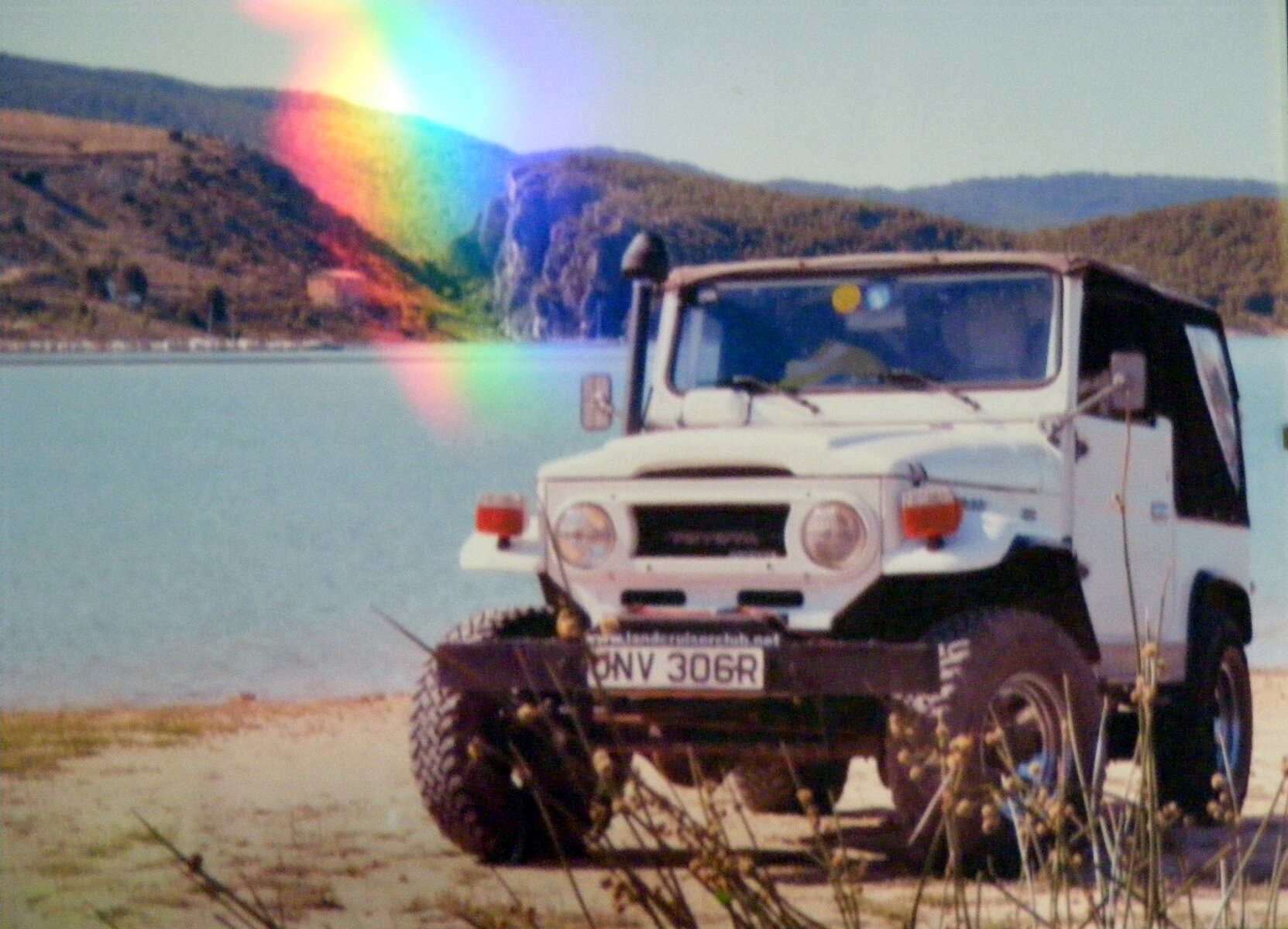

I thought I'd give you all an update on the things we have done to the truck over the intervening years. Aside from moving to Spain and getting the truck registered which took two years but we got there an now she runs with Spanish plates.

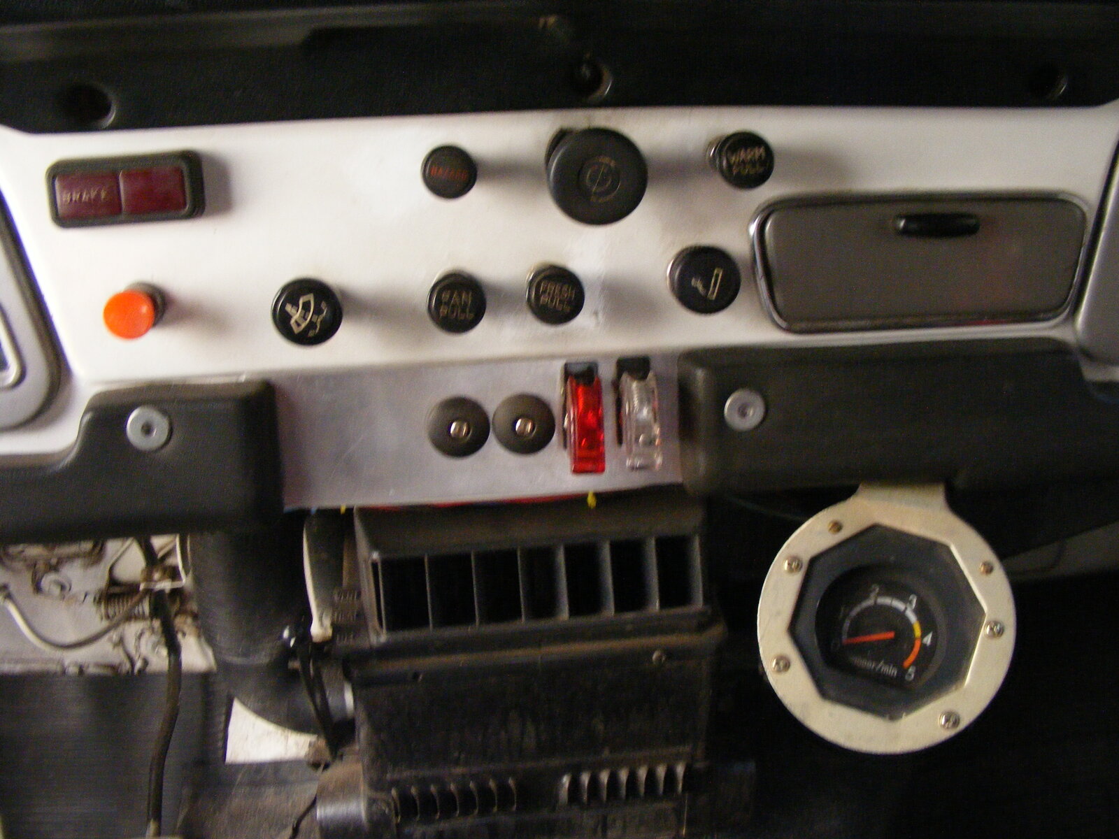

To get her legal we had to fit one of those bright red lights on the back and a reversing light but we didn't want to cut the dash for the extra switches so we removed the radio and fitted an extra panel in its place. No radio?! well it didn't have any speakers so it was no loss. A voltmeter will be fitted in the remaining space.DSCF9708.JPG DSCF8061.JPG

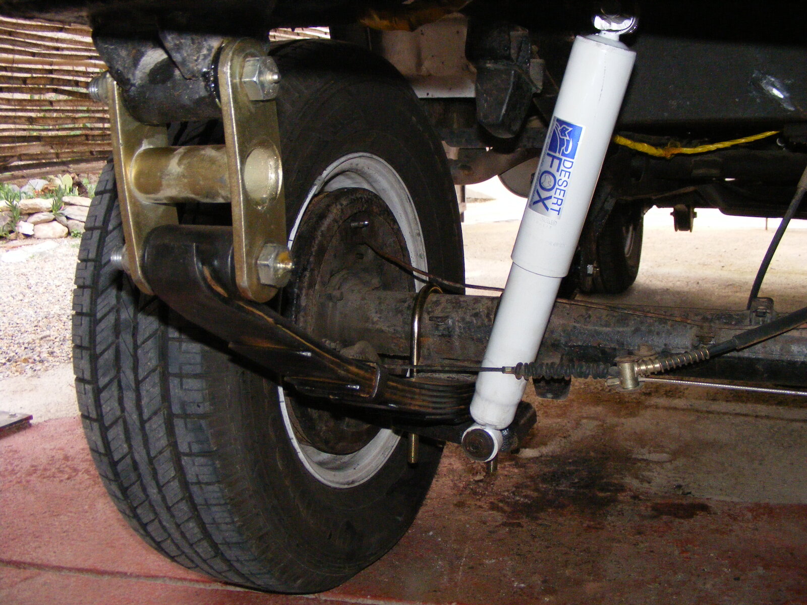

New shocks and poly bushes all the way round and new, greasable, rear spring hangers and at the same time we checked the axle alignment and fitted some BFG All terrains.

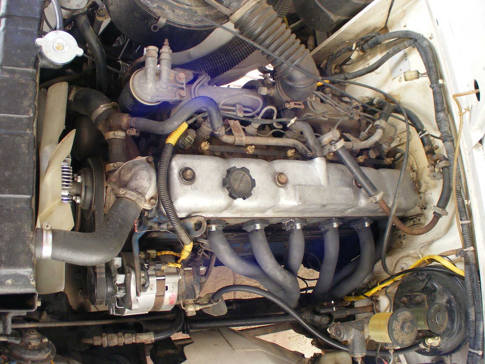

We bought some 2nd hand headers for a 2H and dragged them back from Canada in a rather distorted suitcase only to find that they didn't fit - so a friend got some new profiles cut and we remade them. Now we don't need a radio because the music is all around! DSCF9683.JPG

Only a short update but to finish you know that they say there is a pot of gold at the end of the rainbow well we found our 40 there!
