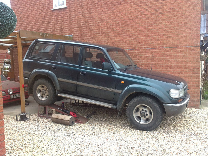

Looks easy, but then again i haven't got the wheel arch liner out yet :lol:[attachment=0:zd61l8yq]27022012763web.jpg[/attachment:zd61l8yq]
Hmmm, need to rethink the car-port..........

I hate to say this but i'm pretty sure you have to lift the body up off the chassis to change it

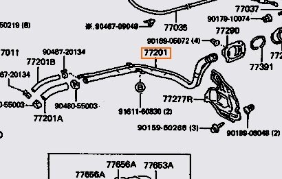

THIS thing?

Aye, that's the one.
Sorry I meant cross-member not subframe.
Do you by any chance have a body lift in already?
How did you manoeuvre the pipe out then?
I only had one jubilee clip at the rubber hose end (part # 77201A), The smaller pipe also connects to a rubber hose (part # 77201B) but the clip is toast. The part where you insert the fuel dispenser isn't attached to anything.
After taking the 2 bolts out that hold the pipe to the body I dropped the pipe from the fuel filler flap area then tried turning the pipe so that the two ends that fit into the rubber hoses come round in an arc but there's no way they are going to fit between the cross-member and the body. An inch or two will probably do it I'm guessing.

Hmm, do you know I can't say how I did it, but I can assure that my body has never been lifted from the chassis that's for sure. My pipe was leaking like a sieve just where it turns from the filler to the tank just where it says 77201. It was full of pin holes. I have done so many jobs I can't recall them all. Getting it out is easy, just chop it up. Getting a new one in can't be hard. Just bend it. I really don't remember any issues at all with doing this. In fact I'd have to look under the truck to remind myself. So it can't have been that hard. If it's that tricky, just cut the new pipe in two and join it with a bit of hose. I would take the easy option rather than start jacking the body off the chassis. That's bonkers.
