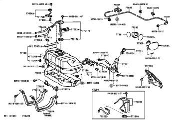

77017B is usually the part that fails
you wouldn't happen to have that in a larger format by any chance? The latest symptom following a new filter is that when the truck dies, it will restart and drive perfectly if the ignition is turned off and on again.....until the next time it dies again...and so on...

How did you do that Bob ???
I print the diagrams off, then scan them back in (Epson Perfection 4990 Scanner). They come out this size.
I'm not sure how to link the diagrams directly from the originating site so this seemed like the only way.
Having the diagrams as .jpg docs allows me to annotate them if necessary using Photoshop.
I now have a large folder of 'Parts Diagrams' on Photobucket.
So, all accidental really :doh:.
