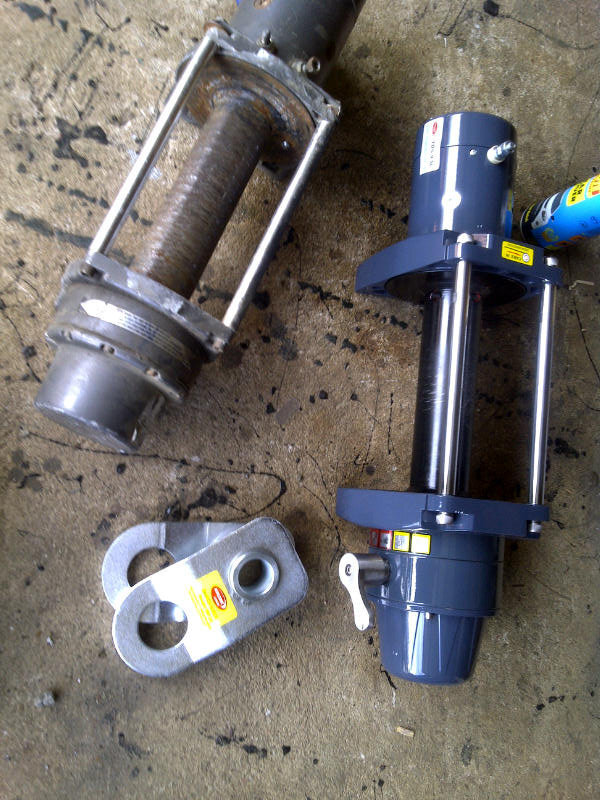

dont think a goldfish TDS will fit in the TBR hidden winch tray, its about 2cm too tall and will snag against the body work between winch tray and aircon condensor...
TDS pretty wide/long too at 61cm
the Warn is about 16.5cm tall and goldfish 19cm
the winch Jon got will fit though its 16.5cm tall and 54cm wide
