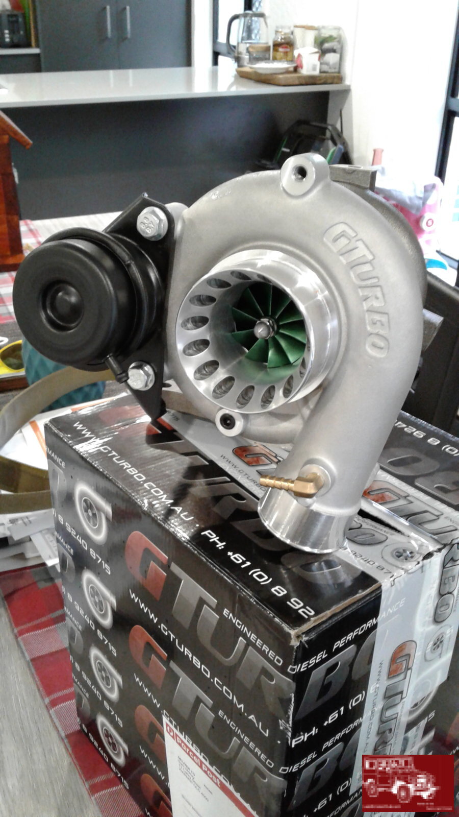

Can work out how to upload photos here but i put a few pics of the new turbo in my media. Will post some updates once the motor is built on performance.

Awesome.
Can't wait to get one of these or a wink for my 80.
The 1hd t is a great engine.
I've never quite got the 1hz tbh. Everyone who has one seems to want to put a turbo on it..

Work of art sam.
Its a shame to fit them to the truck.
