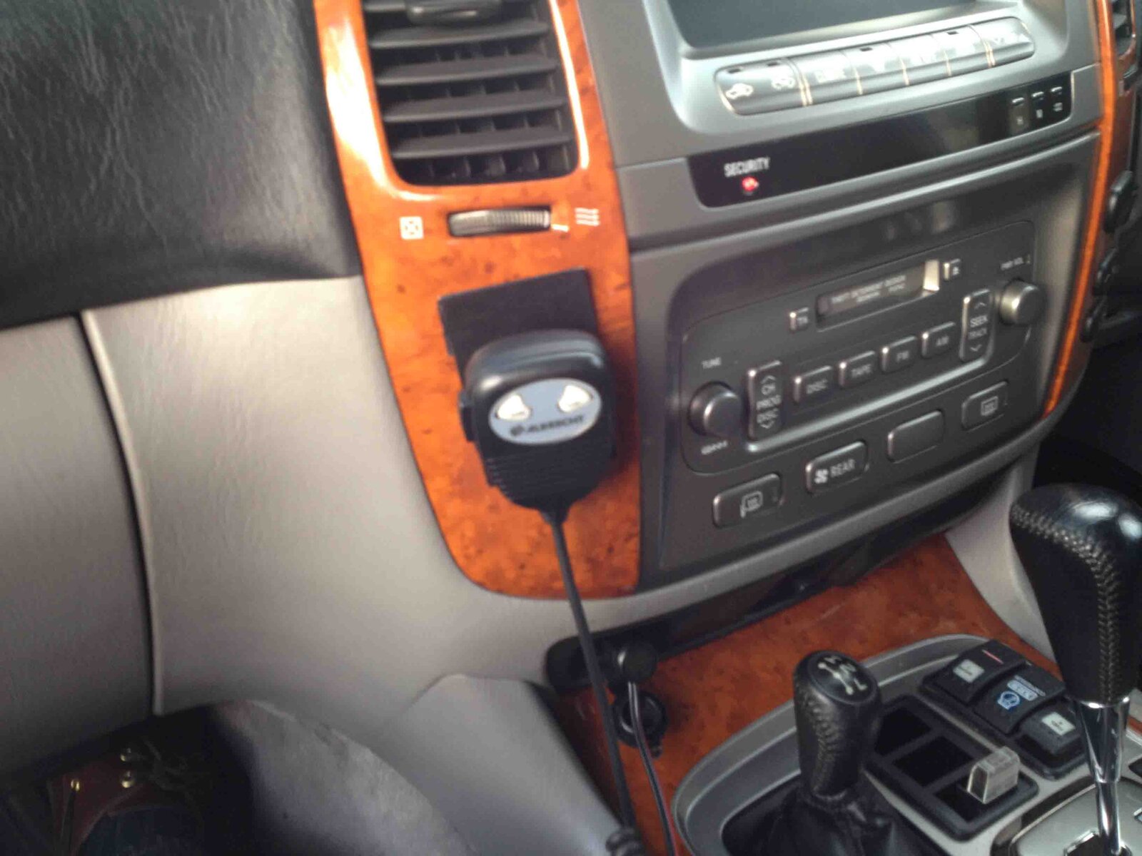

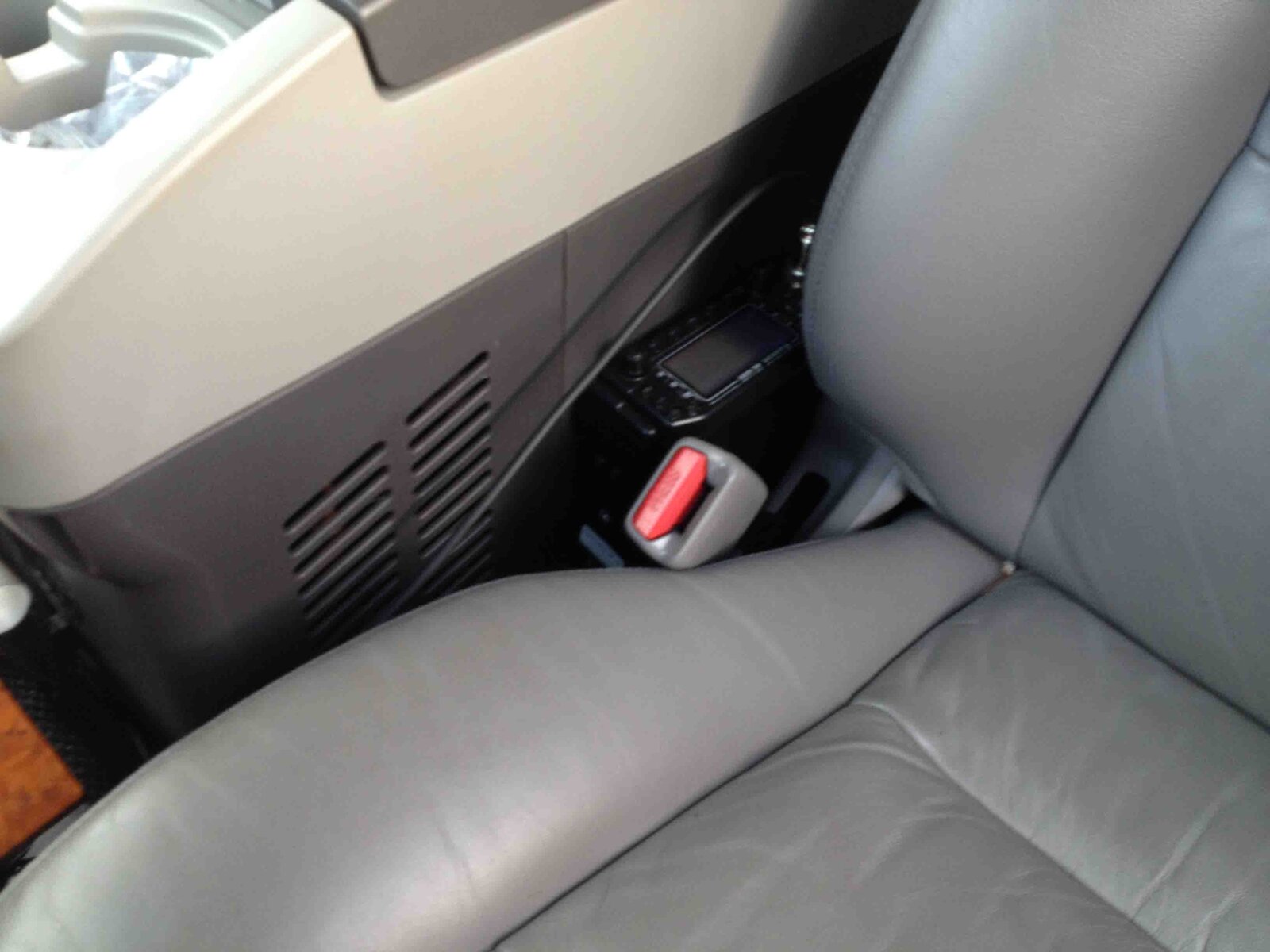

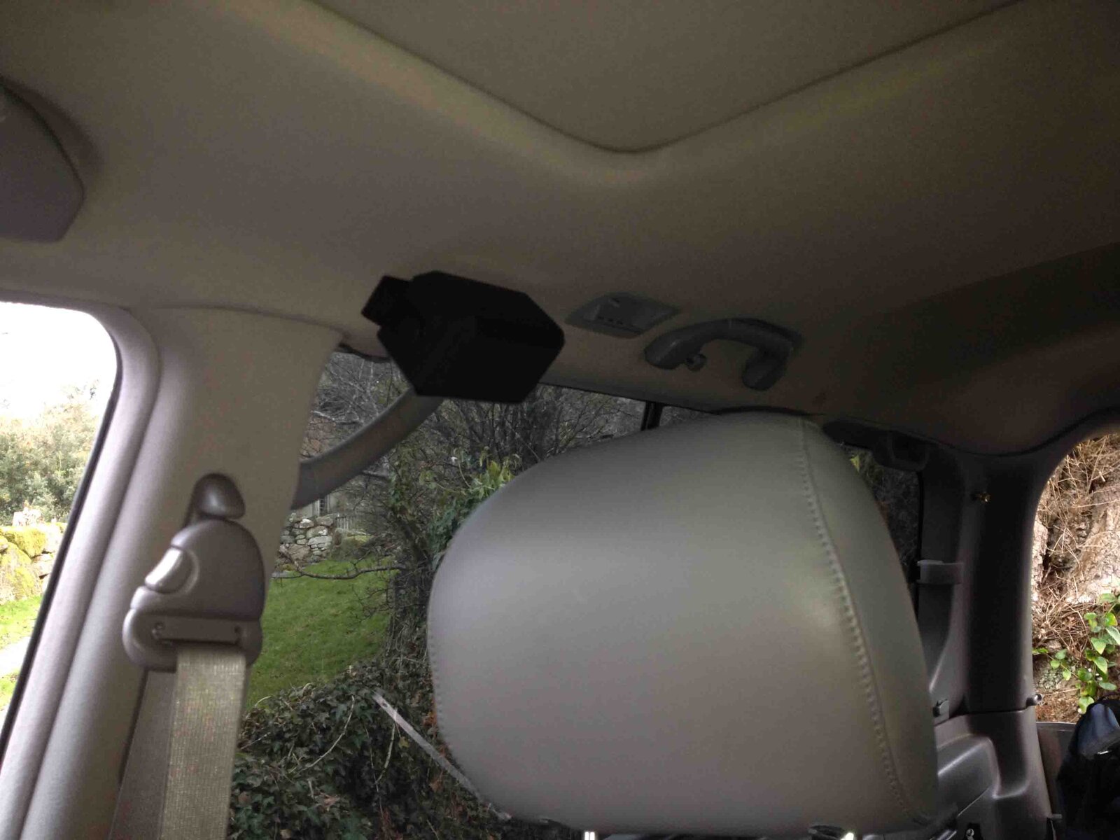

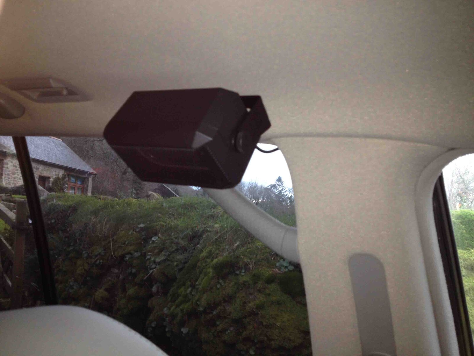

Installed the CB today. Mounted discretely down the side of the freezer centre console. The unit is demountable as some countries (like Morocco) don't like CBs and thus a good idea to remove at borders and the like. Also mounted up a pair of speakers above the front passenger seats so I can hear the CB above the sound of music, road noise the sat nag etc
IMG_1382 low res.jpgIMG_1383 low res.jpgIMG_1379 low res.jpgIMG_1381 low res.jpg

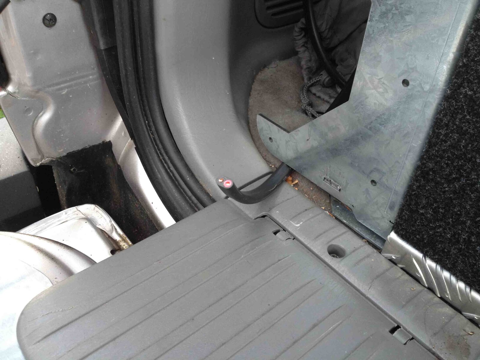

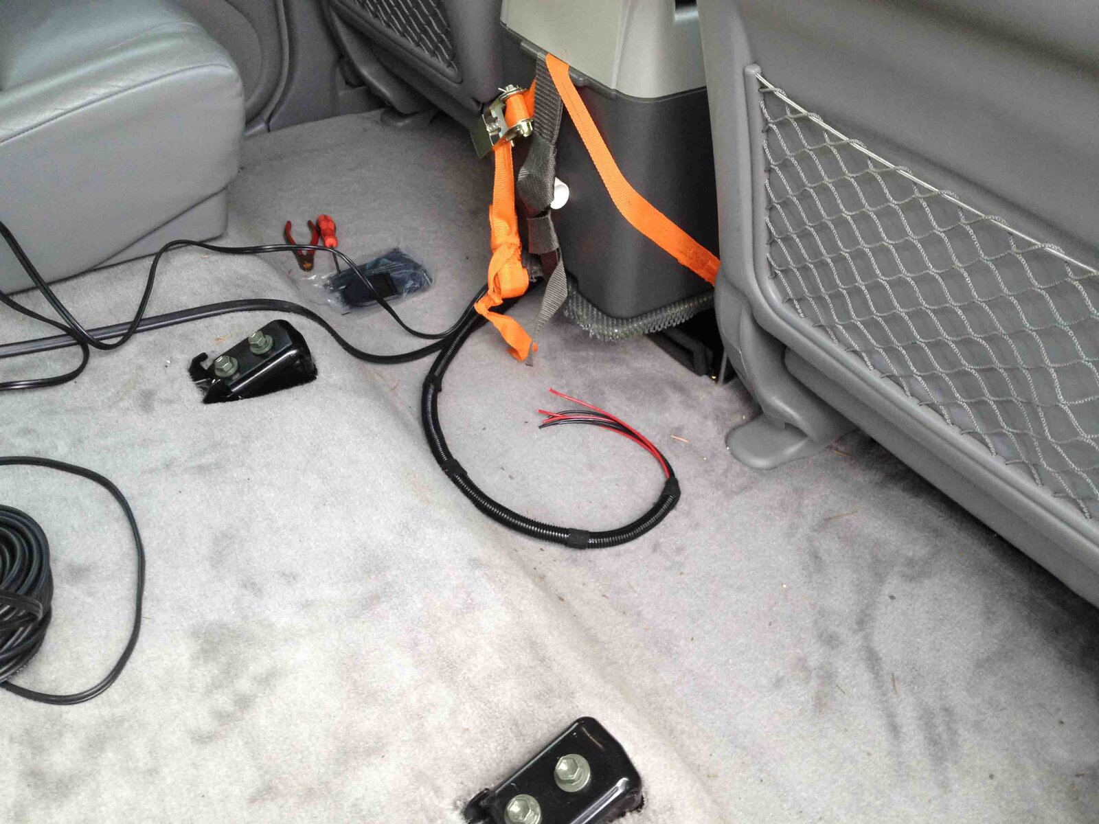

Also shown are the 12v tails from the relay switched permanent 12v. All the 12v sockets in the car are switched so that they can remain live at all times or all completely isolated. The 100A relay and bluesea fuse board feeds two 20A circuits to the area behind the front seats (1 for the fridge and 1 for high power hand tools (12v hair dryer :-) ) plus a heavy gauge circuit to the rear of the truck (long run so wanted to reduce voltage drop) for general camp power, powering the lap-top etc. The front 2x console sockets are fed from same.
The 12v tails will be finished with Anderson connectors and mounted under the extended load deck where the middle row seats used to be

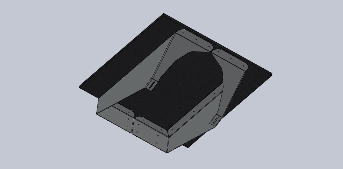

Below is an early draft of the bed base unit that will go where the second row (60%) seat was. It bolts to the existing seat mounting points at the front and the rear is held in place by the drawer system. The final version will have various minor improvements to this design, but you get the idea. Top surface will be 18mm MDF and will form a continuous surface with the top of the drawers. The under side will be used for storage. The side brackets will be drilled to hold various things. This side will also bear the weight of the fridge which is being mounted behind the driver's seat (not on a slide).
View is from below

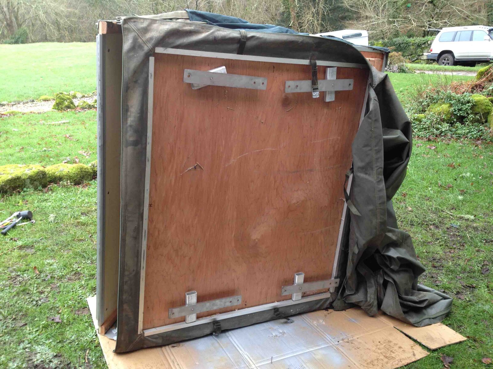

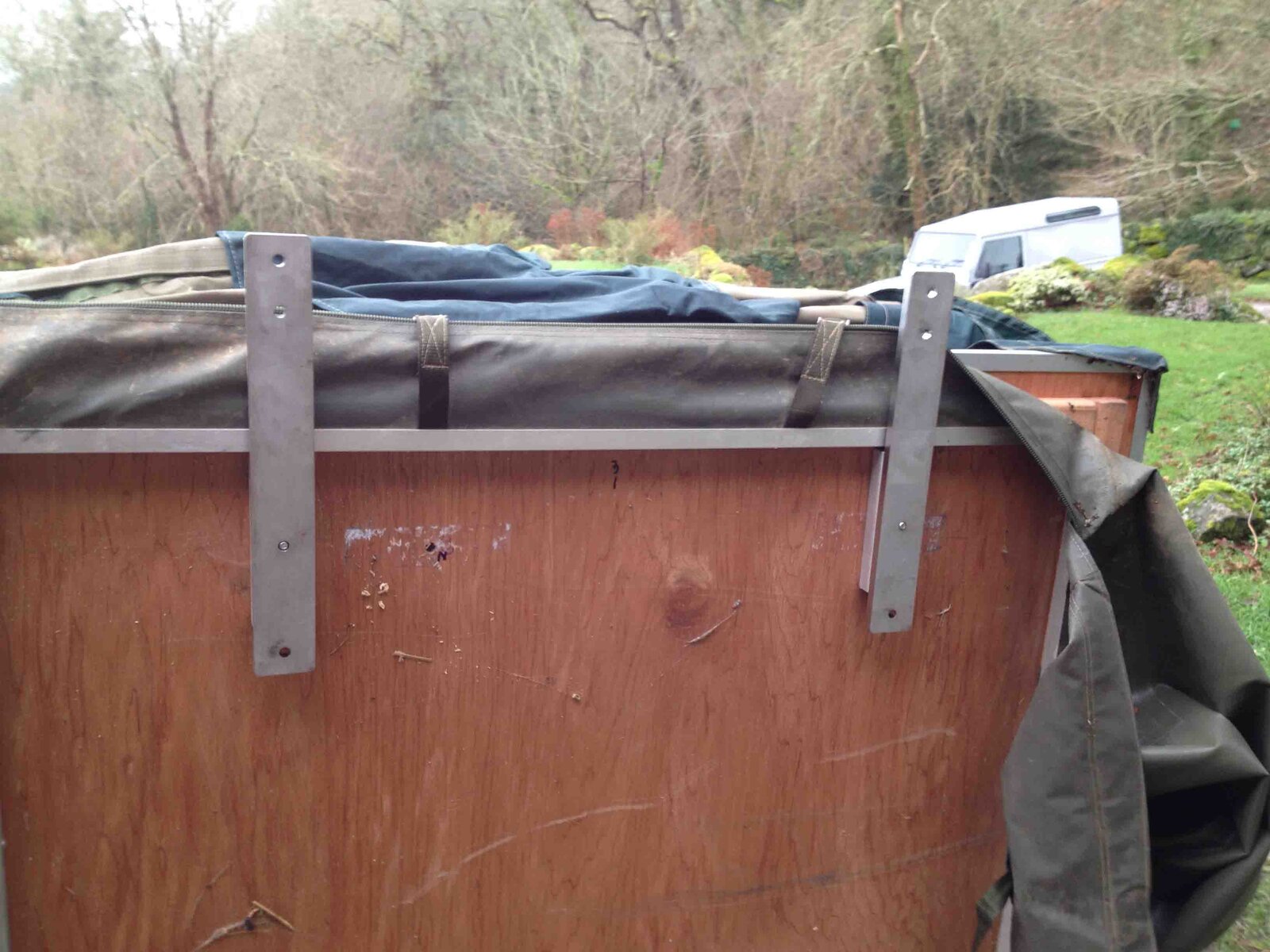

Photos below show the roof tent mounting plates in transit and open position. These allow the tent to be bolted to the roof simply without opening the roof tent first. Hopefully this will make un-stuffing the ISO container and re-fixing the tent a bit easier. Also rigged up a block and pulley from a tree in the drive to lower the tent onto the rack as it makes it easier to man handle nearly 50kg onto the roof with only two people

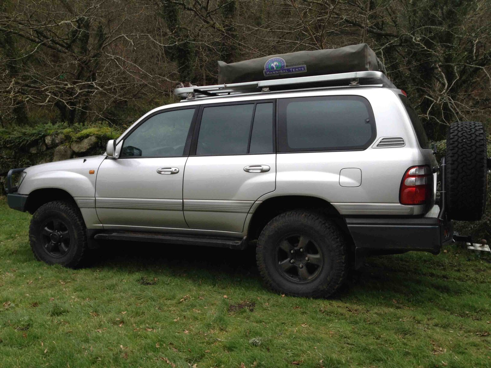

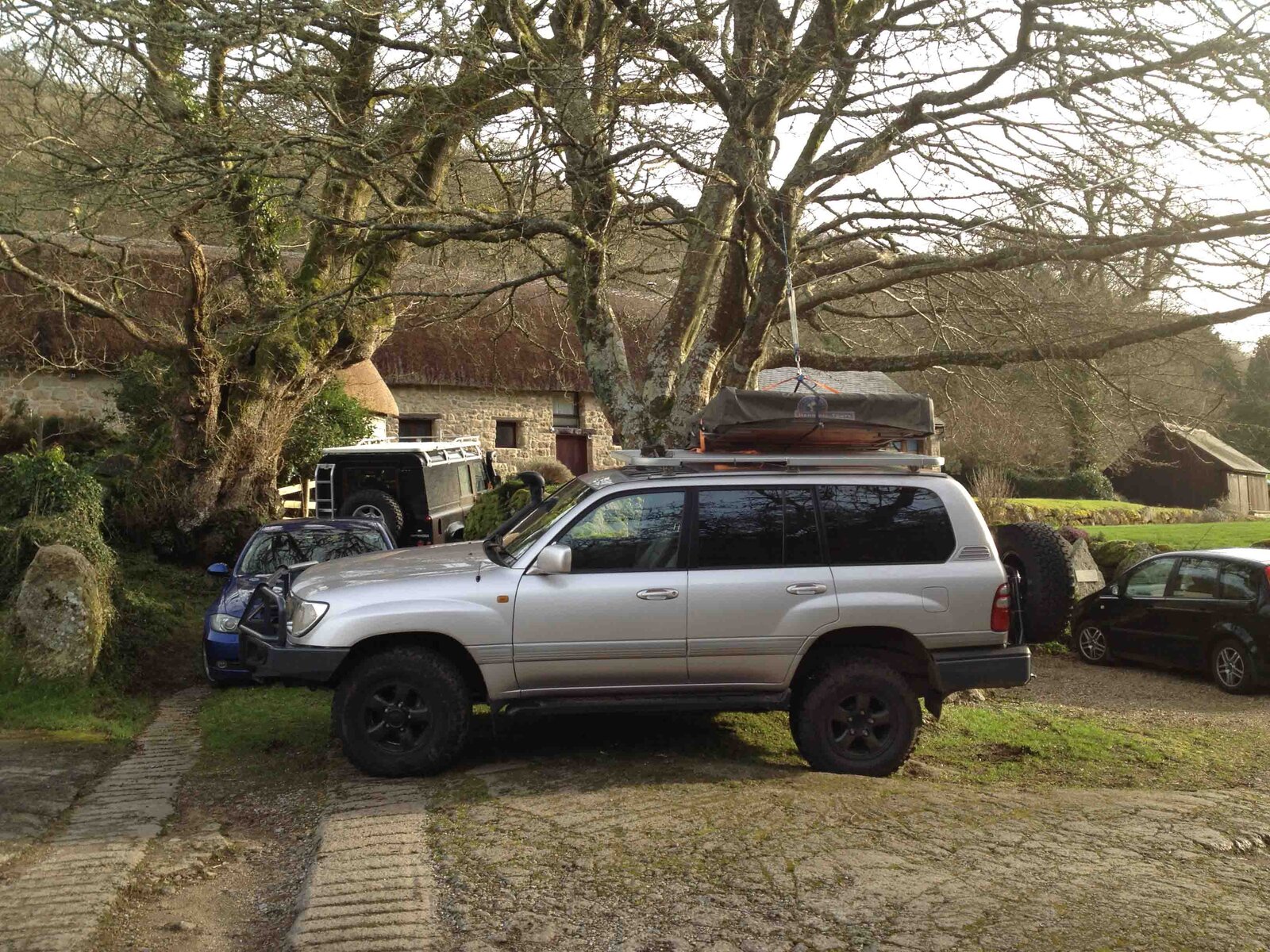

Focus this weekend has been on fitting the side pieces/wing kit for the drawer system and getting the RTT in place
For the side pieces I used some cardboard to cut up and use as the pattern to mark the 18mm ply supplied with the drawers. The side pieces are pre-drilled to fit the side wing brackets but needed to be profiled to fit the side of the car. I used a Stanley knife to pare back the carpet material: this will be stuck back down now the ply has been re-profiled. Hopefully it will look like a factory fit when complete.

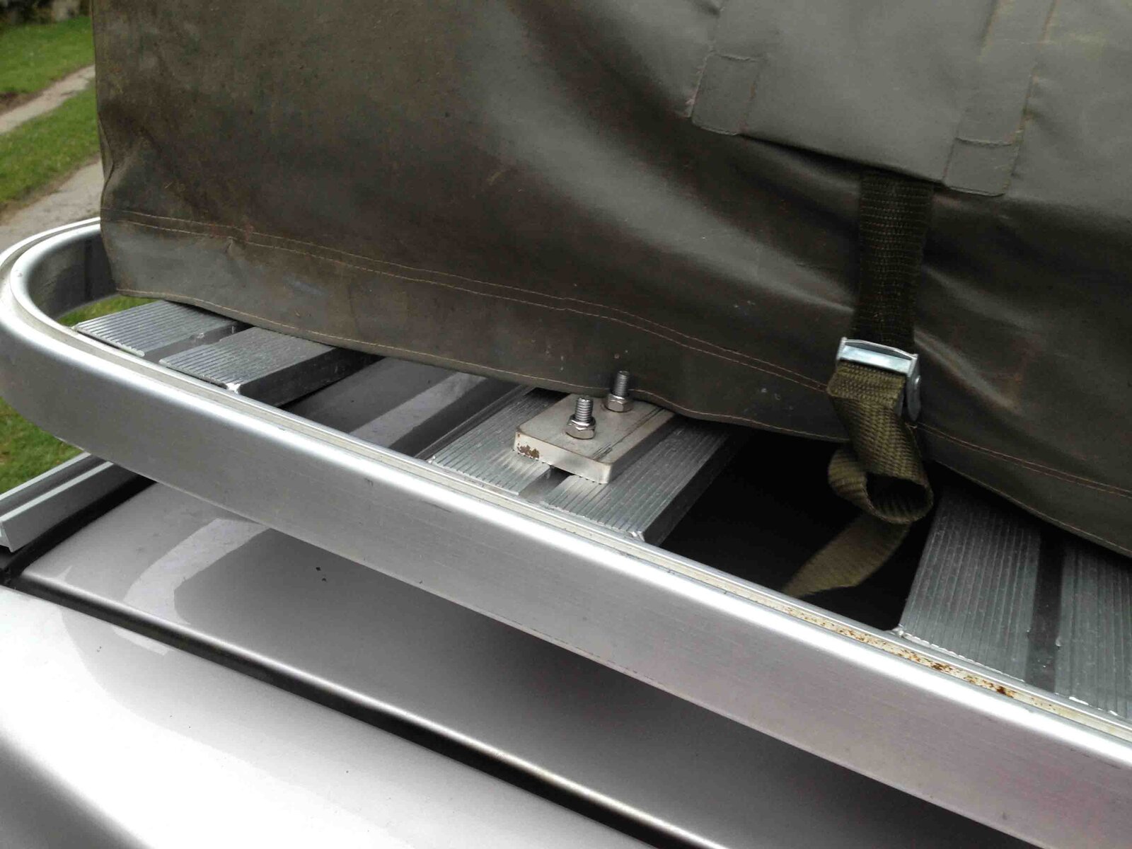

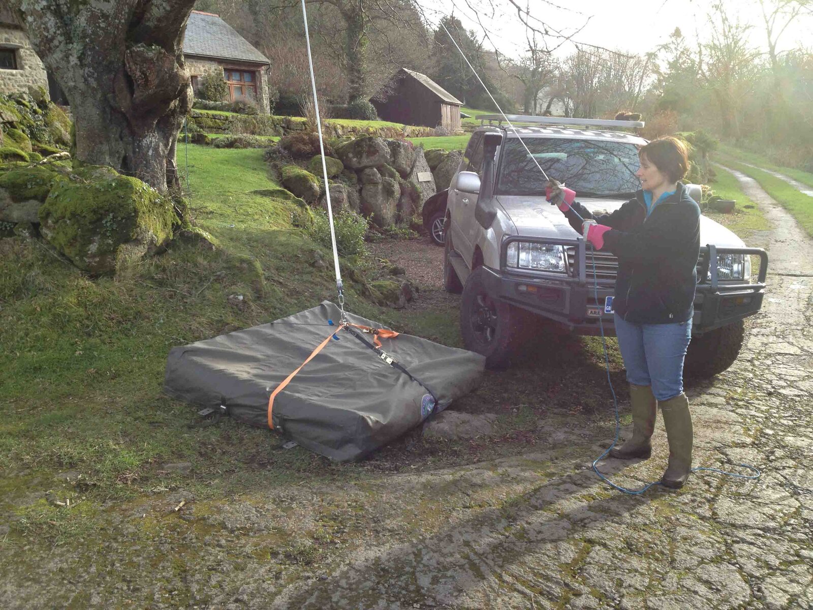

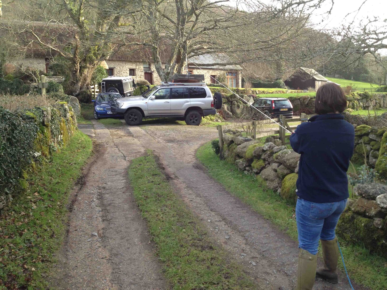

Rigged up the block and pulley system to a handy tree to lift the RTT. This is a bit of an experimentIMG_1400 low res.jpgIMG_1402 low res.jpgIMG_1401 low res.jpg. The pulley has a 180kg lift capability (apparently) but I wouldn't use it for that....but it is surprisingly robust. The RTT is just under 50kg and the block and pulley has a 6x gain so it is pretty easy to lift. Lift the RTT, drive the truck underneath - simples.
Then locate the RTT mounting brackets over the s/s bolts mounted in the roof rack channels and bolt down. Think I'll move the tent back 2" to make most use of the space on the rack and also maybe shorten the bolts and make them slightly differnet lengths to make it easier to get the bolts through the plate
