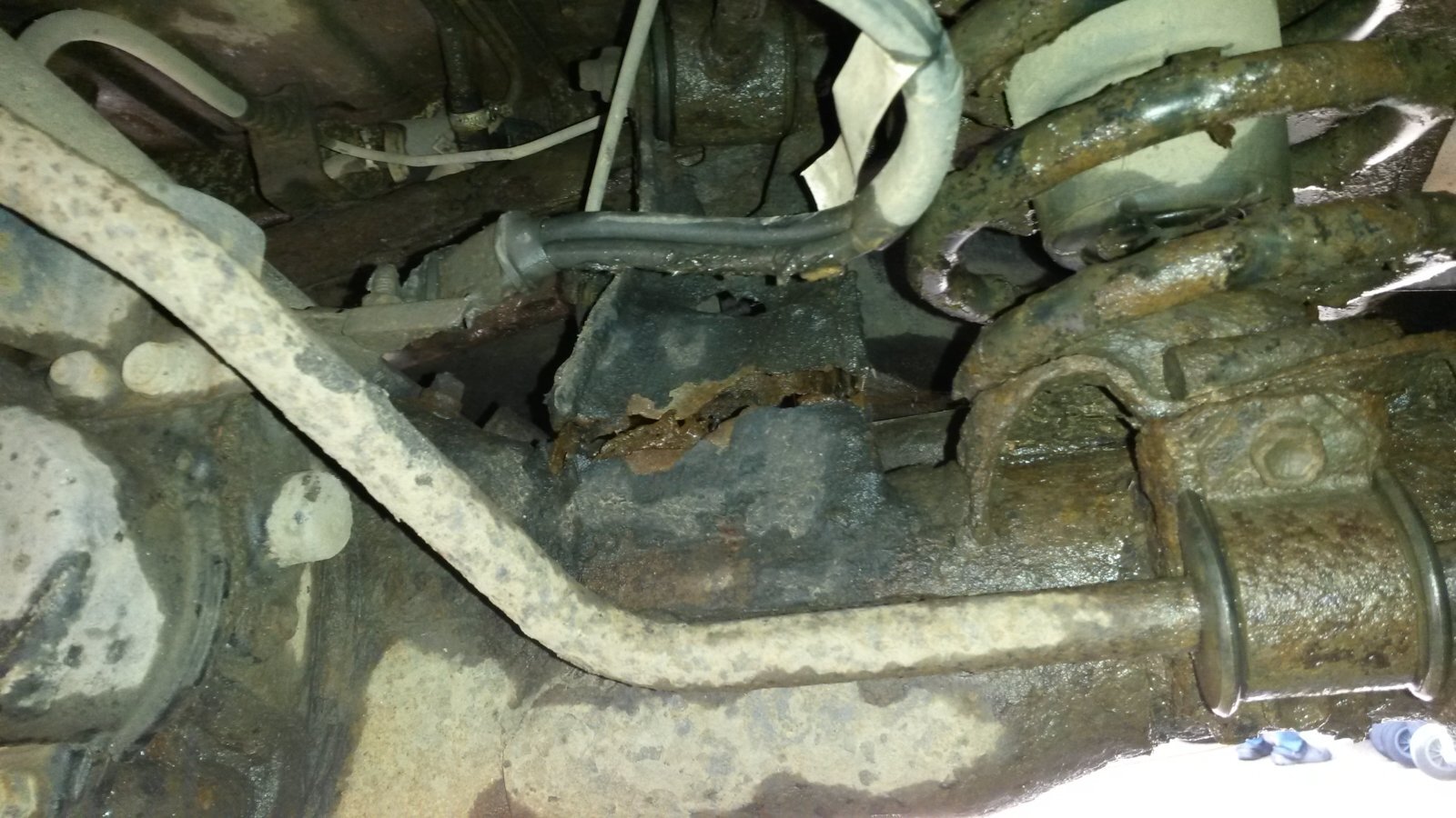

Lol i like it Shayne i only got it Saturday it was very impressive on the test drive probably better than my first "the Colorado that is :joycat:" it has 10 months mot. The seller pointed out that it had some welding done the the diff hanger bracket unfortunately i have now noticed the other one was broken in two see pic so thats a welding job for me straight away :cry:
Ouch , there and the rear body mounts seem to be what suffers from rust the most so hopefully it doesn't necessarily point to further problems .

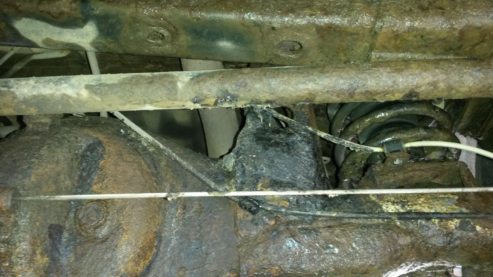

Yes i have the failure sheet but i presume the broken mount shown in my first picture was done after the mot pass i have a attached a picture offside rear upper trailing arm repair if this is what they were referring to ??

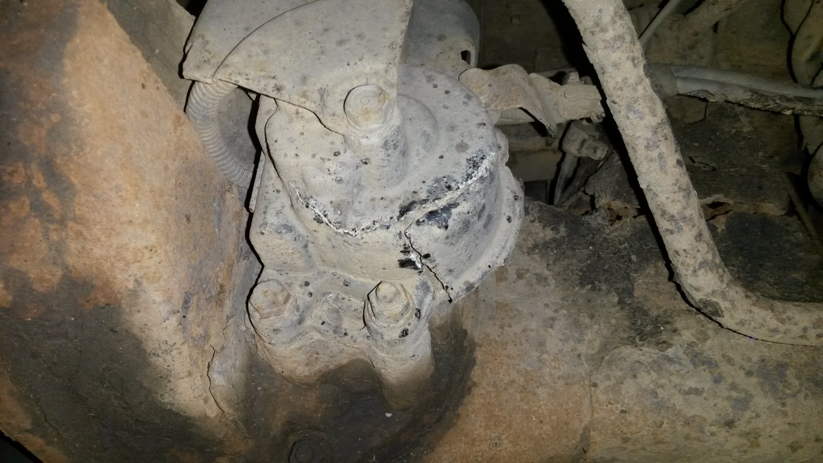

The first pic is your diff locker does it still work ? If so get it cleaned up and seal the crack with jbweld soon they are expensive things to replace . It's only really used for off road though and as you haven't mentioned mud yet maybe you can ignore it altogether .
The second pic is your panhard rod , the trailing arms are the same rods running front to rear and connected to your broken axle mounts ,the bit that needs welded .
Before spending on repairs it has to be worth talking to breakers about a replacement axle and i think Milners sell new ones .
Thanks Shayne if you look at the bracket on the axle t is covered in underseal this i presume is the repair they did for the mot i intend to remove the said underseal and see exactly what is beneath??:flushed: I don't really intend to do offroading but who knows eh i will try and seal the difflocker anyway i would rather repair the axle i have as there are no clunks or whining etc thanks again for your advice very much appreciated ;)
How handy are you with a spanner is the question , what you buy new is just the empty shell of the axle and transfer all the internals though i guess there would also be seal and maybe bearings to buy (its not something i have done or looked into doing)
