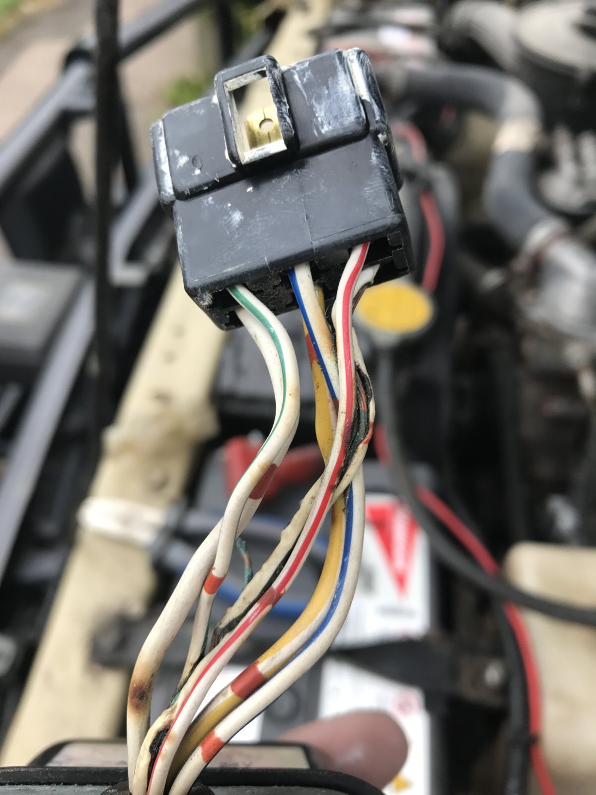

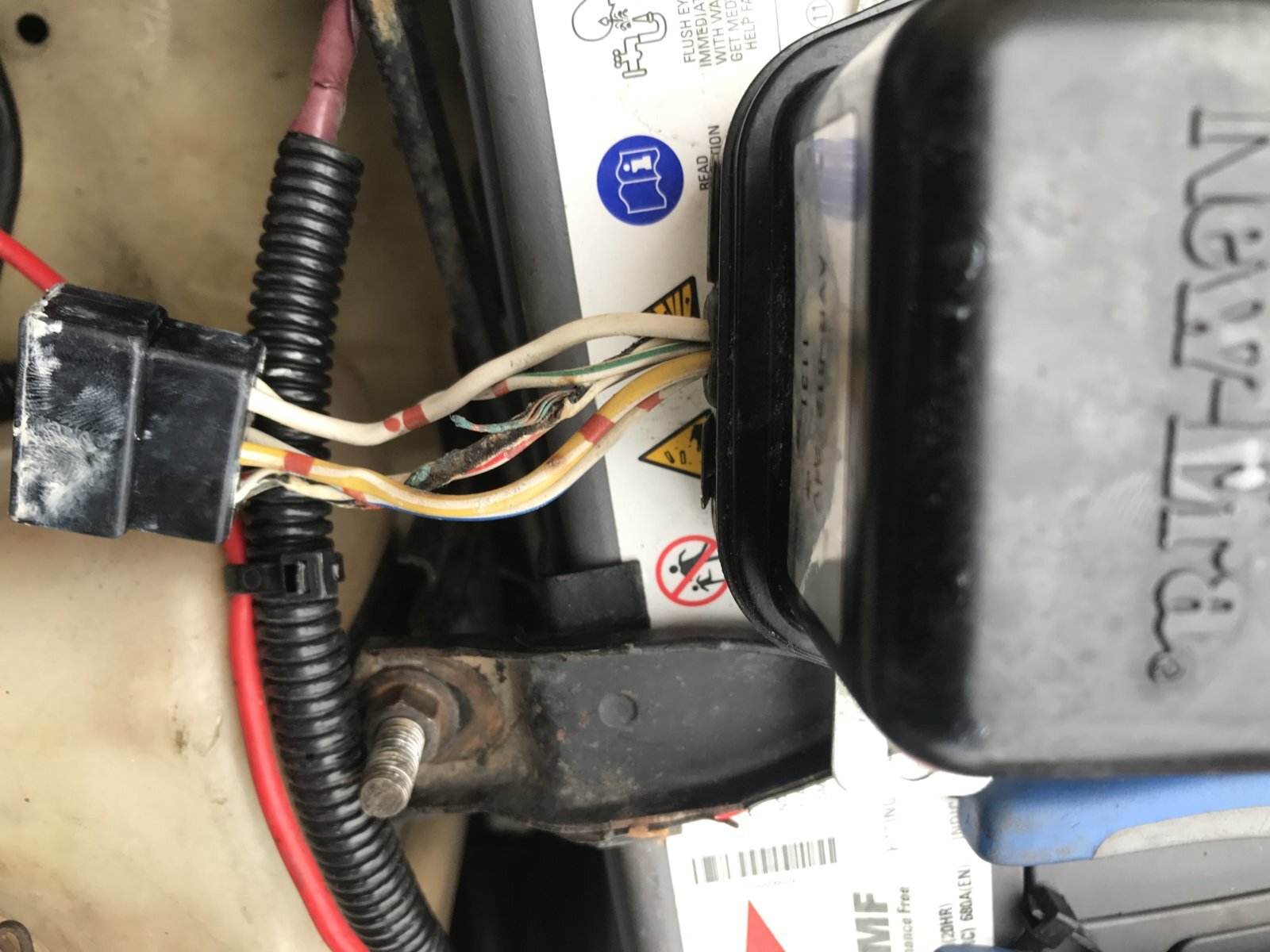

I had this with my 60, the edic kept shutting off, subsequently found out it was due to the wiring on the voltage reg melting.
214FE3AF-2C59-4725-B0CB-925BF96E44AD.jpeg C5208BBC-1A64-4F63-9622-47D7CB2556B2.jpeg
