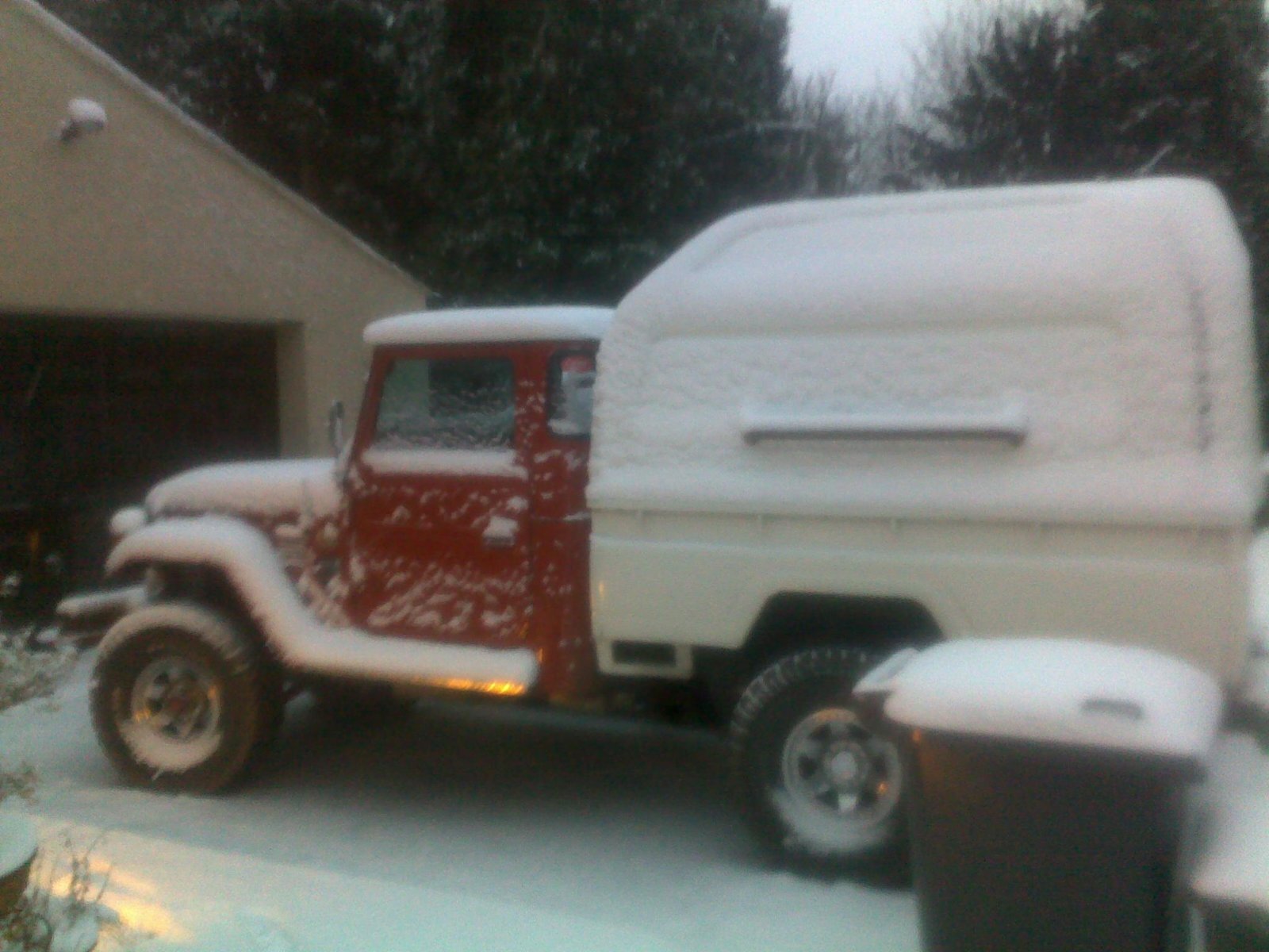

Hi Cliffy I have 33 on me fj45 and a 2" lift. And it looks good good look with it I will be looking for a new suspension kit to get a softer ride old man emu .
Thanks Tony
Yes looks nice
Hi Cliffy a piec of the fj45 with the 33" on it hope it help but looks good .
