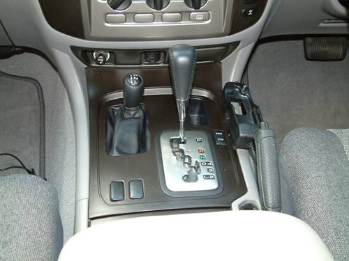

It's a 5 speed. The gear stick works across a notched diagonal. On the 4 speed it's a straight slot.
FYI they are either 3 or 4 speed with overdrive not 4 or 5 speed in the auto box.
When the rear washer nozzle is to the right, it's a 5-speed.
I'm on a similar search (though just looking currently) and you can easily tell by the gear lever and gate - the older ones have a lever similar to the 90 series and a straight "up-down" gate, whereas the newer ones have a much slimmer lever shaft and a notched/dog-leg gate.
I would have thought that anything from 2005 would have the newer box.
Add: This is like it (might not be the exact one but you get the idea!)
Thats great, I get it now.
