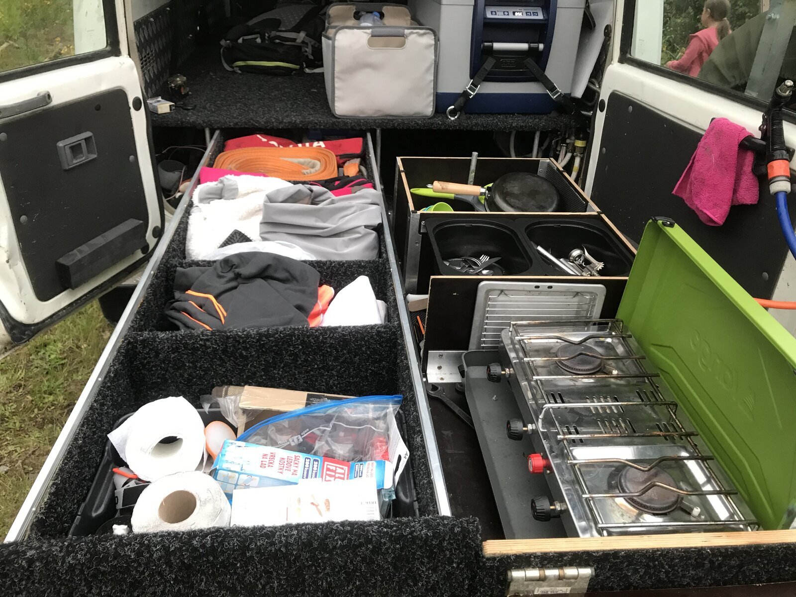

Firstly some background; I use this vehicle periodically for work also, hauling various machinery and components to inaccessible locations, so it was important to be able to quickly and efficiently convert from a touring setup to a working vehicle. Luckily the drawer setup serves both purposes quite well, though releasing 6 buttonhead screws I'm able to remove the kitchen drawer and replace it with a more utilitarian drawer when in work mode. Likewise the roofrack is a versatile addition for both leisure and work, so no worries there.

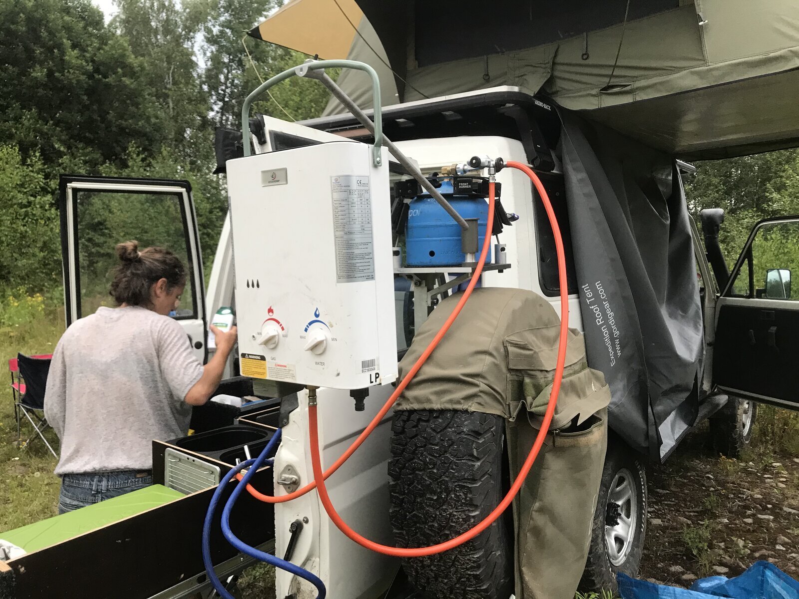

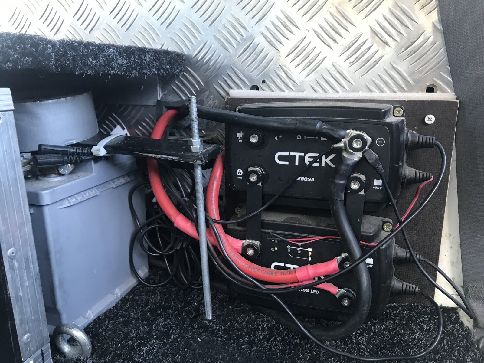

Behind the drivers seat there is a 50l tank for water, and this can be filled from any water source via the 3 way ball valves just inside the rear barn doors on the right side. The pump can draw water from a depth of 15m, and goes through a fine and coarse filter before filling the tank. We power a 2 burner cooker and an instant water heater from a small LPG bottle mounted obove the spare wheel. On the left side of the drawer setup are 5 x 12v & USB outlets running off a 105aH AGM battery. Fridge is a 60l ARB which is plenty for a couple of weeks in the mediterranean. RTT is a GordyGear (165cm), australian made and we are very happy with it, insofar as it is very comfortable for 2 adults and a child, and hasn't failed to keep us dry in some pretty extreme weather conditions so far!
