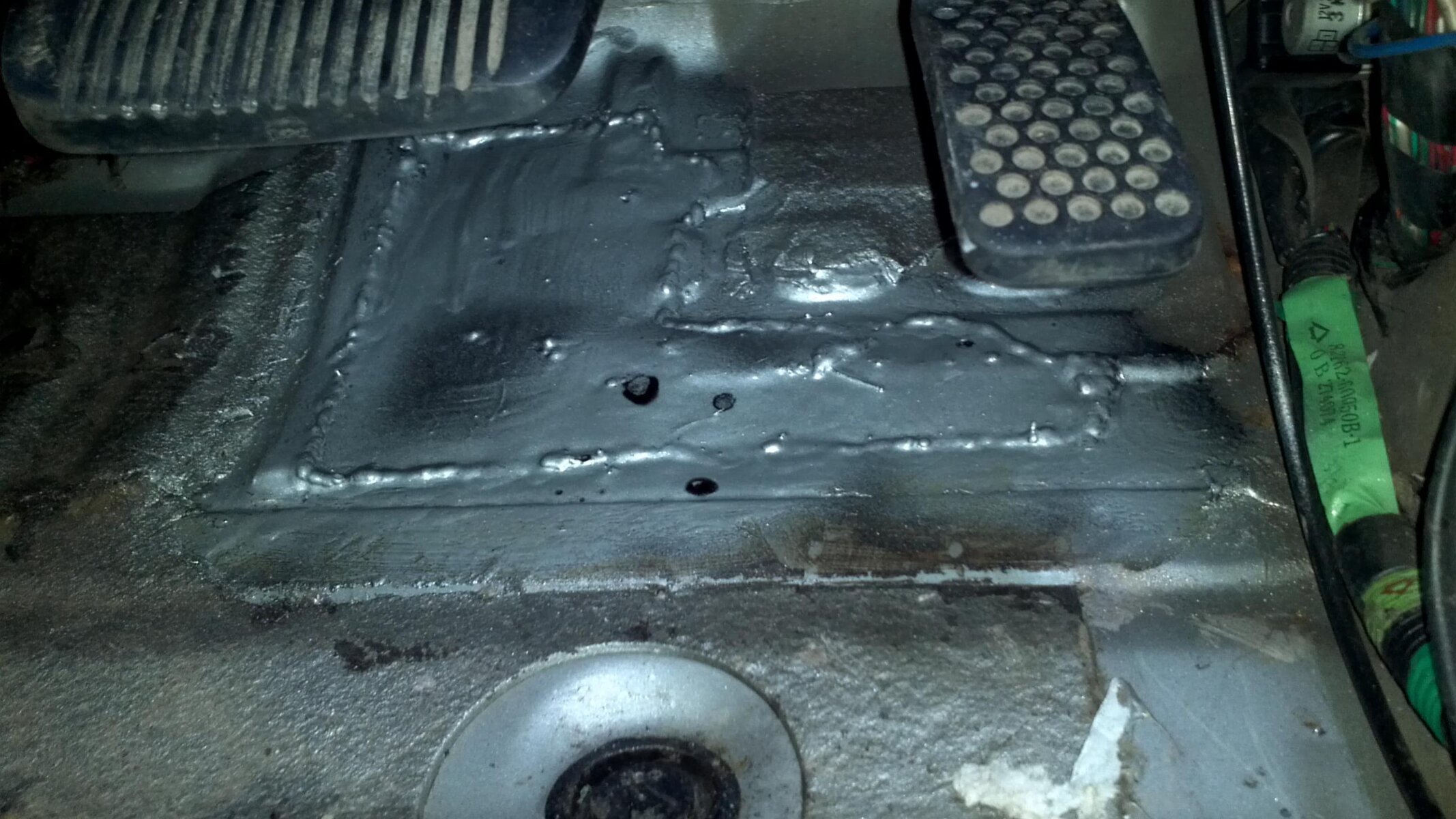

I hate rust, full stop can't stand the stuff. Hence my inane inability to buy UK cars & why I always choose JDM cars if I can find them. Anyway whilst drying out the carpets after the floods from a few weeks back (it was pretty deep to get to the horses) I find a small hole in the drivers side footwell
So after a good prod & poke, then some cutting out I found the culprit, there is a mount on the front side of the footwell, that attaches the inner wing to the guard. This had obviously filled up & ritted away over time. There is a bung in the bottom of it, I'd suggest to remove the little blighter !
So we found this
After several hours work I finally fixed it, nice & properly, all fixed back into the mount (which I even had to fab up some parts of
So I have just ordered a bloody great load of Waxoyl & rust cure stuff & shall give the old girl a once over to keep that horrid rust at bay. This is first bit of welding my 80 has ever required not bad for 26 years old eh.
