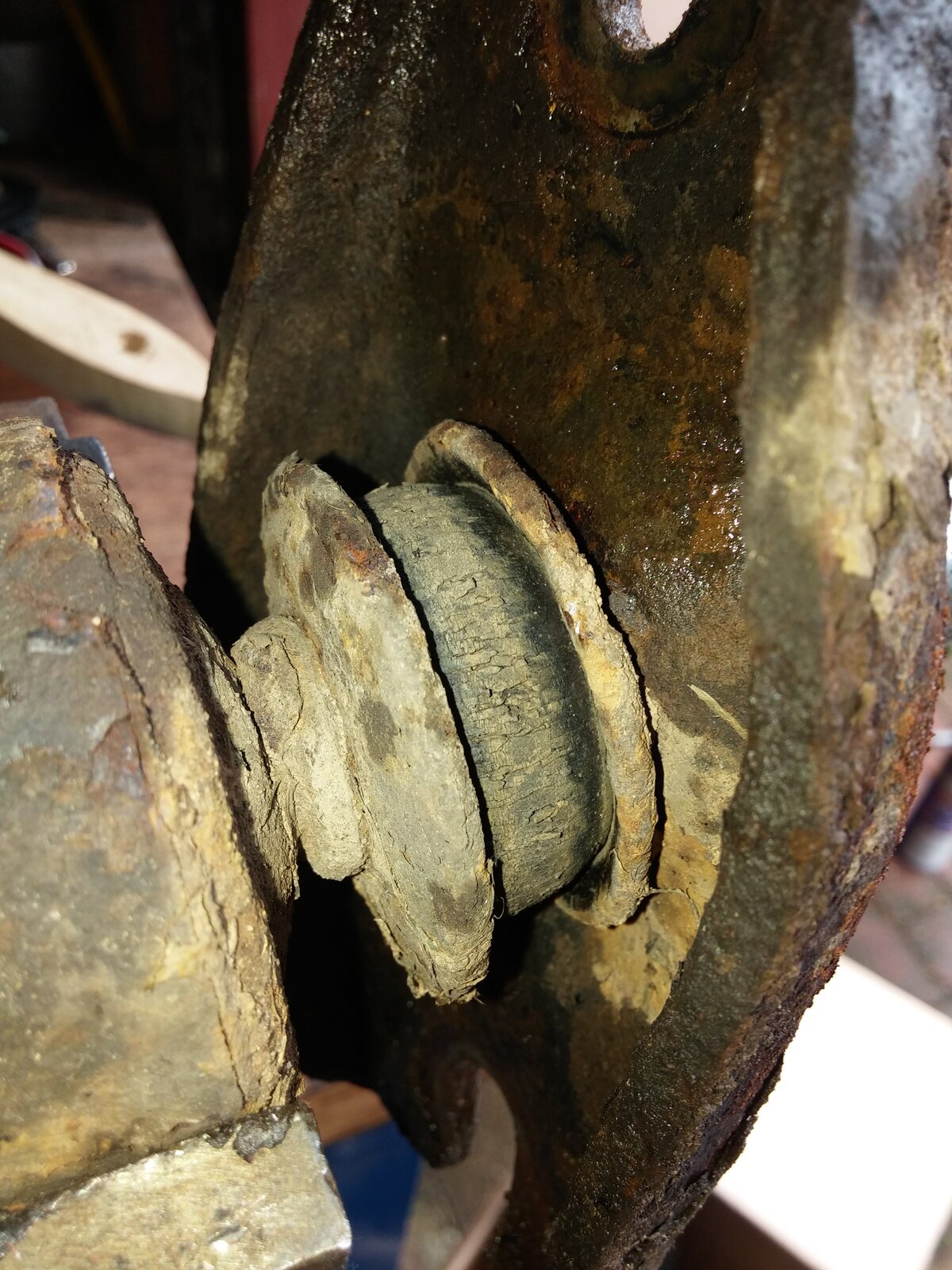

Are you fitting it Mike? If so can you take a photo of how you arrange the rear shock washers/rubbers as I seem to have one large washer from each side left over.

Paul did you put a plate washer either side of the lower bush?? I suspect that's your spare. The top has three plates and 2 bushes:

When I did mine recently. . There is like reinforced extra washer fixed to the top of heavy mount plate. So one above the top bush and one either side of the lower bush.. It's a nice job getting the two 14mm top mount bolts loose! :thumbup:
No Gary I didn't. I assumed the 2 large plates/washers are for the bottom but the centre hole in them means it would not slide unto the lower pin. So I left one of the original ones on there to make sure it has one each side, I have used one new one.
The top has three plates and two bushes as you say.

Yup came across the same issue. I've sent a mail to Chris. I used the one with the right sized hole a d put the lip facing back into the mounting am and tightened it all up :) hopefully not destroyed anything.

.... I used the one with the right sized hole a d put the lip facing back into the mounting am and tightened it all up :) hopefully not destroyed anything.
Gary, the 'dome' of the washer should be facing away from the shock, this will allow the shock some movement during axle movement. If you have fitted it the other way DO NOT use your truck until you have turned it round because you have essentially 'clamped' your lower shock mounting.

Thank you Chris. It seems I have mine fitted correctly and there is indeed one washer in the kit that can not be fitted.

Yes I too have them set up correctly. Thanks Chris for sorting this on a Sunday - fantastic service!
