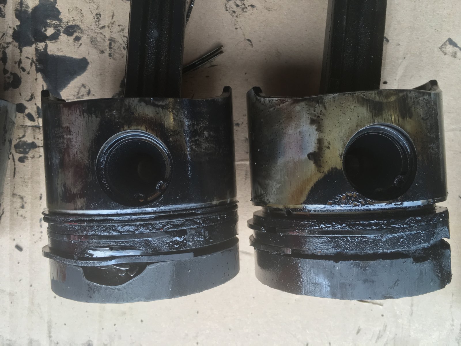

This may be the cause of the problem!! All 6 were shagged but these were the worst. 6 pistons required.

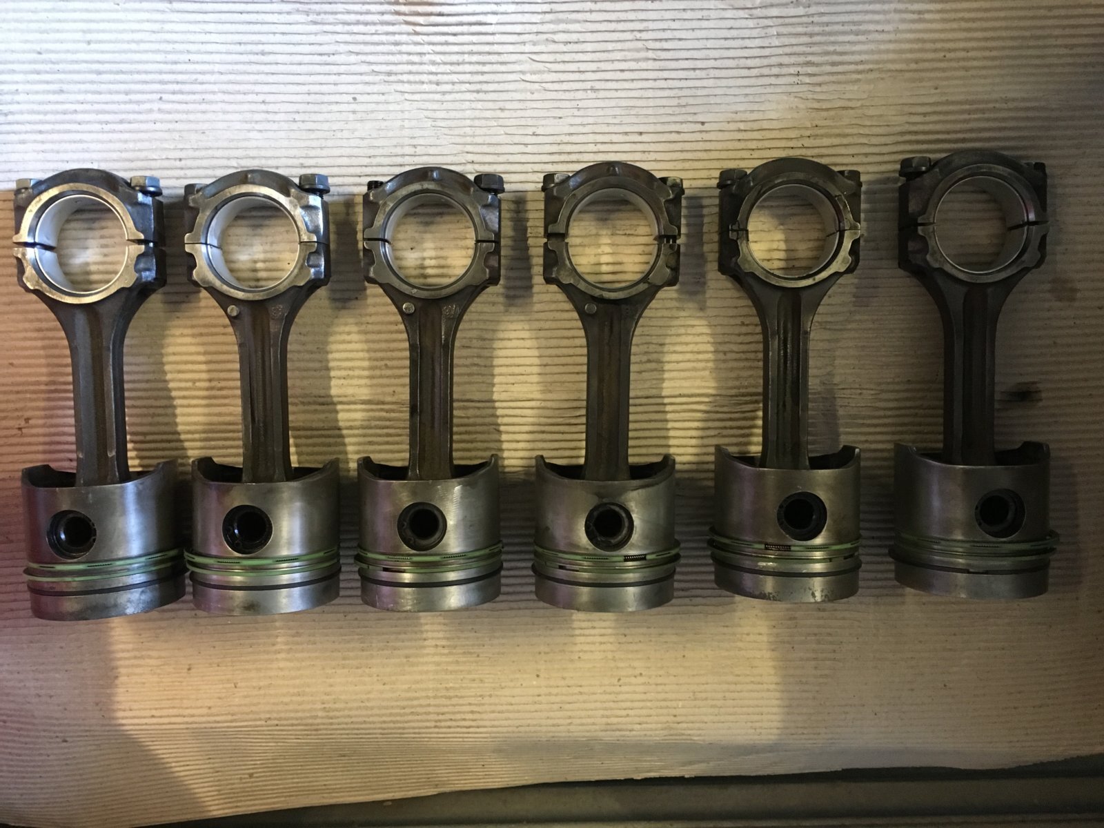

All 6 removed and in perfect condition, you couldn't have scripted it.
Big ends and rings sourced by our own Mr Webster.
All pistons perfectly cleaned and re rung with shells fitted.

The root of the problem was self inflicted I think, I'd put 255/85's on Hilux steel wheels (heavy) which had increased the gearing a bit, and asked everything of it to Lincomb and back on oil of an indeterminate age. There was no overheating issue, temp was fine all the way, rad is like new.
It has been suggested it could have been an injector issue but they checked out fine for break pressure and spray pattern, it ran without smoking so I guess its not that.
The biggest bonus was that the bores were still good, a few small scores but nothing for concern and that the pistons out of the scrap engine were so good, the rings were worn out but all the ring grooves were perfect and the new rings fitted snugly. ( these pistons came out of a 60 which had a Turbo Technics turbo conversion fitted BTW).

The pistons out of the truck had got 193K on them and the pistons which went back in had 225K and been turbo'd. On both blocks there was very little bore wear but the rings on the turbo'd were really thin, that said it went very well. If the block in the Cruiser had been bad then I could have used the other block and crank and re furbished that.
