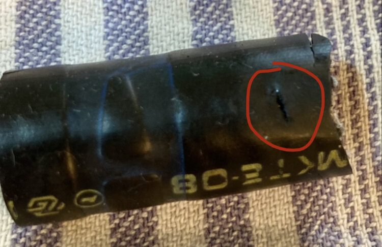

Noticed this the other day. A very small fluid leak on the coolant hose to the Auto Box. Its one of the ones on the bottom of the radiator to the auto box.
It had been rubbing on the cross member and caused a very small split. Good thing was there was enough to snip off 25mm and push back on.
Its hard to explain but easy to fix.
