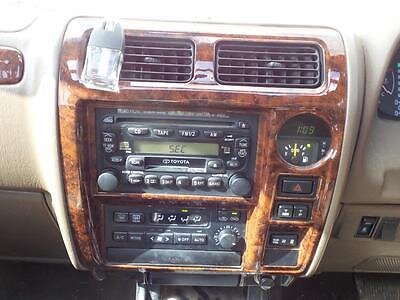

The heater/aircon control panel is exactly the same as my 1998 truck and the owners manual makes no mention of climate control though it does show a digital heater control panel with an auto button which i definitely don't have .

This one has climate control so mine doesn't
If yours has aircon you will need a longer belt. the climate control just uses the aircon and heating inside cab to maintain a set temp.
With just standard aircon it is either on or off.
Both systems will have the same aircon compressor in engine bay.
If that makes sense...
