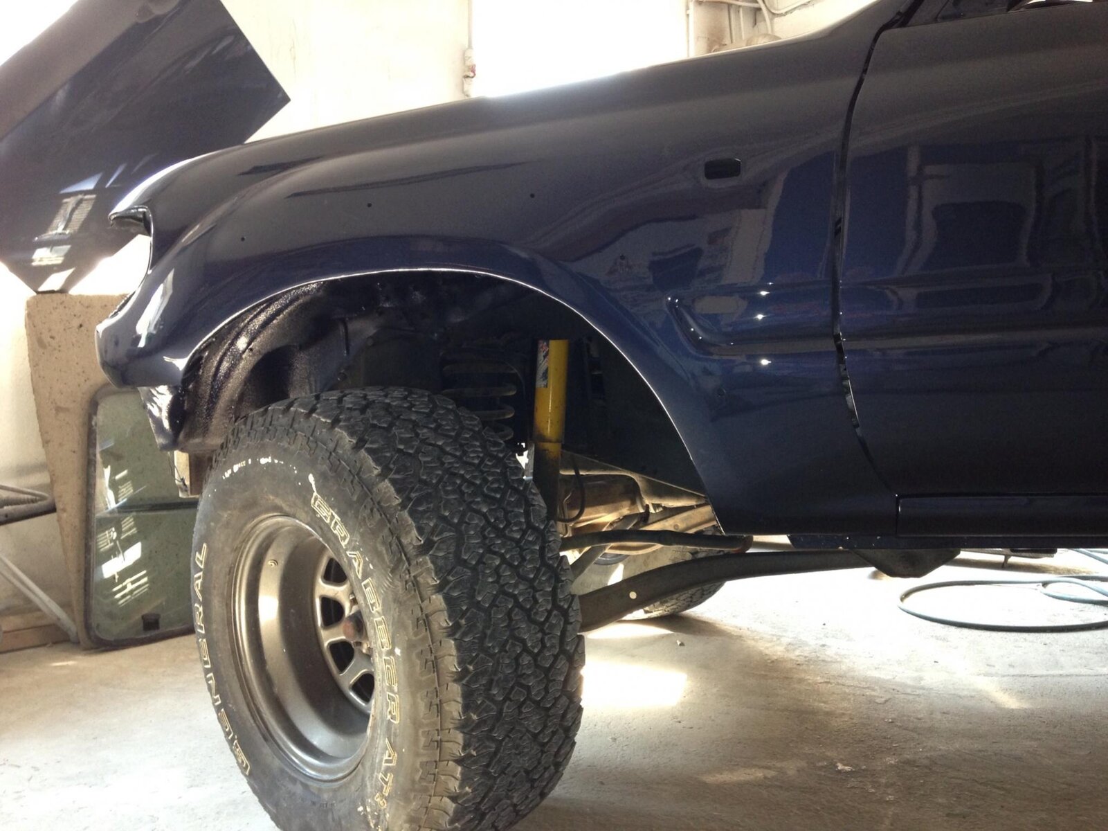

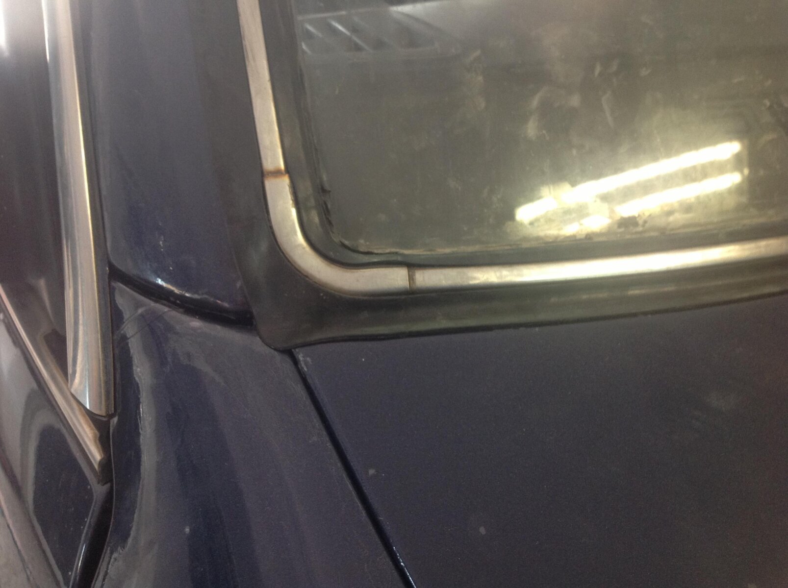

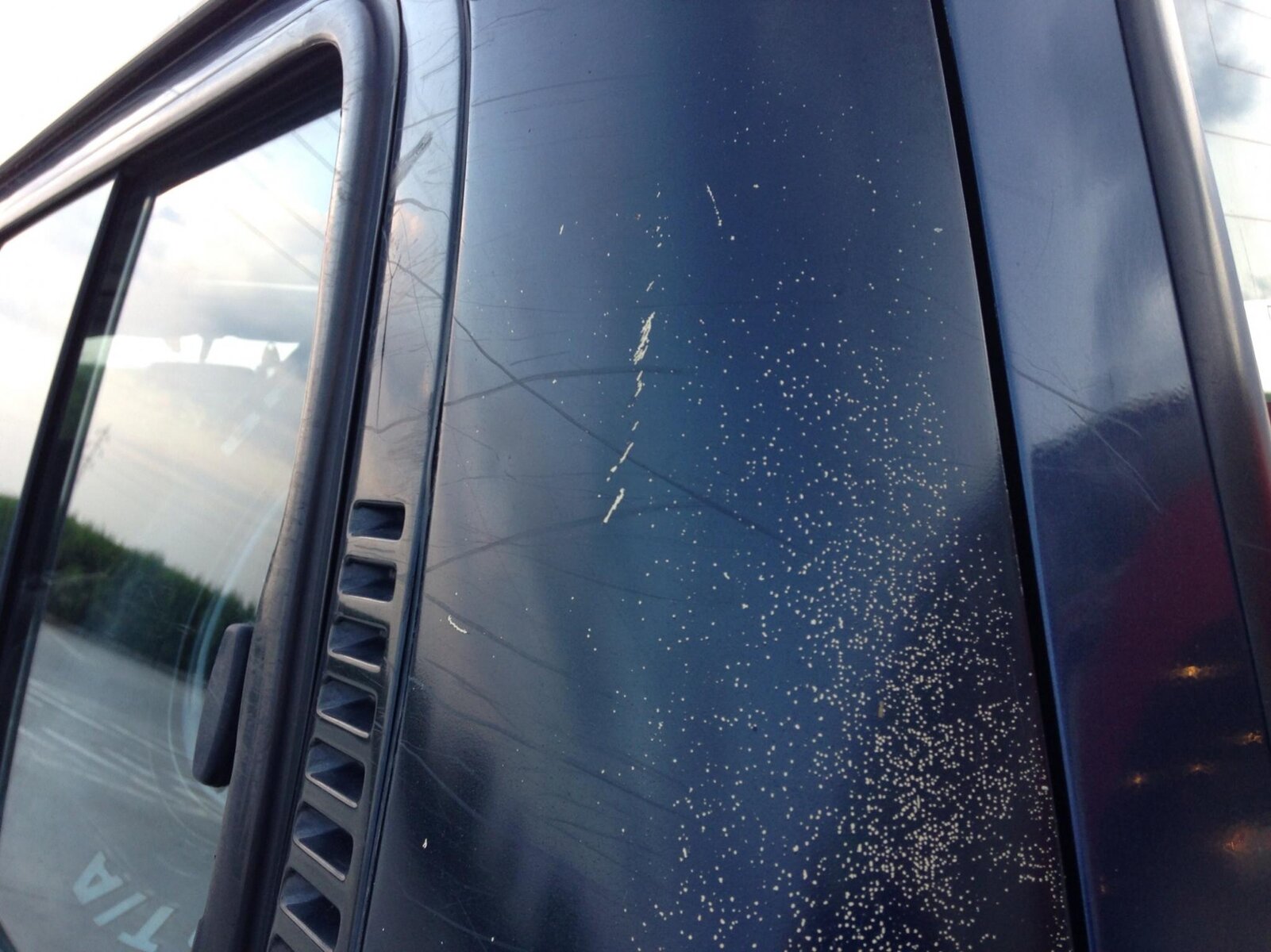

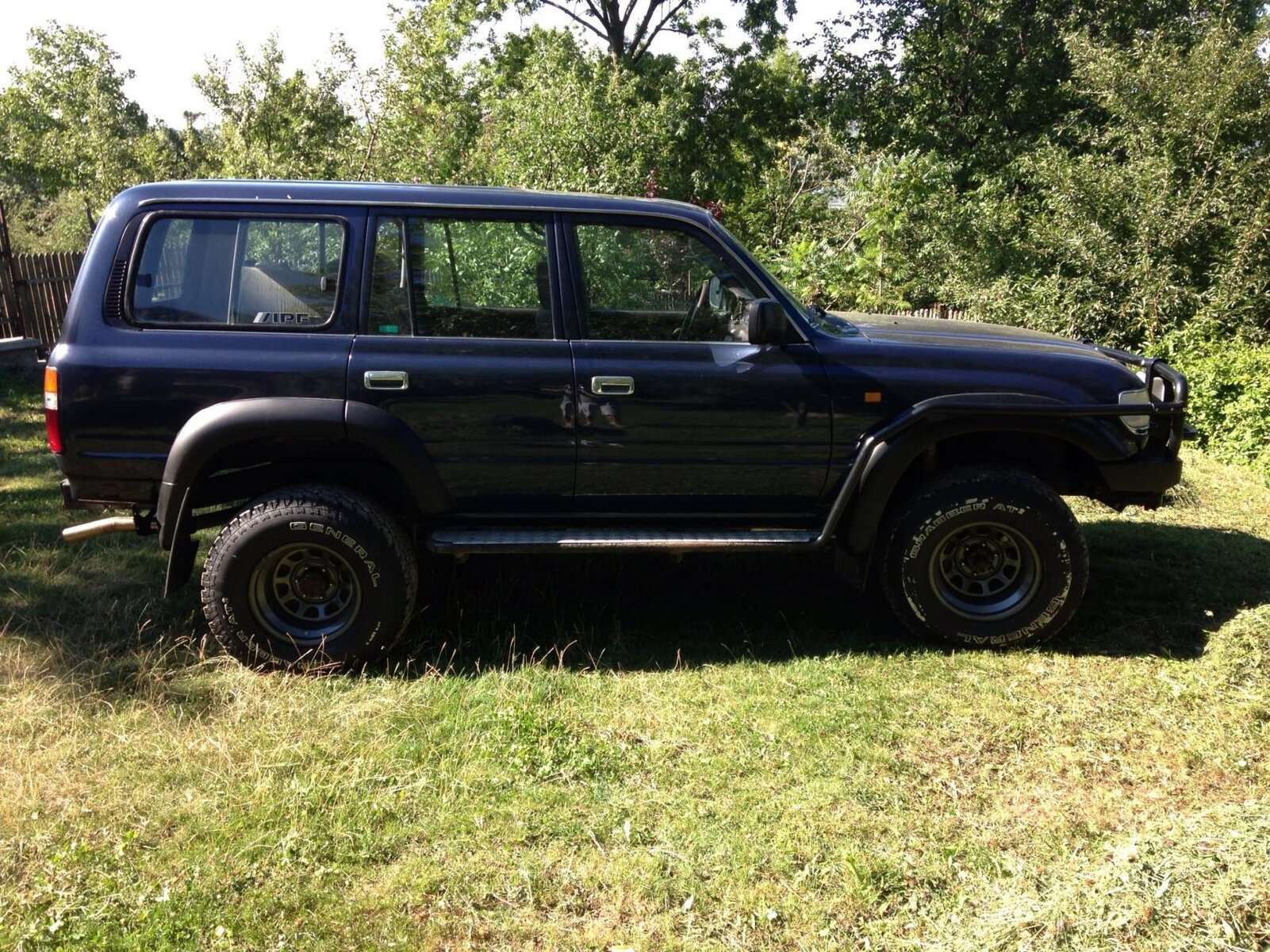

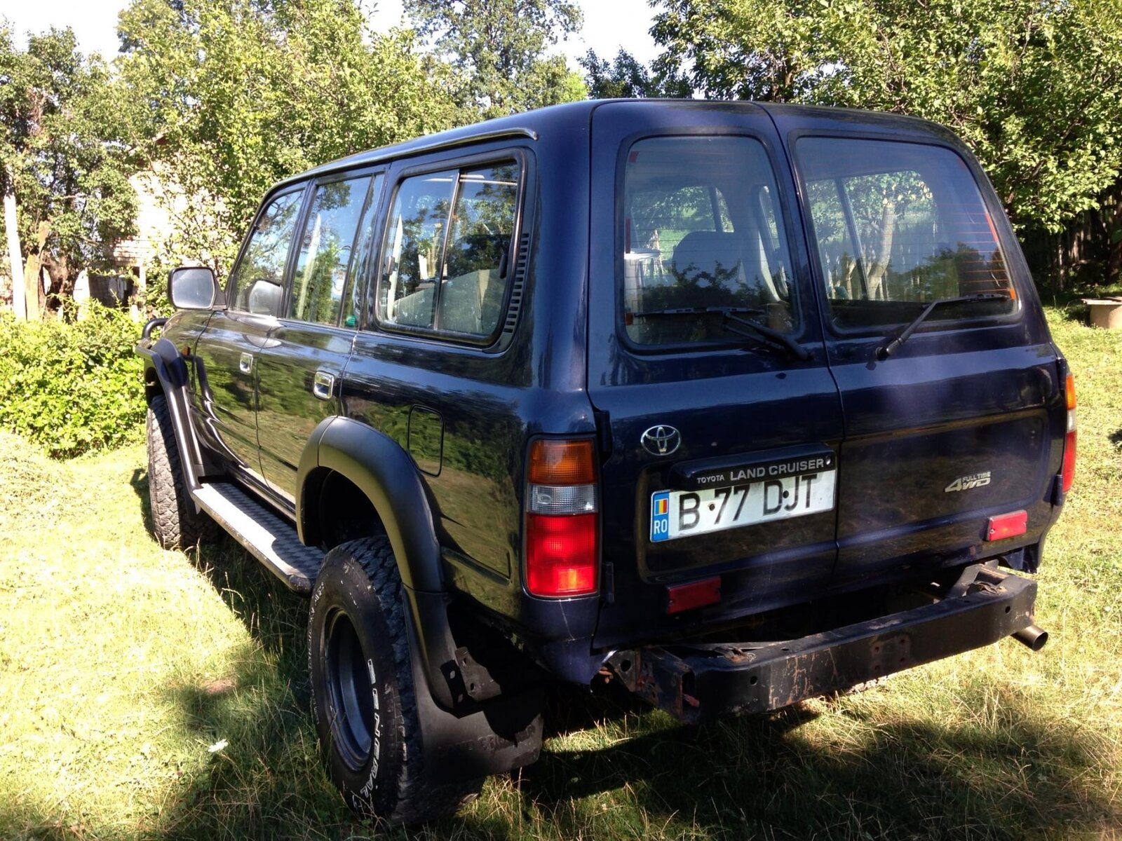

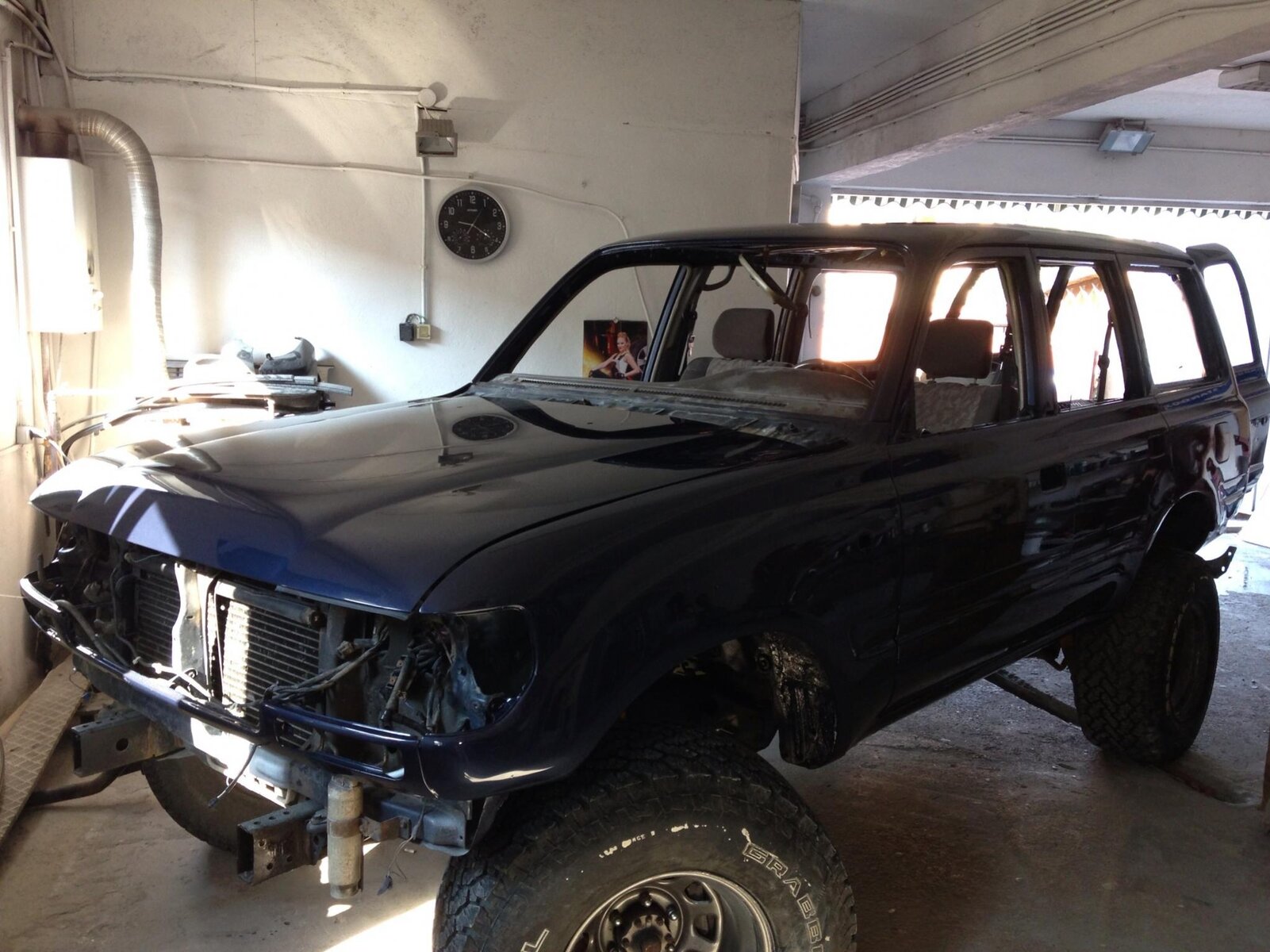

OK, photo time for anyone interested. They're not good pics I'm afraid, it was very sunny and I was in a dark and dusty workshop...

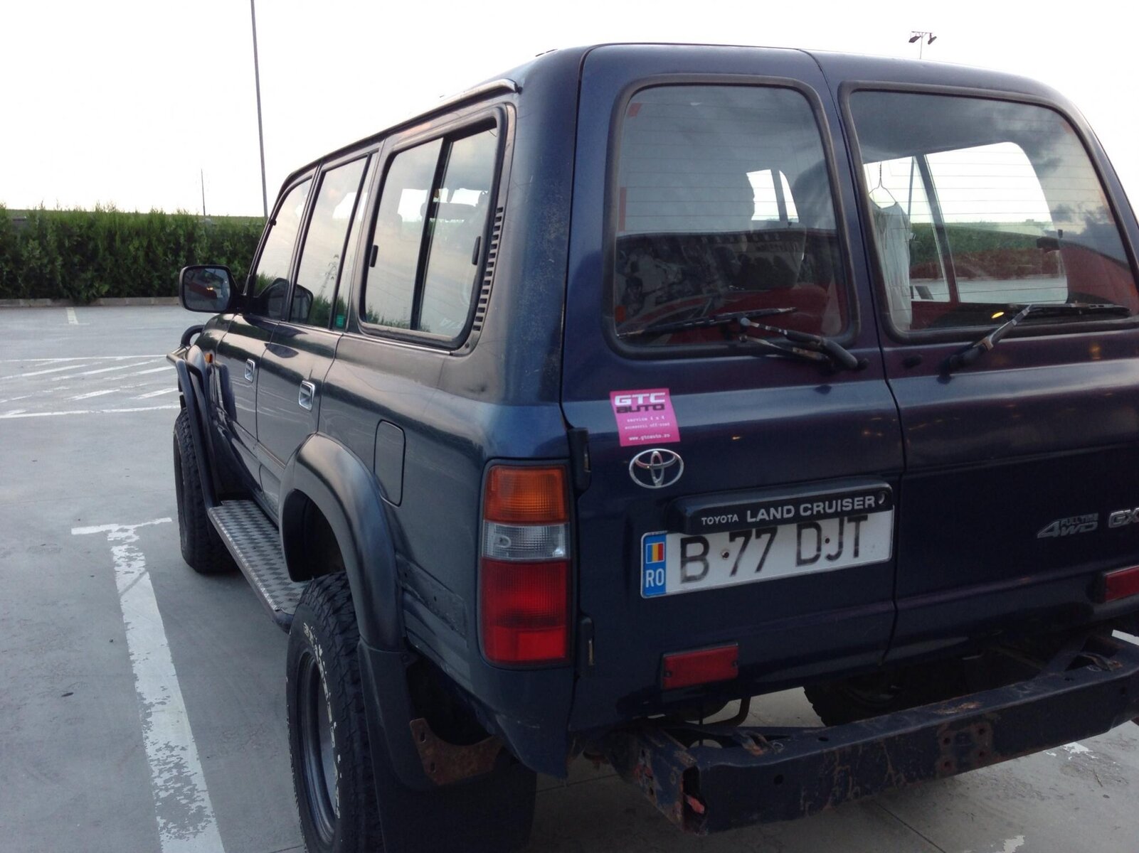

Before the wrap:

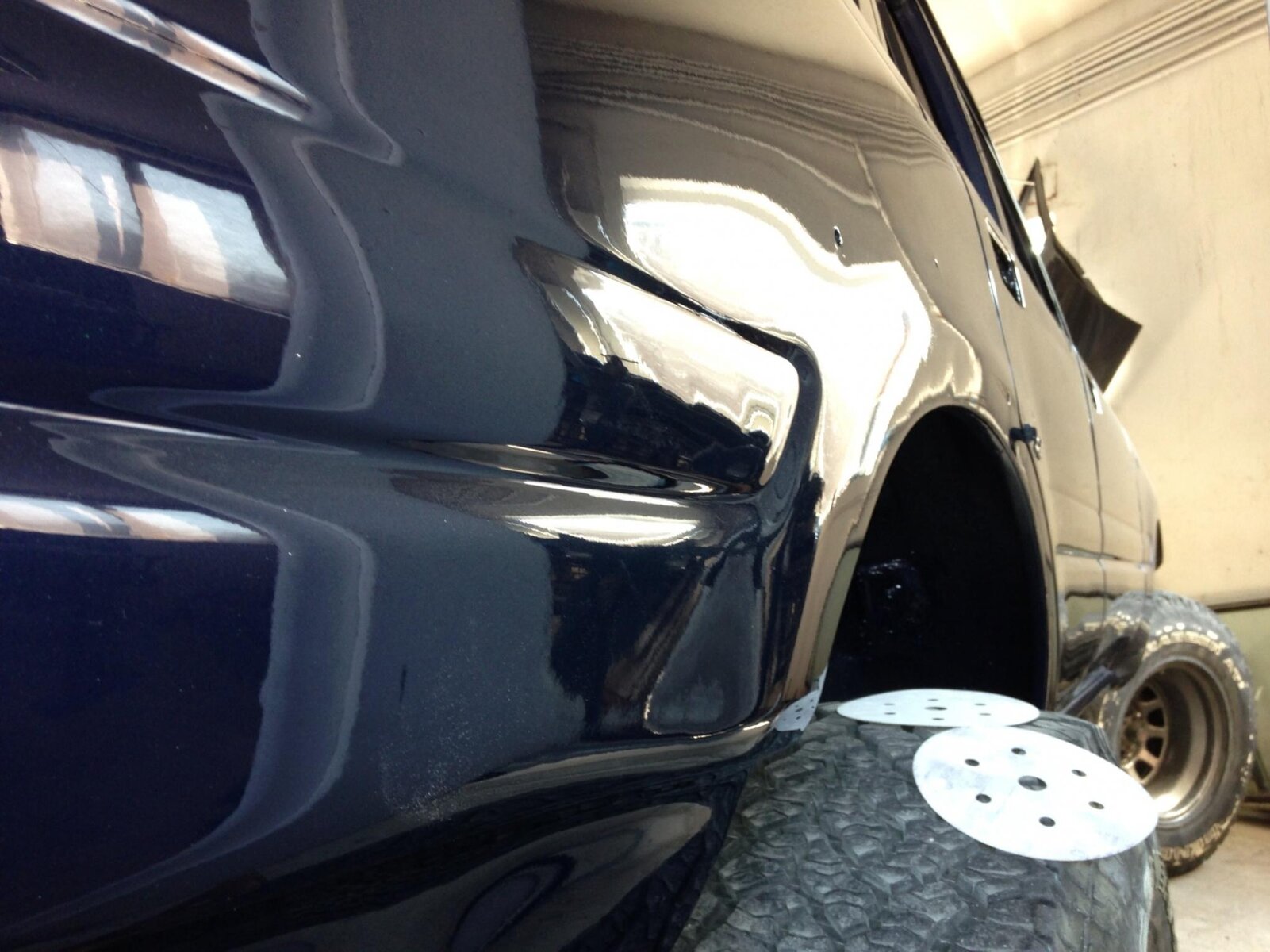

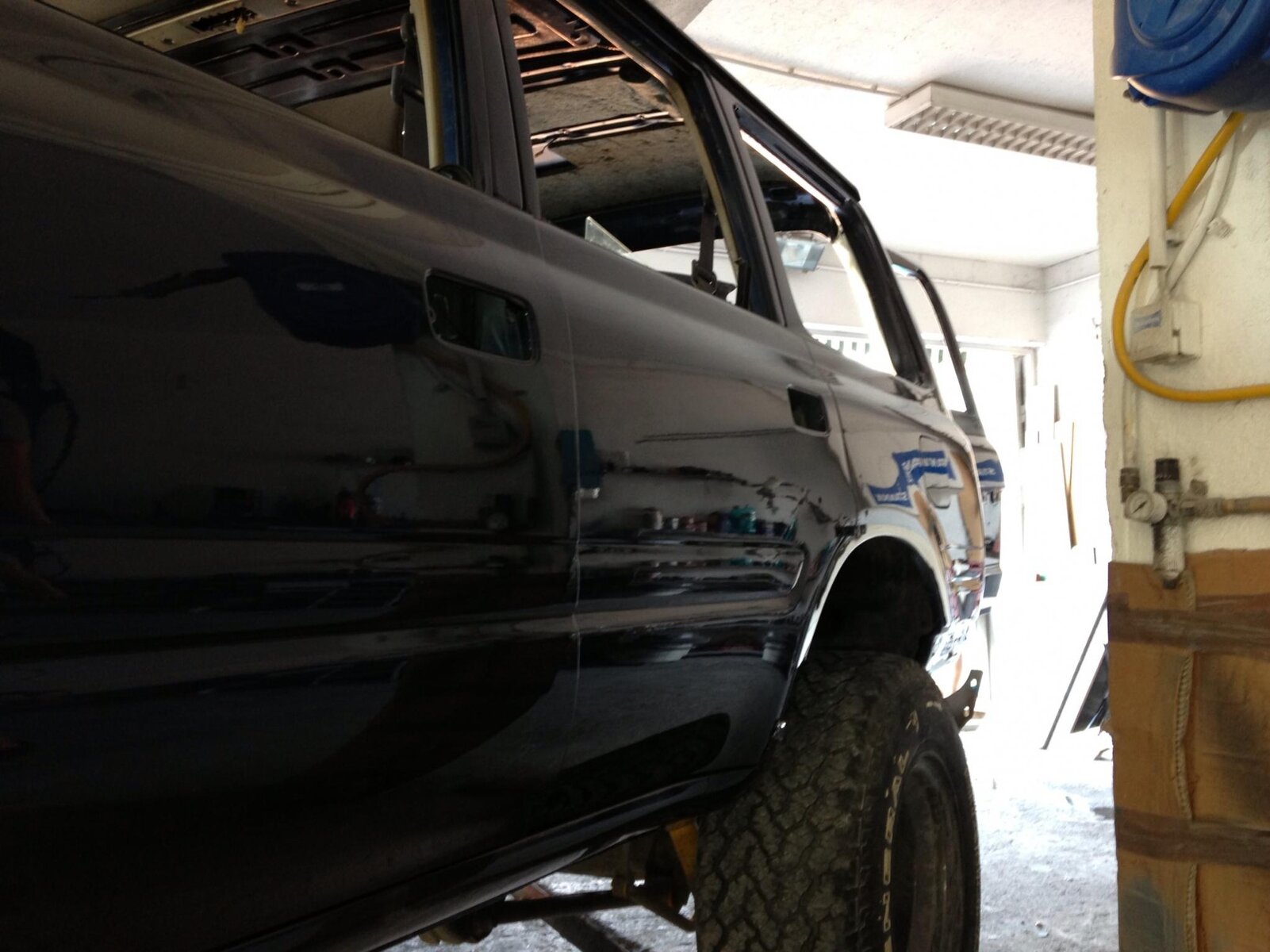

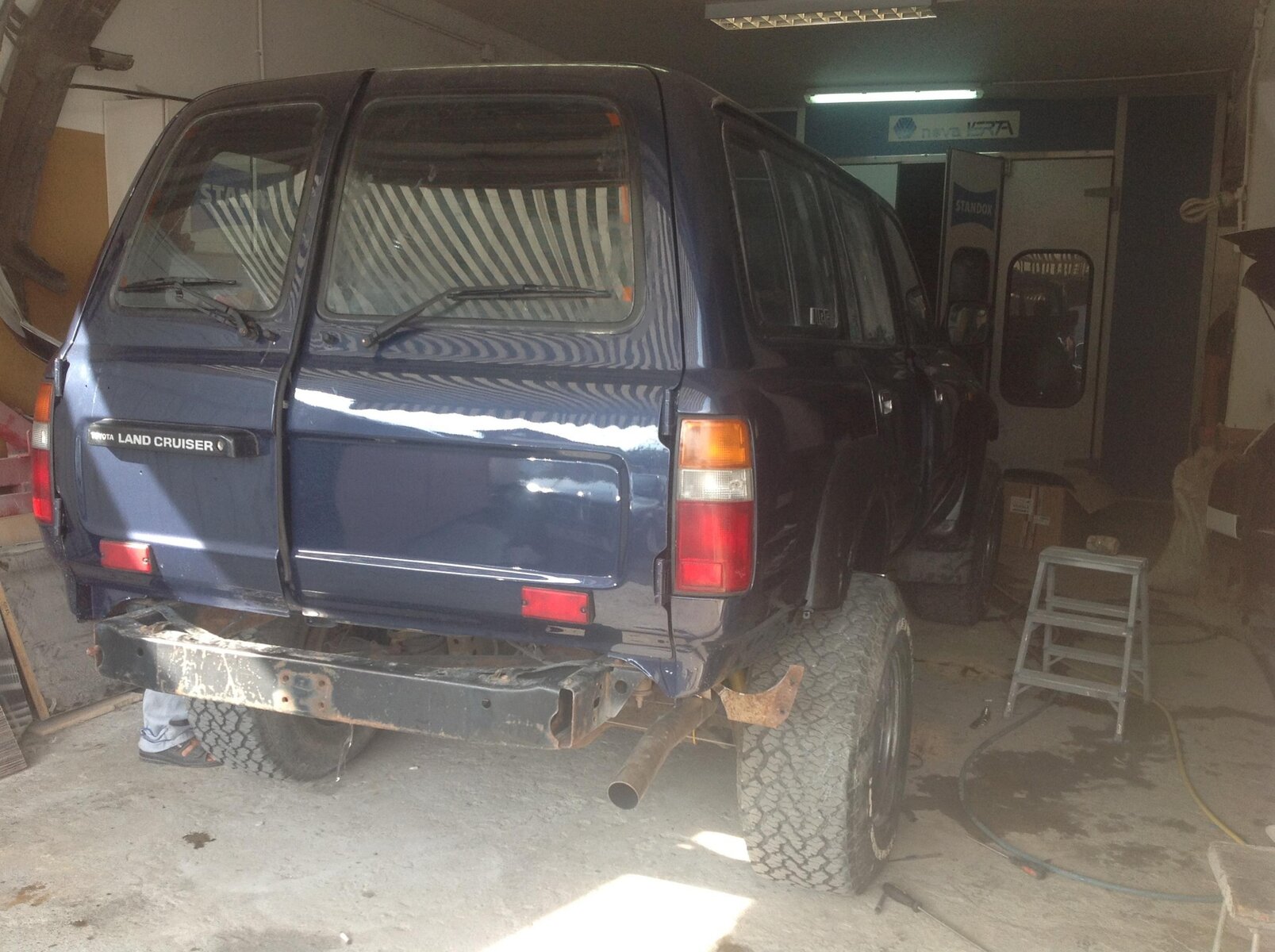

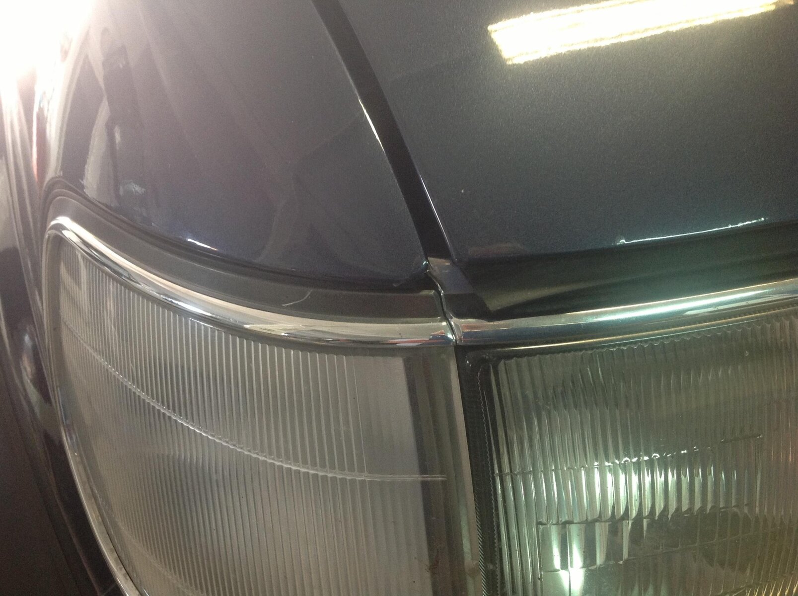

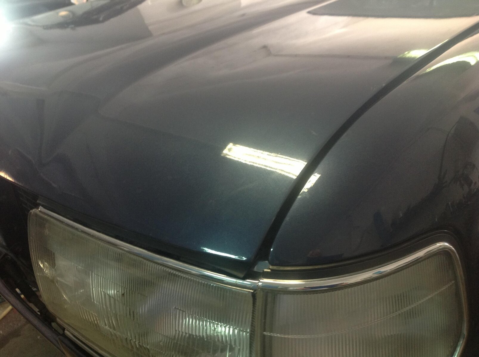

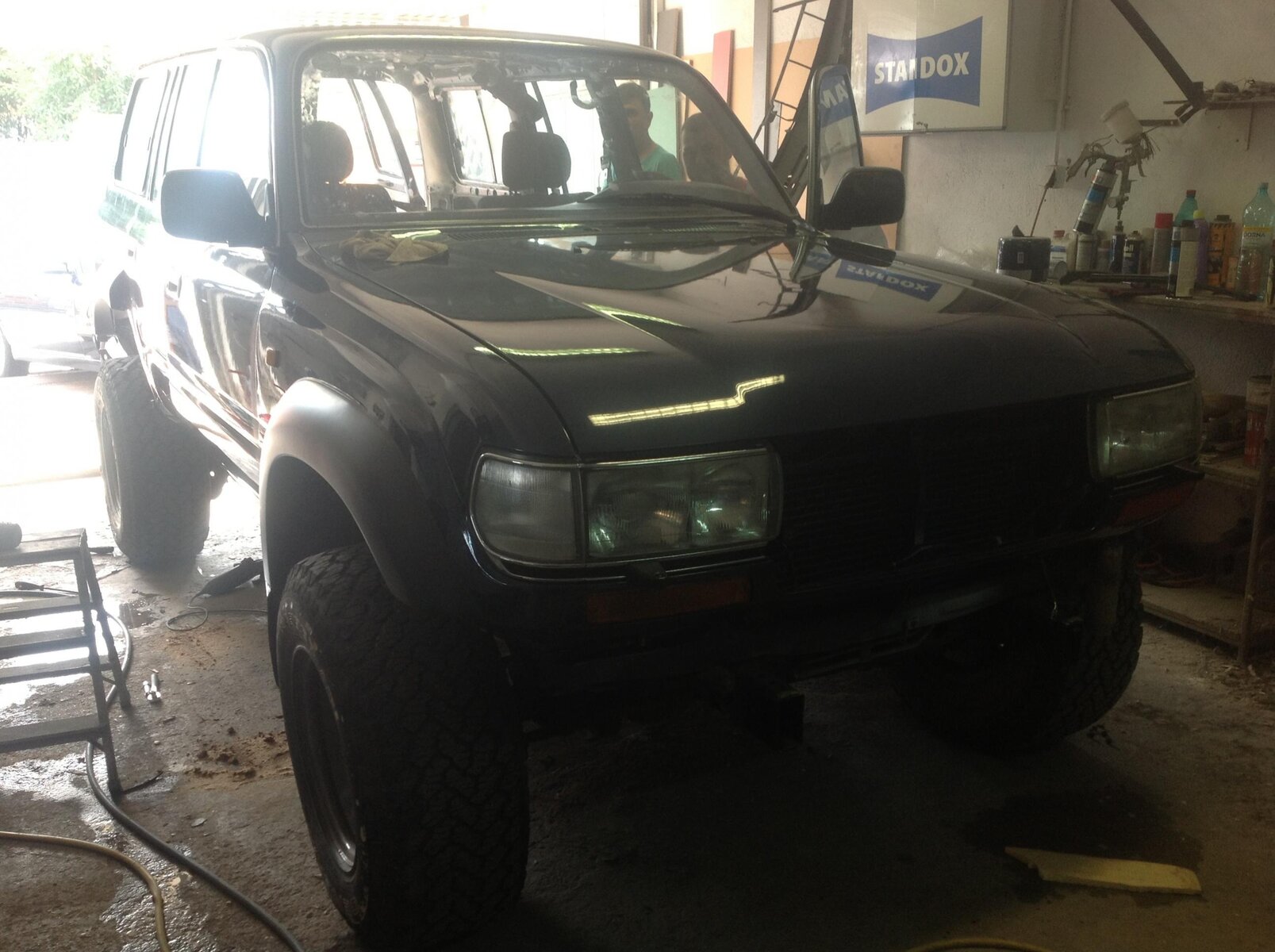

After the wrap:

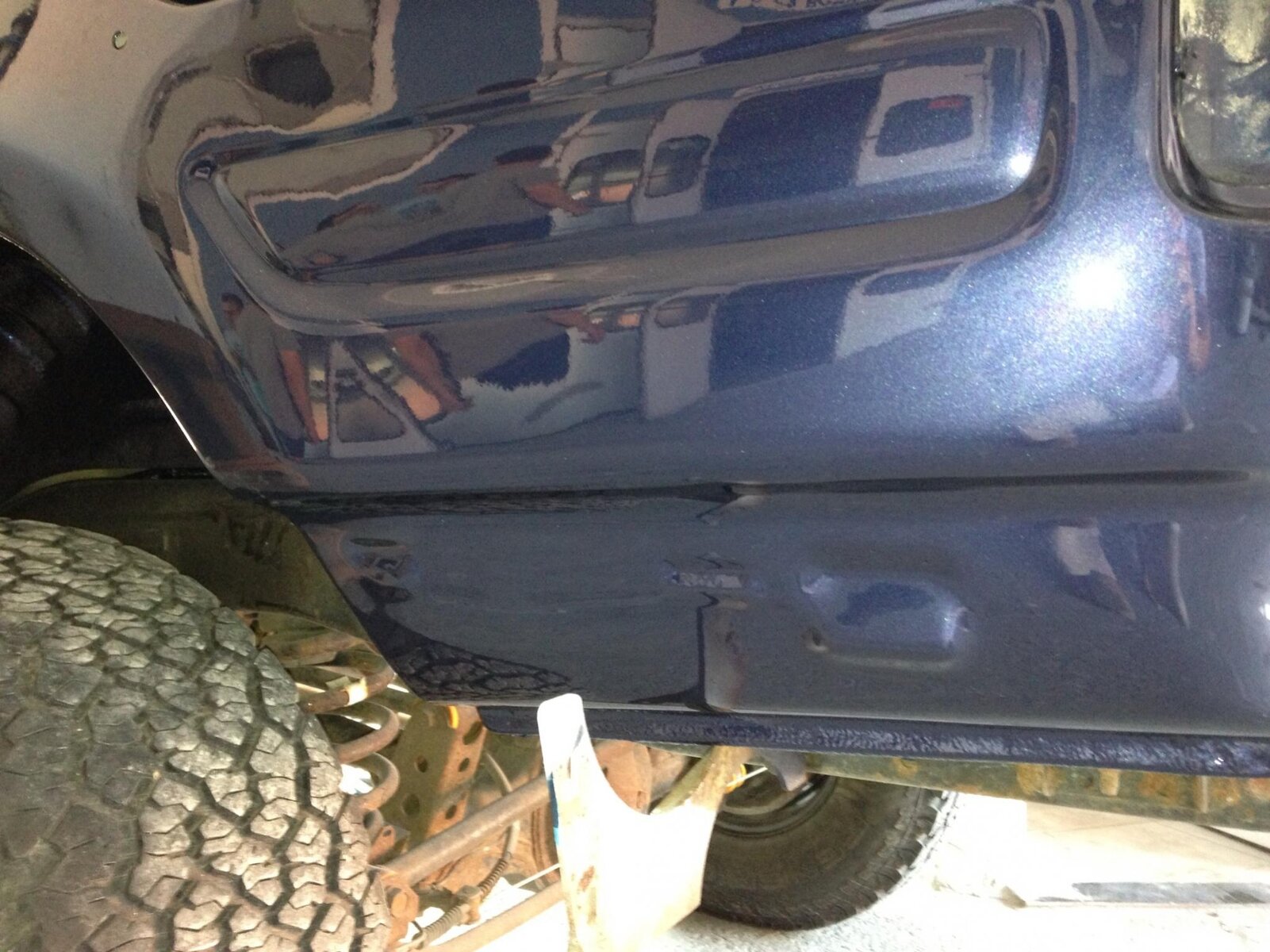

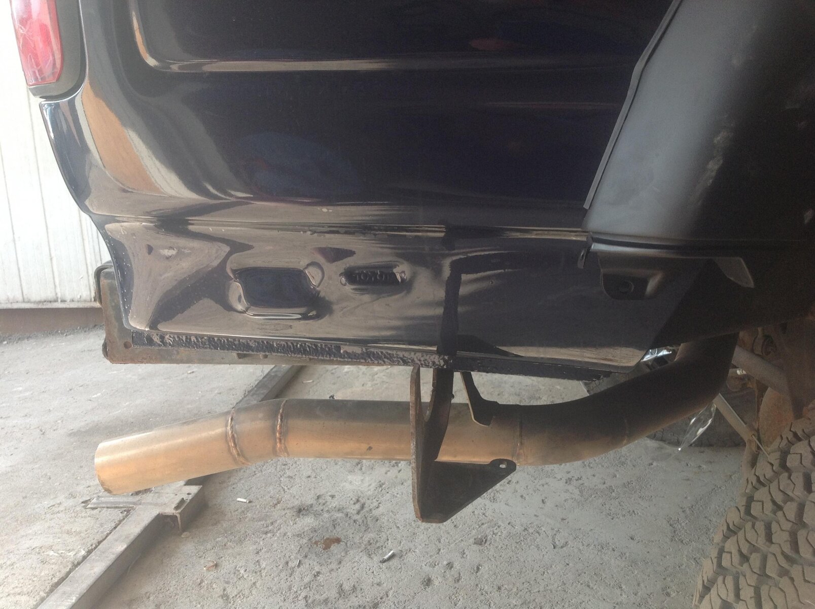

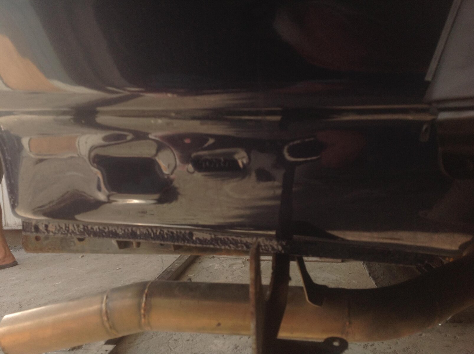

The rear quadrants behind the back wheels had both rotted, this was the only rust on the car. The guy cut out the offending bodywork and welded outer skin, inner skin and repaired the inside curve of the wheel arch closure panel. He did a good job.
The car is still covered with finger marks and sealant smudges and a good deal of anti-rust wax, dust and generally work-in-progress. But he assures me that it will all be back in one piece and clean when he finishes with it tomorrow! :dance:
Apparently, the 200 micron film is a bugger to lay especially on reverse (concave) curves in the bodywork. There are some small areas where I can tell he struggled, there's a few tell-tale finger marks on the sticky side of the wrap. But never mind, it's such a difference from before that I'll let them off.

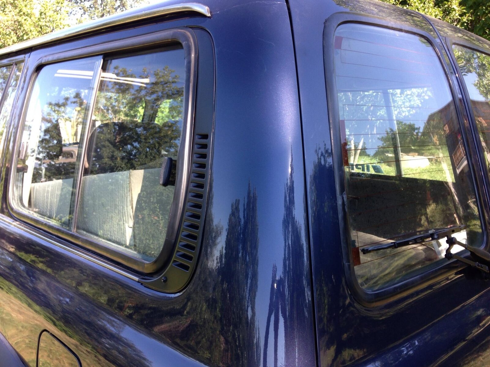

The guy did a great job on the body repairs. The rear O/S (sorry left side it's a LHD) pillar had filler in I know, but he fetched it all out, all inch and a half of it! :wtf: He cut the inner pillar panel out to get at the back of it and brought the dent right out to profile. Then he repaired the inner skin again so you couldn't even tell he'd cut it out. If he hadn't shown me I would never have known.

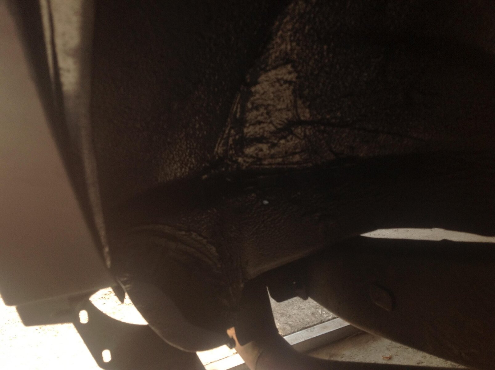

He also stripped and re-loaded the wheel arches with black rubberized protection and then over-sprayed it in blue!

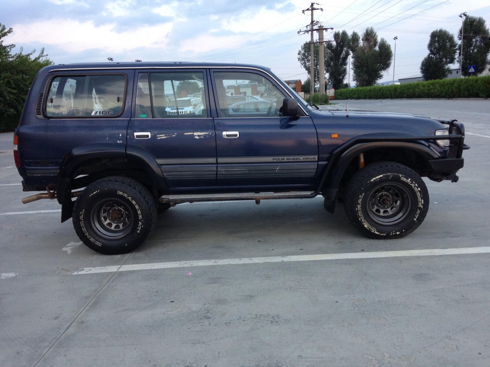

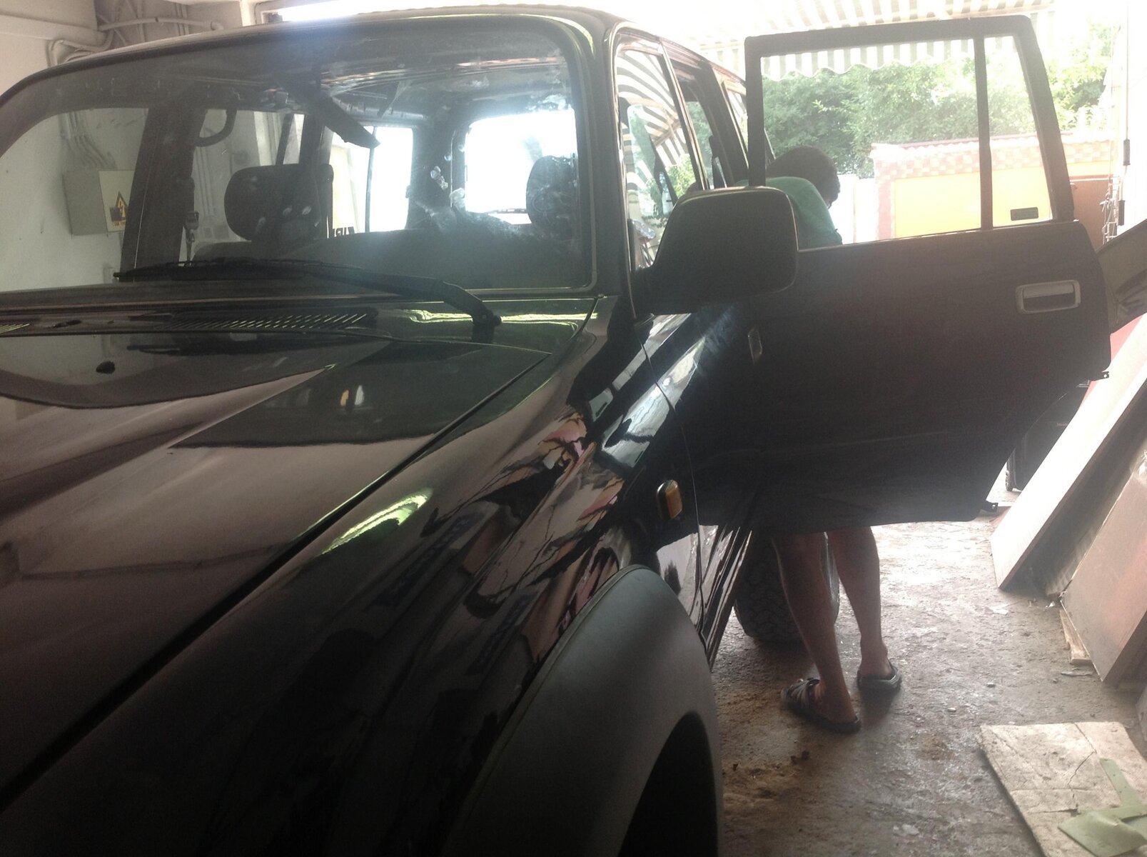

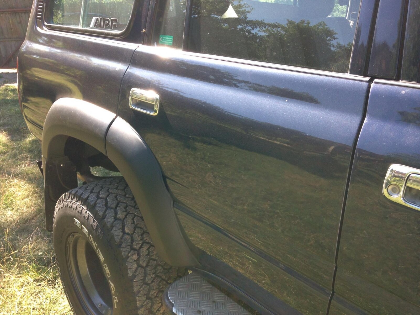

For those who aren't totally bored with this, some before's & afters:
NS view:
Before
After
Rear OS pillar:
Before
After
Rear OS Pillar close-up:
Before
After

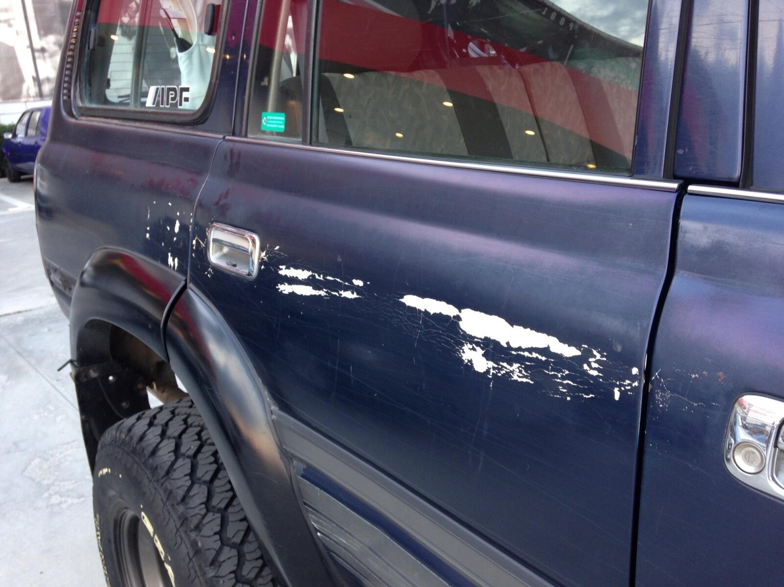

Rear NS passenger door
Before

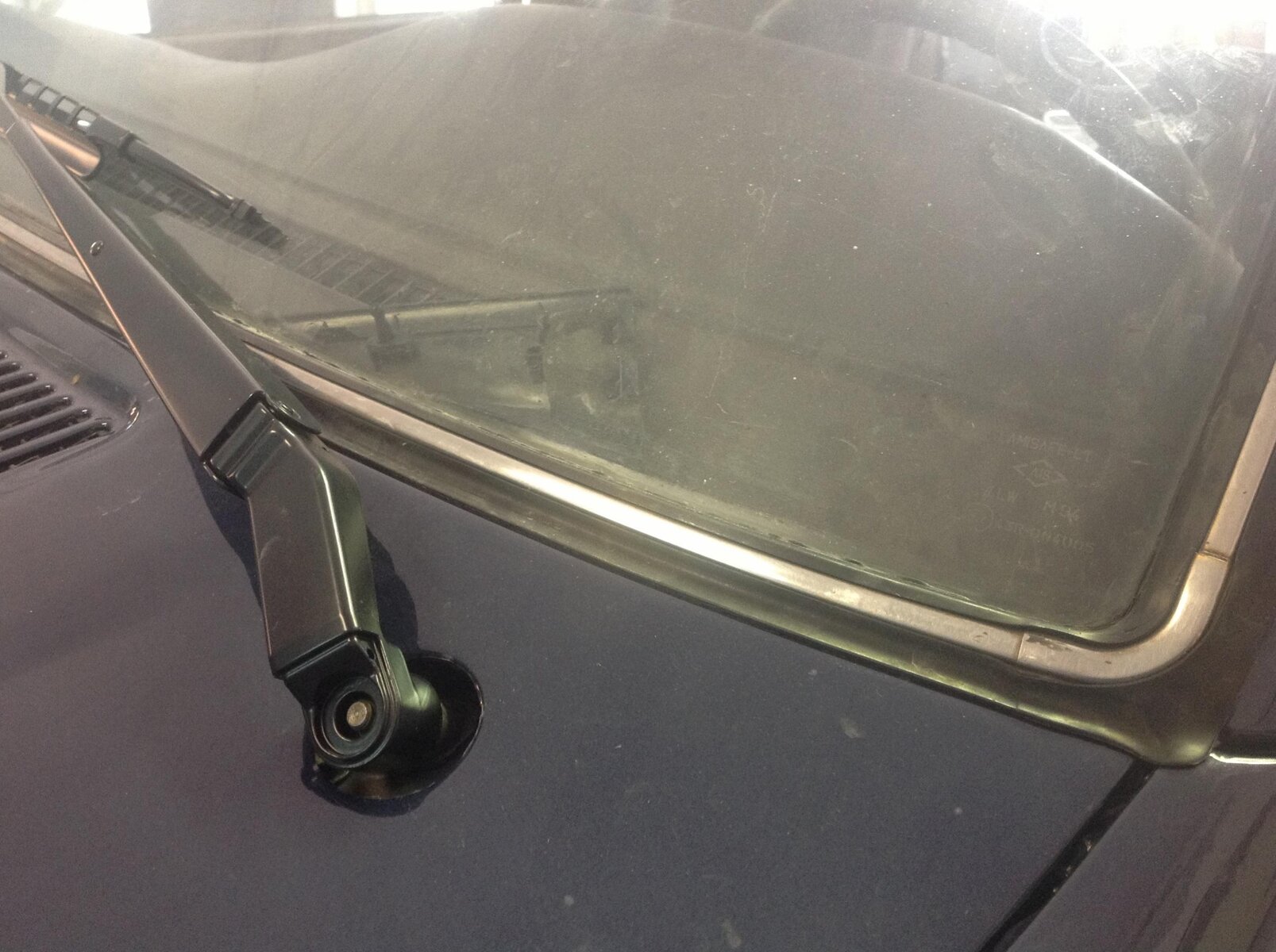

(i) Replacement front wiper arms (the old ones were corroded onto the splines ant they had to cut them off including the retaining nuts). They left them for a week with plus-gas, but still wouldn't shift. They were Mr T replacements cos of the lack of 80s in scrappiest here. Approx price £220 equivalent.
