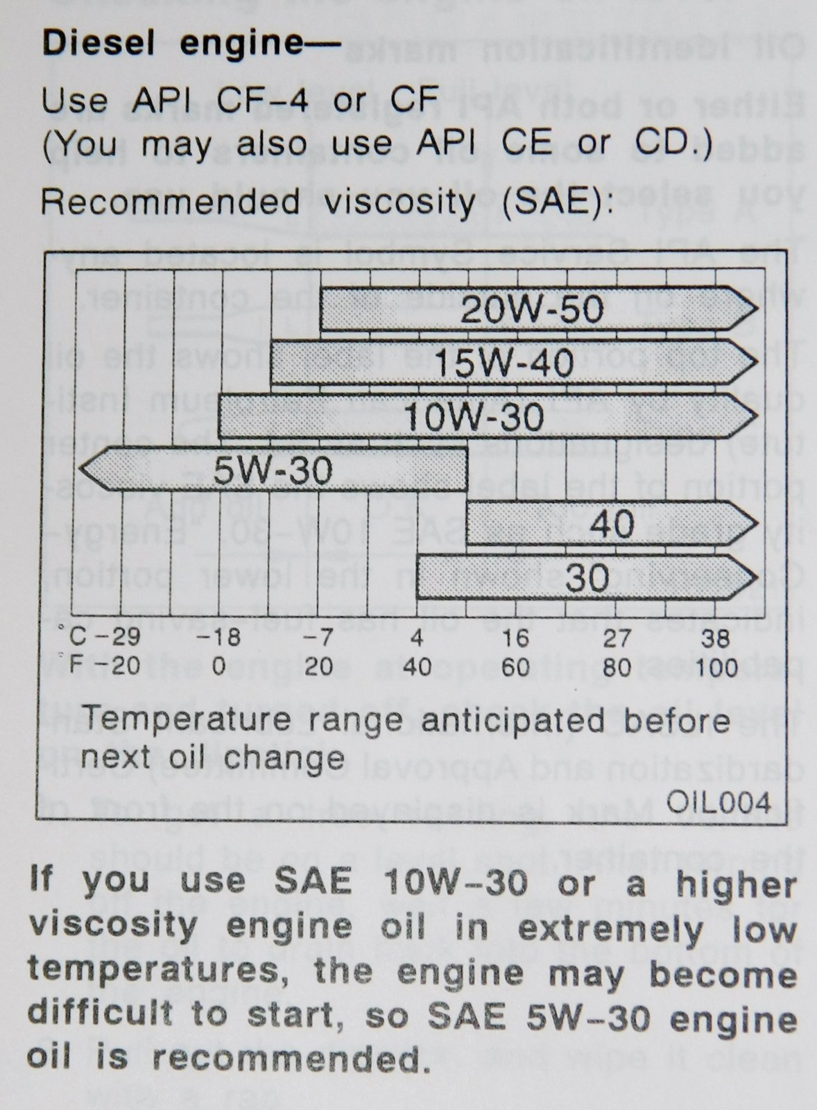

Not sure about the dipstick, it looks right, I filled with 8L of Toyota 10W40 oil (sent by roughtrax with their service kit) and it reads full on the dipstick. Is that going to be too viscous when cold?
Temperature wise here it's not uncommon to be -30C at winter, so far it's been -15C most nights, days it gets over freezing sometimes.

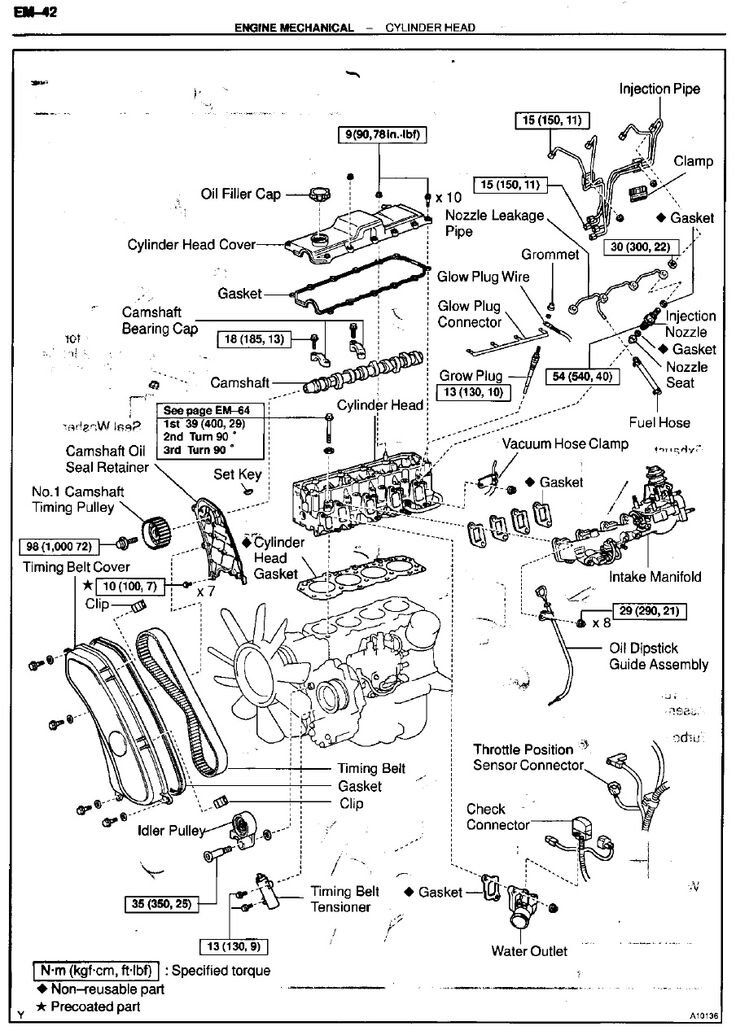

As for the clip I found in the sump here's a shot.
Yeah that's a good question. I know the head's been off before so hopefully it was something that was dropped in, as opposed to something that should be inside the engine.
When I got the sump out properly I found another large bit of the same plastic, I suspect there were some bits too to complete the piece but I didn't strain the oil.
Anyone recognise it?
The half moon cap thing fills in the space at the back of the head behind the camshaft.
