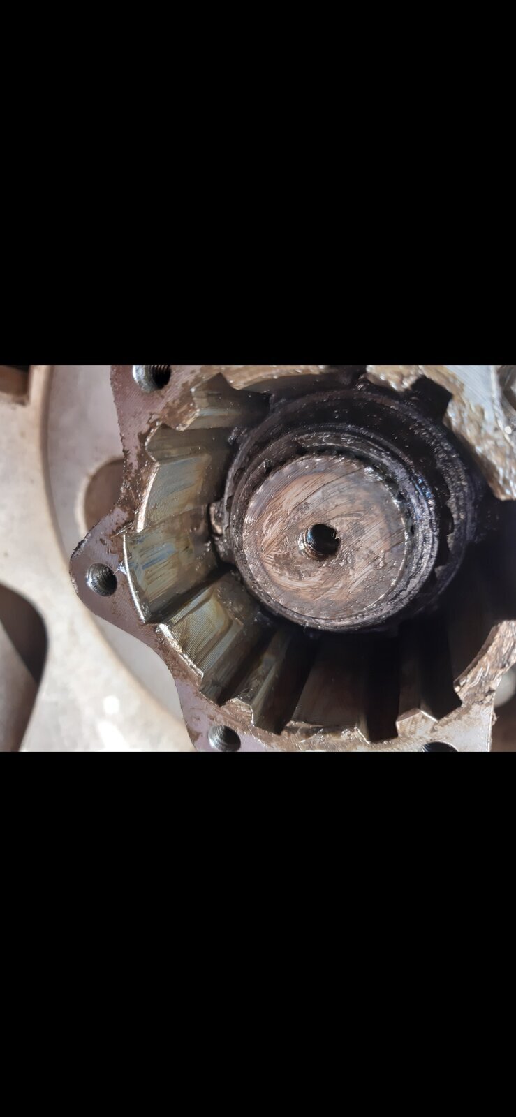

Hi Tel Boy, I waw waiting a long time for the 54mm socket, so I jumped into it today. I removed the both 54mm nuts but I can not remove the rotor/disc. I can see the wheel bearing but I can not pull the disc out. It there something more to release? Can you help me where is the problem? Thanks
Edit: no result after hours of effort by a rubber hammer, the rotor stuck on the spindle. What can be there stuck, the bearings?

I have never seen one stuck in place like that and I can't think what could be holding it on. I can see from your photo there is nothing holding the hub in place, the numbers on the bearing race are visible. Normally a quick wiggle on the disc and the bearing just falls out and you lift off the entire rotor & hub together. Try tapping the bearing race with a rod and metal hammer while you spin and wiggle the rotor, to see if it will come loose. If not, then try walloping it to shock it loose.
If all else fails you might have to make up a tool which pulls on the hub studs and has a bolt to push on the centre of the shaft. An easy thing to make up if you have a few bits of angle bar lying around the garage, a drill, a nut & long bolt and a welder.

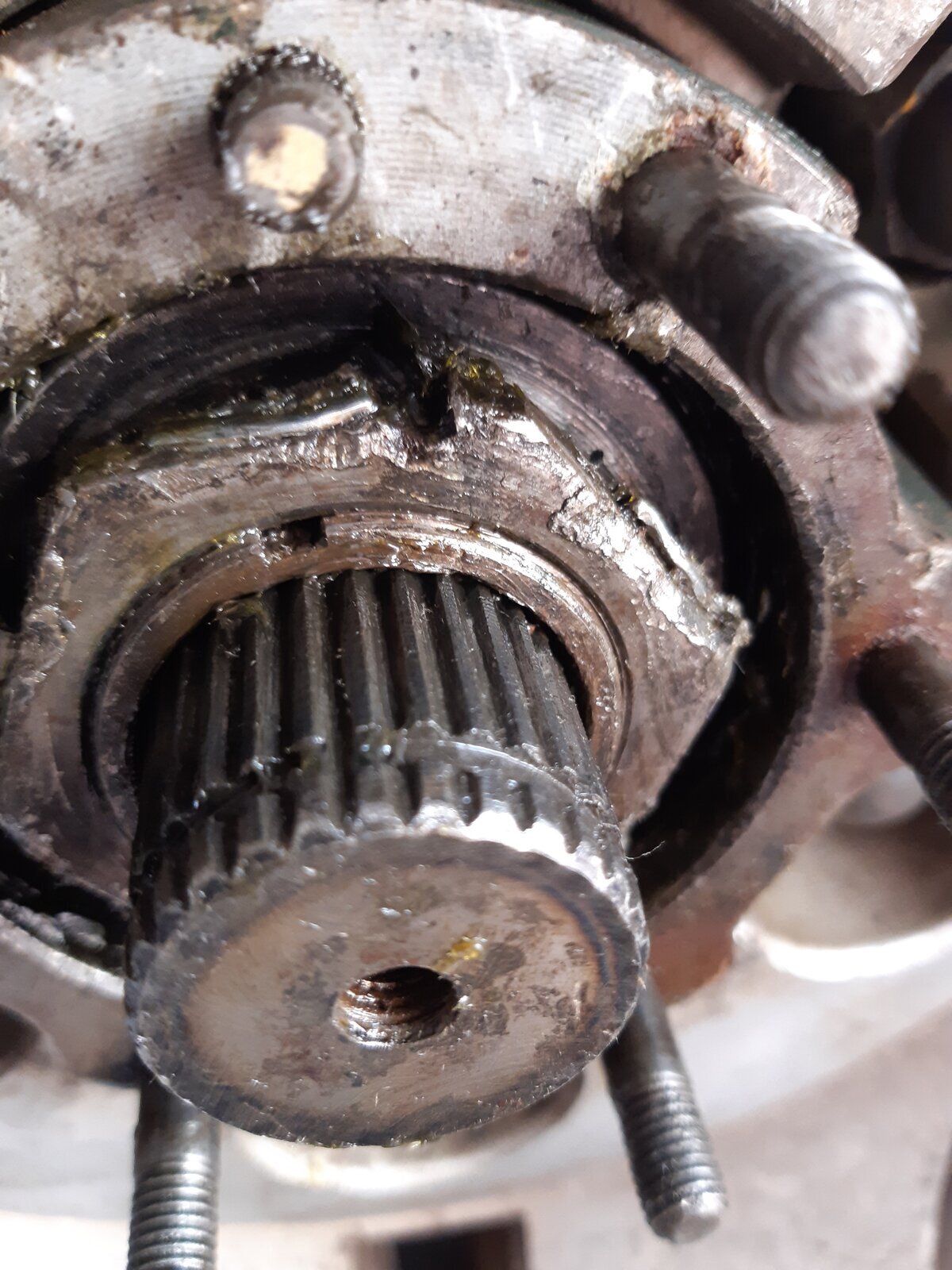

So I did the other side as well. This time the rotor and the bearing went out very easily. The only problem I had were the upper studs. When tighting the nuts these studs were comming out from their threads, so it took me a while to tighten them.
I replaced the other rotor as well, now the car goes straight when breaking.
I 'm watching some photos from when I was previously working on the "squeaking" side, see attached. You can see some rust on the spindle, mixed with grease. I wonder if this could also have caused some squeaking.
So now the knuckle bearing's and squeaking story is over, thanks again for your big help, and I can start working on other issues.

Hi Dalky, you have been busy. I am glad to hear that everything went well. I don't know about rust causing the squeak but I do know that rust is a not a good thing to see in your hubs. Water has got in, the seals had gone, so it's good that you have rebuilt the hubs now.
