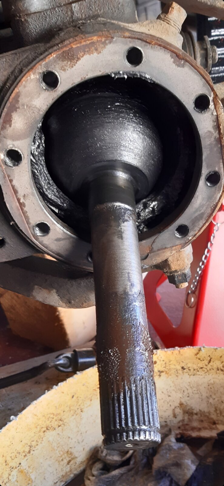

Hi Tel Boy, I waw waiting a long time for the 54mm socket, so I jumped into it today. I removed the both 54mm nuts but I can not remove the rotor/disc. I can see the wheel bearing but I can not pull the disc out. It there something more to release? Can you help me where is the problem? Thanks
Edit: no result after hours of effort by a rubber hammer, the rotor stuck on the spindle. What can be there stuck, the bearings?

I have never seen one stuck in place like that and I can't think what could be holding it on. I can see from your photo there is nothing holding the hub in place, the numbers on the bearing race are visible. Normally a quick wiggle on the disc and the bearing just falls out and you lift off the entire rotor & hub together. Try tapping the bearing race with a rod and metal hammer while you spin and wiggle the rotor, to see if it will come loose. If not, then try walloping it to shock it loose.
If all else fails you might have to make up a tool which pulls on the hub studs and has a bolt to push on the centre of the shaft. An easy thing to make up if you have a few bits of angle bar lying around the garage, a drill, a nut & long bolt and a welder.

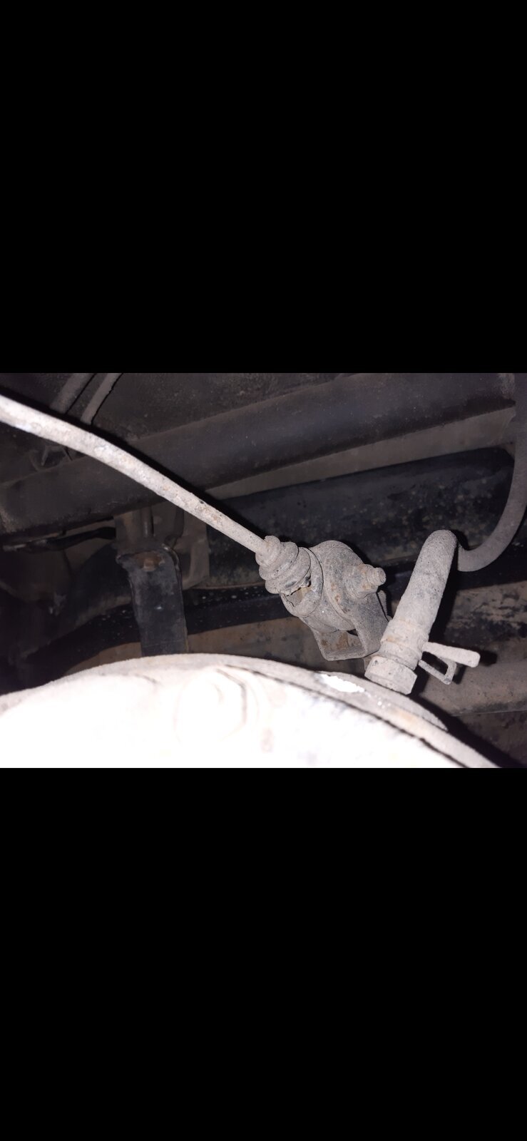

Another thing is that I was checking the whole breaking system. I found one cracked rubber housing, see picture, it´s something with a hand break?

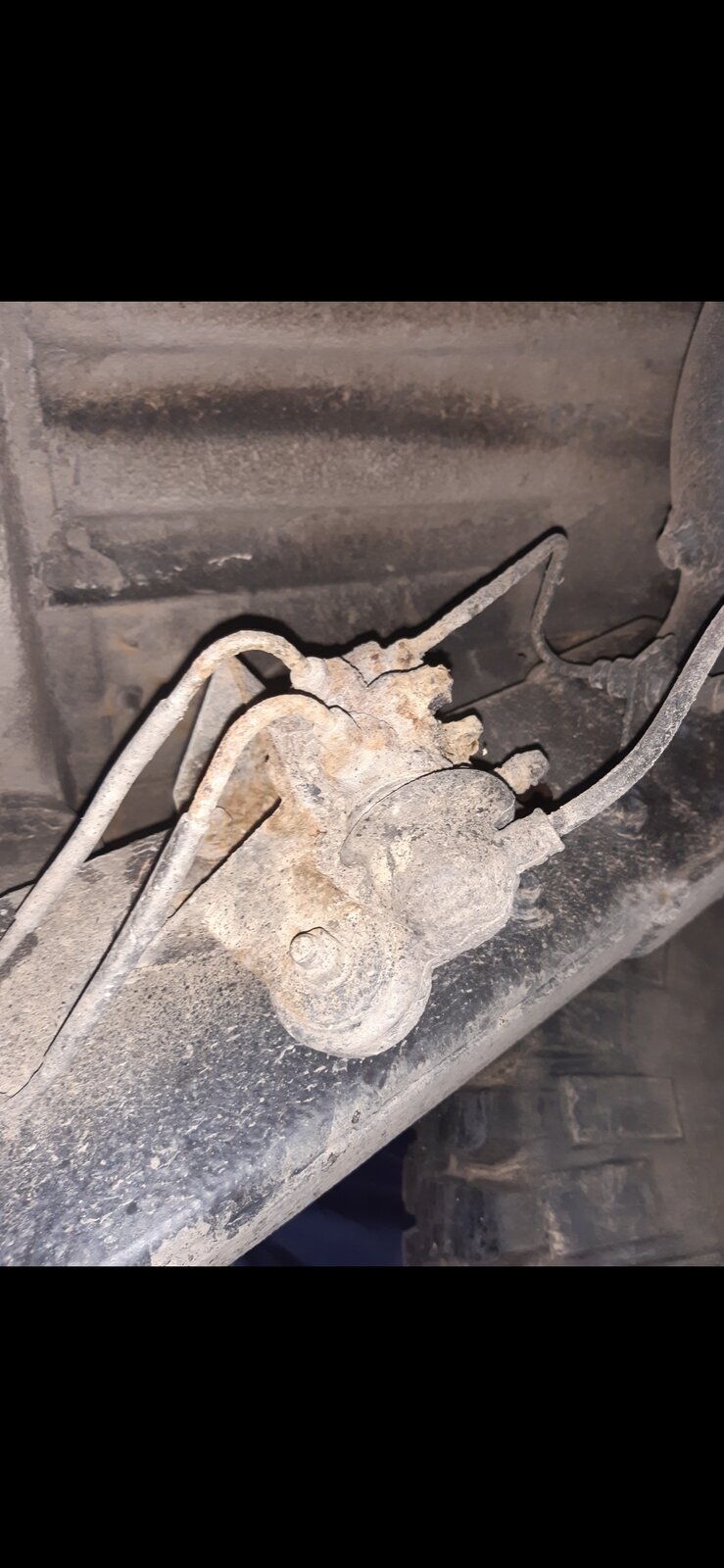

Other picture is a rear break cylinder? The breaklines comming to that cylinder(or what is it) are very rusty (the rust starts 30 cm before the cylinder, untill then they are fine) and I will definitelly have to replace them or a rusty part of them. I can imagine the future, it will be a nightmare to loosen that bolts. I think there is also a bleeding valve(?)... Do you have any experience how to refurbish that thing(if it´s possible).

Your photos of the rear brakes shows the system for increasing brake pressure to the rear when the car is heavily loaded. The first pic is nothing to do with the handbrake, it's just a joint at the rear of the rod which measures how high the axle is relative to the body. The higher it is the heavier the load and the more pressure goes to the rear brakes. Inside the torn rubber cover is just a mechanical rotating joint, no hydraulics and nothing clever. Best to take it apart, wire brush it and make sure it is rust free and moving freely. Then grease it and put a new rubber cover on to keep it clean & dry.
The second pic is the actual brake proportioning valve (or load sensing valve) which adjusts the rear brake pressure. These often get rusted up and seized solid, but your looks like it may be still OK. When you have the rear of the long rod detached, carefully pull off the rubber cover and move the rod up and down. The front end of it moves a cylinder up and down inside the valve housing. Make sure the cylinder is moving freely also, and there is no brake fluid leaking here. If it is stuck with rust and dirt it can be pulled out and the whole thing cleaned up carefully inside the same way you would do with the front brake pistons in the caliper. Of course this is all much easier if you remove the valve from the car first. If you are going to replace the brake lines in that area then you may find it easier to do that.

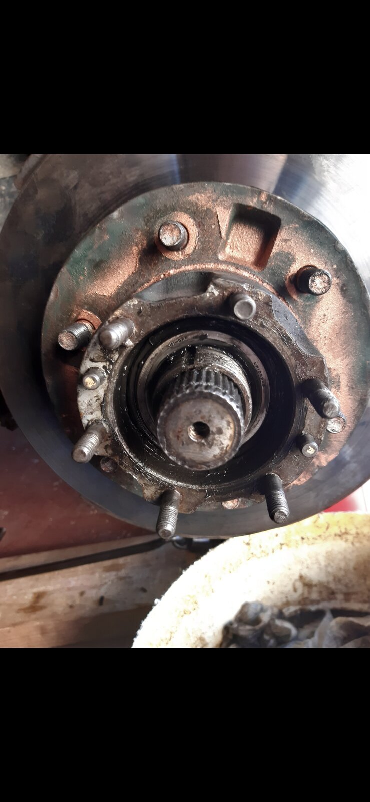

I 'm watching some photos from when I was previously working on the "squeaking" side, see attached. You can see some rust on the spindle, mixed with grease. I wonder if this could also have caused some squeaking.

Hi Dalky, you have been busy. I am glad to hear that everything went well. I don't know about rust causing the squeak but I do know that rust is a not a good thing to see in your hubs. Water has got in, the seals had gone, so it's good that you have rebuilt the hubs now.
