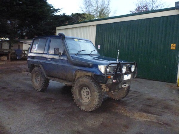

The first job was to get all the mud from Bunyip Forest washed off LJ.

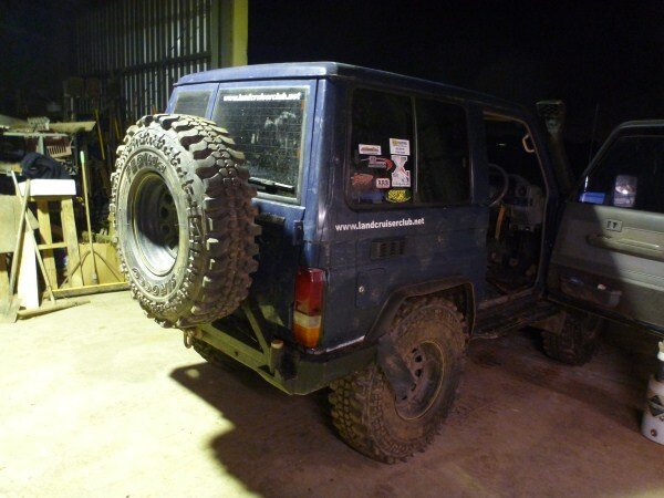

So early one morning before work last week I got LJ round to the workshop ready to be cleaned.

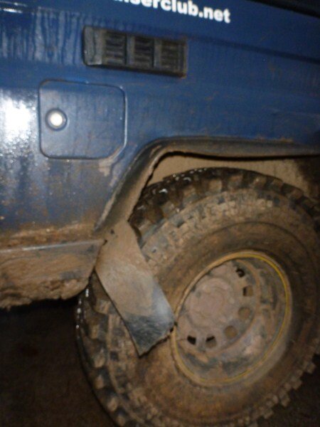

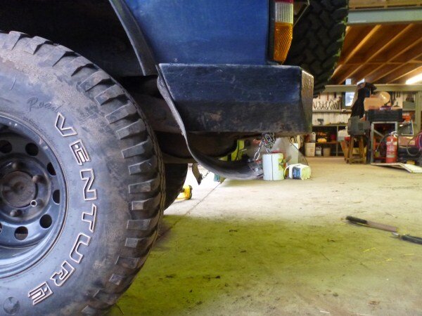

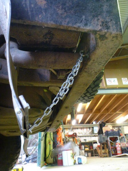

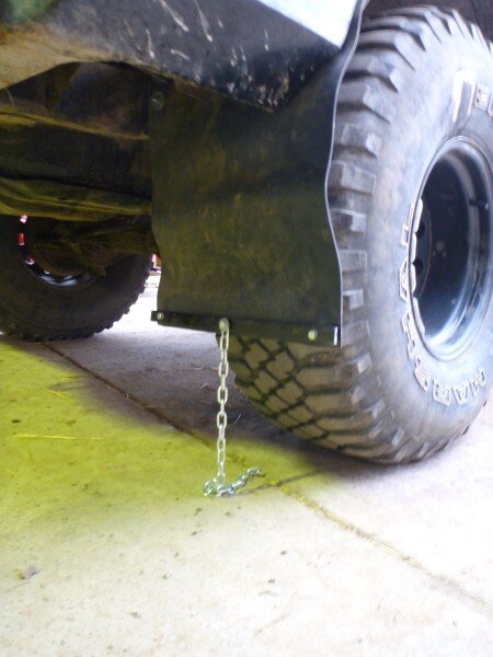

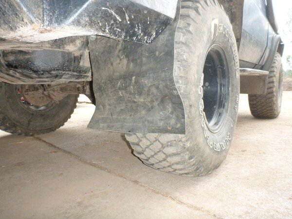

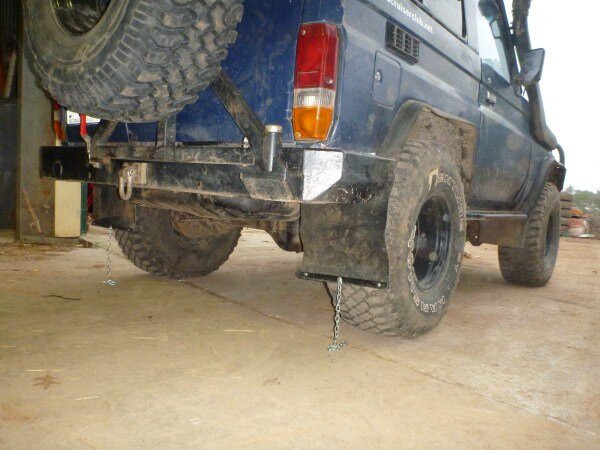

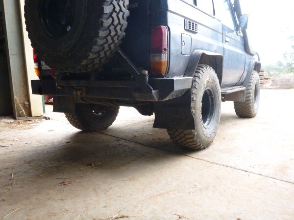

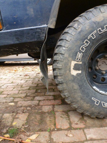

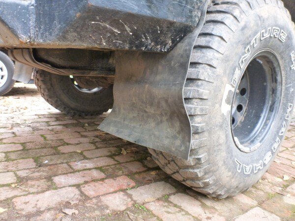

The drivers side rear mud flap was torn and hanging off, but more on that later.

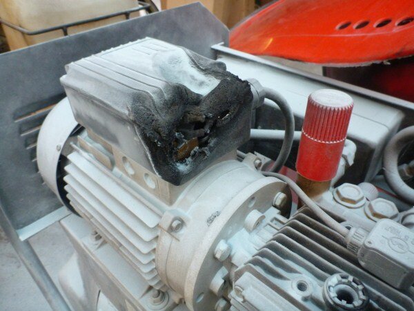

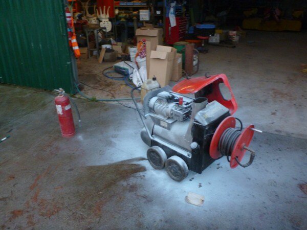

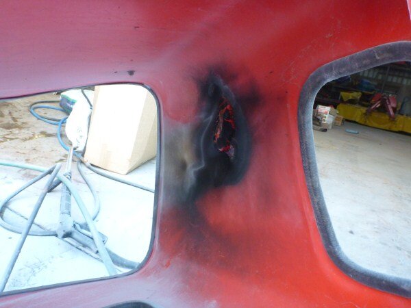

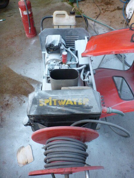

Halfway through the wash the pressure wash stopped working. :?
When I walked into the workshop I found black smoke billowing from the pressure washer. :shock:
I unplugged it and dragged it outside and emptied half a fire extinguisher over it. After lifting the cover off it was clear which bit had been on fire.
Melted the cover a bit.
My boss wasnt too impressed, but he understood it could have just as easily have happened to him. :|

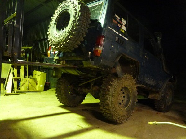

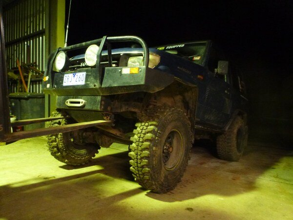

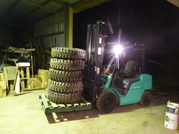

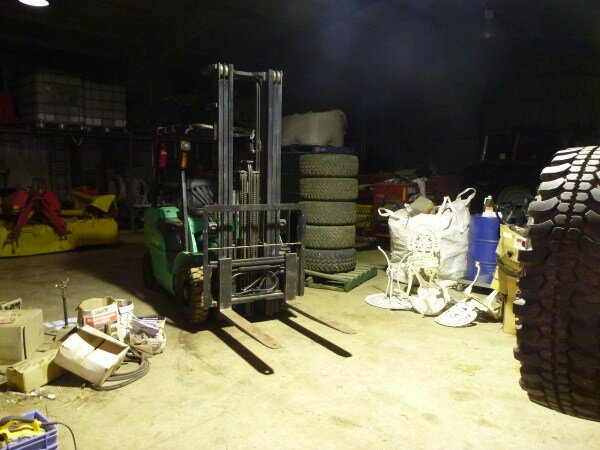

So that night I made a start. The plan was to change all the tyres and put the 35"s back on and while changing the tyres I'd get the pics and measurements for Chris. :icon-smile:
I brought the tyres in with the forklift.

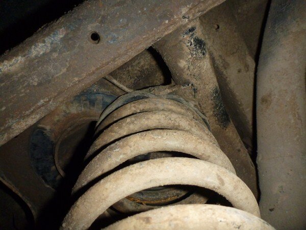

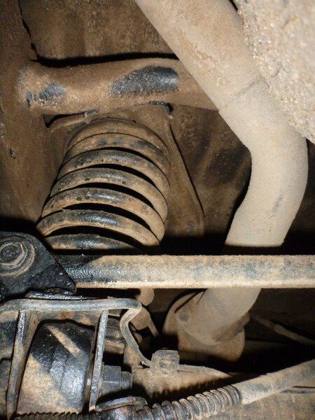

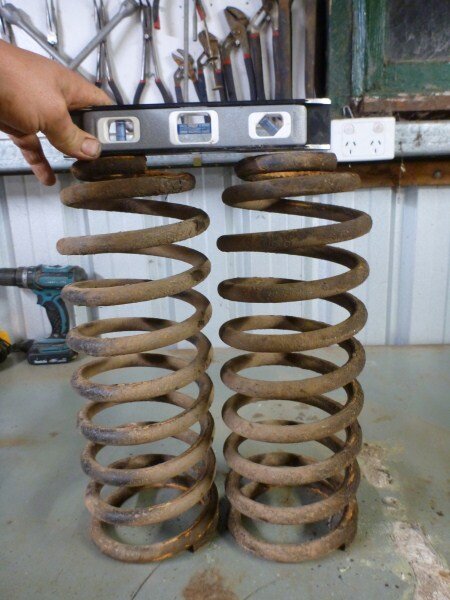

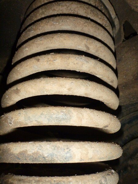

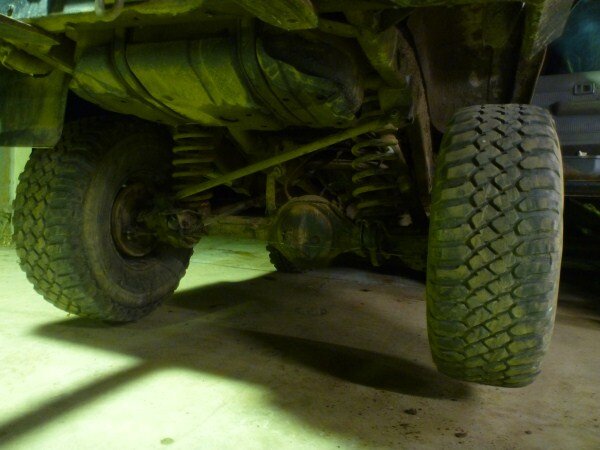

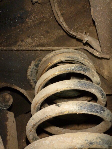

I took a pic of the springs to show what there like when the truck is sat on the ground.

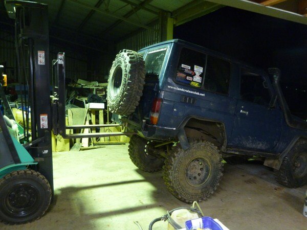

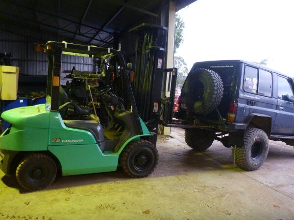

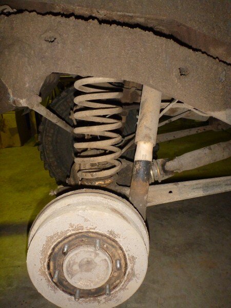

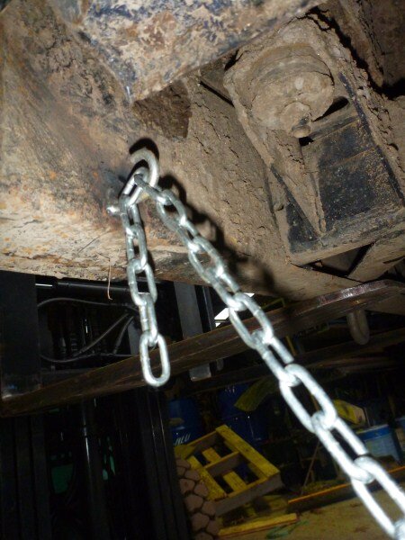

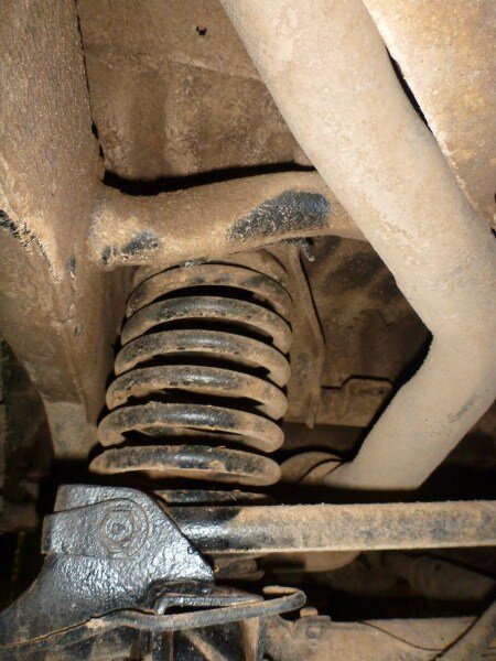

Not wanting to mess around with trolley jacks and axle stands I thought it would be much easier to use the forklift.

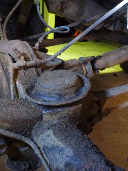

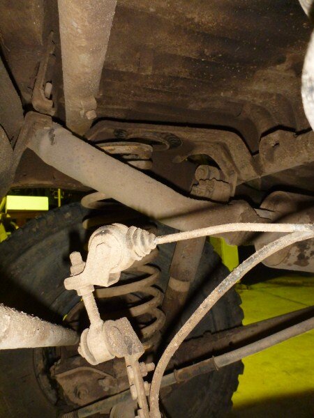

A few pics I took to show Chris what the suspension setup looks like.

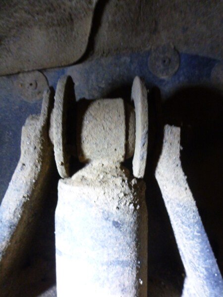

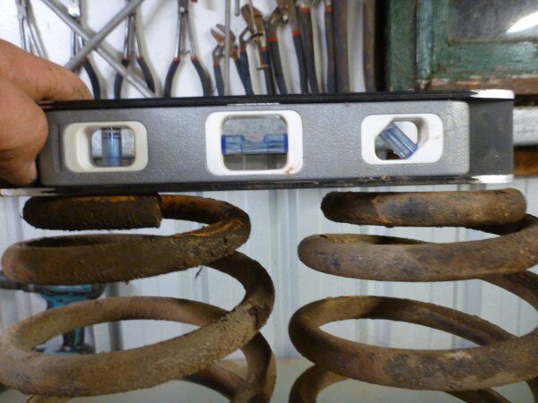

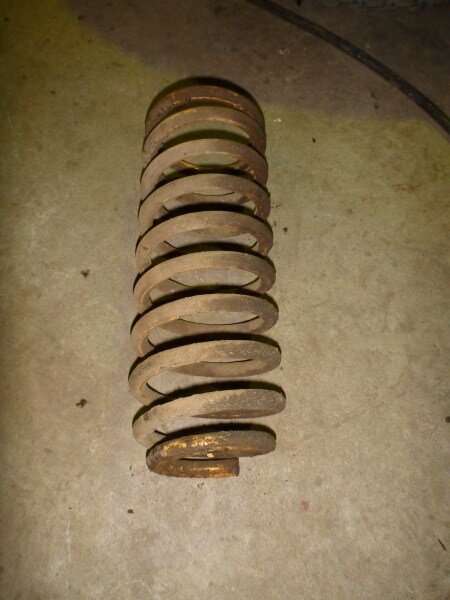

I decided as the springs were now loose I may aswell take them out to measure and inspect them.
LJ has been leaning more towards the drivers side for some time. On closer inspection of the springs, the spring removed from the drivers side stood 5mm lower than the other side. Not a huge amount I know but obviously not helping the lean.

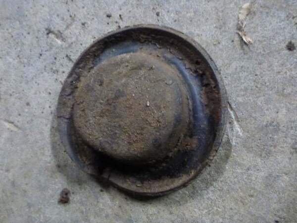

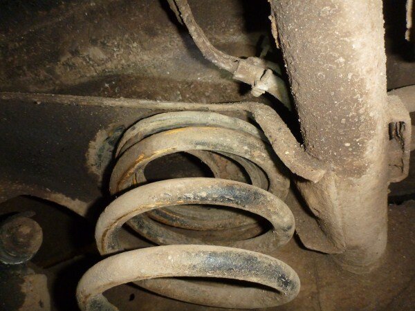

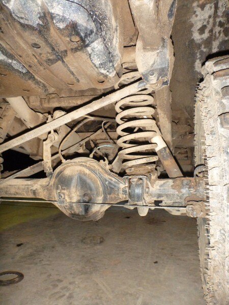

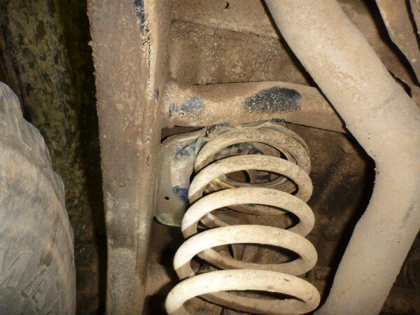

Another thing that I noticed was that the rubber shoe that fits on the axle below the spring was missing on the drivers side. Again not a huge thickness, maybe another 5mm. So that means the drivers side spring and lack of rubber meant that side was 10mm lower. :think:
Measurements taken I put the 35"s back on.
I have had springs pop out when flexing off road before, and they never seem to re-seat them selves properly after the suspension articulates even if the spring doesnt pop out completely. :doh:
In fact they proved tricky to get the springs back in properly and the truck lowered back to the ground.

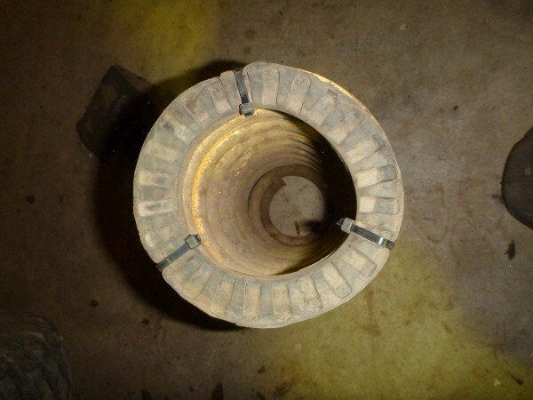

Another problem was getting the little rubber bits to stay on top of the spring properly. In the end I cable tied them on.
I'm thinking of bolting the top of the spring to the chassis like they do on landrovers, so that the spring can dislocate when the truck articulates, but obviously the spring wont fall out and when the chassis and axle move back together the spring seats properly. I was also thinking of making some spring spacers for the back as a temporary option to give me a little bit of lift back and also to stop the spring falling out as easily. :think:
Front next.
Westcoast supplied 4 shock absorbers all the same. This was wrong!
The front ones should have been a different width at the top to fit the chassis mounts. As a consequence and to keep the bushes in the top shock mounts I had to use some big washers and bits of tube to keep them in place. :icon-rolleyes:
Took the tyres back out.

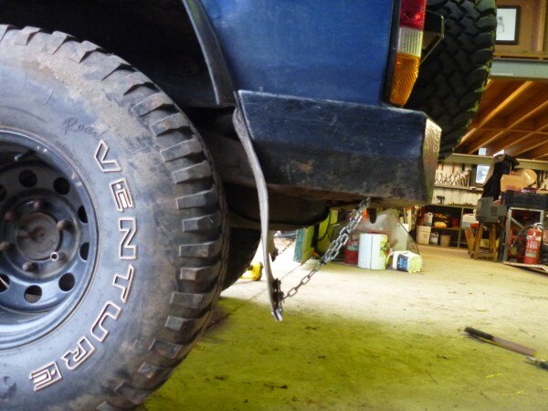

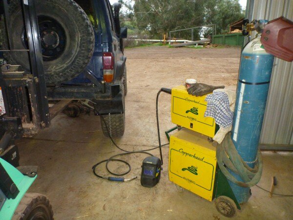

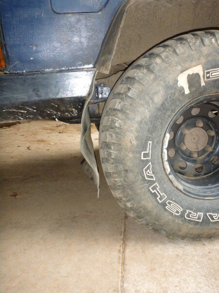

Sunday morning I made a start on replacing the destroyed mud flap.
The reason it failed was because I hadnt added any chain to keep it away from the tyres. So the tyre wore a hole through it and then off road it got torn off. :doh:

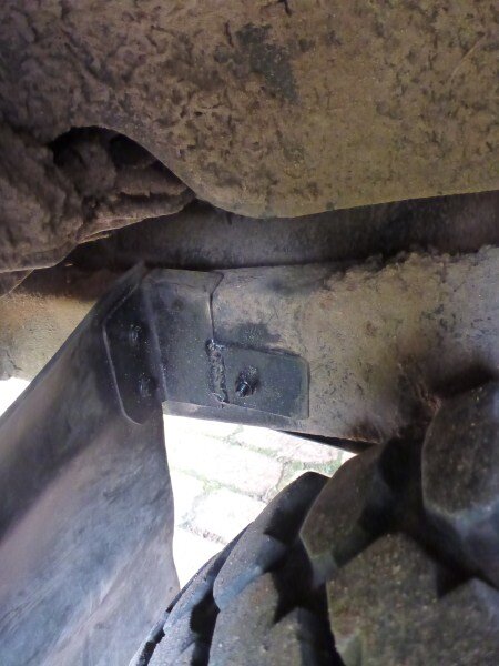

It also broke the weld on my bracket. So the first job was to re-weld the bracket.
Bracket welded, painted and re-fitted.
I cut some more rubber and bolted it on.
I wasnt very happy with all the creases and ripples in the rubber.

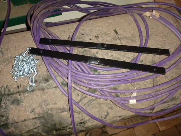

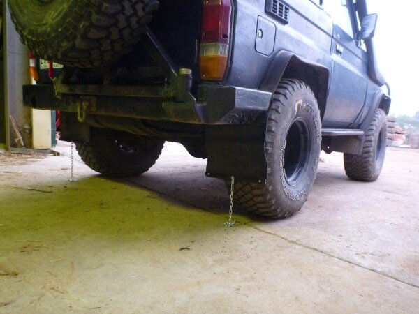

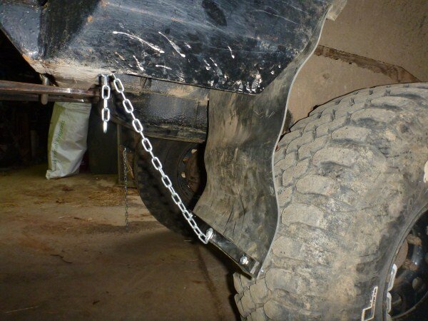

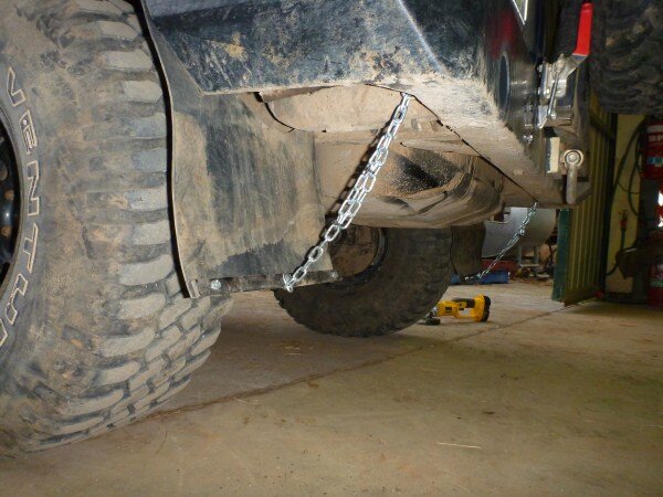

I cut, drilled and painted some 20mm x 5mm steel bar and bought some chain from Bunnings. The idea being the steel would help weigh and hopefully pull down the rubber and also stop the chain from pulling through.
Drilled and bolted in place.
Lifted the back end up to make it easier to weld the hooks on.
Decided not to cut the chain to length just yet as I think I may change the mud flaps yet, so for now I've just cable tied the extra chain out of the way.
This is where they will sit for normal road driving.
Then when I go off road I will hook them up higher so there out of the way.
The chain idea with the mud flaps is exactly what Michael has done on his white 80 series cruiser.
I'm going to see how they go, not sure how long they will last.
Another idea I've seen was what the chap with the green Suzuki Sierra (SJ) had done. On his hed got big rear mud flaps that had a garden gate sliding bolt welded to a bracket on the top of them. So they locked firmly in place for when on the road, then when going off road he just removes them completely. :think:
Its important to have mud flaps and flares/arches as thats something the police pick up on over here and obviously I dont want any hassle with them.
