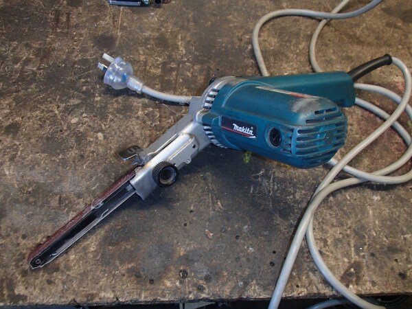

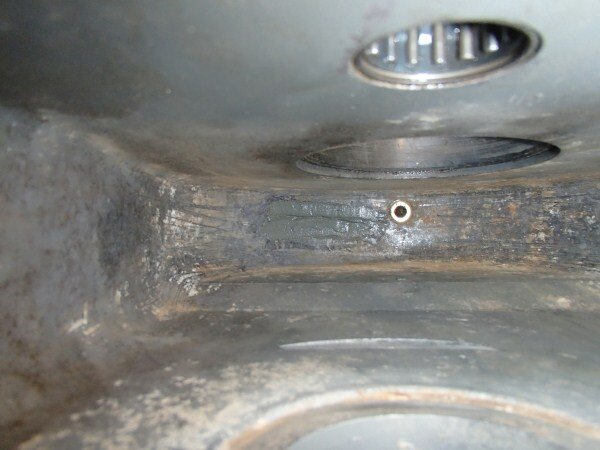

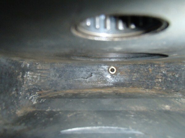

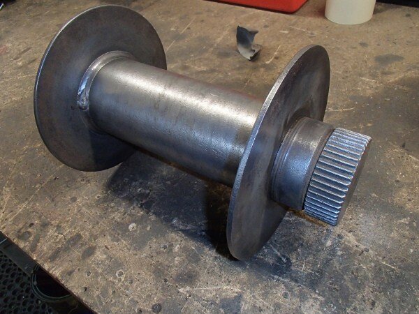

I was hoping I would be able to clean up the crack inside the bottom housing using the finger linisher.
But it was 5mm too short and so wouldnt reach. :doh:
So I had to sand it by hand through the hole where the drum mounts to.

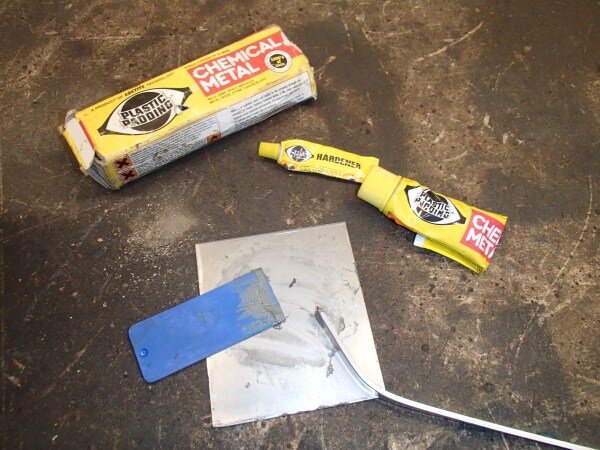

I was then able to fill it with chemical metal.

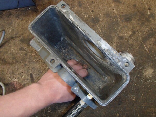

After work I sanded down the chemical metal and cleaned the drum up on the bench grinder that had a wire wheel on it.

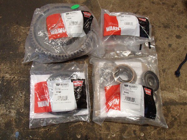

The pile of bargain genuine Warn parts ready for the rebuild.

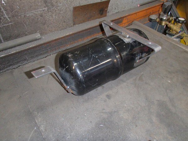

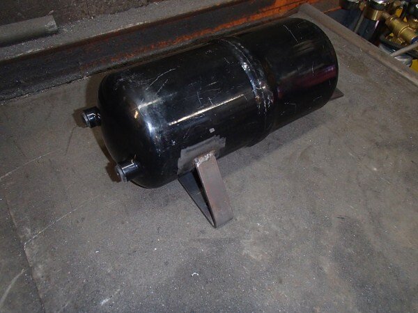

I welded some brackets on to an air tank.
Test fitting in the car.

On Thursday we had a brand new pick up truck in and I had to design and make a battery tray for it. A lot of modern engine bays are so full when they leave the factory that there isnt any room to fit another battery under the bonnet.
We already make trays to fit a battery in the pick up bed, thats what all the other trays I've been making have been. But some people cant fit a battery in the pick up bed as they've got other things fitted there, so the only other place is underneath.
I made a cardboard template.
Drew around it onto the steel and cut it out.
Folded it and tack welded the corners.
Added some brackets.
Added a section of tube to protect the corner of the 13" optima battery.
It was a nice little project and once its done and tested and goes into production we could sell thousands over the next 10-20 years. :icon-cool:

Michael got his winch back from his winch guy freshly built up with the new Gigglepin twin motor top hat.
Amazingly its heavier than the huge Red hydraulic winch.
This meant hed got his old main shaft spare for my rebuild.

First job was to fit the new bottom housing seals and bushes.
Used a seal/bearing tool to push the new bush in.
New main gear went in next.
At this point I'd put the main gear in the wrong way round but I didnt realize straight away.
Main shaft off Michael.
Compared to my rusty worn old one.
New parts.
