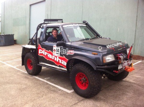

Just realised I've never told you the name of the Jimny.........
Frankenzuke!

The Jimny is going really well. :icon-biggrin:
We've discovered the 1.6 16v vitara engine in it has a blown head gasket though. :thumbdown:
Not a huge problem though as the other part of the business is Suzuki 4wd wrecking. So we've got a factory full of engines ready to go in. :dance:
The auto box is getting re-built by a specialist this week. Then the new engine is going in and then its off to the paint show to get re-sprayed.
Then it needs stickering up with all the company graphics, the interior is getting a totally custom job with new carpet and recovered seats and door cards. :icon-cool:
