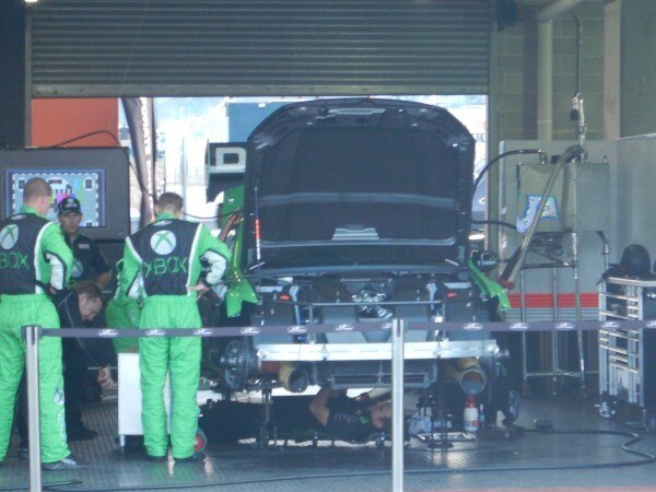

Back at the pits, teams were busy fixing cars from the days qualifying.

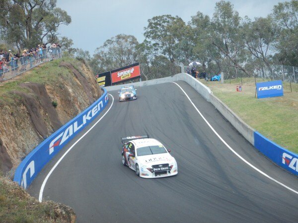

The next day we got the bus to the top of mount Panorama and spent the day up there watching the racing.
