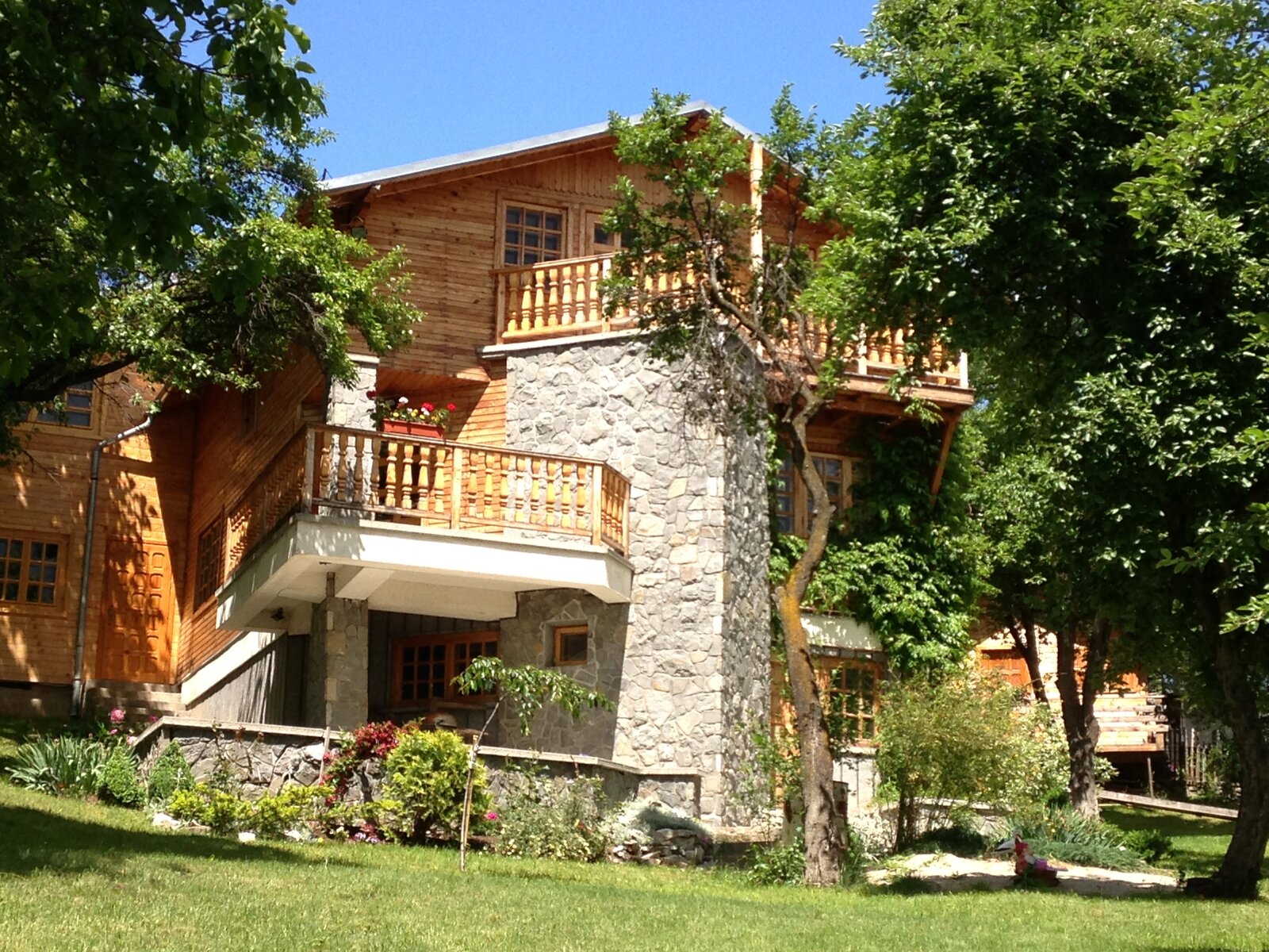

I've taken a lot of inspiration from this American one and this is the sort of look were going for.
Ours will have a mezzanine floor on the second storey level with a double bed and the down stairs area will have a log burner and built in book cases under the ladder/stairs leading up stairs.
Outside there will be a big deck area with a veranda roof over the top. The staircase leading up one side and the other side will have a firemans pole for quick descents and a pulley block above with a rope and bucket hanging down for hoisting things up. There will also be a bell tower on the roof complete with an old English built church bell that came from a burnt down church in Tasmania.
