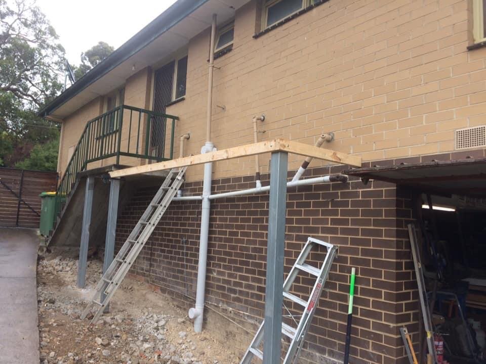

First I redid all the waste water pipes and a storm water pipe.

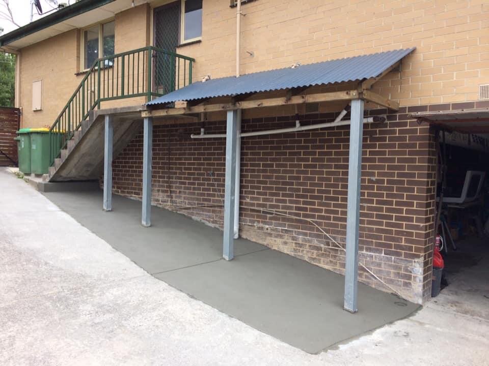

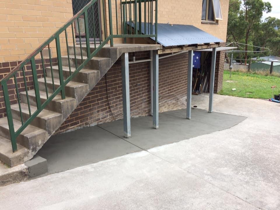

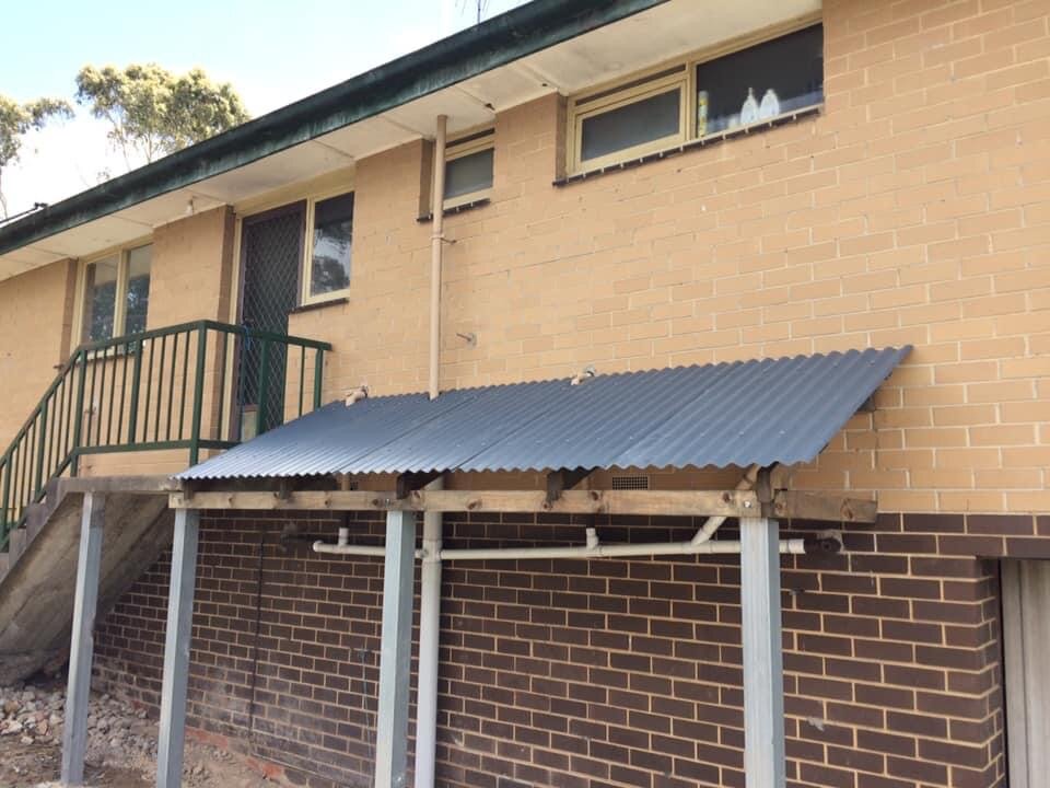

Then I added a load of galvanised 4” square steel posts that I had acquired from an old mezzanine at work.
I also replaced the 2 steel posts under the concrete steps as they were too short now I had dropped the ground level so much.
I concreted then into the ground and used clamps and bits of wood to help hold them at the correct height and in position until the concrete set.
With those all in position, I constructed the roof.
And clad it in the same blue colour tin as the carport.
When we do the extension on the house I will replace the entire current, concrete tiled roof with this same blue tin.

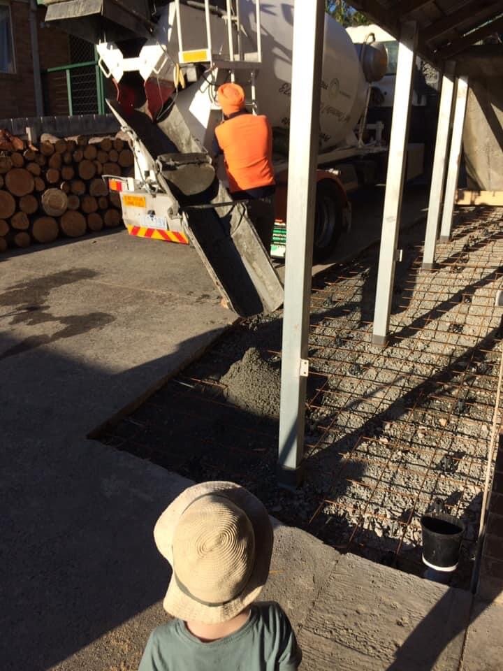

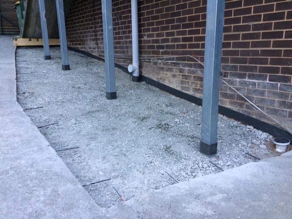

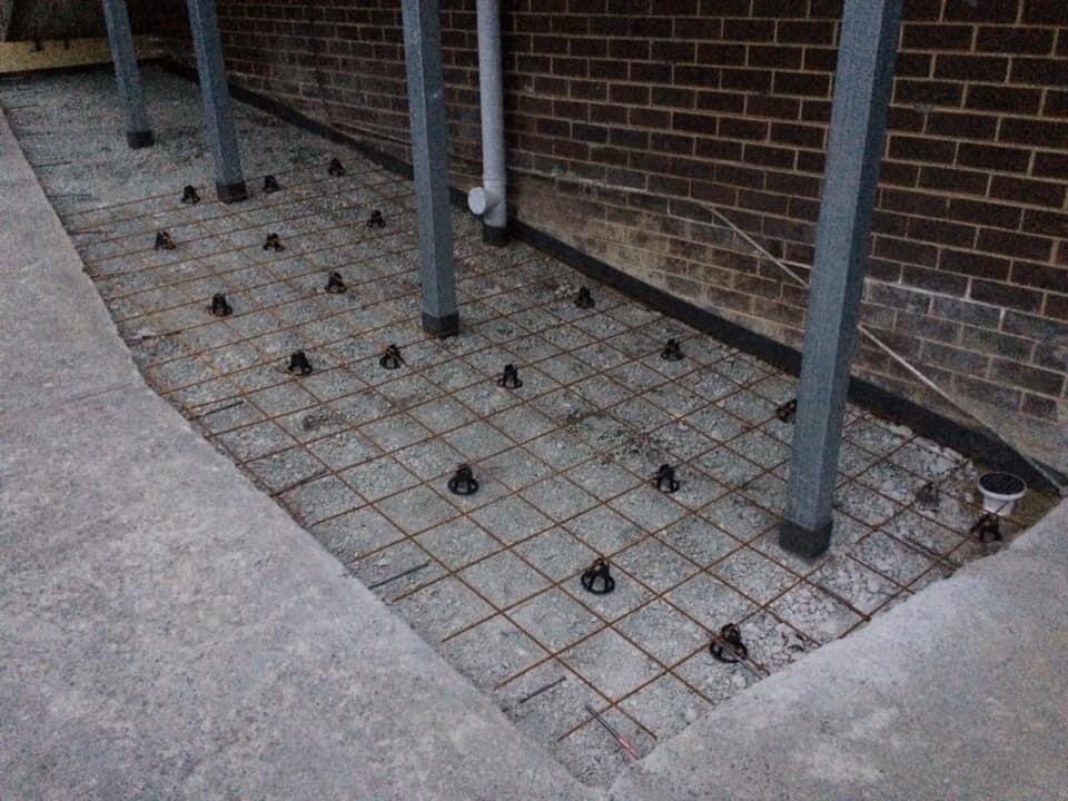

Next I needed to add the steel, to reinforce the new concrete.
I added dowels into the existing concrete, to prevent the new concrete from sinking and cracking.
Followed by the mesh.
Then it was concrete time!
My friend Michael did an excellent job!

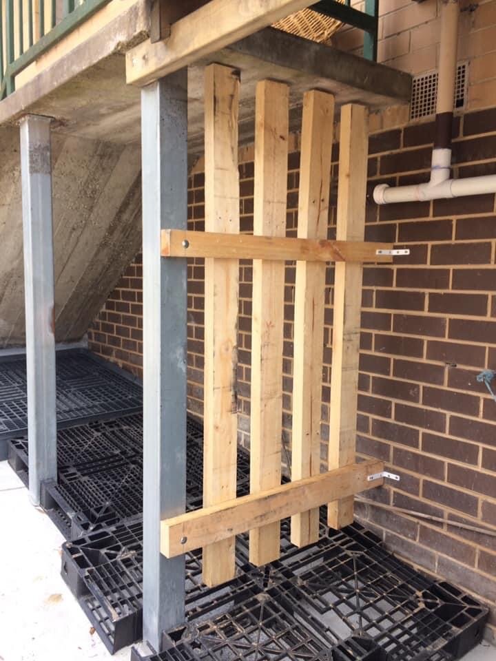

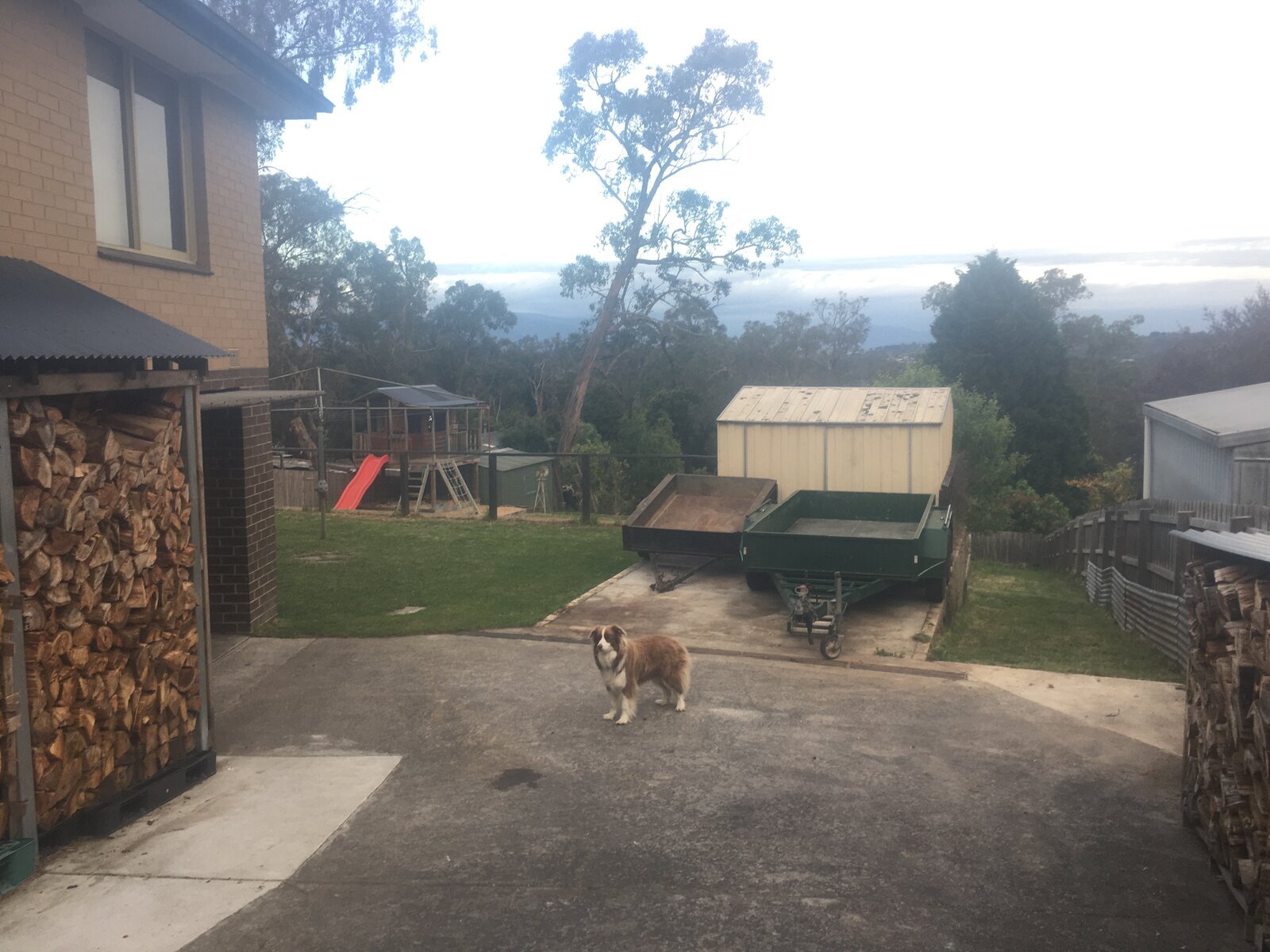

I used some reclaimed pallet timber to make an end and dividers to stop the firewood from escaping.
We then hired a 30ton petrol log splitter for the day and with the help of my neighbours we split a mountain of fire wood!
It made such a mess and it would take me days afterwards to clean it all up and put it all away!
But it filled the new wood store nicely.
And I was even forced to build another store along the fence, I had far more wood than I envisaged I would.
I decided to keep the temporary metal fire wood shed for now, as I still had a load of firewood that I ran out of time to try and split, during the 8 hours we had the wood splitter here.
But I moved it right back on the old garage concrete pad it’s on, which made room for my big trailer and Sams toys.
Finally the place is looking a bit neater after being a mess for the last 18 months!

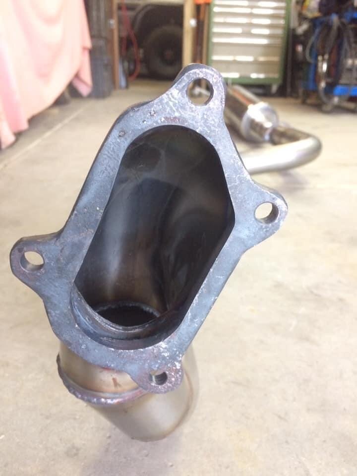

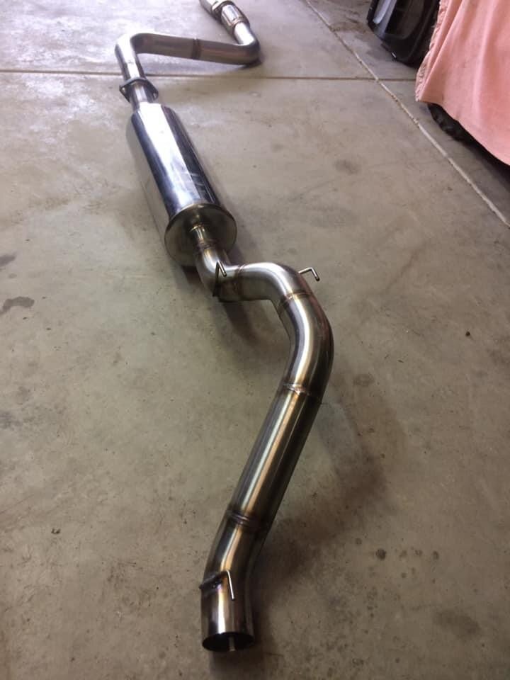

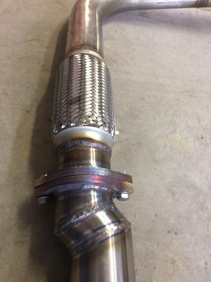

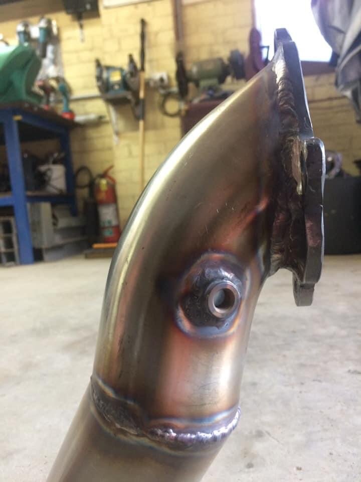

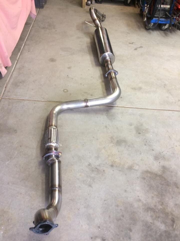

One of the few jobs that I still needed to do to complete the 1KZ engine conversion I did way back in September, was a decent exhaust system.
So I built a 3” mandrel bent stainless steel exhaust system for it, from the turbo back. :icon-cool:
My only regret is using such a big silencer, as currently it’s far too quite. I should have just fitted a small silencer like on The 78, as that system sounds awesome when I put my for down!
I may end up changing the silencer or even deleting it completely, I’m not sure yet.

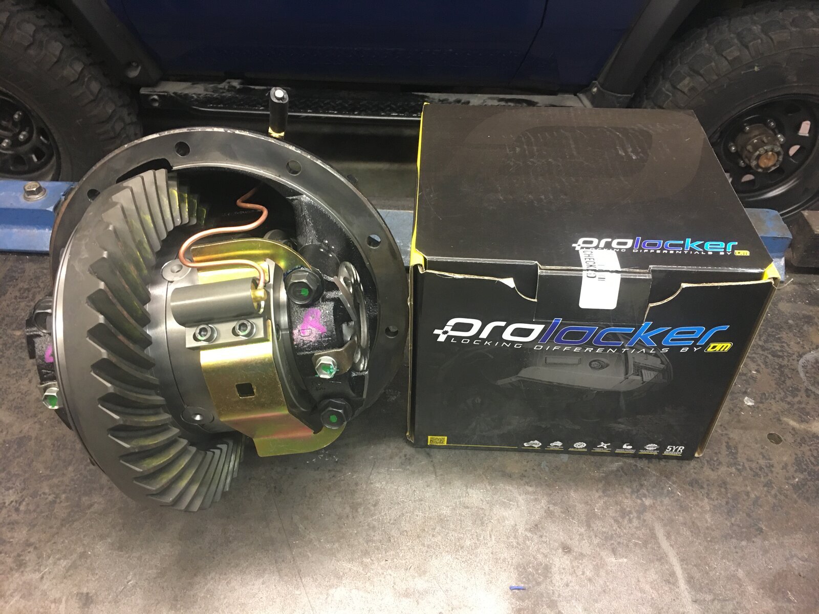

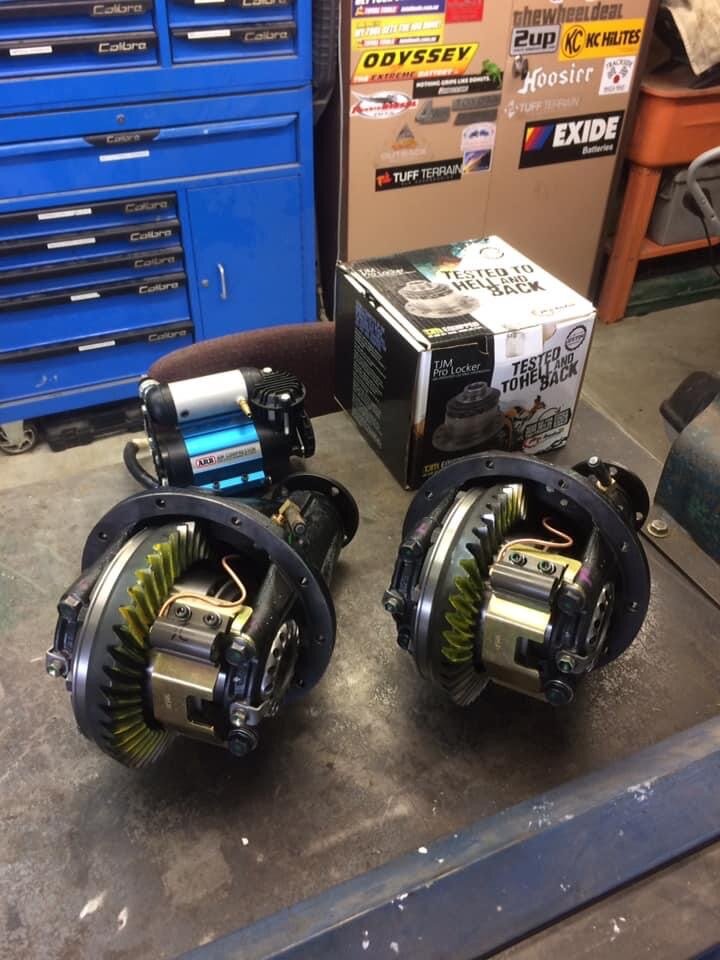

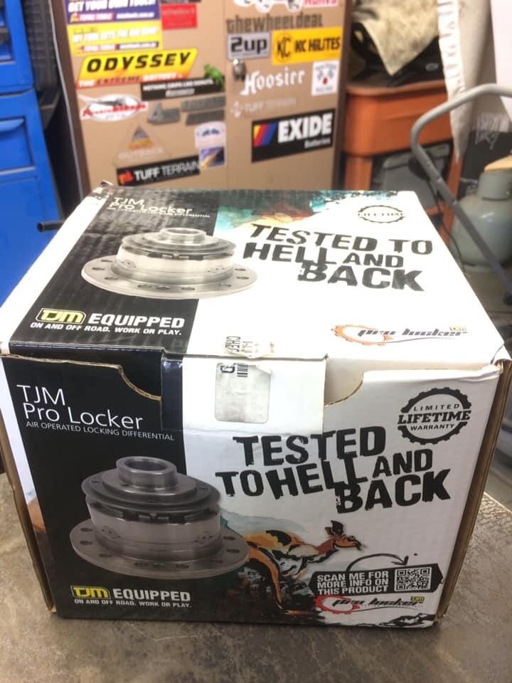

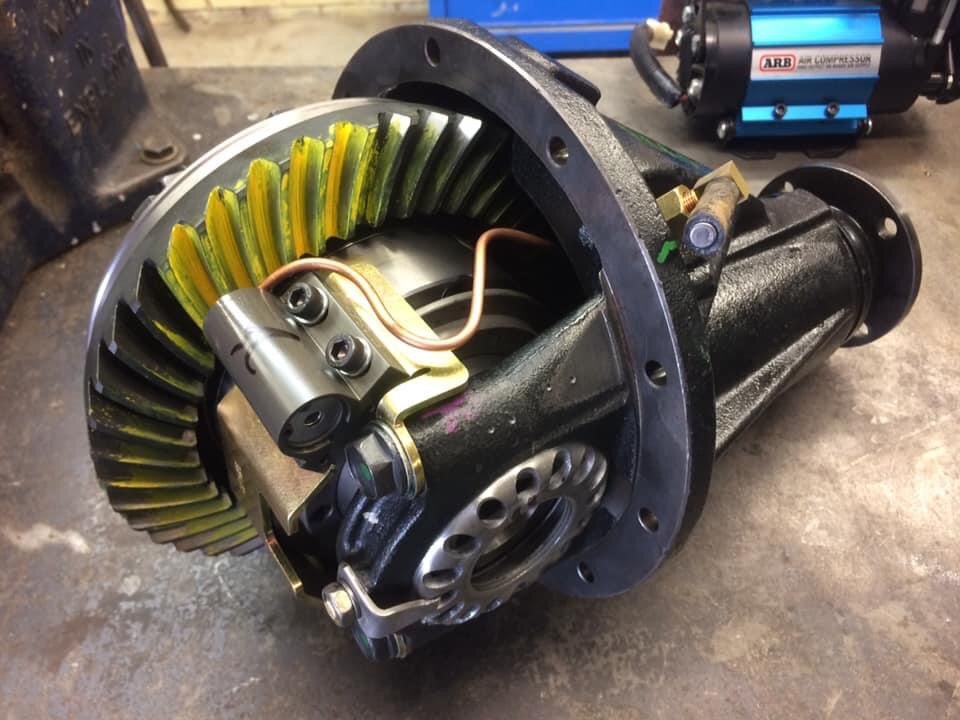

So with the Hilux I decided to go with TJM Pro Lockers as I’ve heard such great things about them.
I had my diffs rebuilt with solid pinion spacers and all new Koyo bearings. I also picked up an ARB compressor from work.

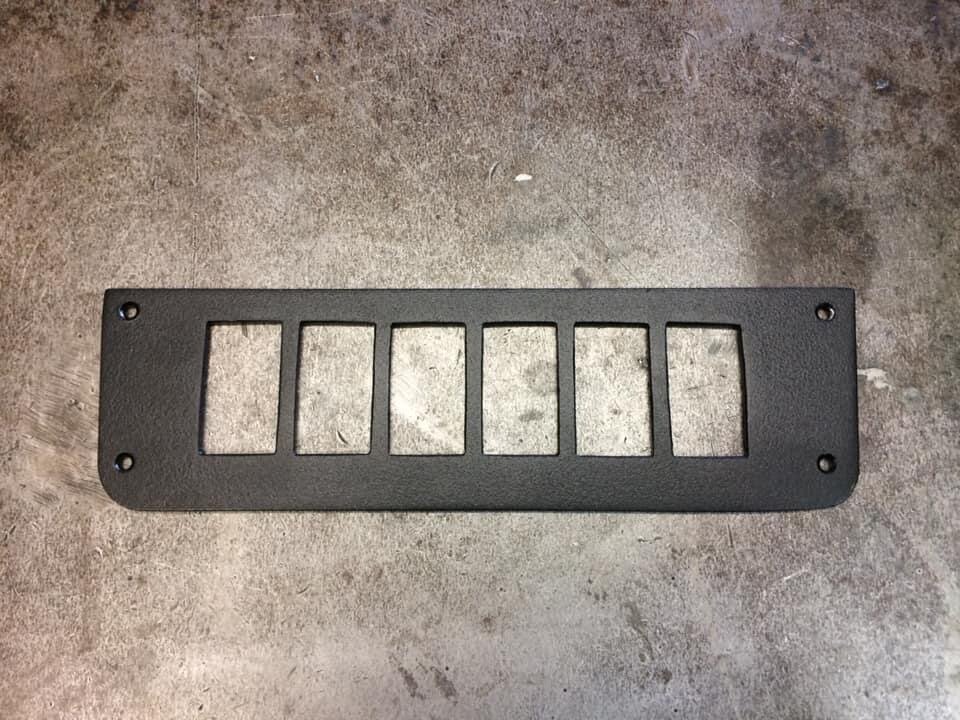

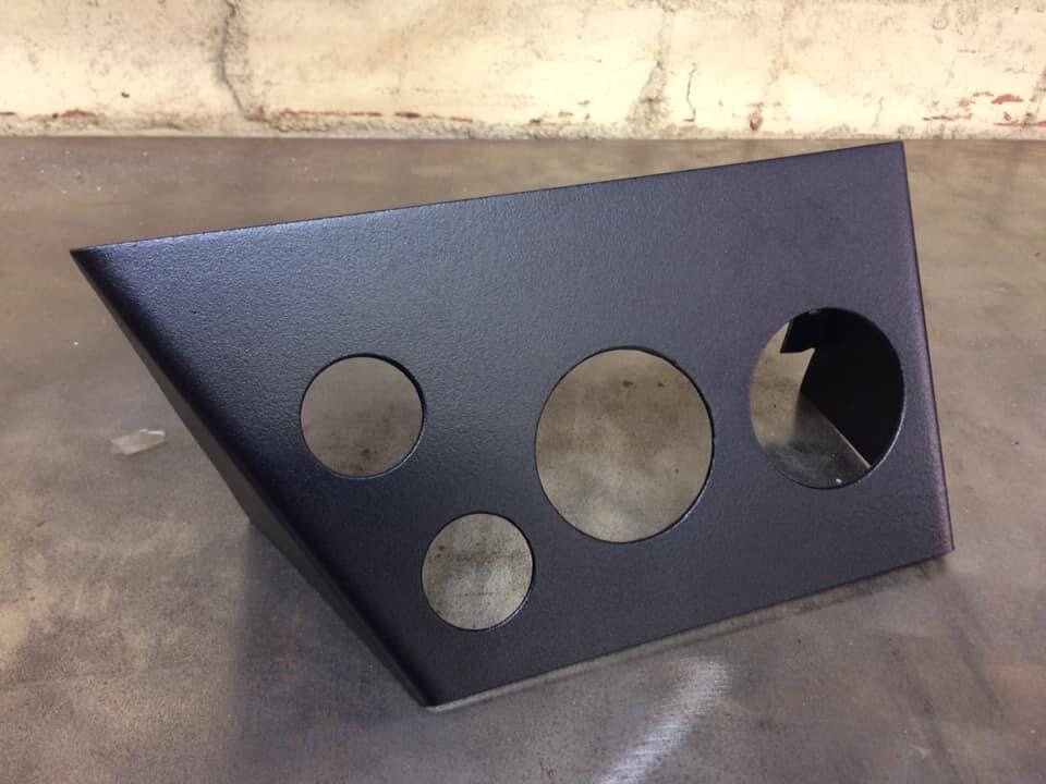

I needed somewhere to mount switches for the new lockers and compressor.
So I made a switch panel out of aluminium.
Got it powder coated in texture black.

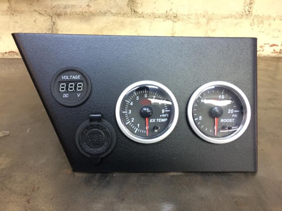

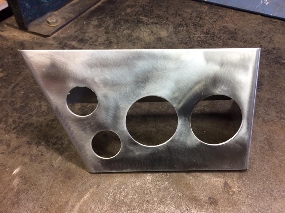

I also needed somewhere to mount a boost, EGT and volt gauges and a double USB socket.
I started with CAD (cardboard aided design)
Then cut it out in aluminium.
Folded it.
Test fit.
Added some holes.
Got it powder coated textured black.
Added the gauges and socket.
All fitted.

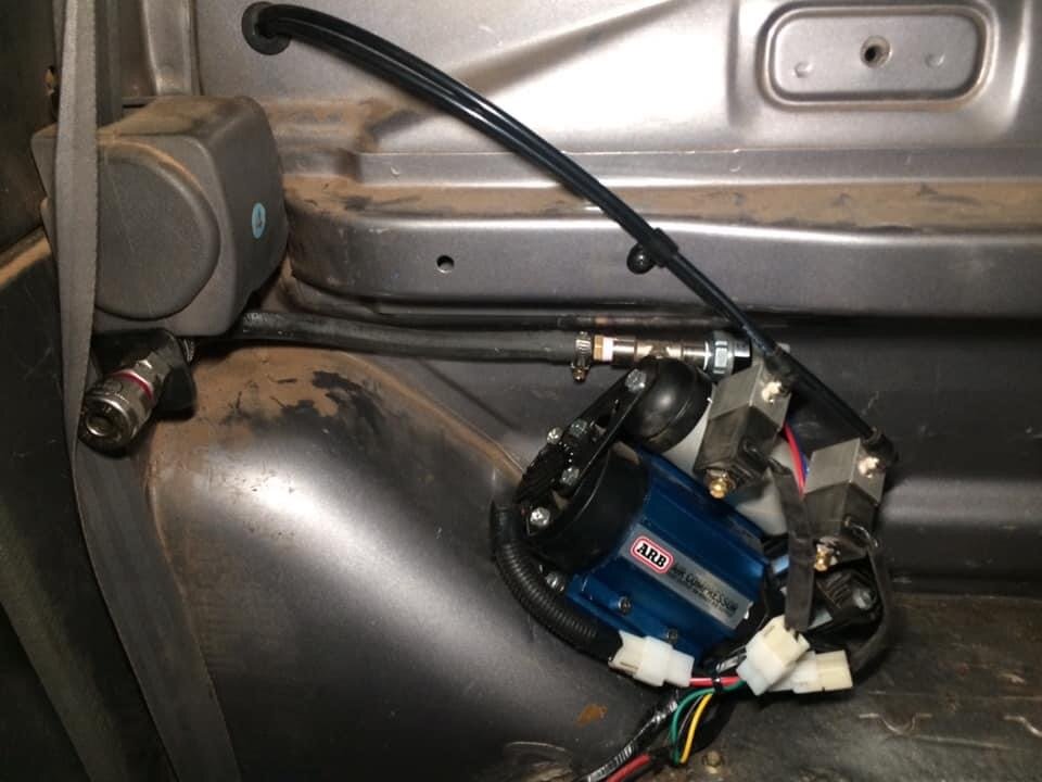

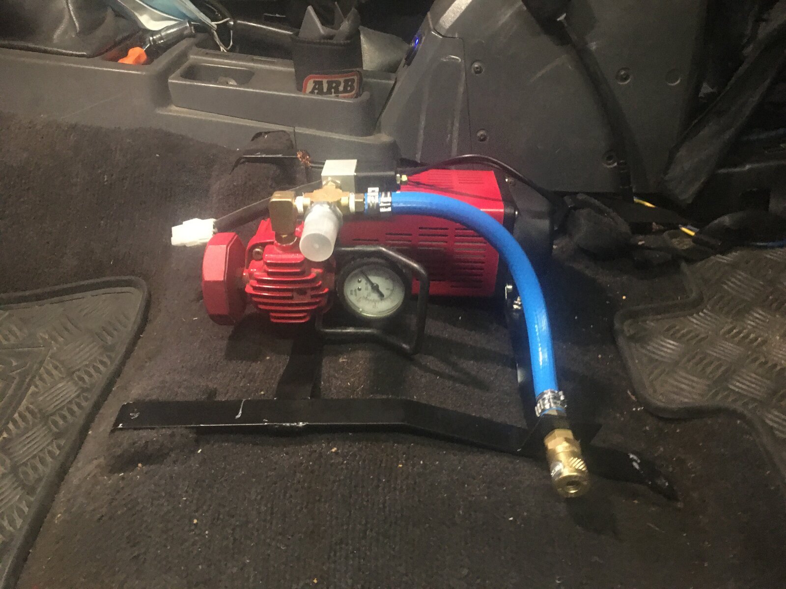

I mounted the compressor behind the rear seat and added an air outlet for inflating tyres and blowing out air filters.

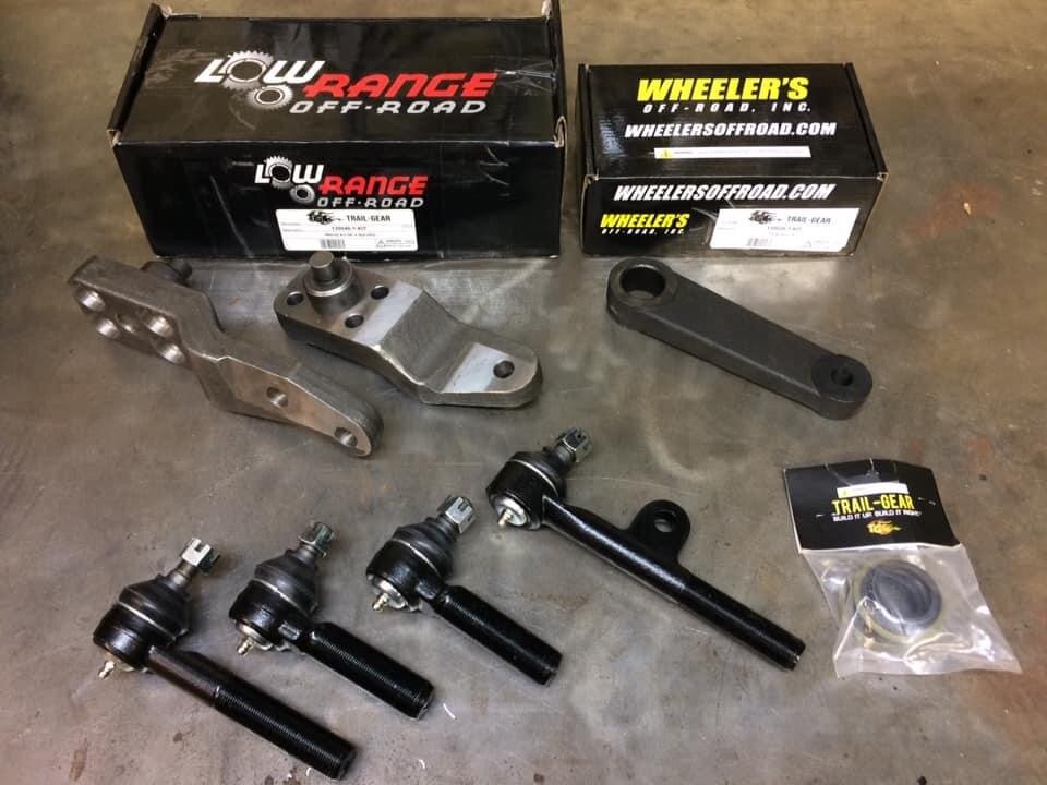

I bought some bits from Trail Gear in the US to do a high steer conversion, in order to ditch the weak point of this model Hilux, the weird steering setup they have as standard.

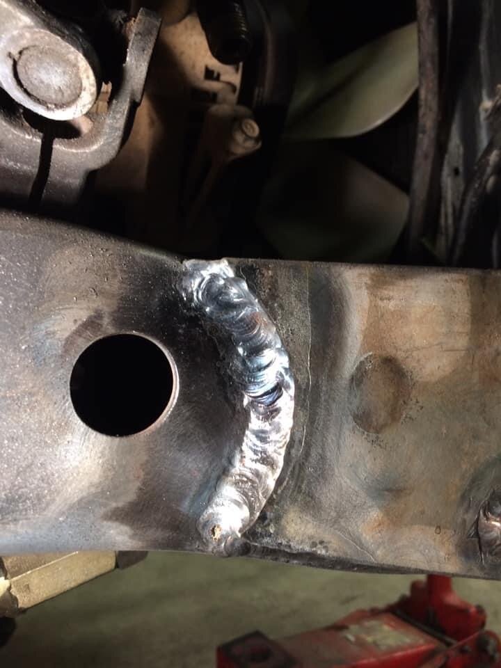

I TIG welded a piece of 12mm Plate to my chassis in order to allow me to mount an IFS Hilux steering box.
I used the steering box from the engine donor Hilux, with the new Trail Gear flat pitman arm.

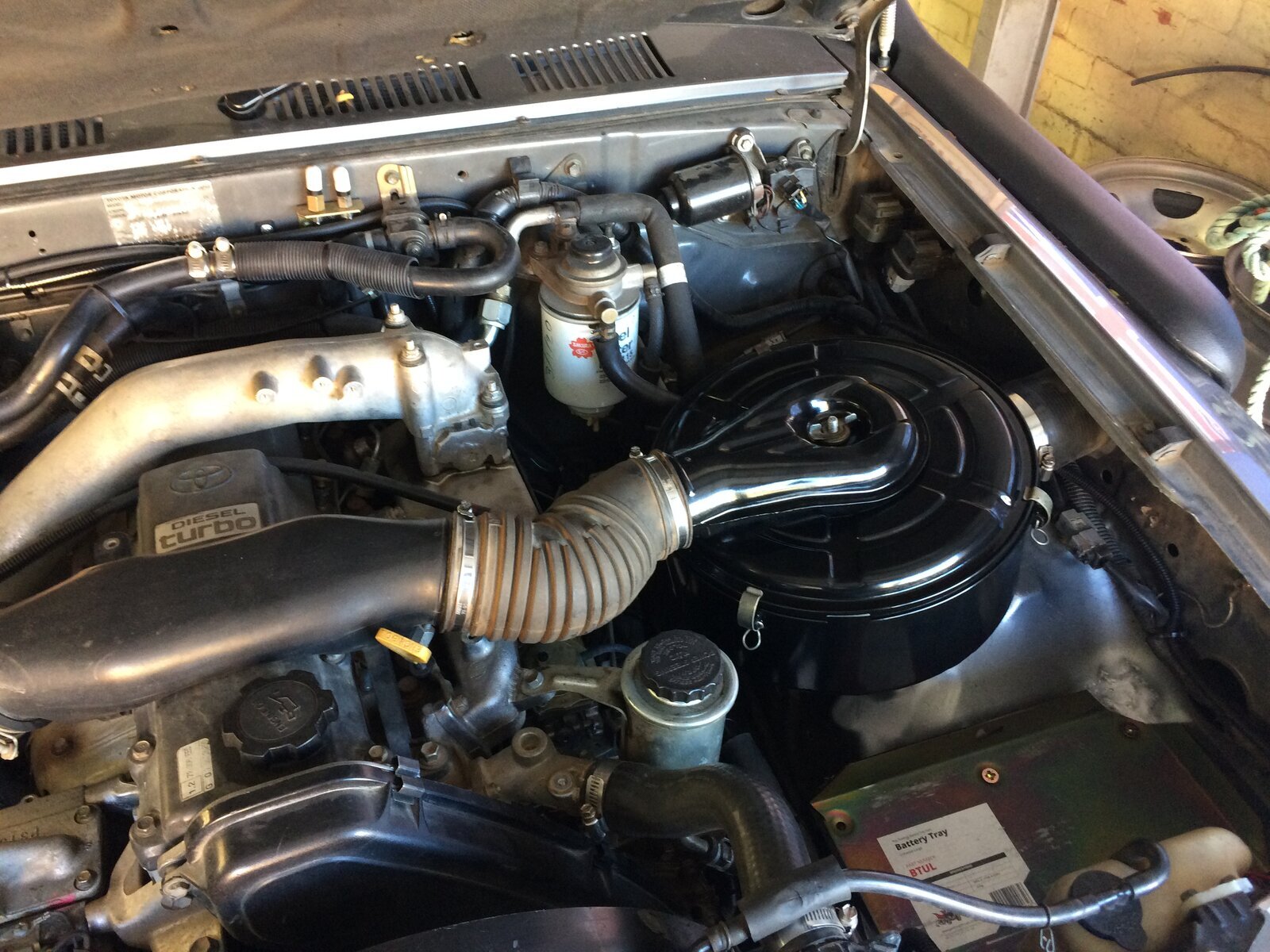

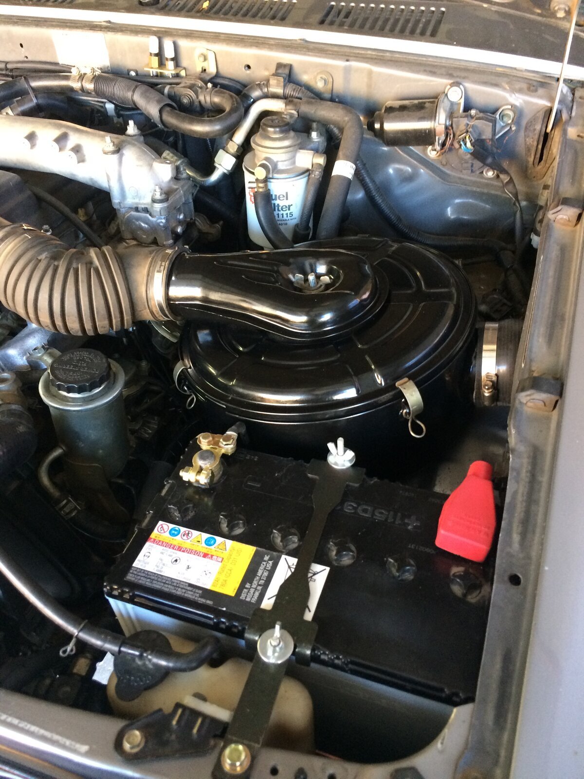

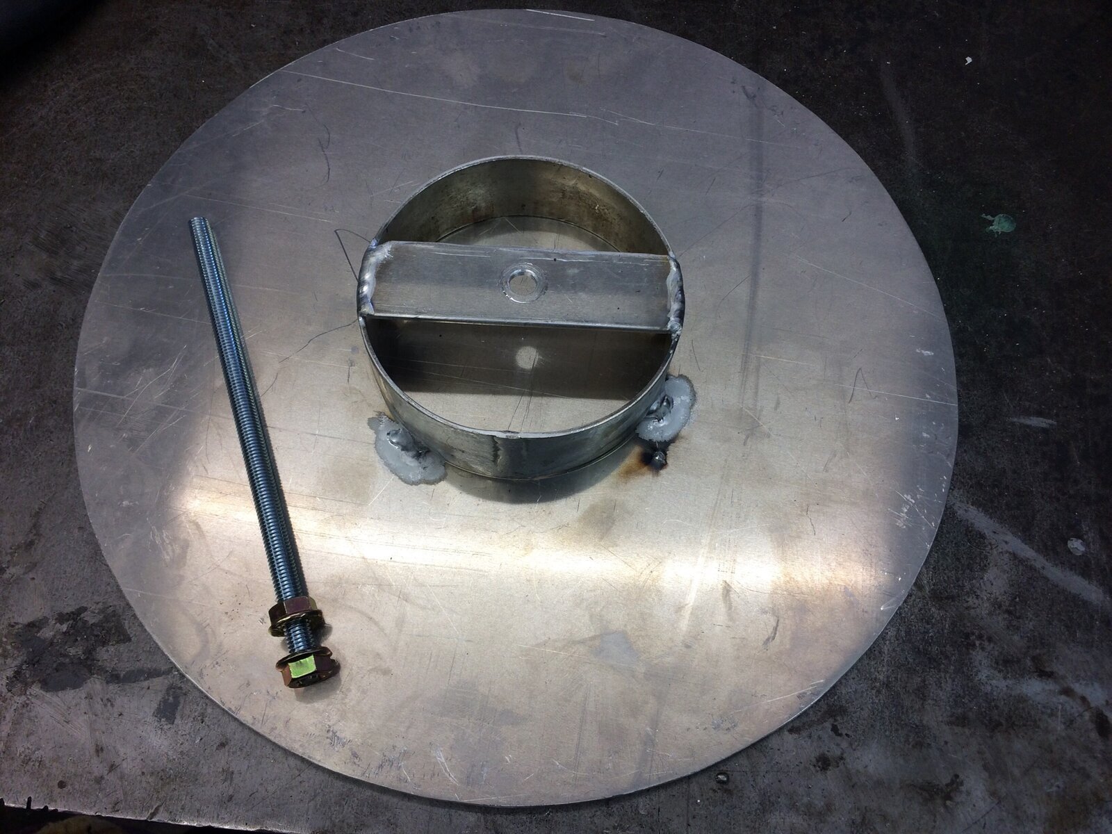

I had never been 100% happy with the angle or position I’d had to fit the airbox from the engine donor Hilux, into my Hilux.
But with my plans now being to use this car for 4wd trips I really needed room to squeeze an auxiliary battery on the passenger side, so that I’d have a second battery to run an Engel fridge.
I tried modifying the airbox from the engine donor Hilux and tried moving the inlet. But that really didn’t go well at all.
The metal is paper thin and even with the amps turned right down on the TIG, it blew holes and looked terrible! :thumbdown:

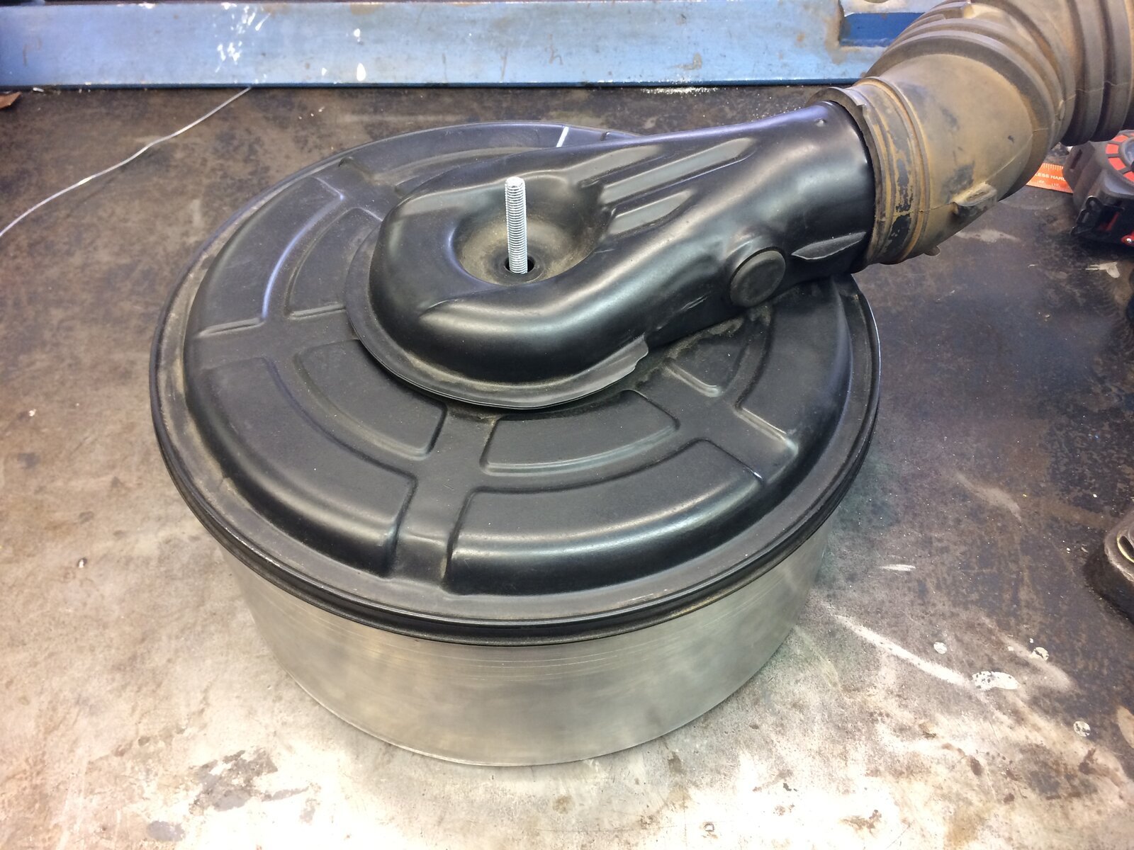

Seen as I like my engine conversions to look completely factory, there was only one option...........
Make my own airbox from scratch, with all the features of the genuine one. :shifty:

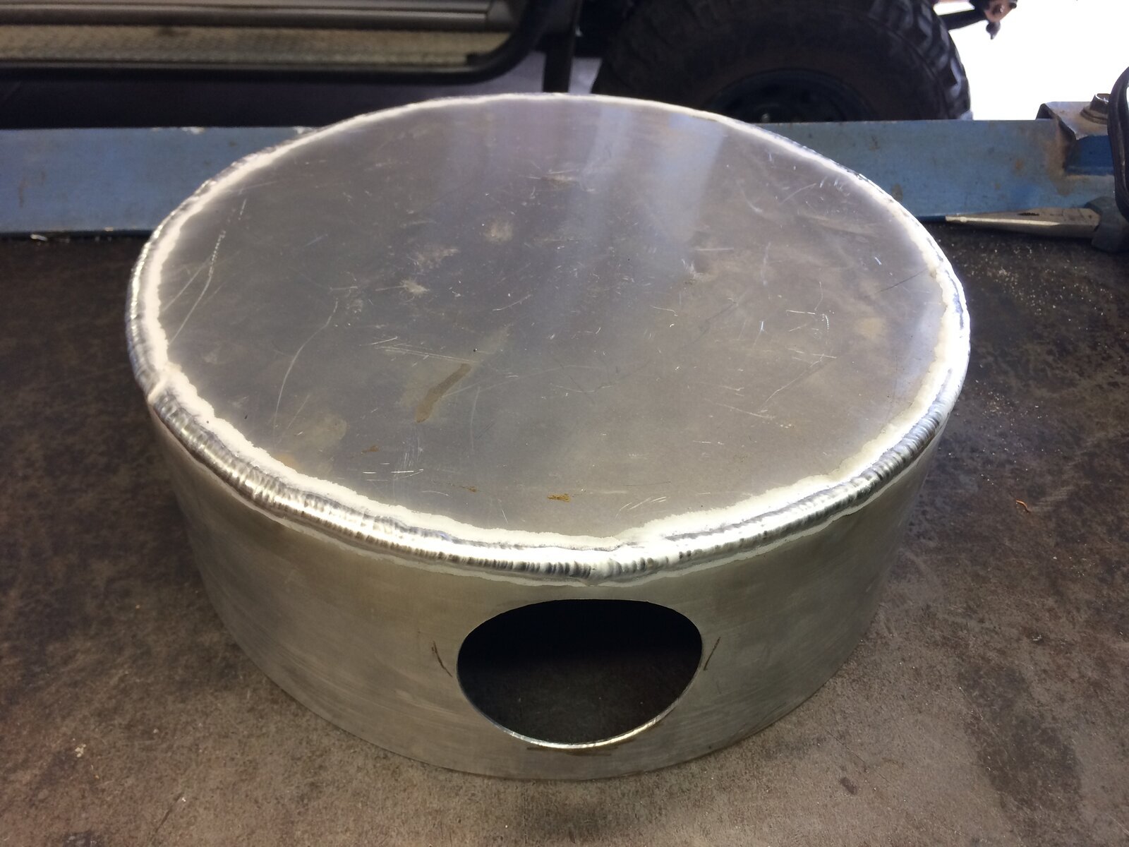

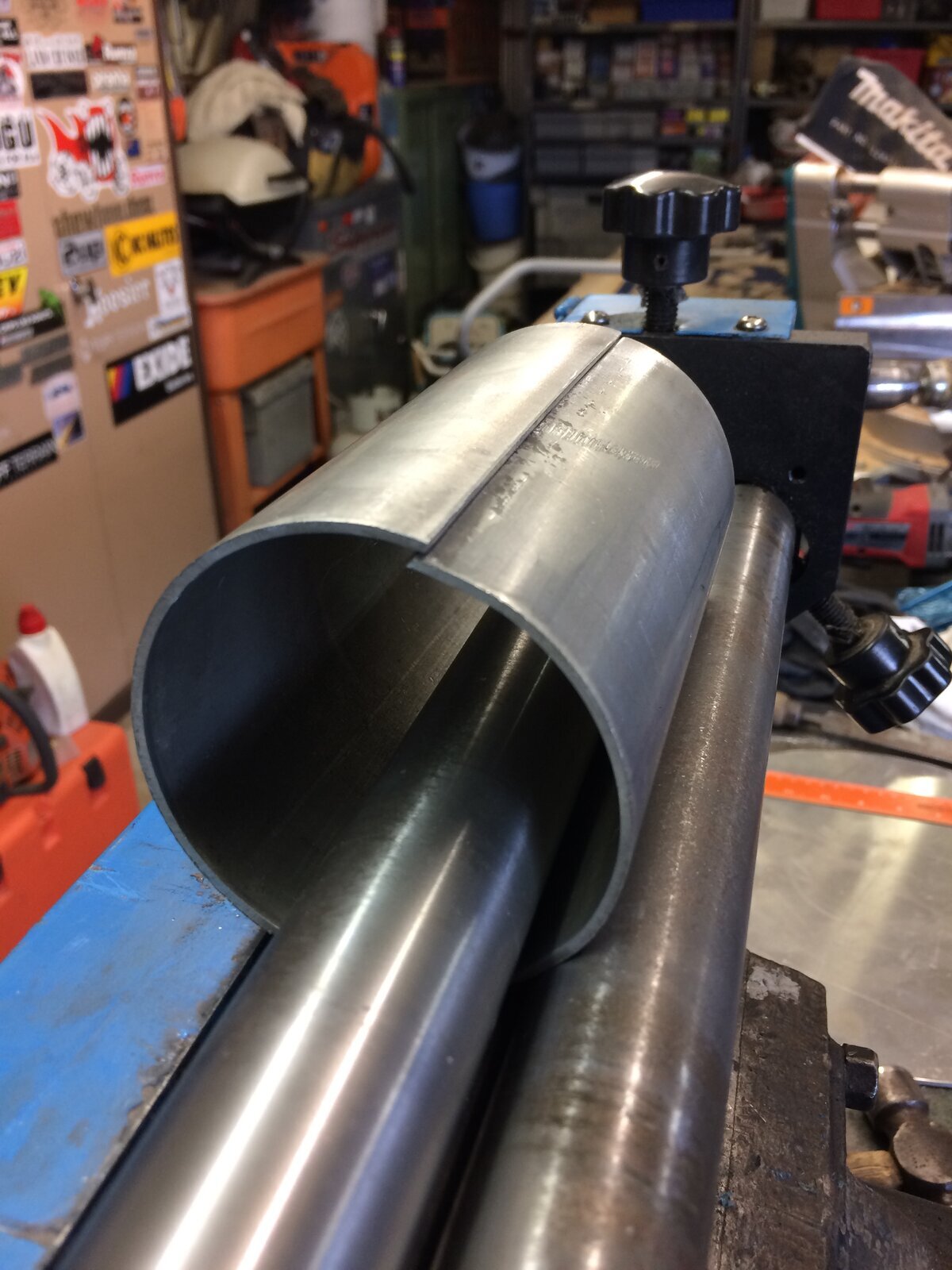

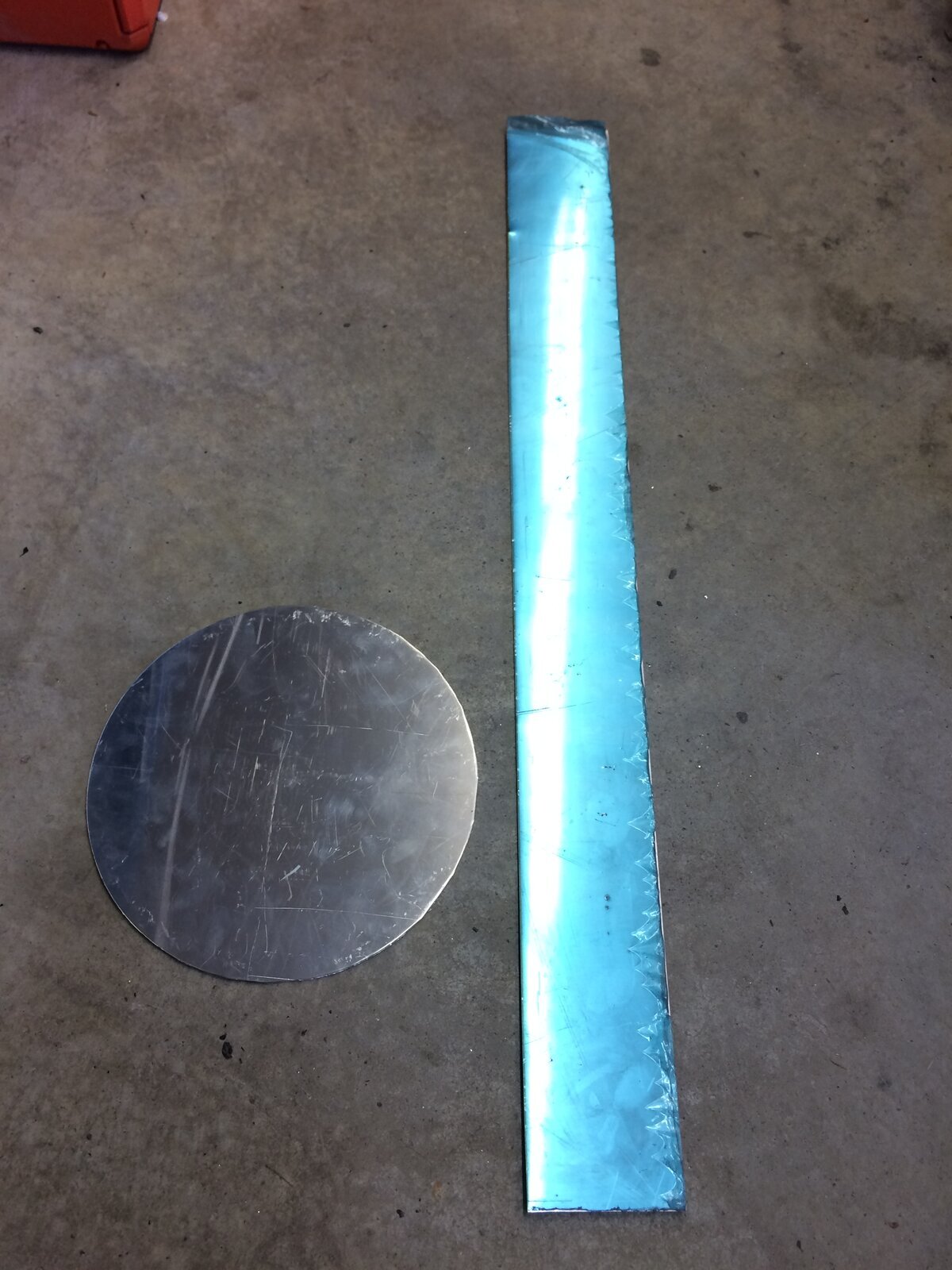

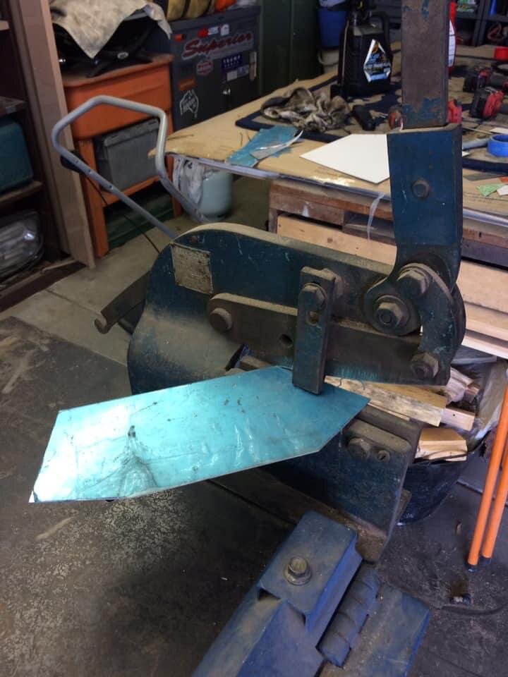

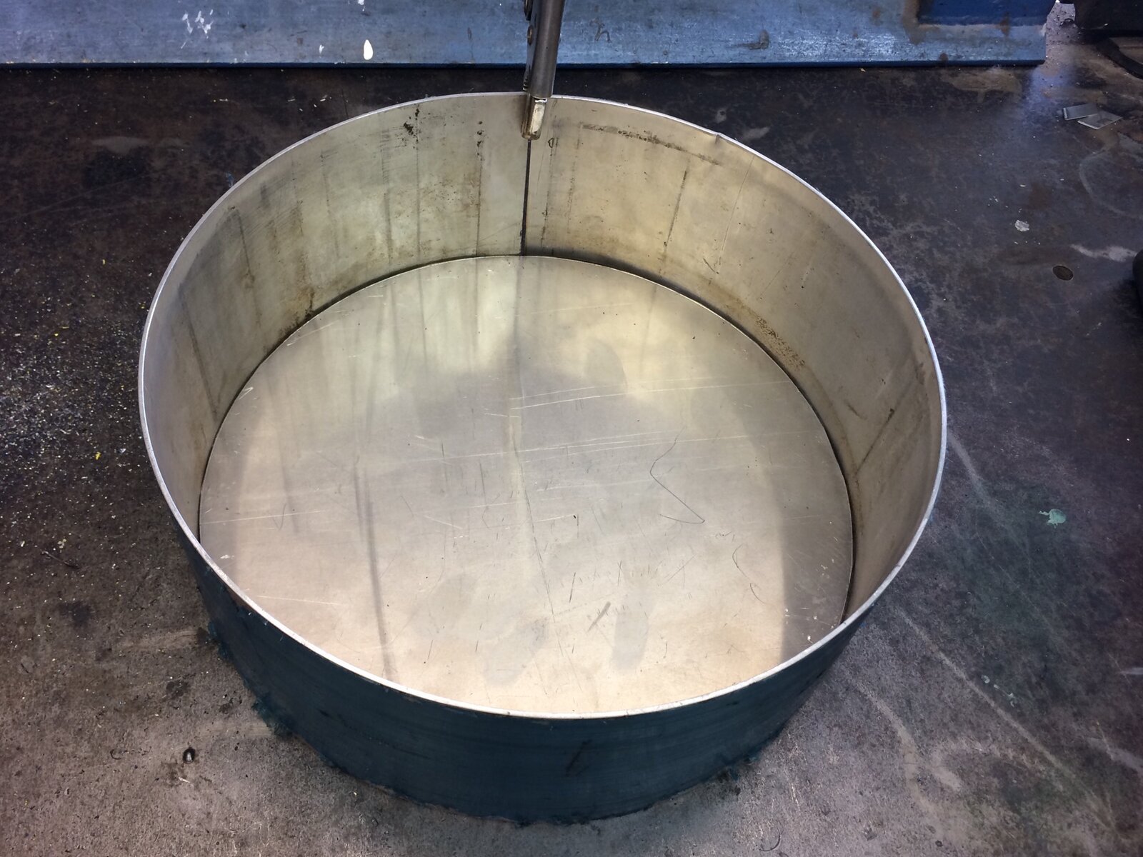

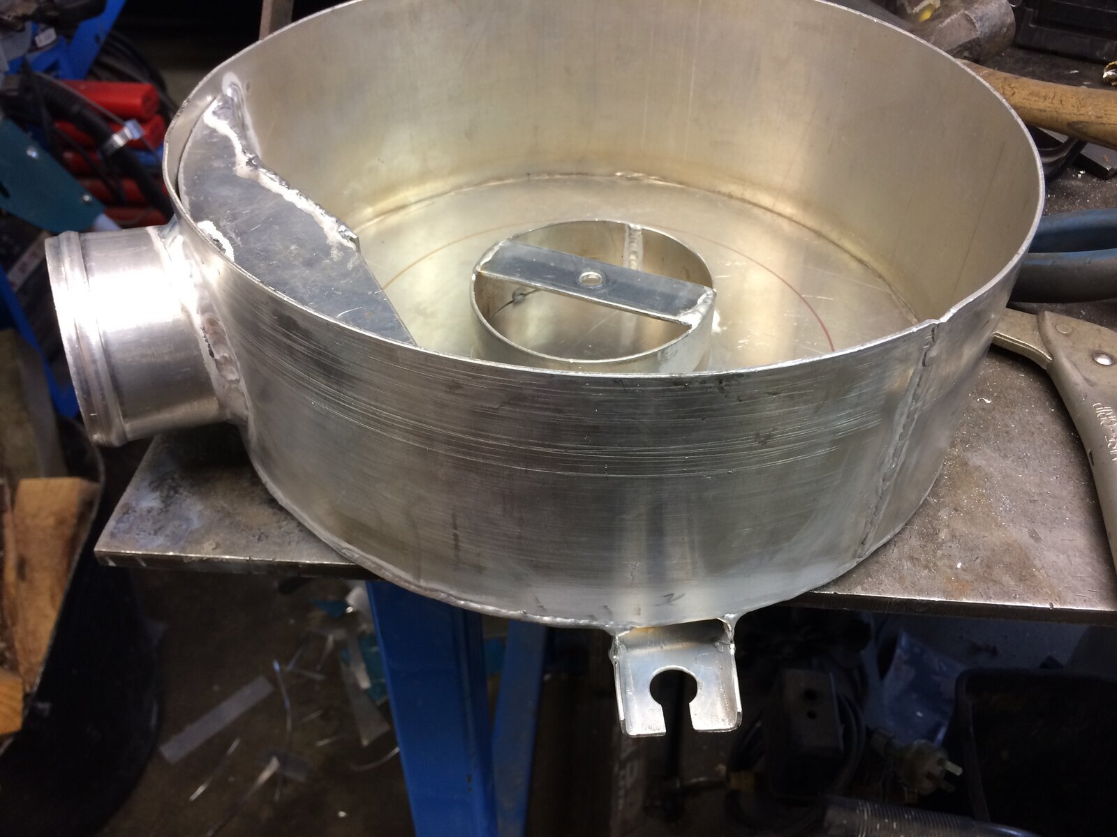

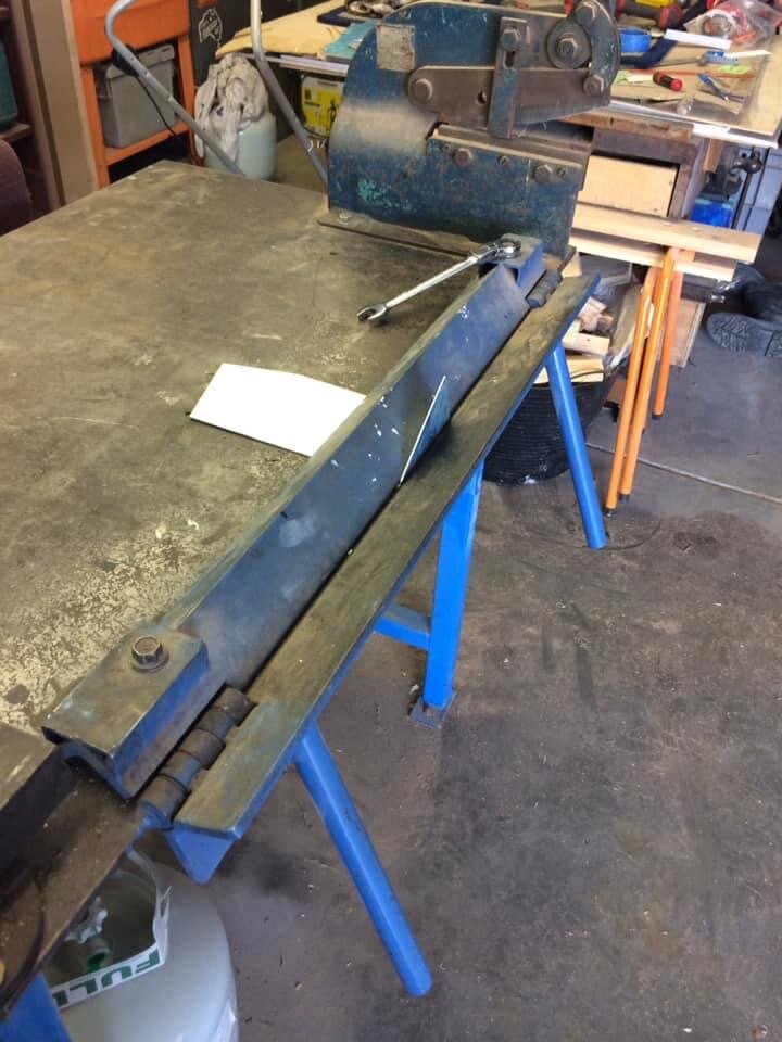

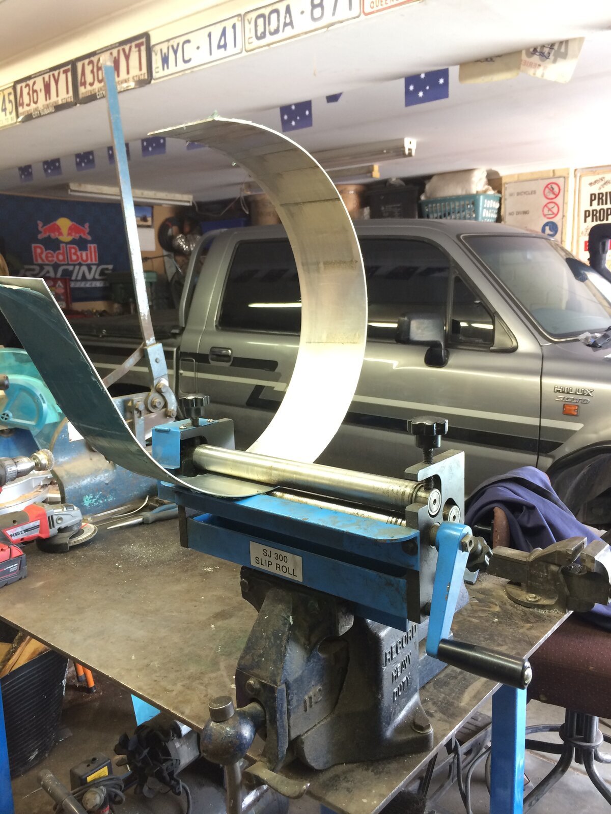

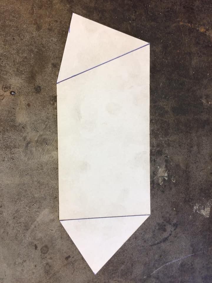

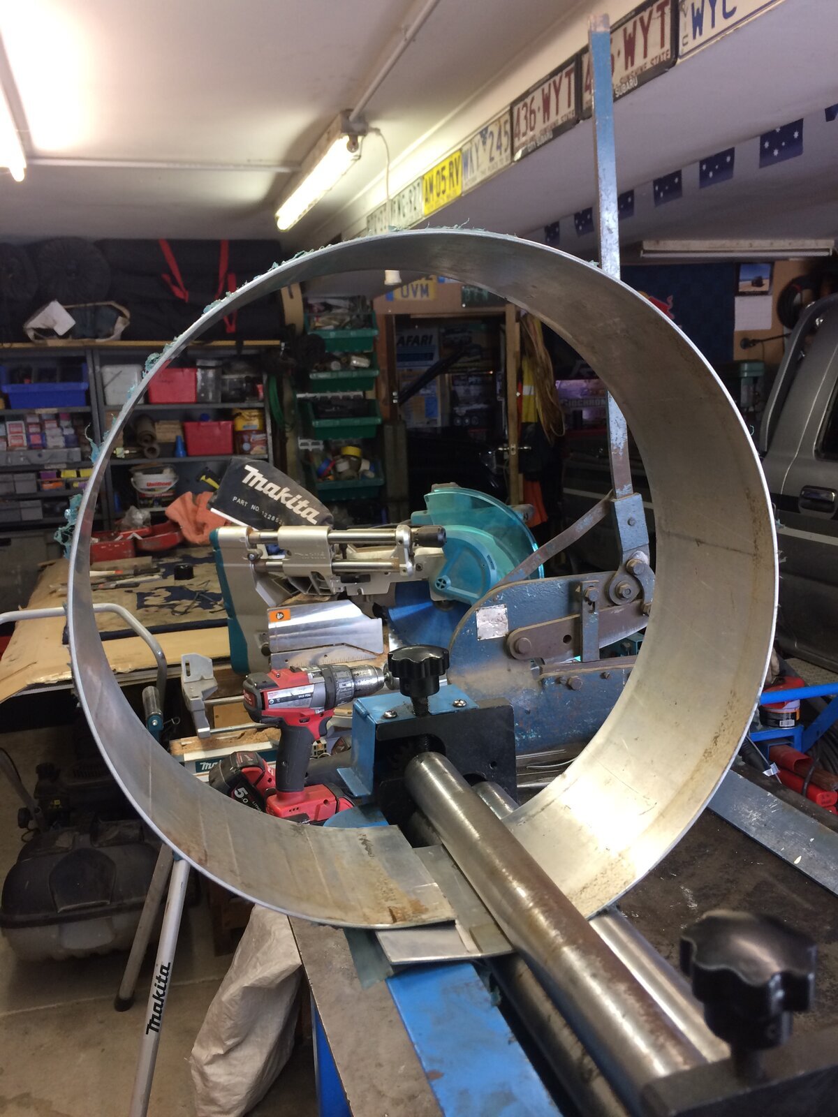

First I cut some aluminium on my hand shear. 3mm for the base and 2mm for the sides.
I put the 2mm in the rollers and rolled it.
I had cut the strip longer than I needed on purpose as the very ends never get rolled properly like the rest of the sheet.
I cut it to length in the hand shear.
I then stood back and admired the beautiful cake tin I had made!

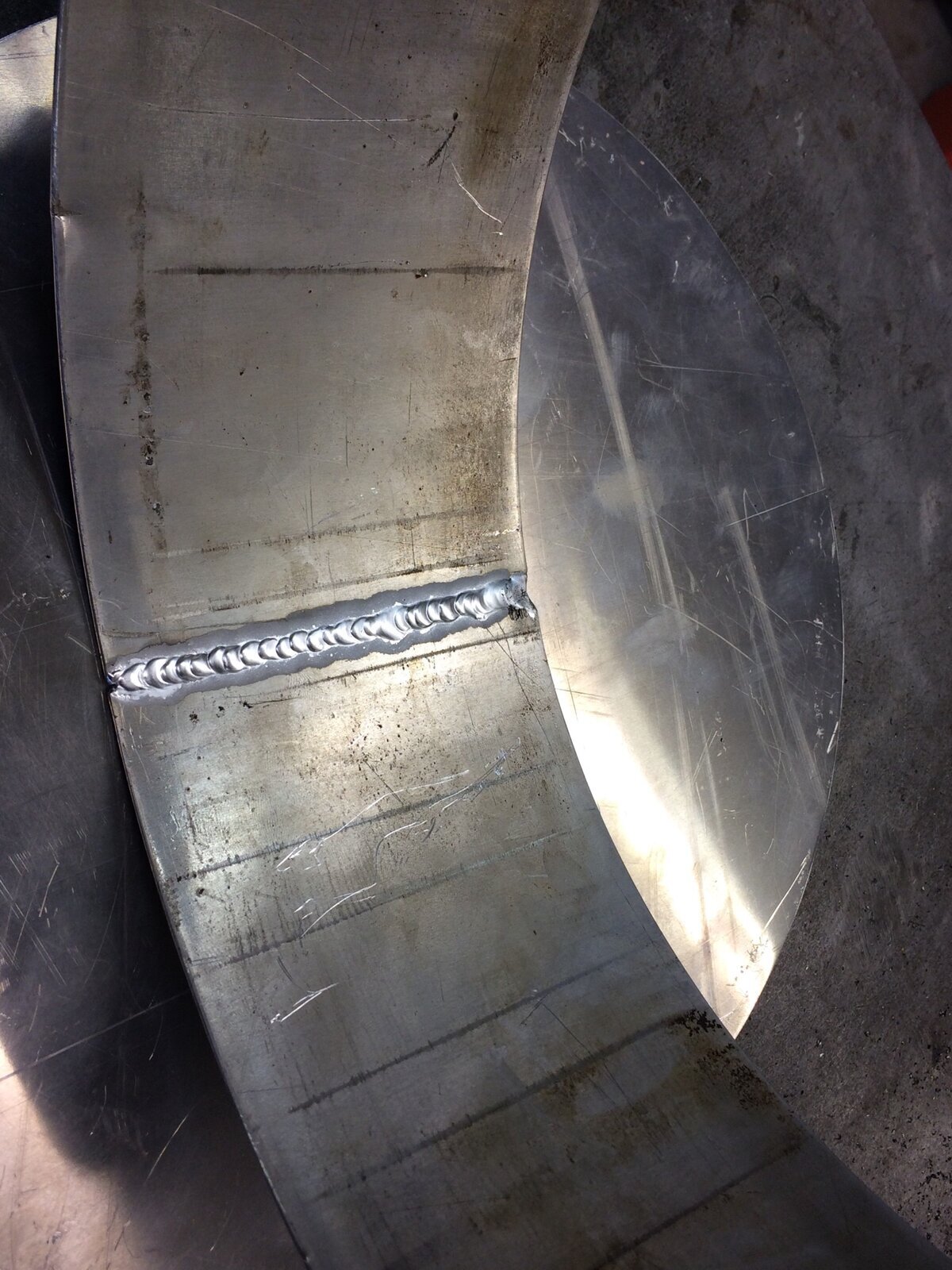

I TIG’d the 2 ends together.
And got it back in the rollers for a final roll.

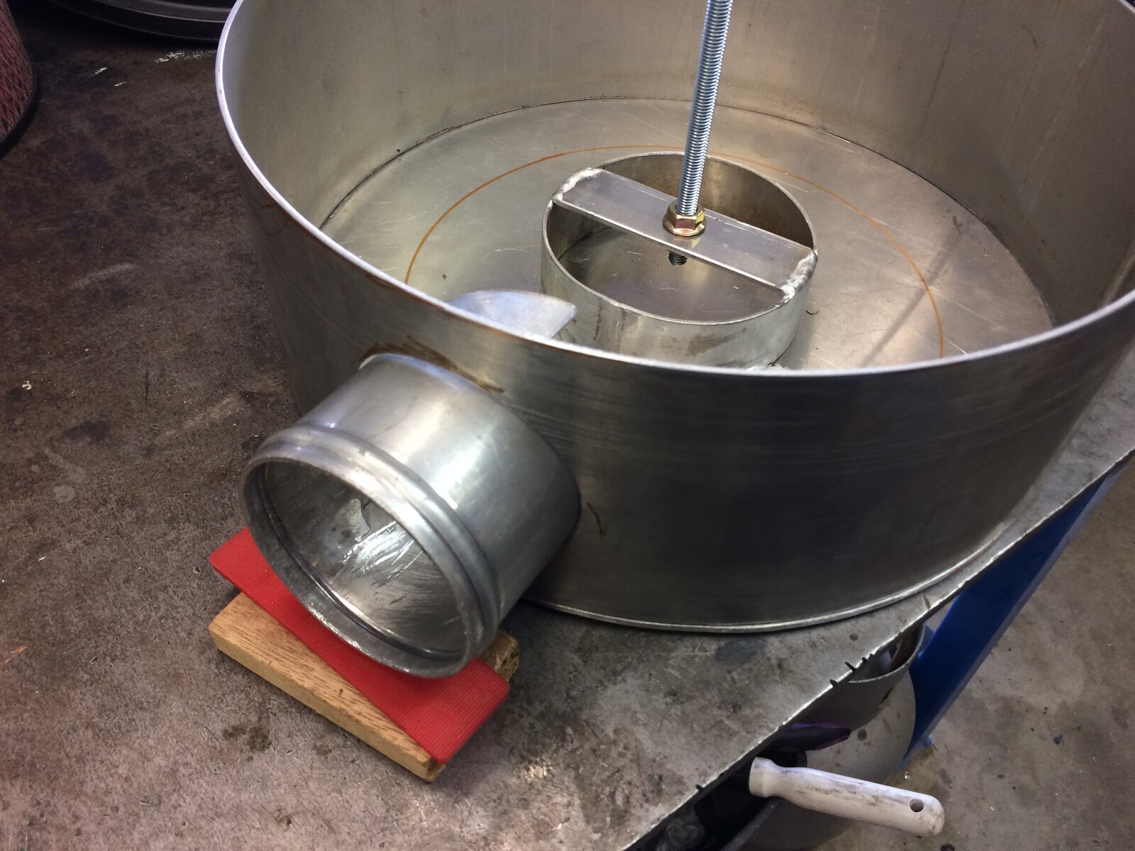

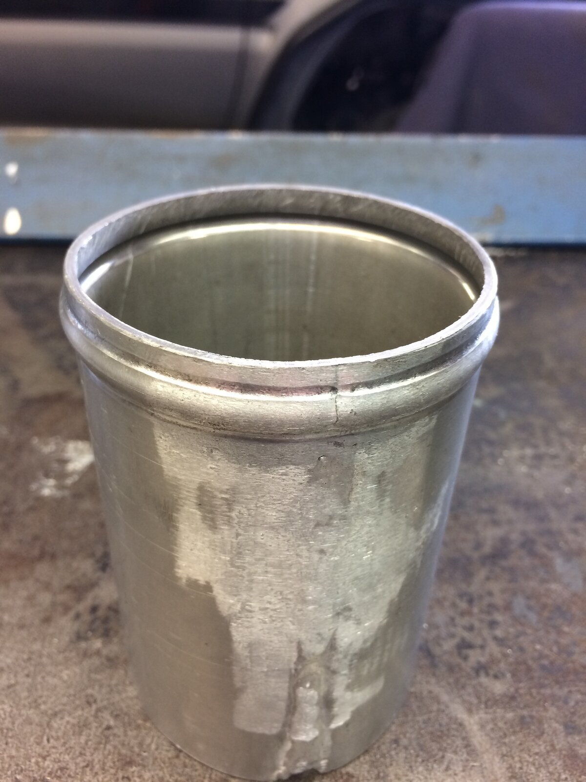

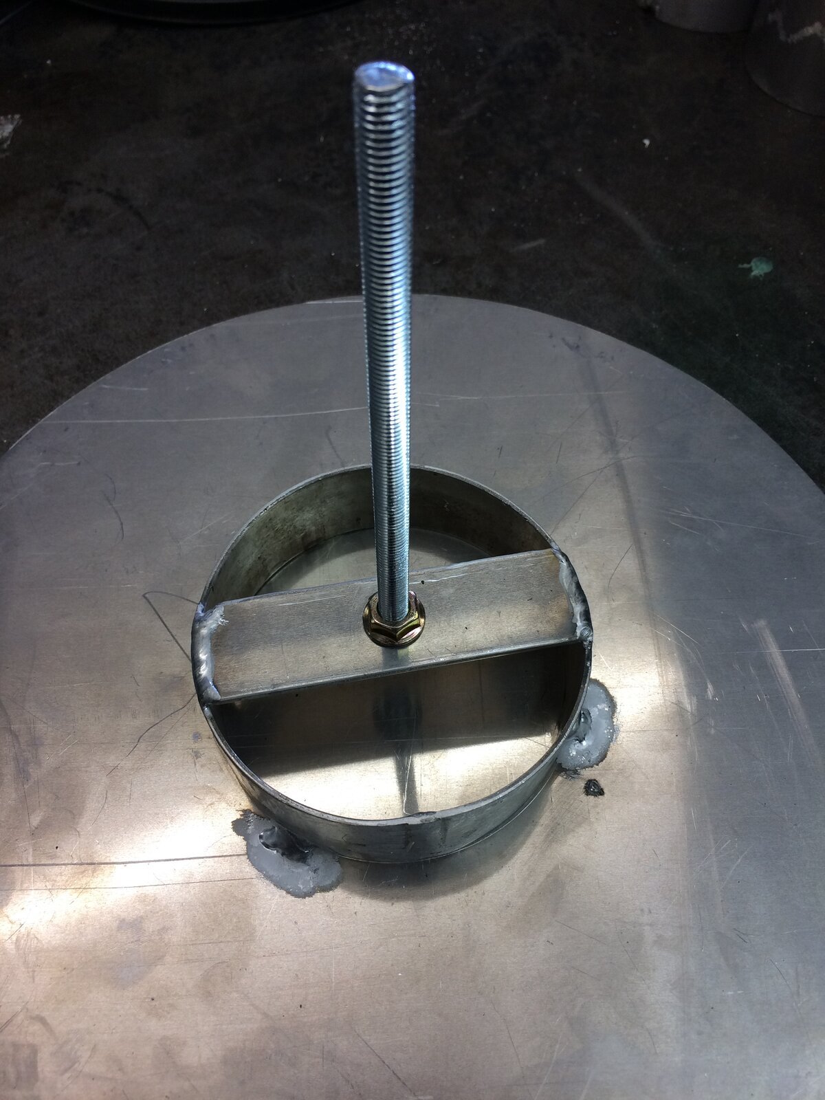

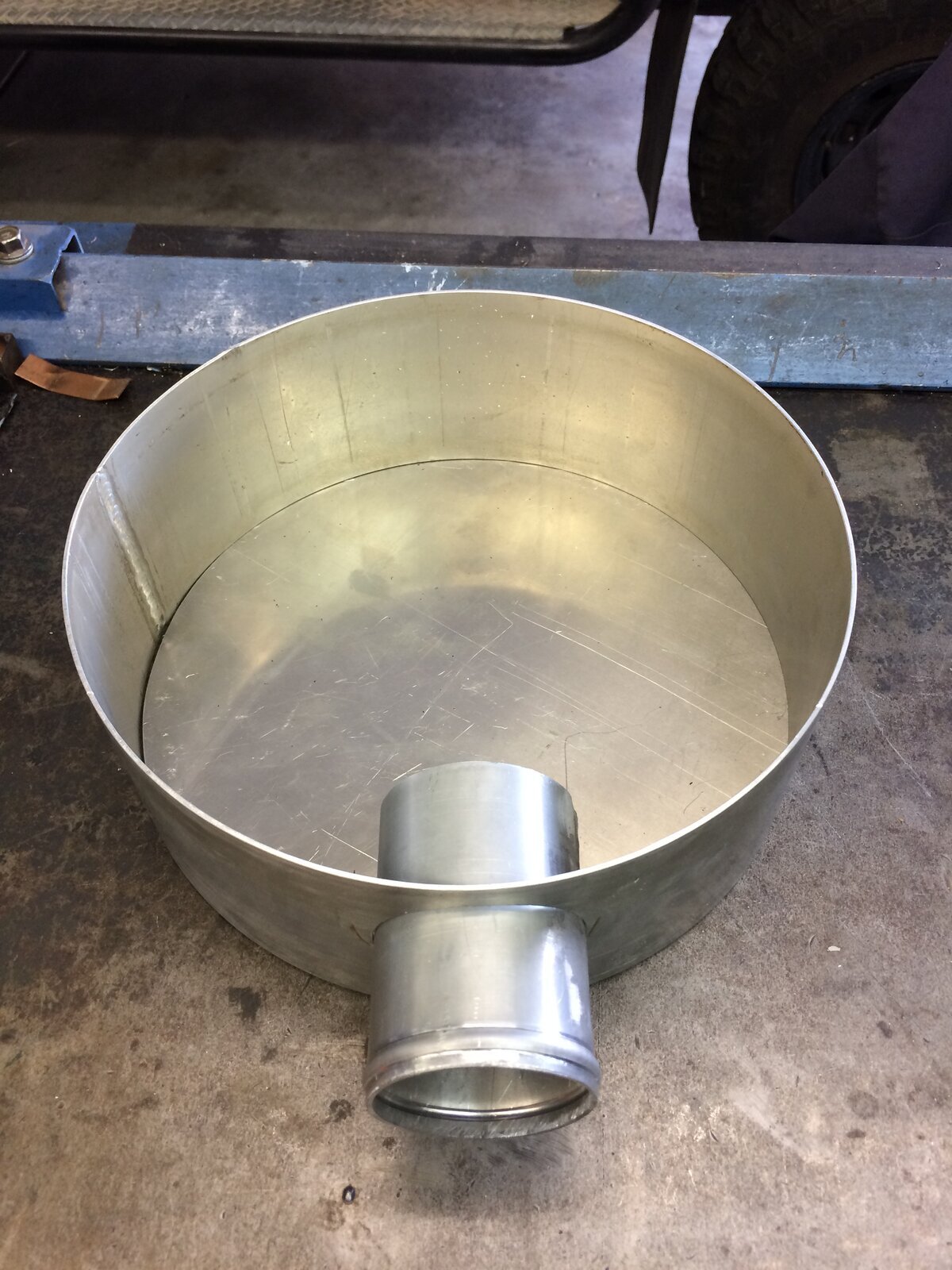

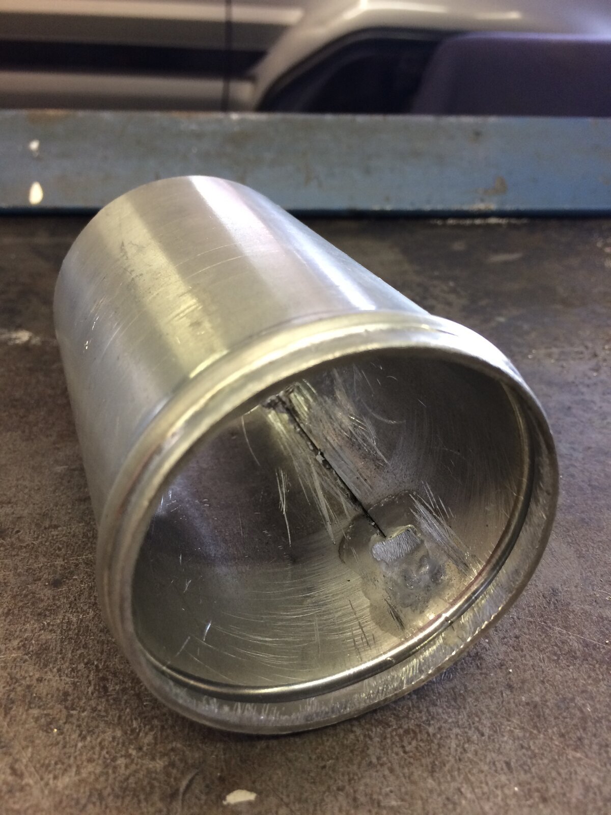

I needed some 3” aluminium pipe for the inlet but as I didn’t have any I decided to just make some.
So I cut and rolled some more 2mm sheet.
I clamped the 2 edges together then welded it and sanded down the weld on the linisher.
And the next day I called in at my local Pirtek, who for the bargain price of $10, bead rolled it for me.
How sexy are bead rolls!

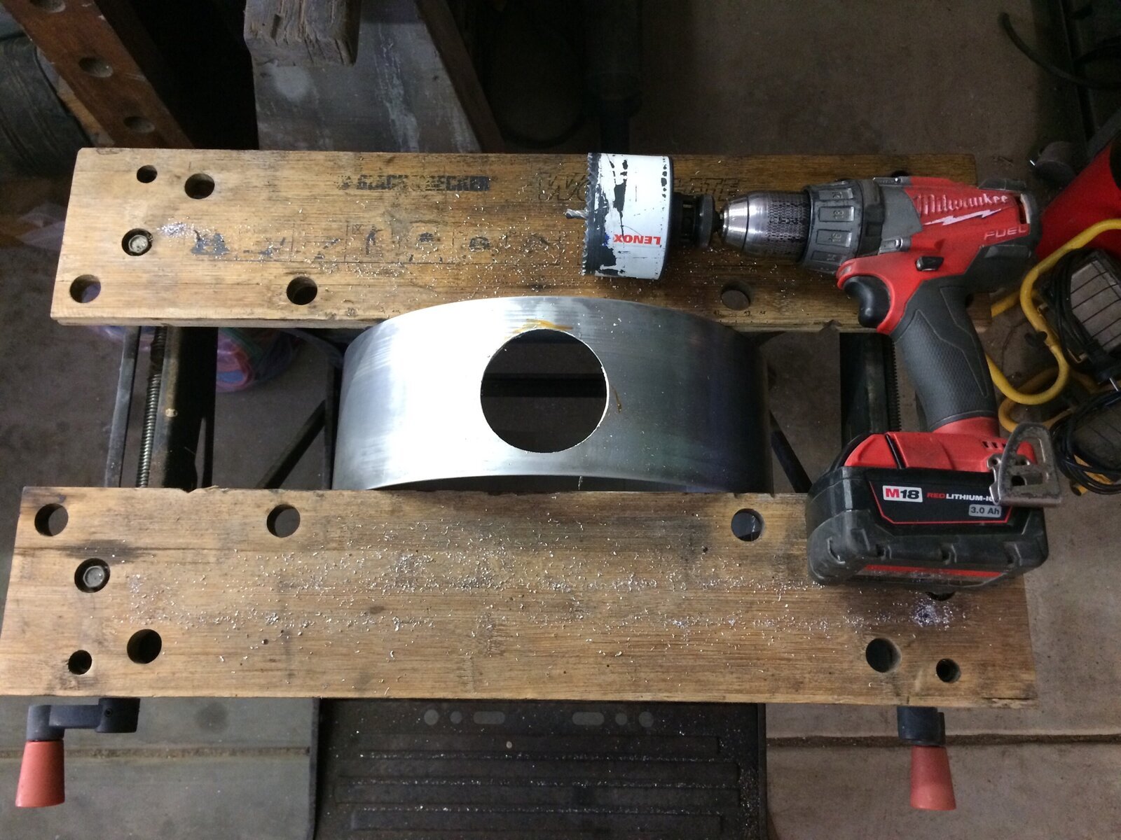

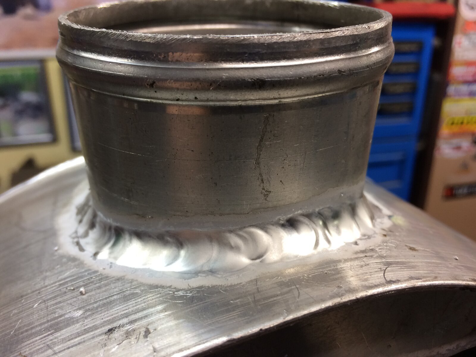

I drilled a 3” hole in the side of the cake tin for the inlet pipe.

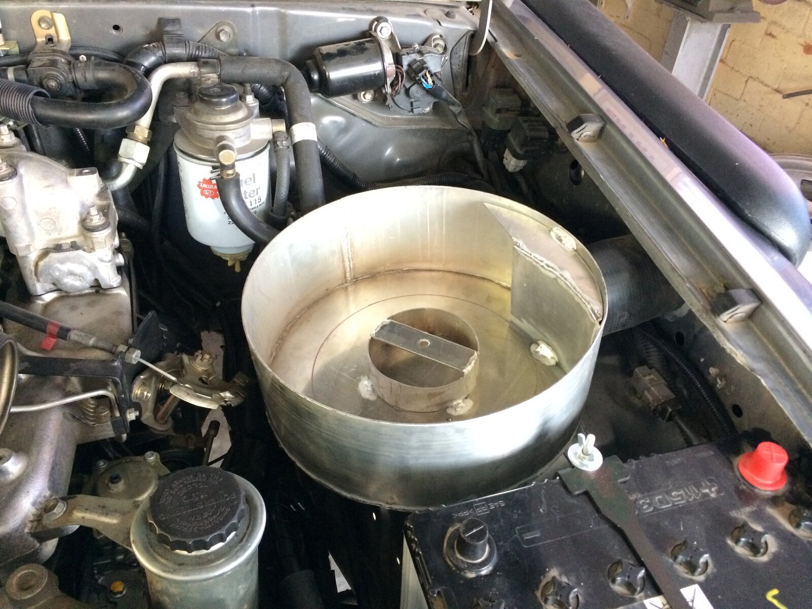

Next I constructed the centre section which helps to locate the filter and also contains the threaded rod that pokes through the airbox lid for the wingnut to screw onto.
Test fitting the standard lid.
I fully welded the base on.

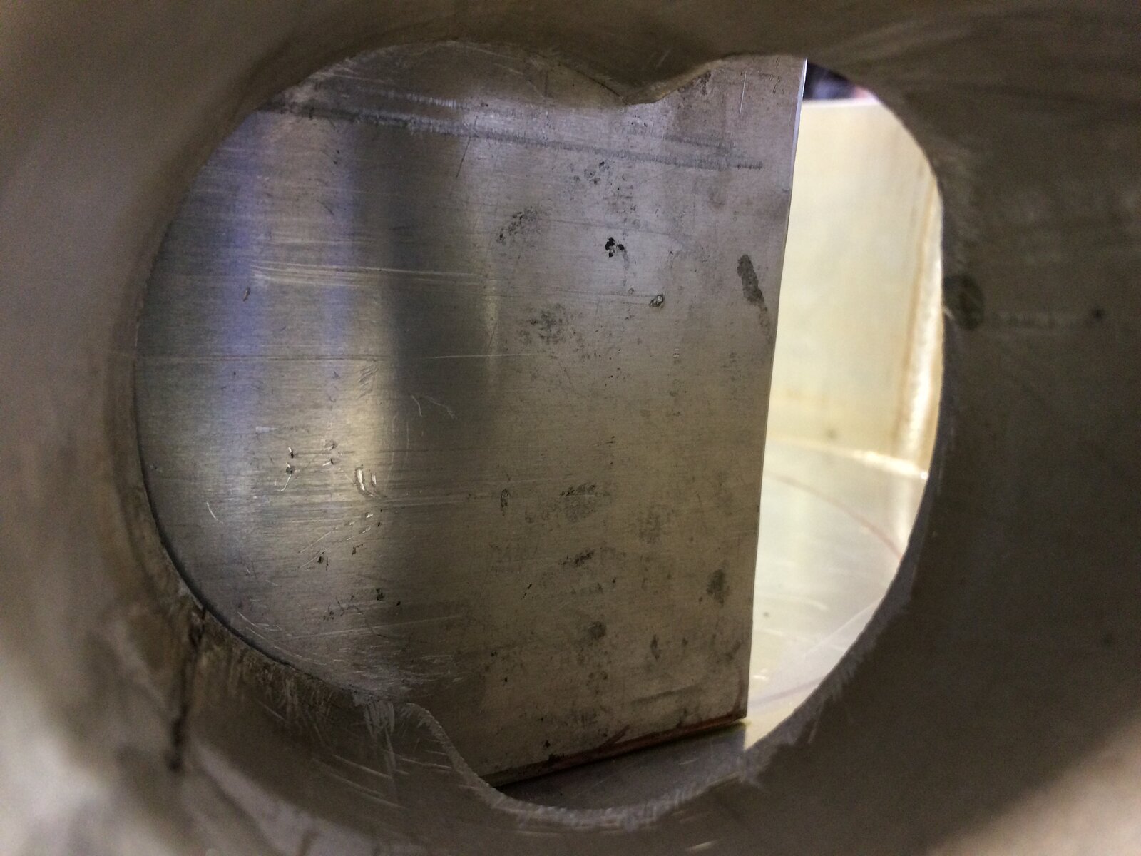

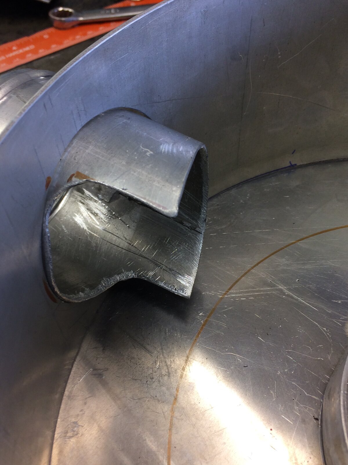

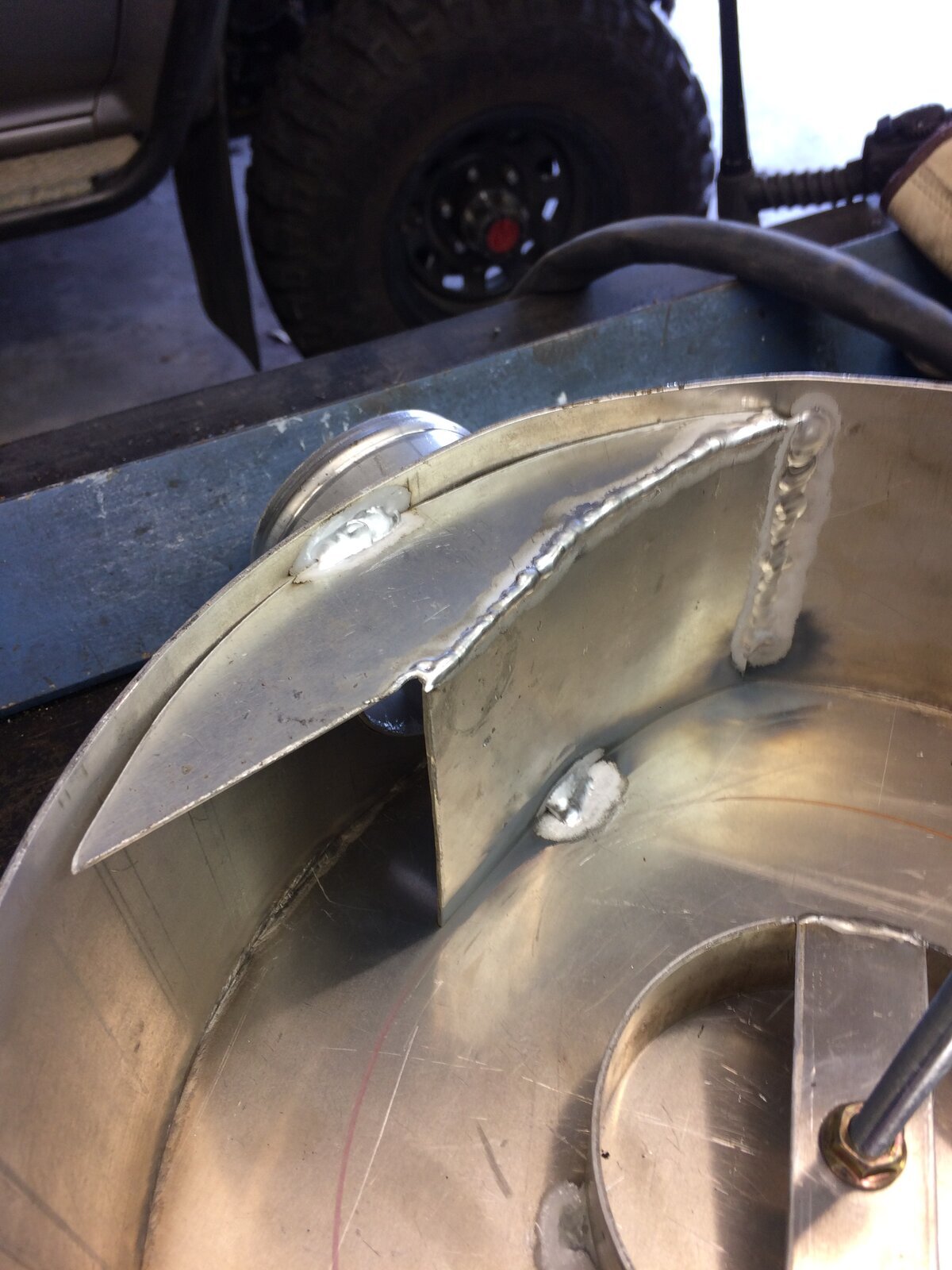

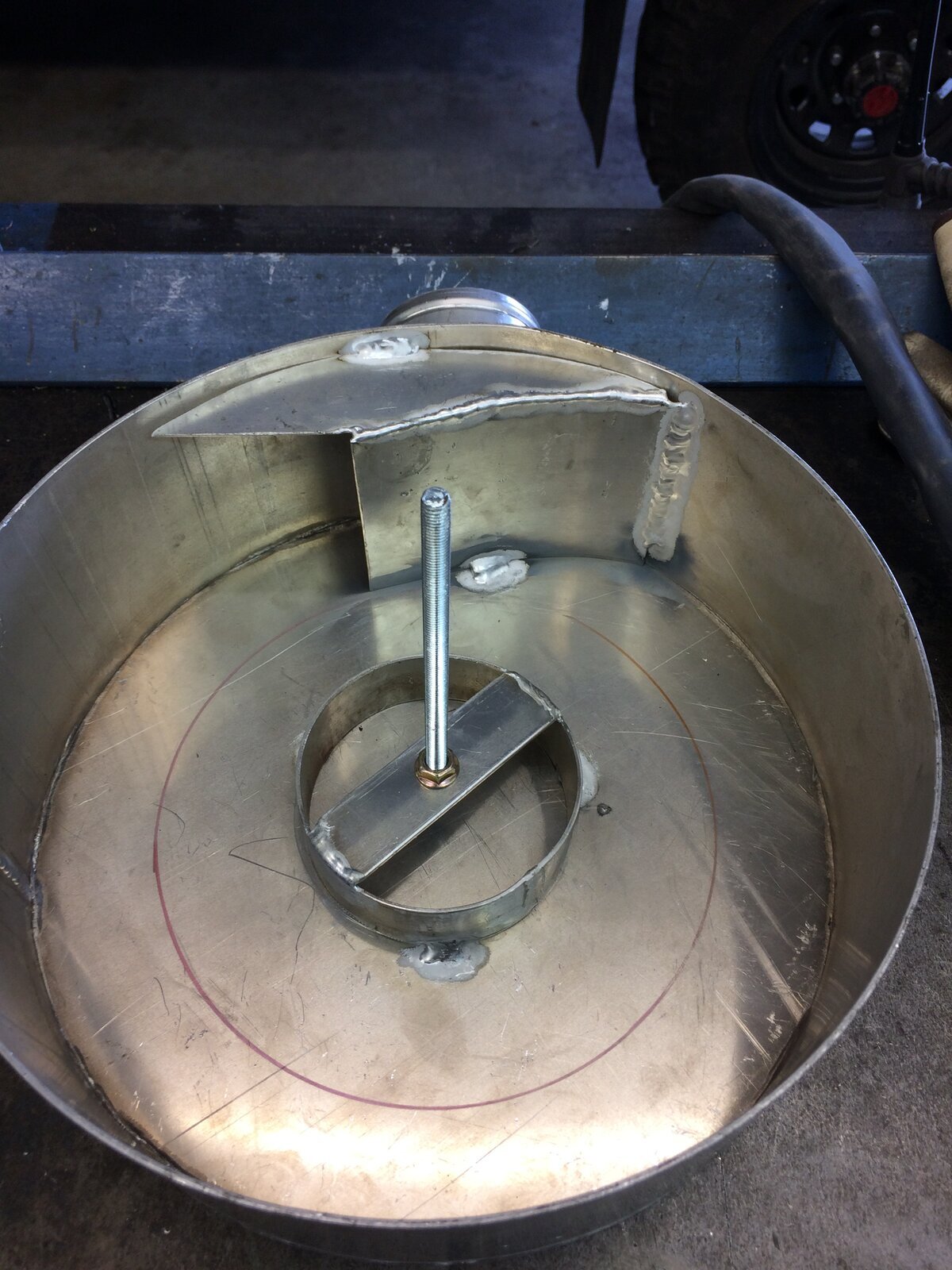

Next I needed to make the baffle, just like the standard airbox has.
The baffle is important as it helps create the vortex affect that these big round Toyota airboxes work on. The idea is the air rushes around the outer edge of the inside of the airbox creating a vortex and all the bigger particles get flung out around the bottom of the airbox and don’t clog the filter.
It’s a shame the newer LandCruisers no longer have this style of airbox, because if they did there wouldn’t be anywhere near as many destroyed engines in 70’s and 200’s from dust ingress. The flat, road car style filters just don’t work as well in dusty conditions and there’s no vortex affect!
Anyway, back to the build......
I made the baffle.
Trimmed the end of the inlet to suit the baffle.
Welded the baffle in position.

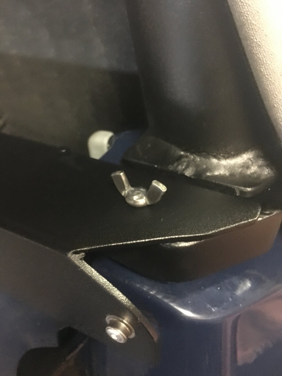

I fitted an auxiliary battery tray on the passenger side of the Car.
Fitted a battery and then got the airbox in position to test how it fitted.

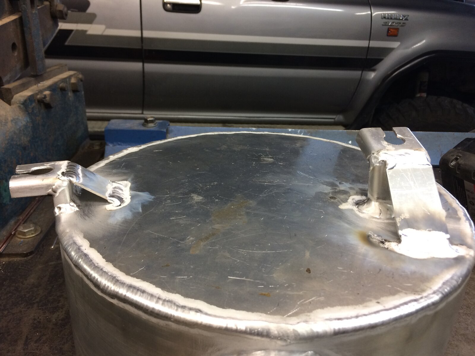

That all looked good, so I pulled it out and fully welded the inlet on.
This view shows the baffle and how the air is forced around the inside of the box and not just straight through that little section of filter.

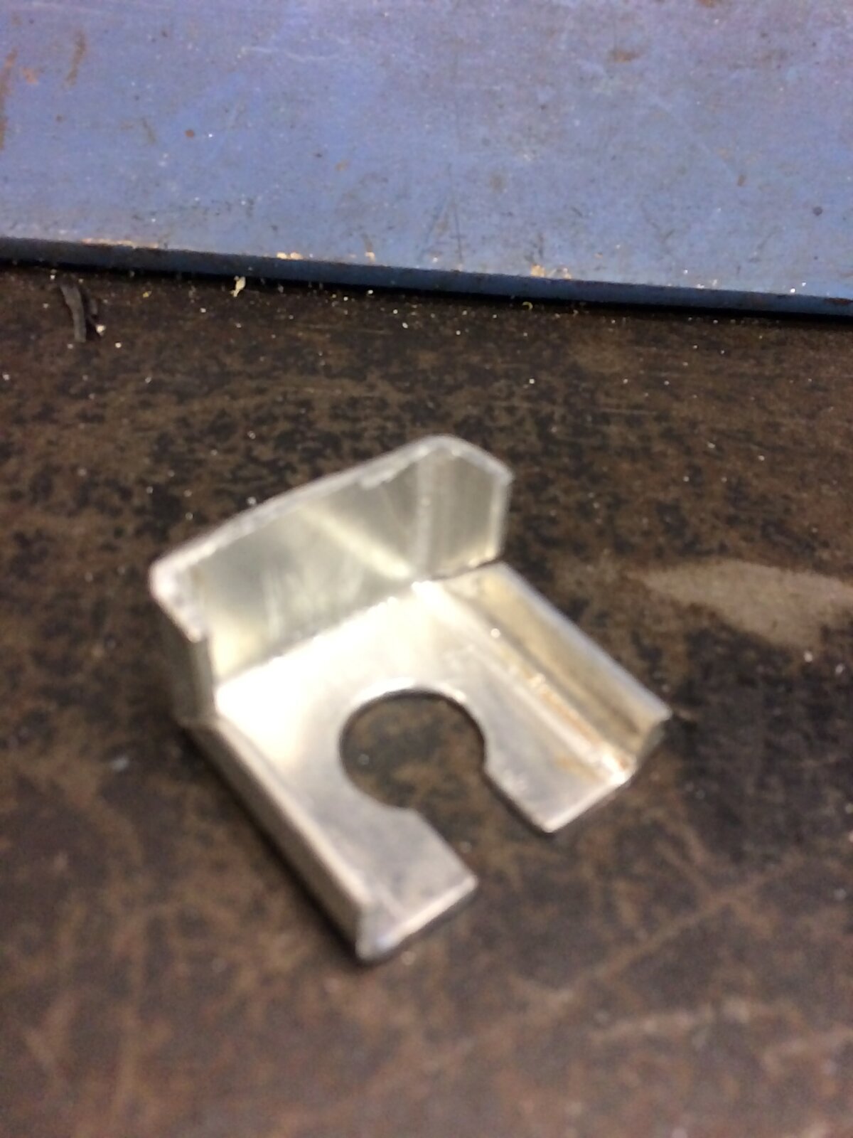

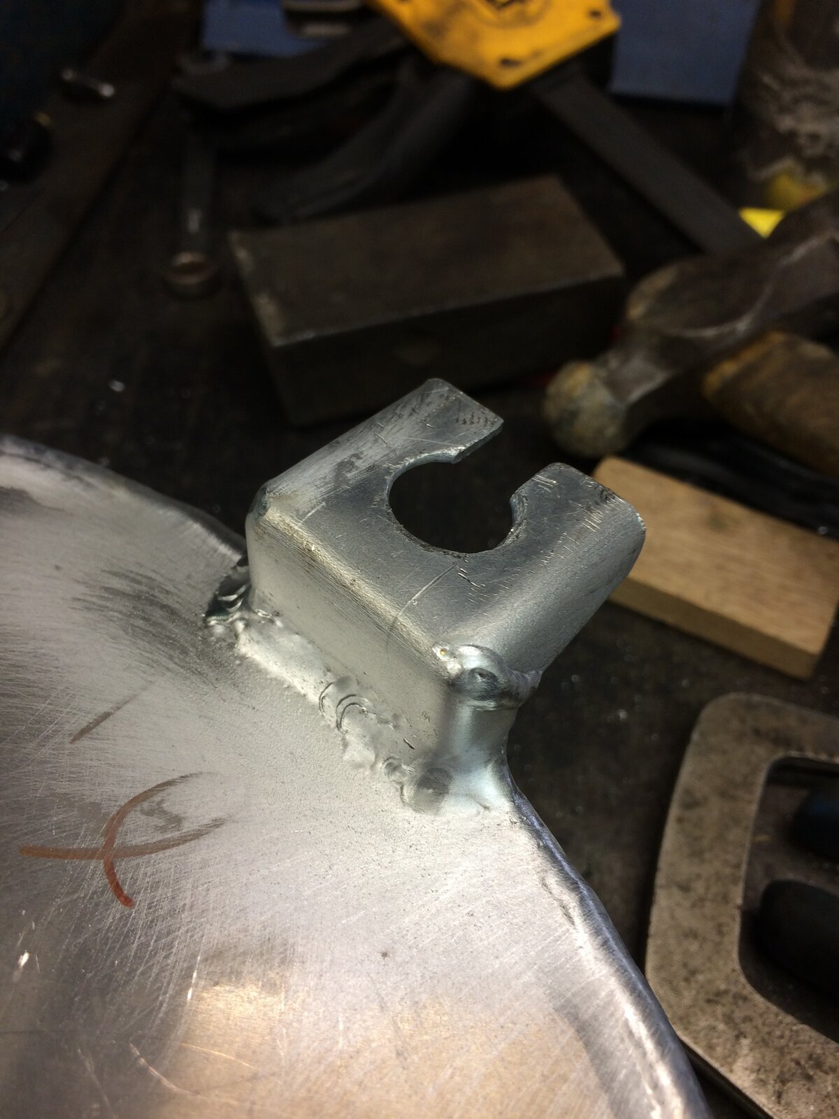

Next I needed some mounts to bolt it in position in the car.

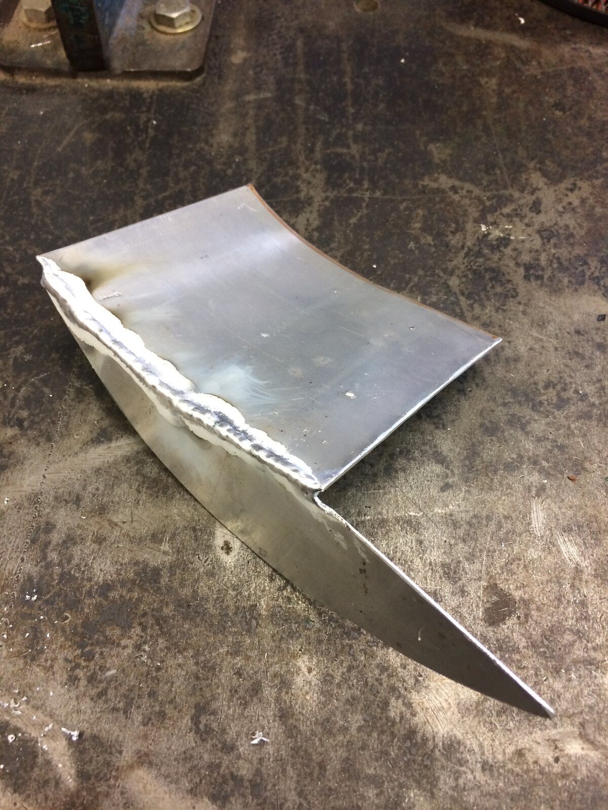

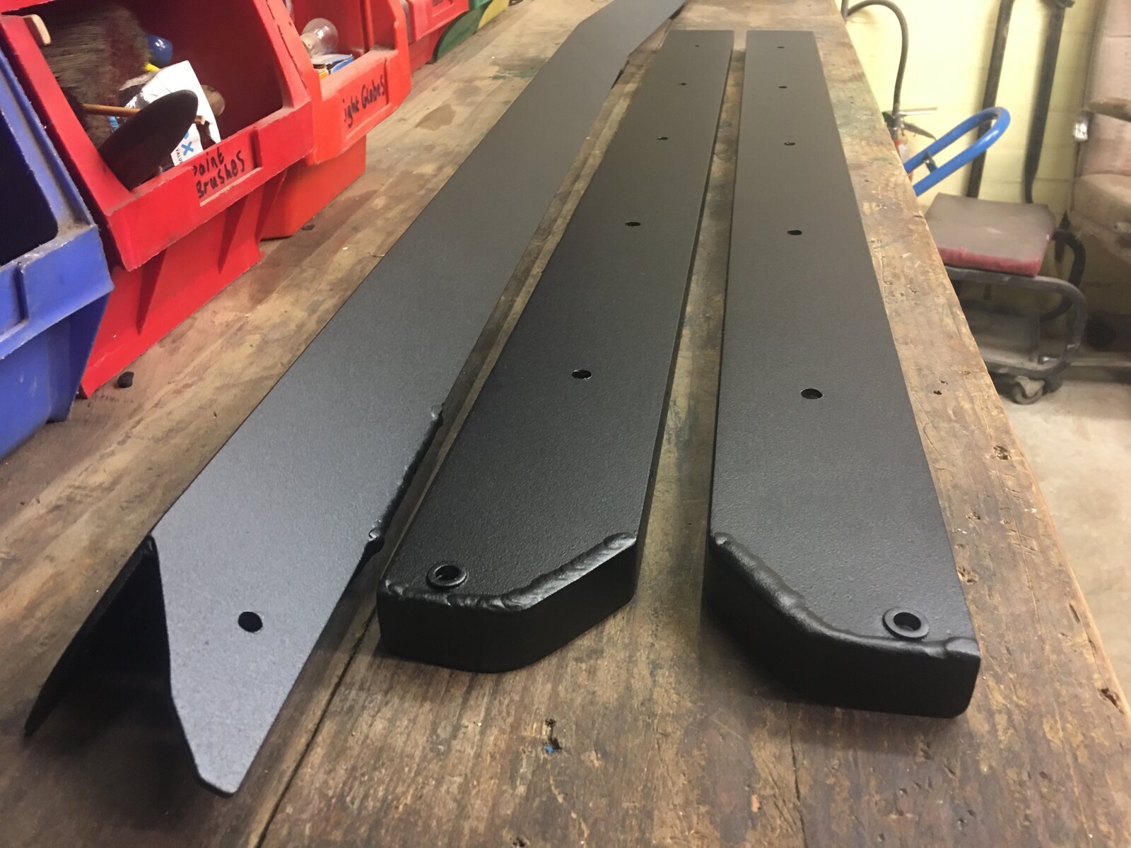

I cut and folded some 3mm aluminium sheet.
The idea was to copy the factory mounts as much as possible.
Folded it to the correct shape and size and drilled a hole and cut it out to take the factory rubber mounts.
Welded it on.
Made and welded another one on.
Added some braces to reinforce them.

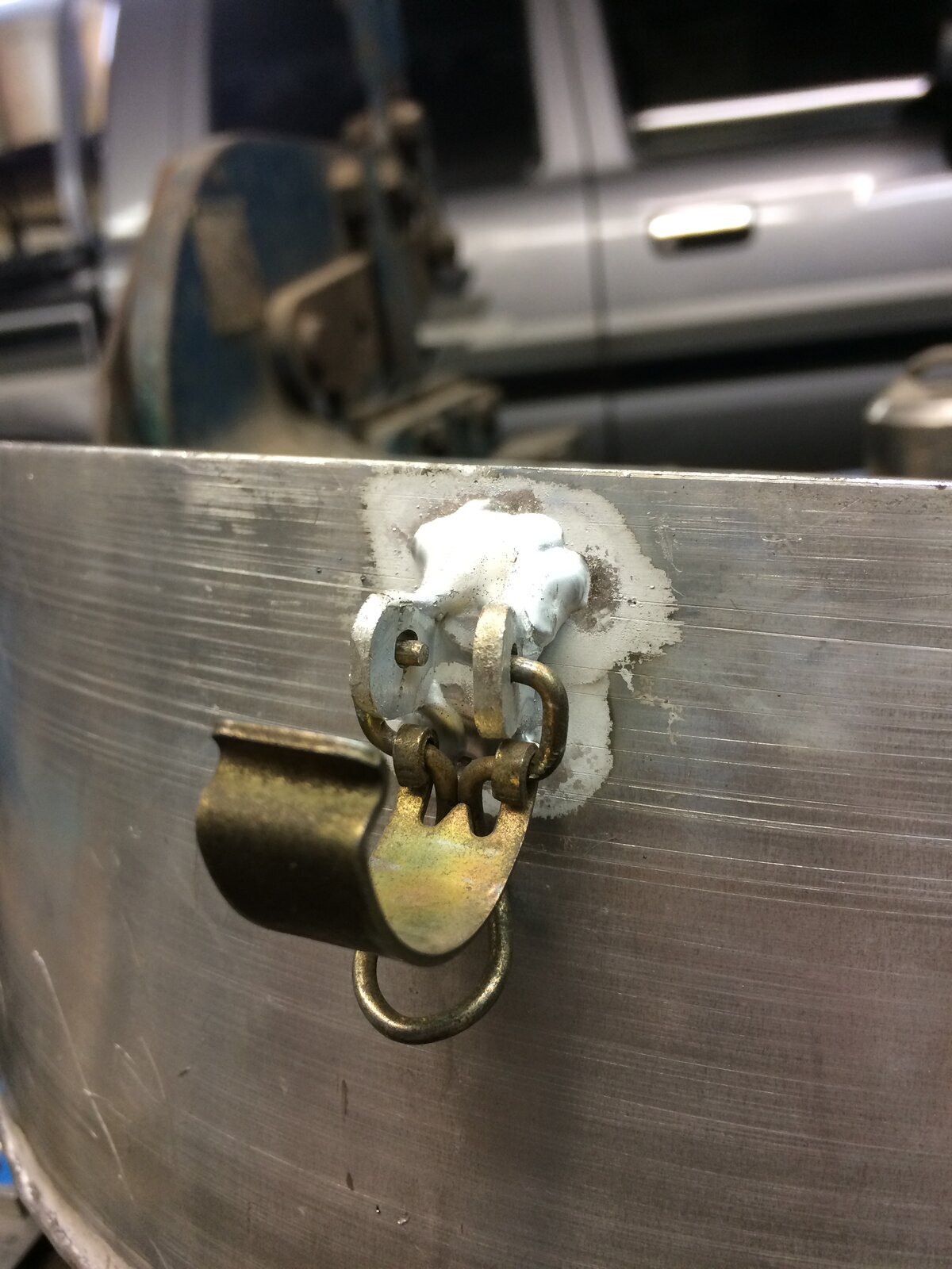

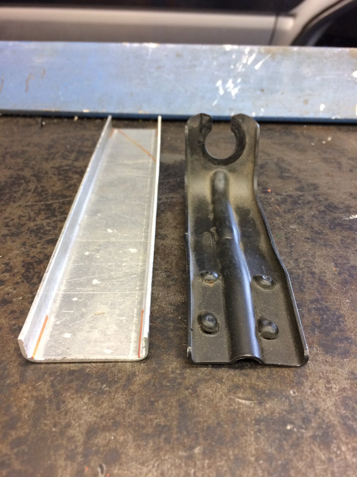

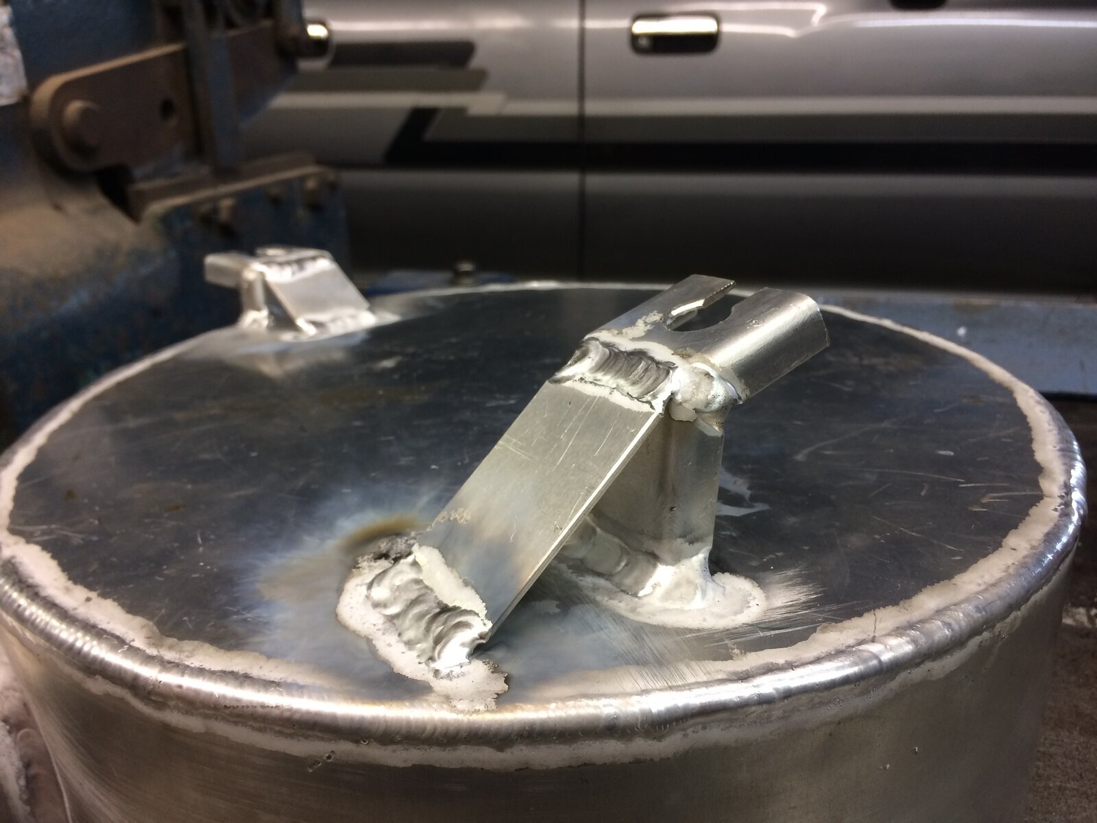

Next I needed to make some brackets for the factory over centre latches to mount to.
I found some channel the correct size in my aluminium store.
Cut and drilled it.
Welded them on.
Tested they worked.
It was then ready to be powder coaed.
I got the lid and the new box both powder coated satin black.
Then glued all the rubber seals in position on the box and lid.
Bolted it in position.
So I’ve now got that factory look I wanted and room for an auxiliary battery! :dance:

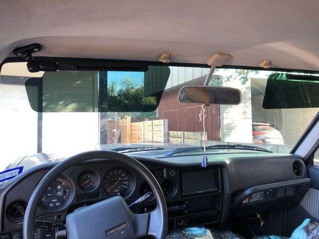

I have a question from some while back, how did you find the sun shade on the LJ ? I am considering getting one, but i am quite tall, 191 cm, and already need to bend whyle driving, in order to see the traffic lights. Did this ever bother you ?
Thanks Mircea. :thumbup:
I really liked the sunshade and found it worked well. However you will need to duck to see traffic lights unfortunately.
It never bothered me as I didn’t have that many traffic lights near where I was living, but for someone who’s tall it may be an issue. :think:
Yeah, thanks, i figured as much. It may be overkill, but i plan on replacing the sun visors with the tinted airplane ones, because i can look thru them. I never use the visor while driving, because i have to stoop to see.

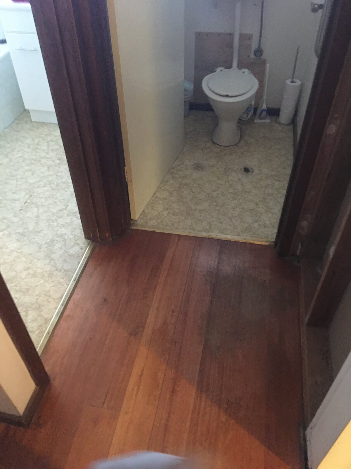

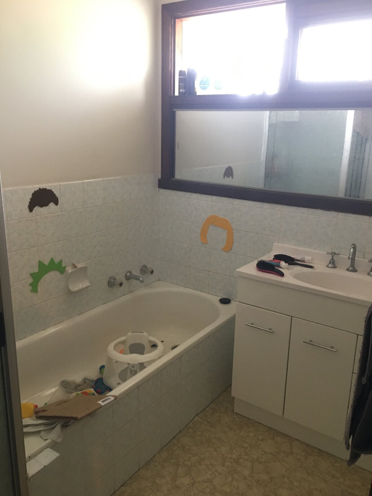

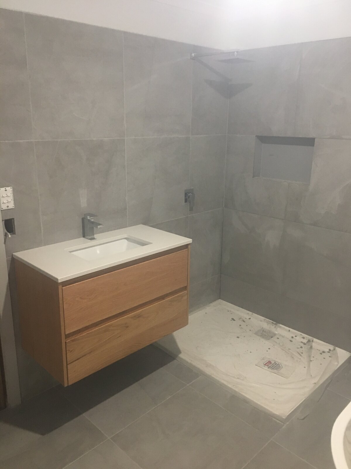

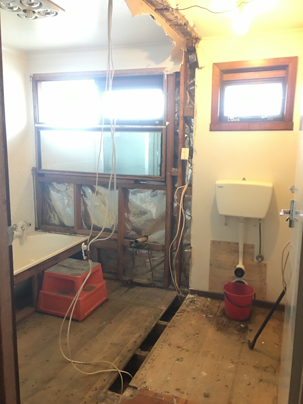

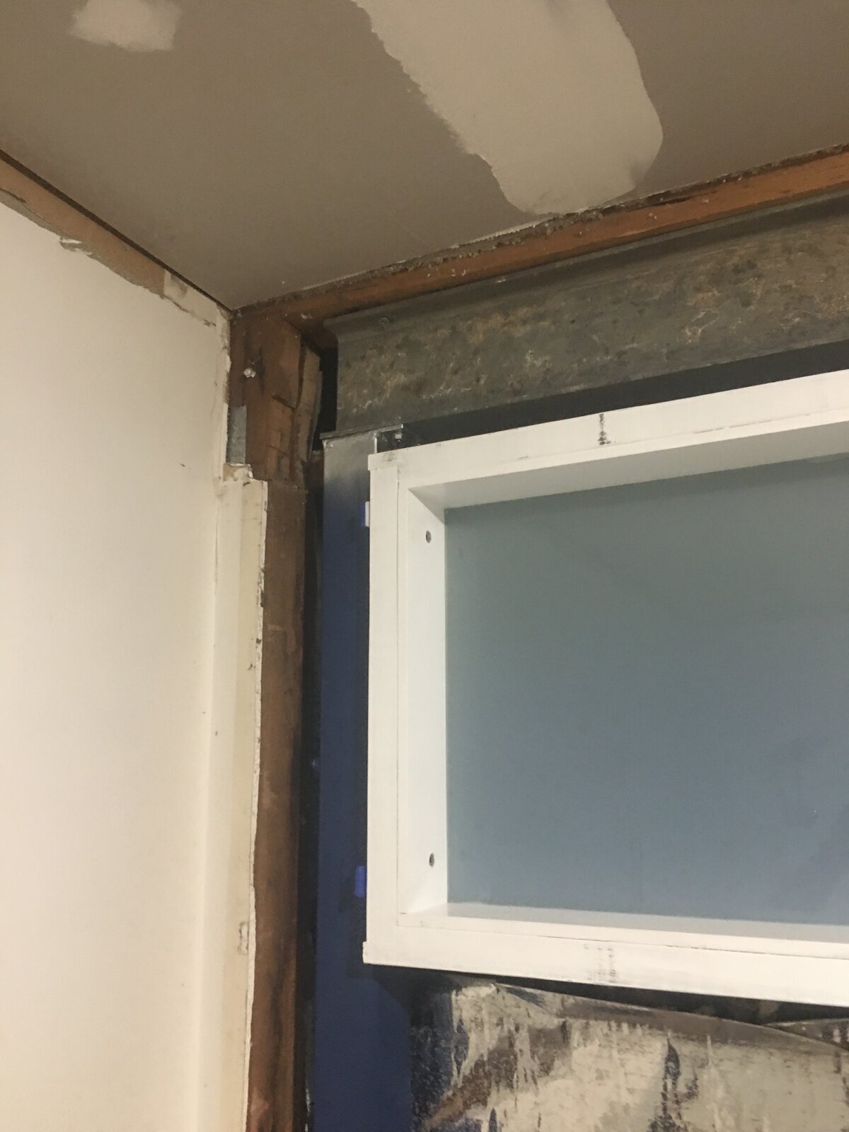

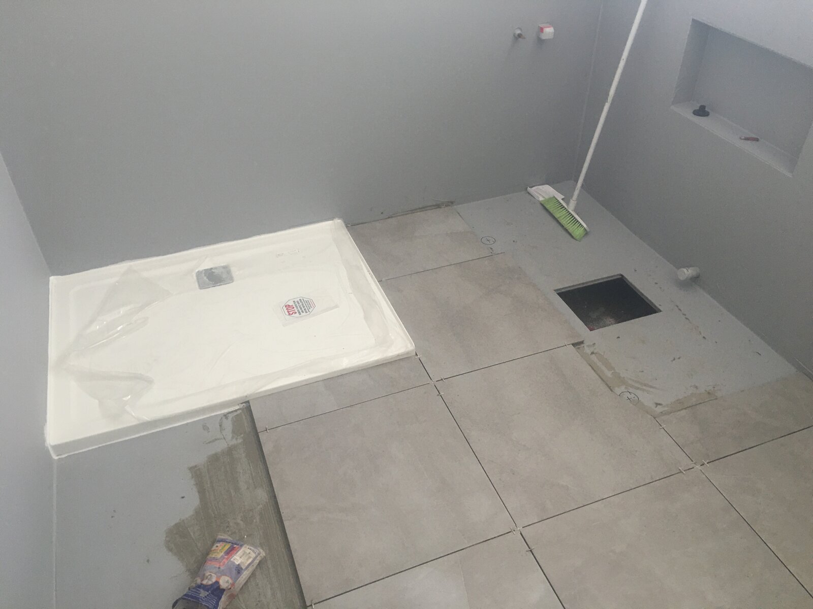

I finally renovated the bathroom, which turned out to be a huge job.
Our original 1970’s bathroom and seperate toilet, which had a wall separating the 2 and a square meter of wasted floor space that I wanted to incorporate into the new bathroom, by knocking the dividing wall out and moving the door out to the hallway wall.
The wall came down first.
Which meant there was now 2 different sized windows in the room, which didn’t look right.

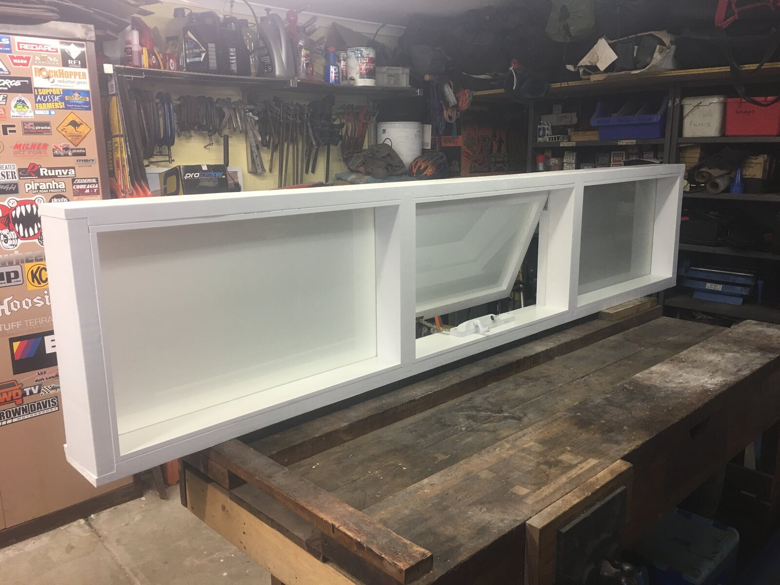

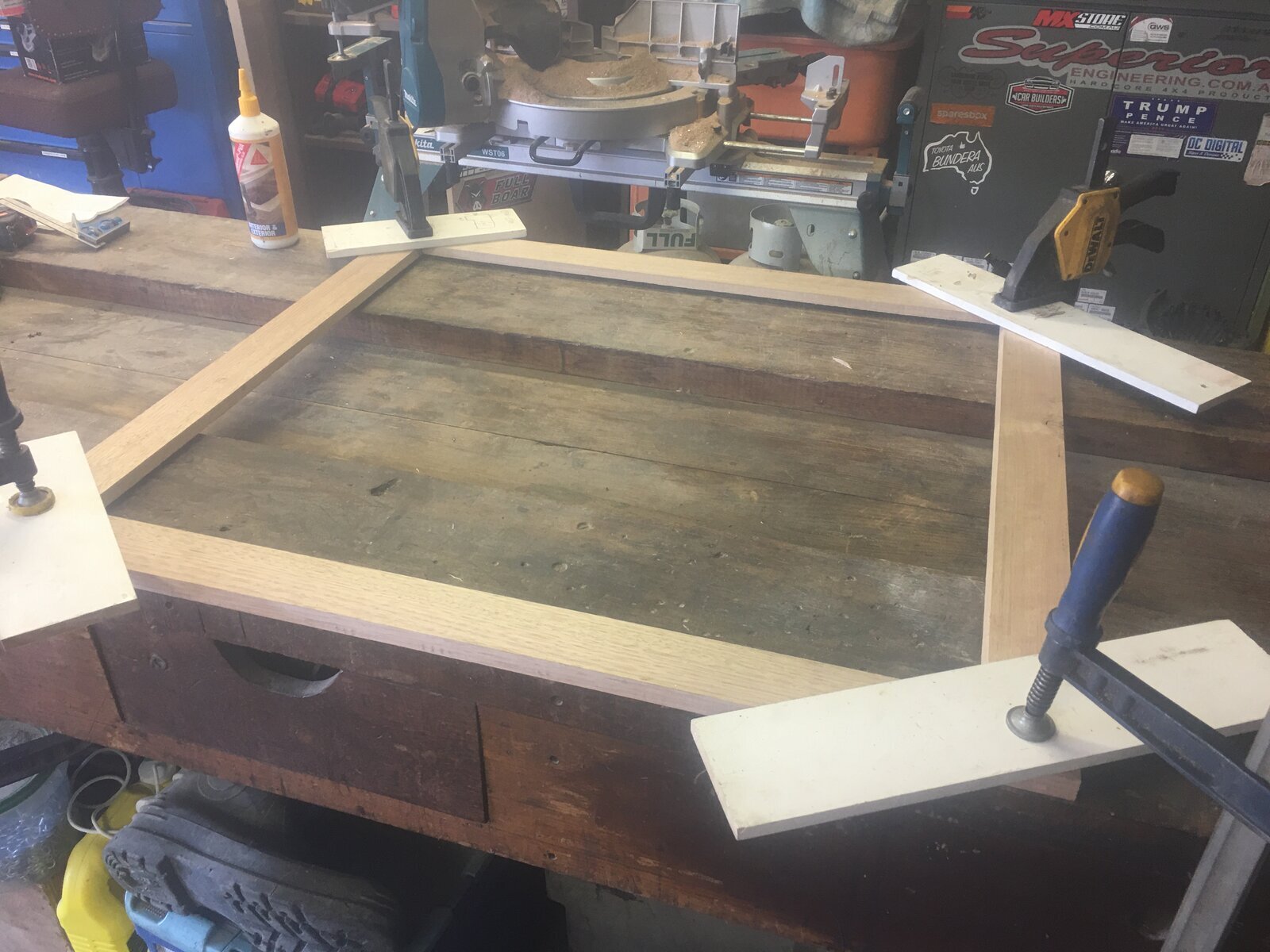

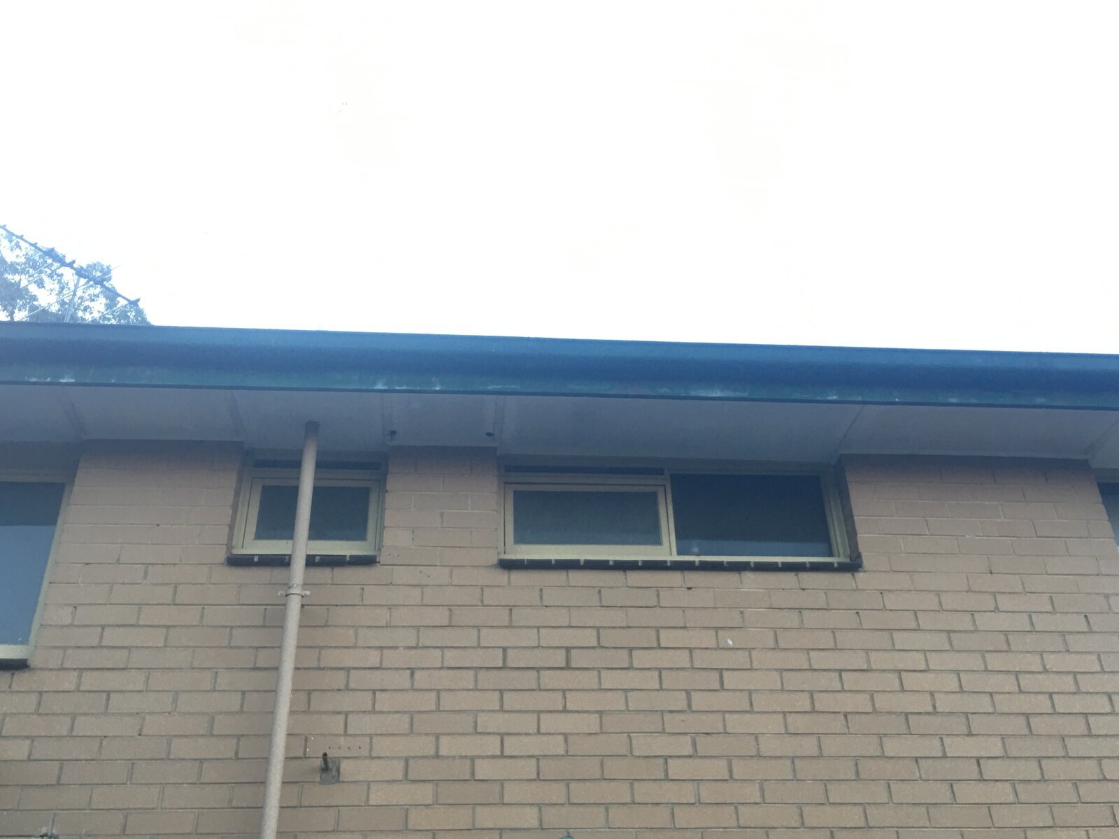

So my next task was to build a new window, to replace the 2.
View from the outside.
As the house is a brick veneer house, the brickwork isn’t actually load bearing and doesn’t hold the roof up.
The hardwood timber stud wall behind the brickwork holds the roof up.
I decided to add some steel to help hold the roof up as the concrete tiles (which I will be changing to corrugated tin when we do the extension) are very heavy.
Old windows out, brickwork removed, new steel and window in.
My OCD required the window to be central of the room with equal reveals each side of it, so I had to build out the brickwork on one side.
After plumbing, insulating and plaster boarding I could apply a waterproofing coating.

Rebated some Tasmanian oak on the table saw.
Sanded and varnished.
Fitted the mirror into the frame and installed it.

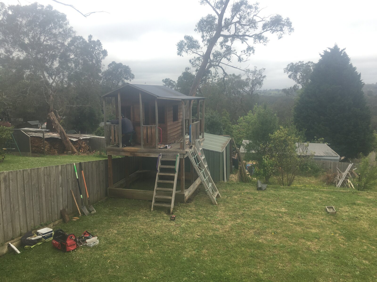

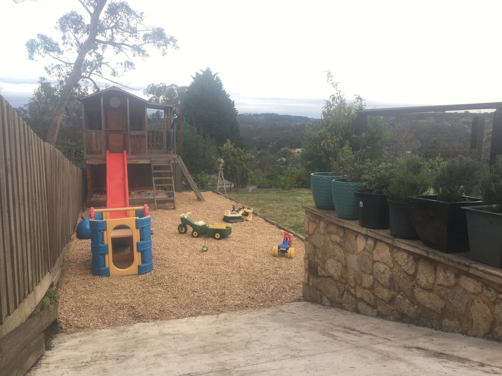

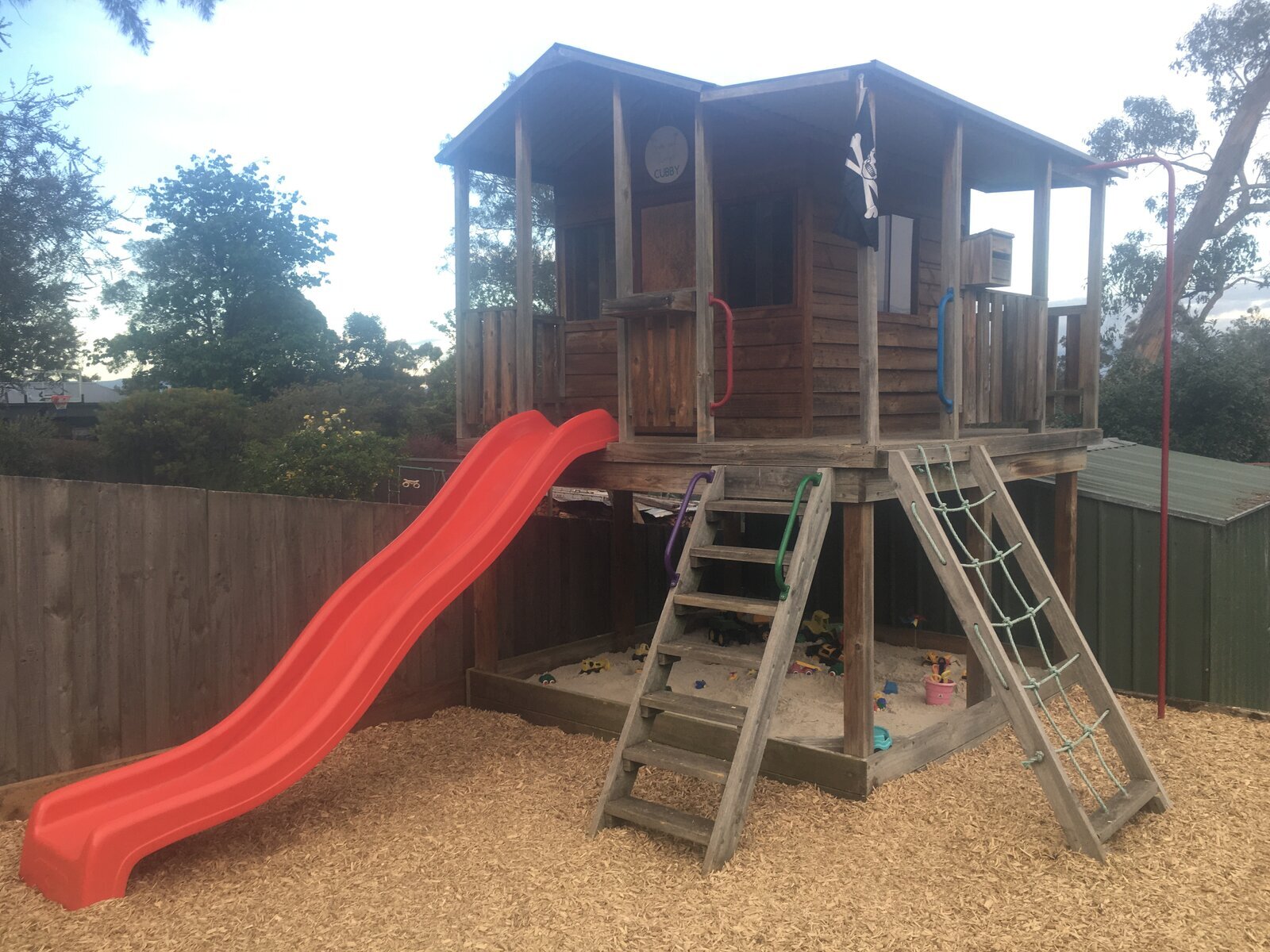

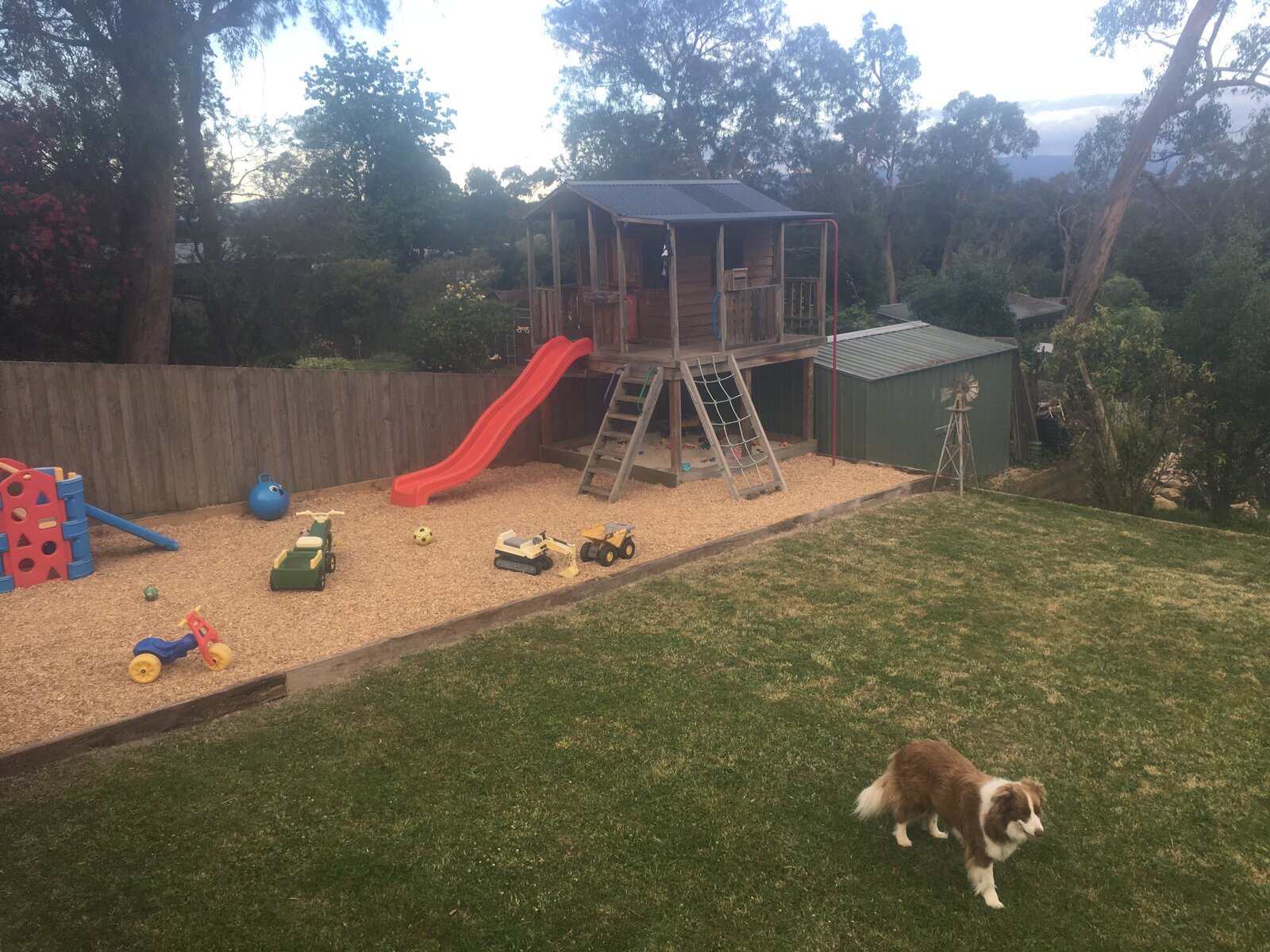

In October I dismantled and re-assembled a cubby house for Sams 4th birthday. We managed to keep it a secret and it was a great surprise for him. He loves it!
Sand went in……
Some sleepers to retain the pine bark.
Installed the weed matting.
Picked up 5 cubic meters of pine bark.
All ready for the big reveal.
His face when he saw it for the first time!

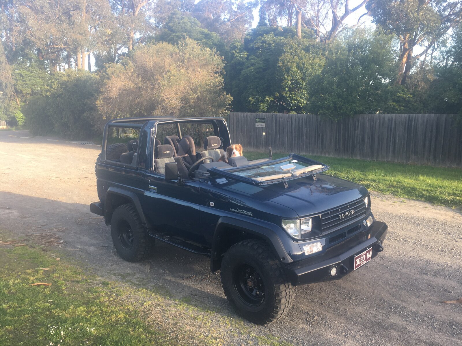

Now that the V8 engine is running properly after I diagnosed that one of the coil packs was faulty and then fitted new coil packs and HT leads. It is a lot of fun to drive and the power is incredible in such a small light 4wd!

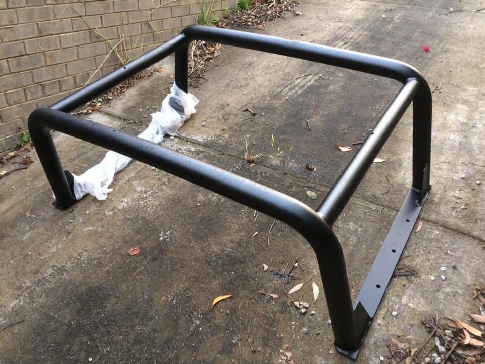

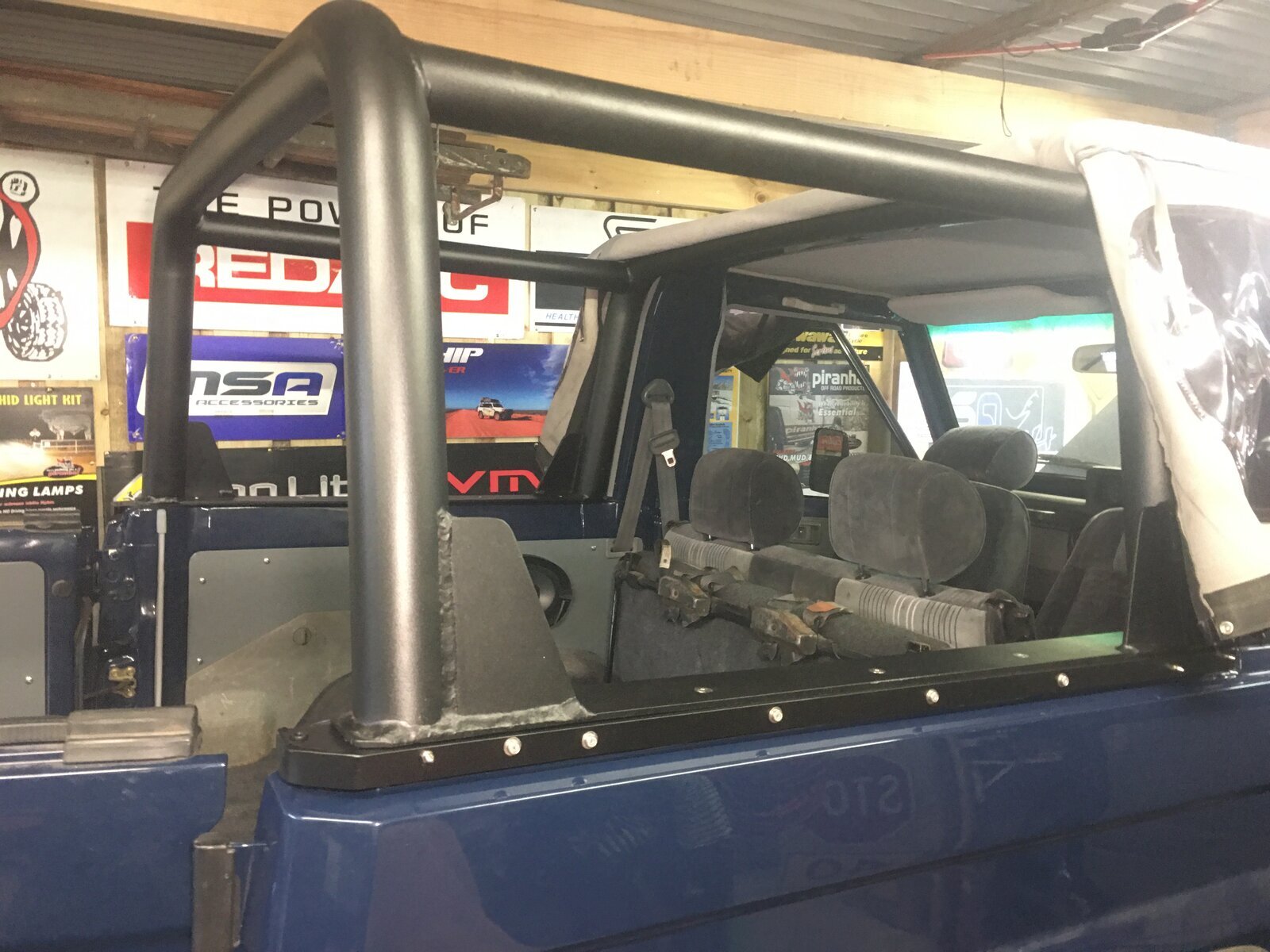

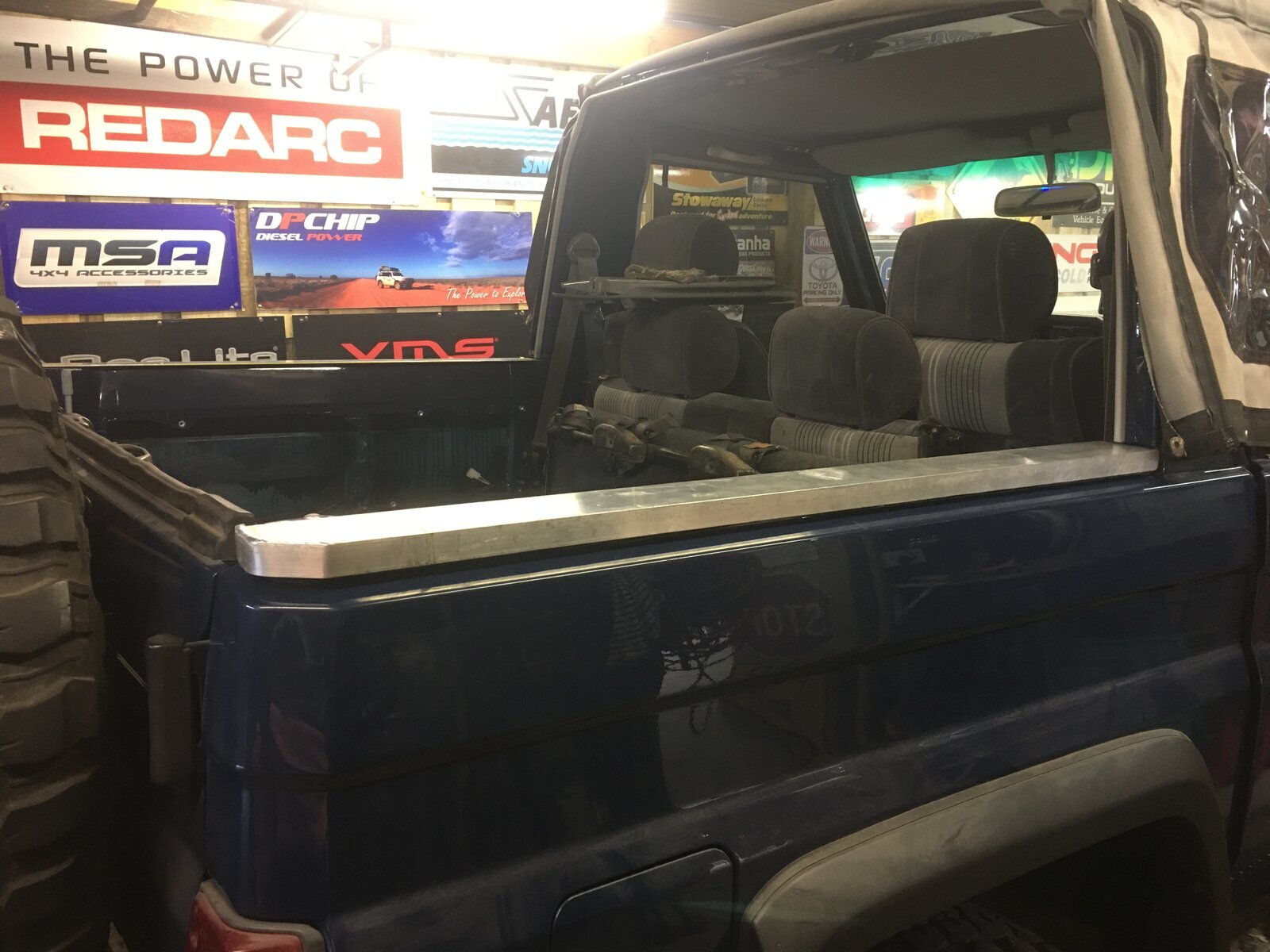

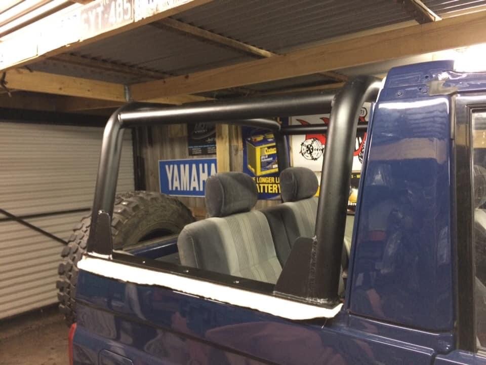

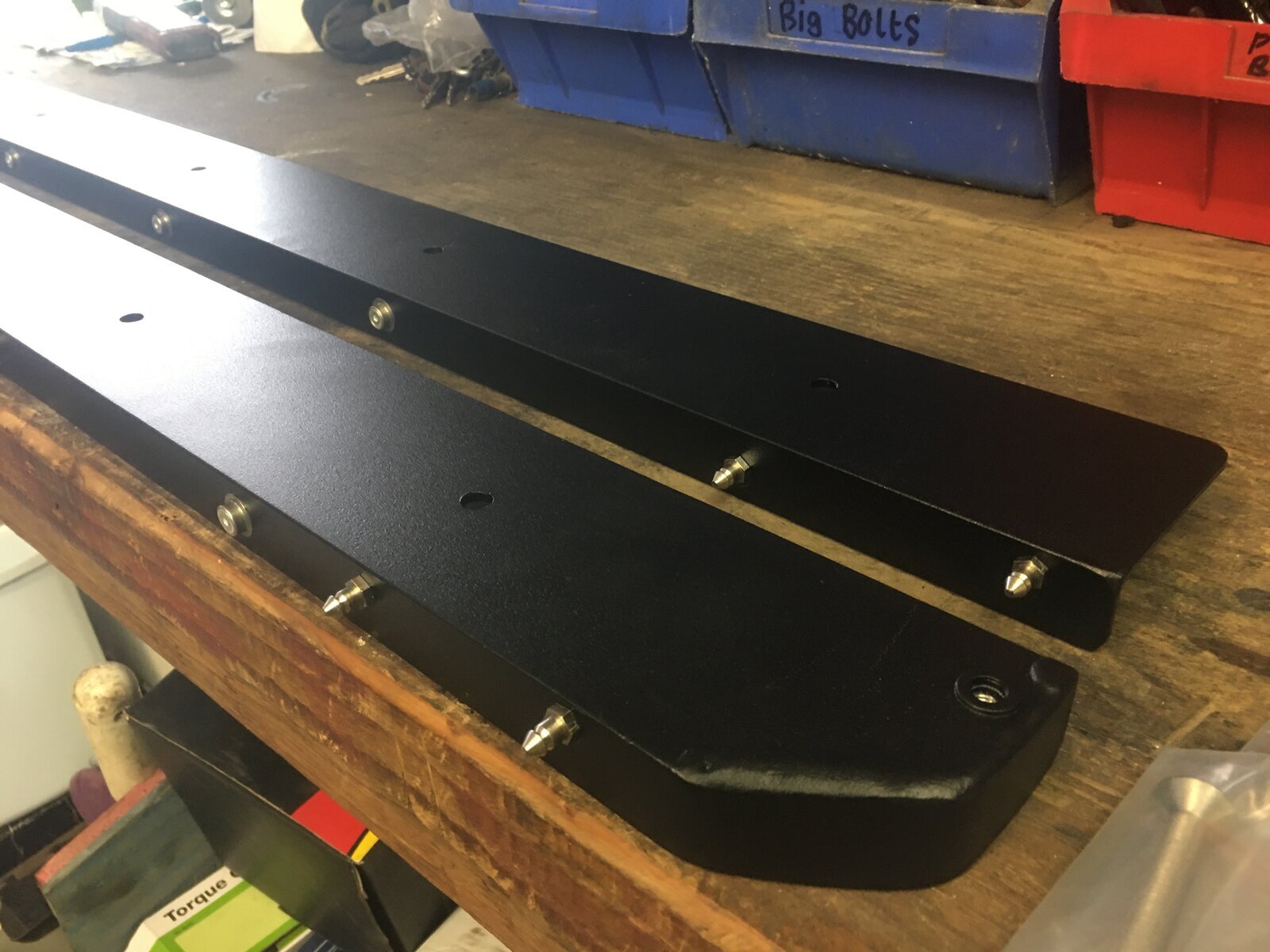

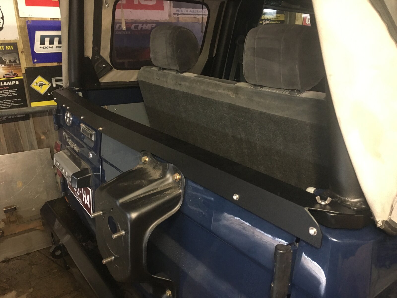

I decided in order to make LJ more usable, all year around I should re-fit the canvas roof and aluminium cage the soft top body came with.
So I got the bare aluminium cage powder coated texture black, as after being stored in the garden for the past 4-5 years it was looking a bit tatty.
I didn’t want to drill holes all over the body and rear doors for the press studs to clip onto, so
I came up with a solution.
Aluminium angle.
10857A3B-7481-4484-BD6A-A807CD49B5A7.jpeg7E600C55-ED77-409B-A231-2CB82CB9127D.jpeg2E6A5701-CB5E-4445-9D2D-C4FBF305B733.jpeg6DDE7C3F-C25D-442A-8303-6B3854BA708F.jpeg
Powder coated textured black.
506792E0-04B0-4B8E-B05C-2827F56F6F2A.jpegD3882C07-033D-4119-8AAC-A3E42BEDDBF1.jpegEF225A13-88F7-44DD-AF19-55F4C0DDBA25.jpeg
I got a few pics of the 2x LJ’s together.

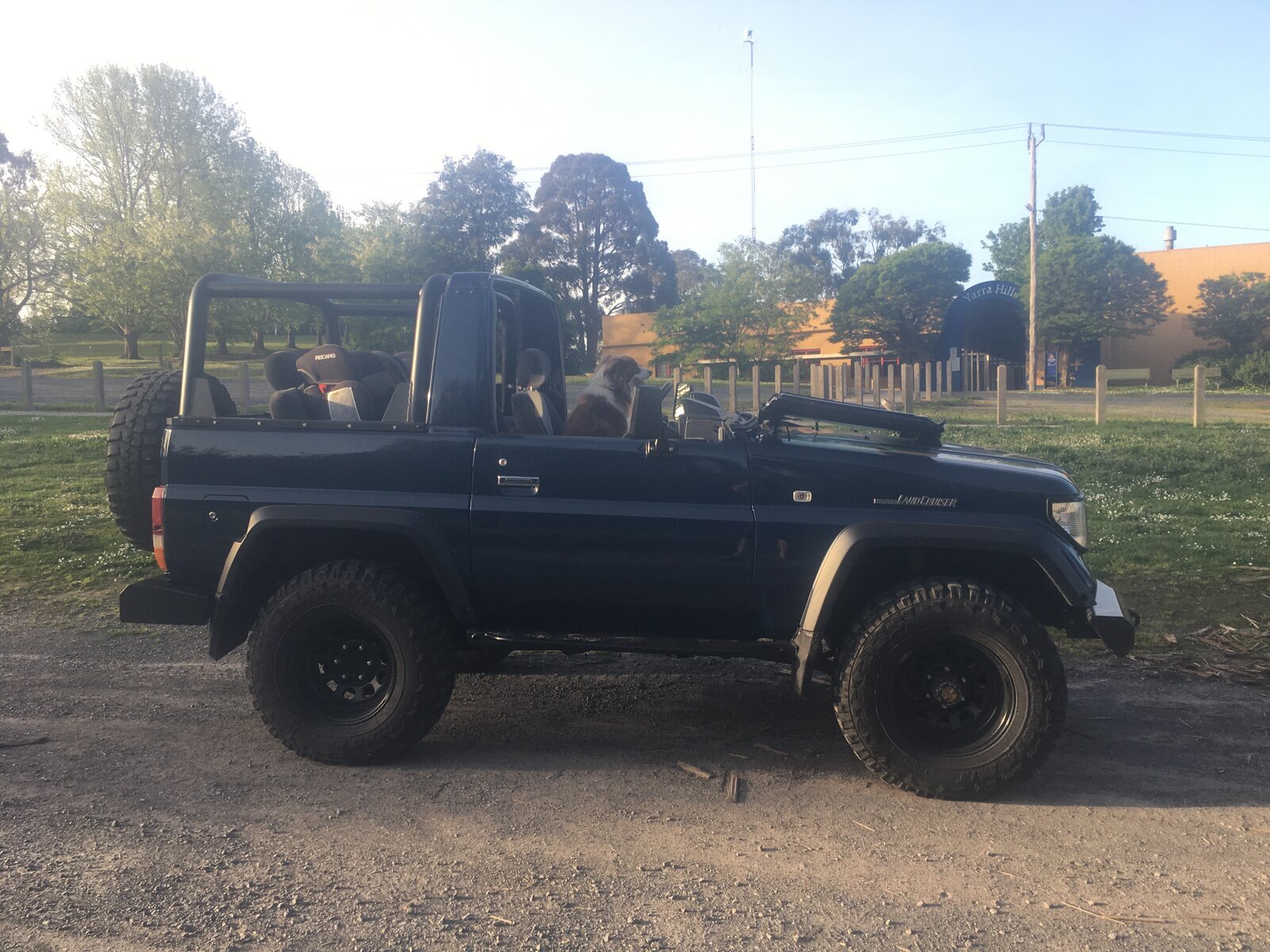

I took LJ for a drive with the windscreen folded and door tops removed, something I’ve always wanted to do.

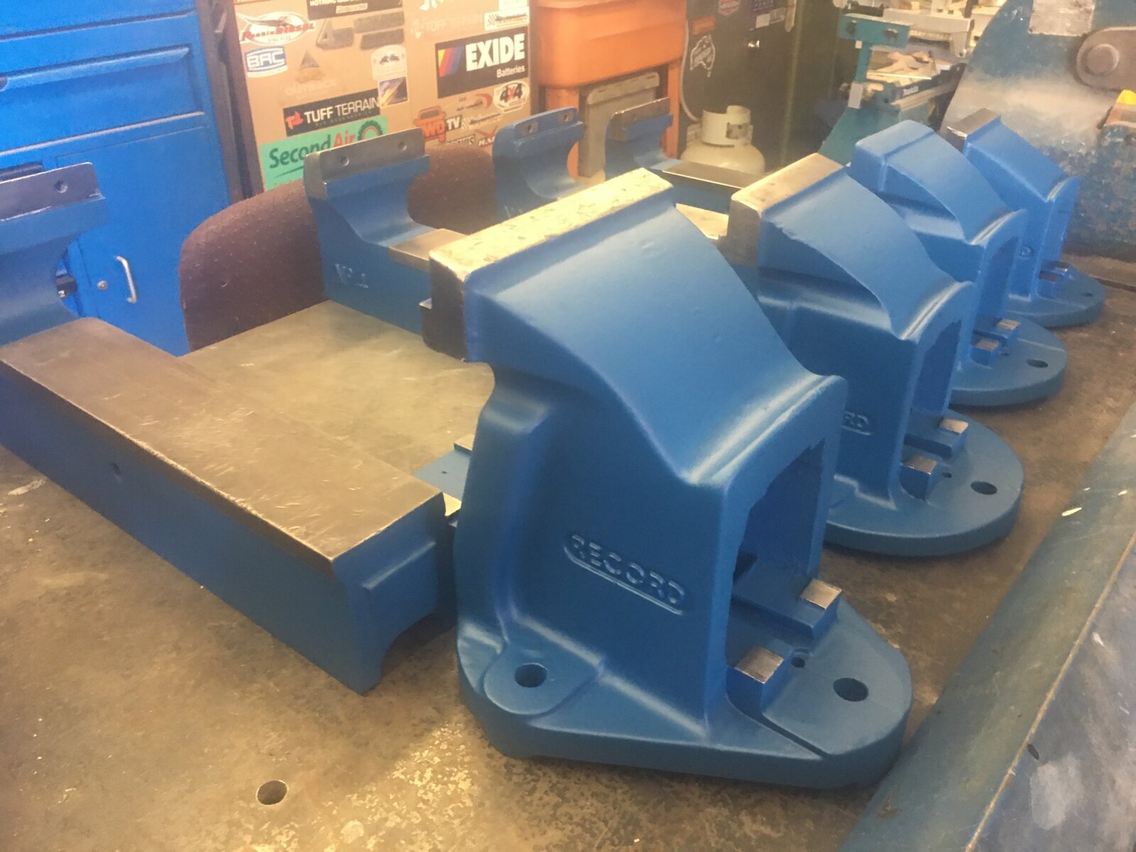

I’ve always liked old English made Record tools and in particular vices and when I moved out to Australia I brought 4 of them with me.
In March this year I discovered an Australian made Record #3 vice. I couldn’t believe it and despite hours of researching I couldnt find any information of them ever having been made here.
I had to buy it so I bought it and since then I’ve been searching for more.
I then began searching Market Place, Gumtree and EBay every single day for more and as the months went on I found a #6 then a #4 and most recently a #2 which I had to drive all the way to Adelaide to get.
I’m now hunting for a #1 and #5.
They’ve all needed cleaning up and repainting because they’re at least 60 years old and they’ve all been used and abused.

I’ve just updated my LJ78 build thread with the pics and information from converting the rear axle to a fully floating axle with 9.5” diff.
Underseat compressor mount.
Rear door jerry can holder.
And rear door table.

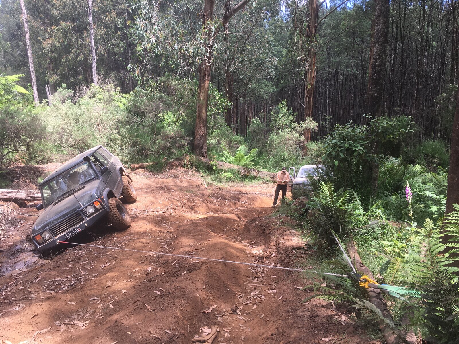

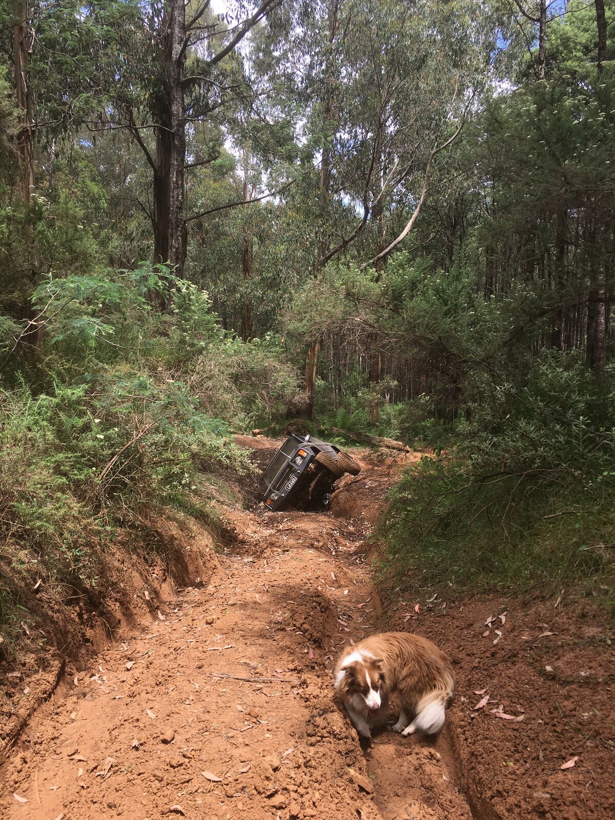

I said over the radio to my friend Michael “the right hand track looks more challenging”
Next minute he’s on the radio saying he took the right hand track and has a slight issue……
Thankfully the only electric window that still works on the old thing is the passenger side one!
The hole he fell into had a conveniently placed Boulder which stopped him from going completely over.
I backed the Hilux down and we set to work.
We got him back and off the boulder and then re-rigged the winch rope to pull him forwards and up the bank.
And he was free!

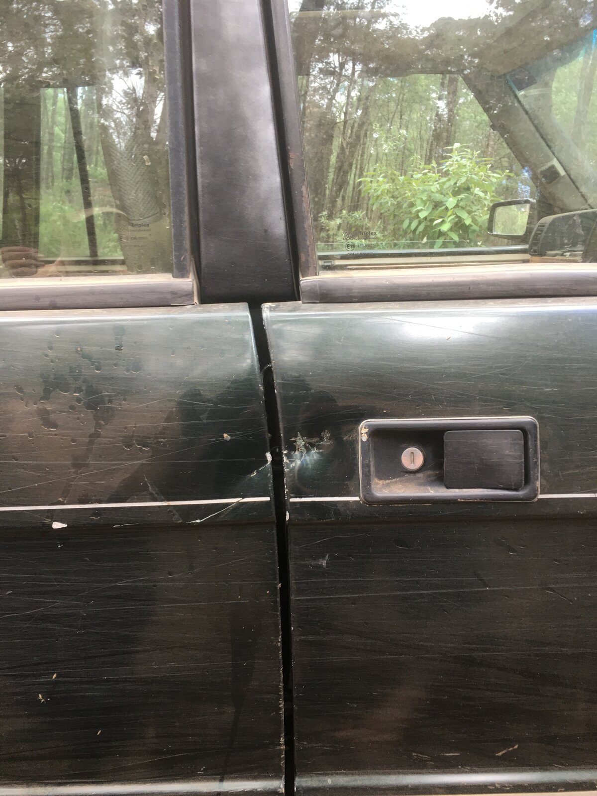

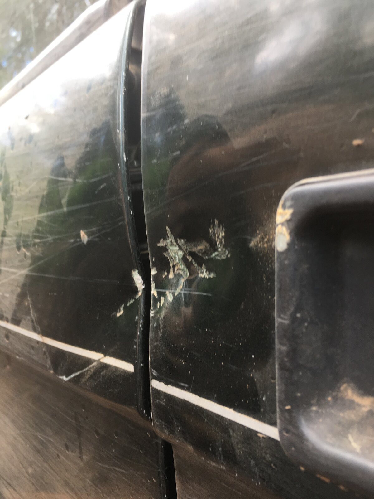

The rock had damaged the doors slightly but it wasn’t too bad considering.
