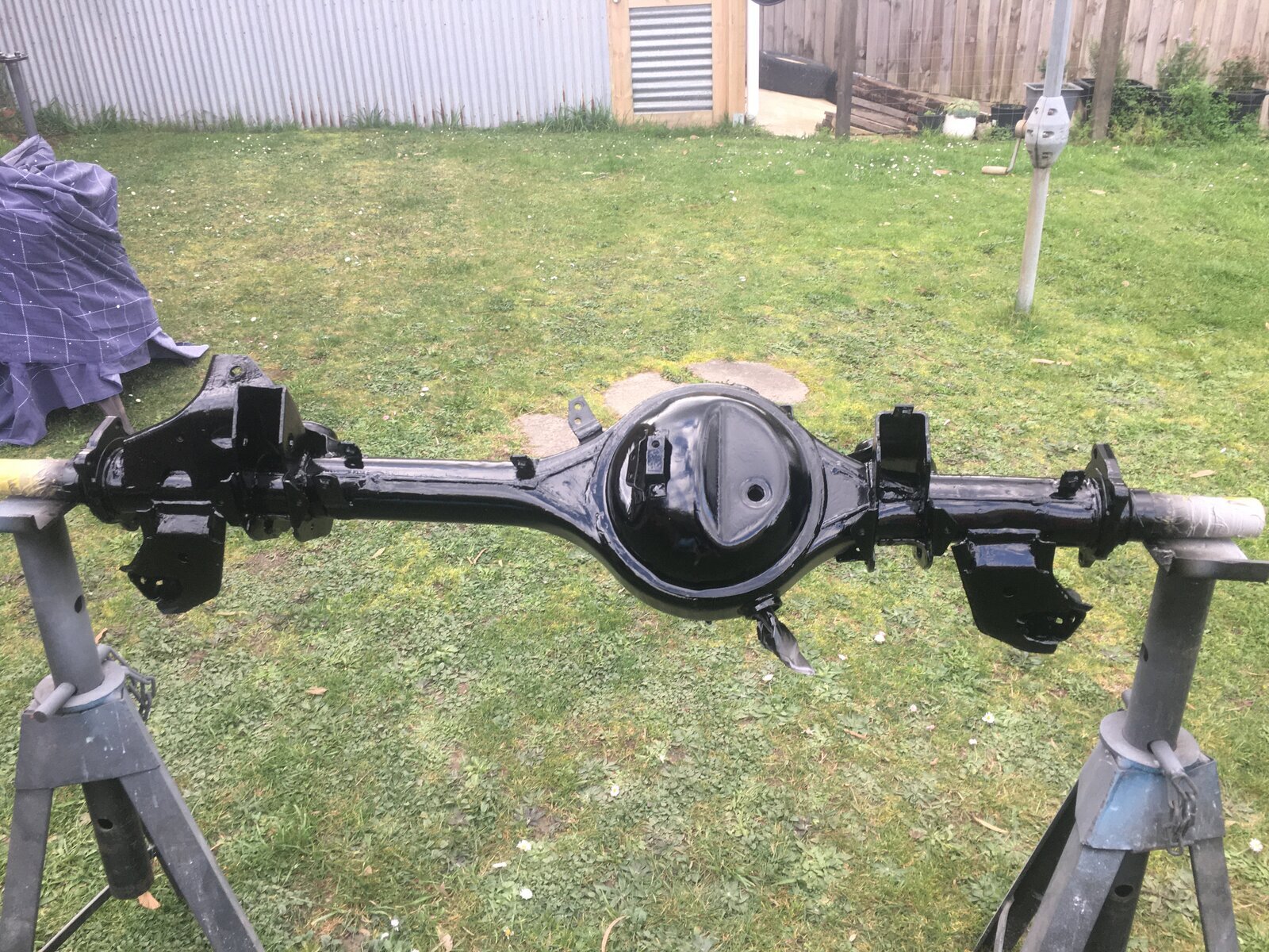

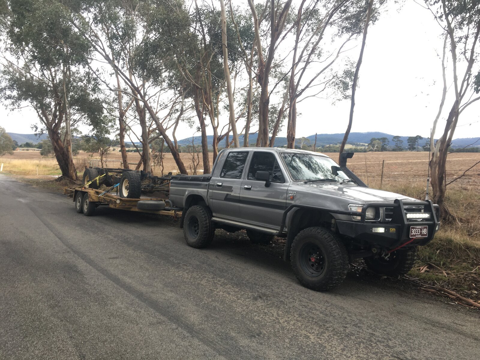

Long time no update on this thread……..
So following on from the previous update, I painted the rust repair, refitted the screen and we took The 78 away for an amazing month long trip to Tasmania last Christmas.
Pics from that trip are on the page below:

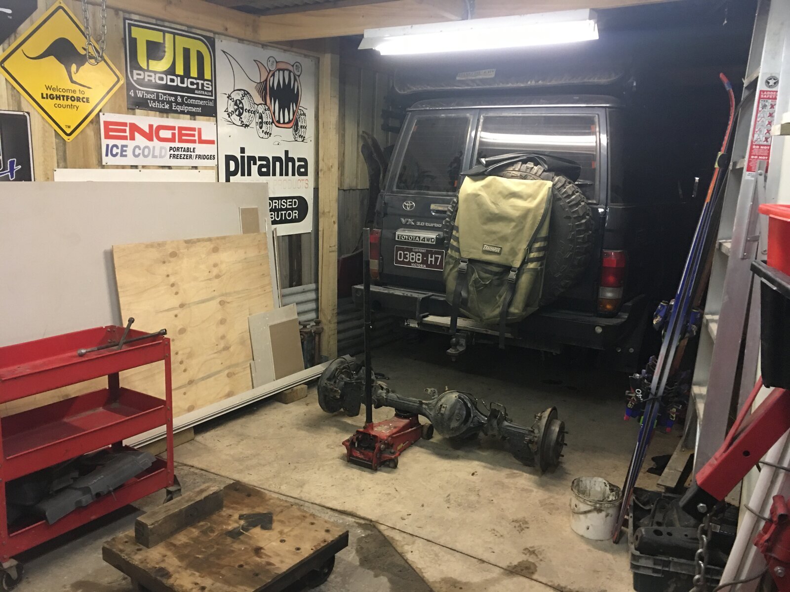

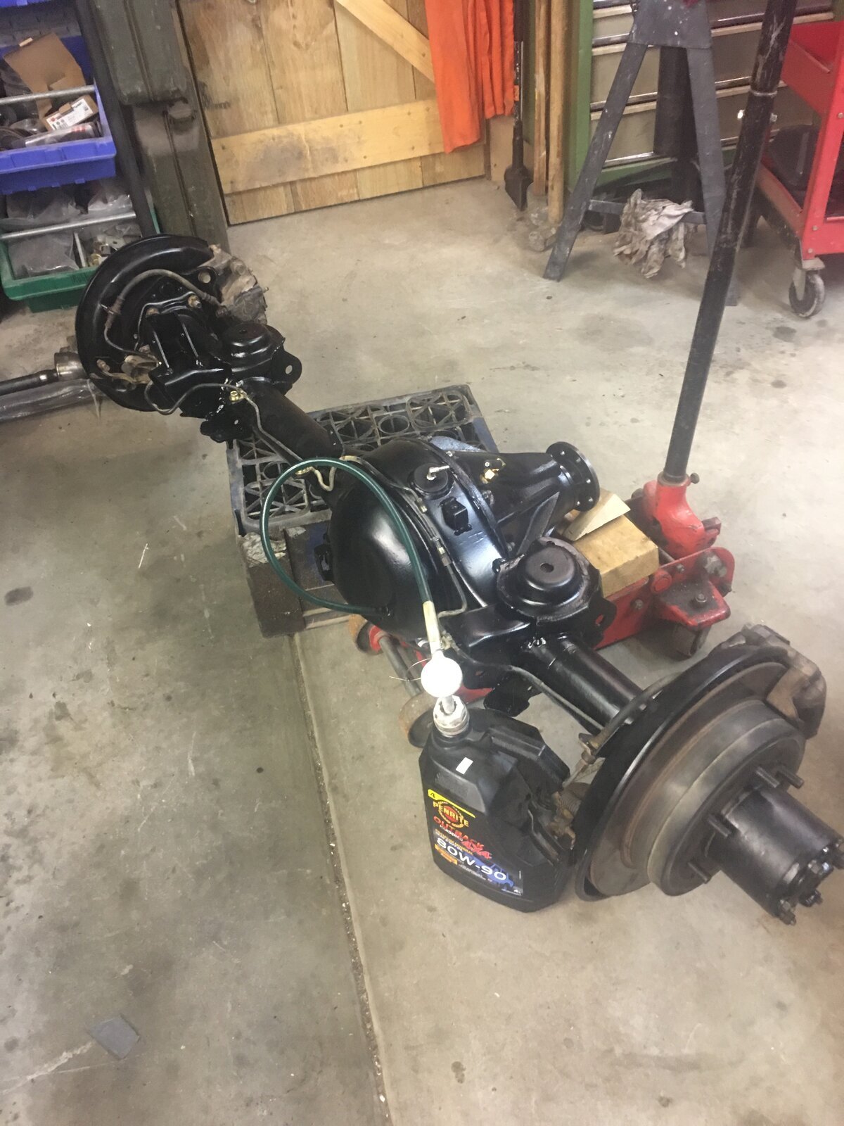

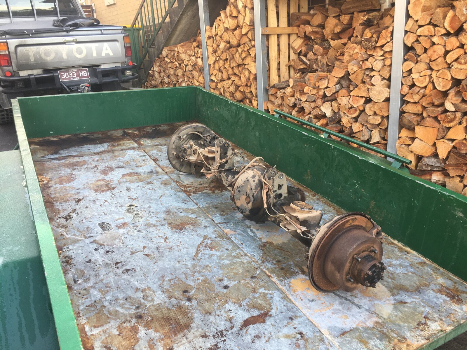

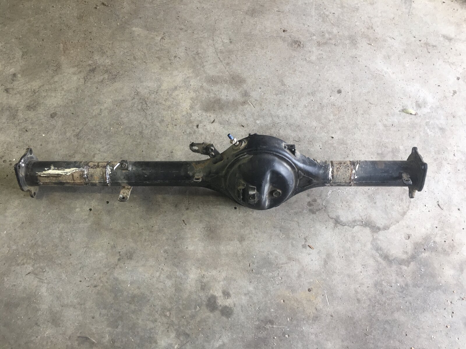

After that trip The 78 developed a noise which to start with I thought was the gearbox, but it turned out to be the rear diff.

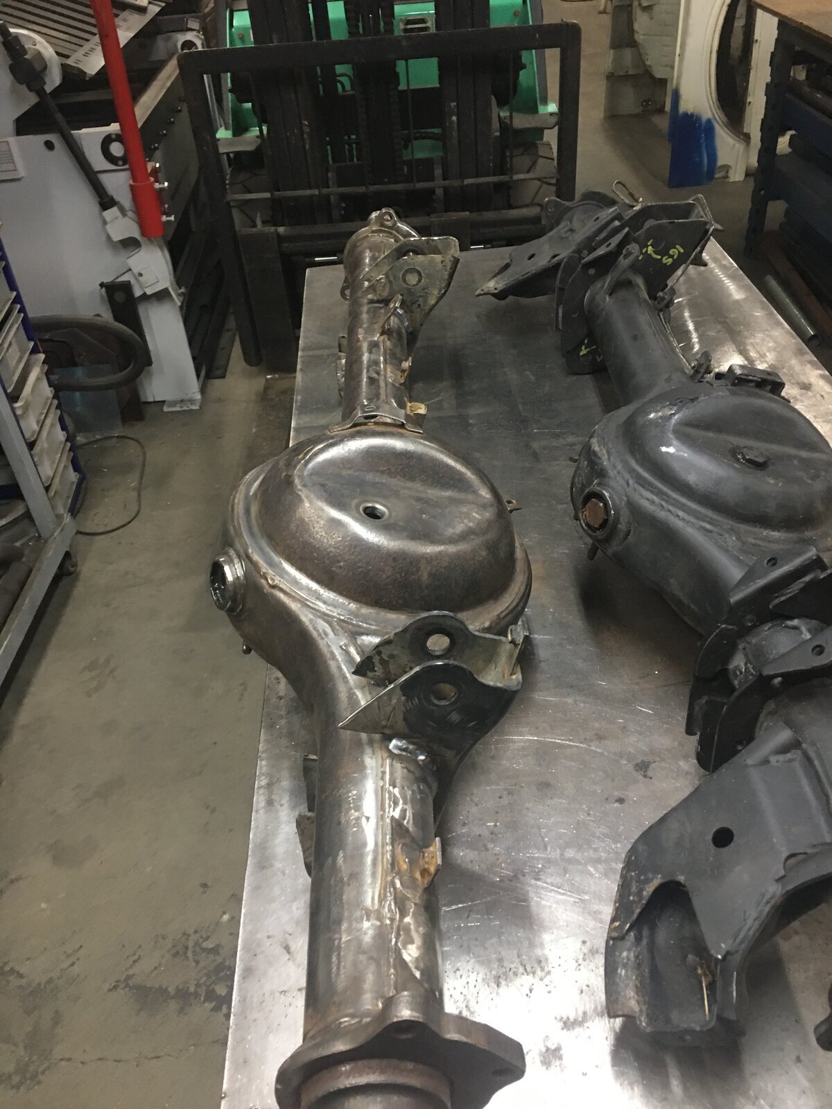

I was really annoyed it had failed because I’d had that diff expertly rebuilt with a new ring and pinion and solid pinion spacer and I hadn’t driven particularly aggressively or on big tyres.
After speaking to my diff guy he thinks the old diff went bang due to the weight the 78 was carrying (especially last Xmas) with all the power going through the little 8” diff.
He said if I wanted it to be absolutely bomb proof then I needed to use a 75 series housing with 100 series 9.5” diff centre.
I’d be loosing my factory locked rear diff sadly, but I’d be upgrading that 8” diff to a 9.5” and gaining fully floating axles (half shafts) at the same time.

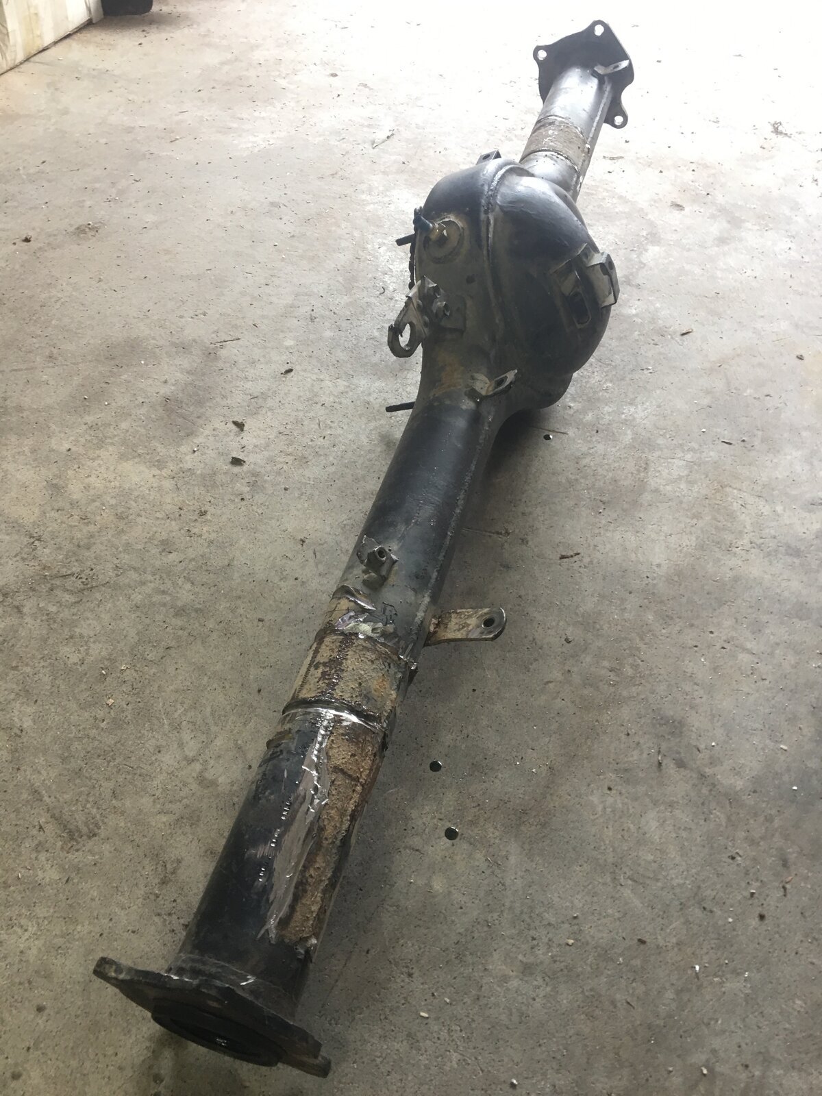

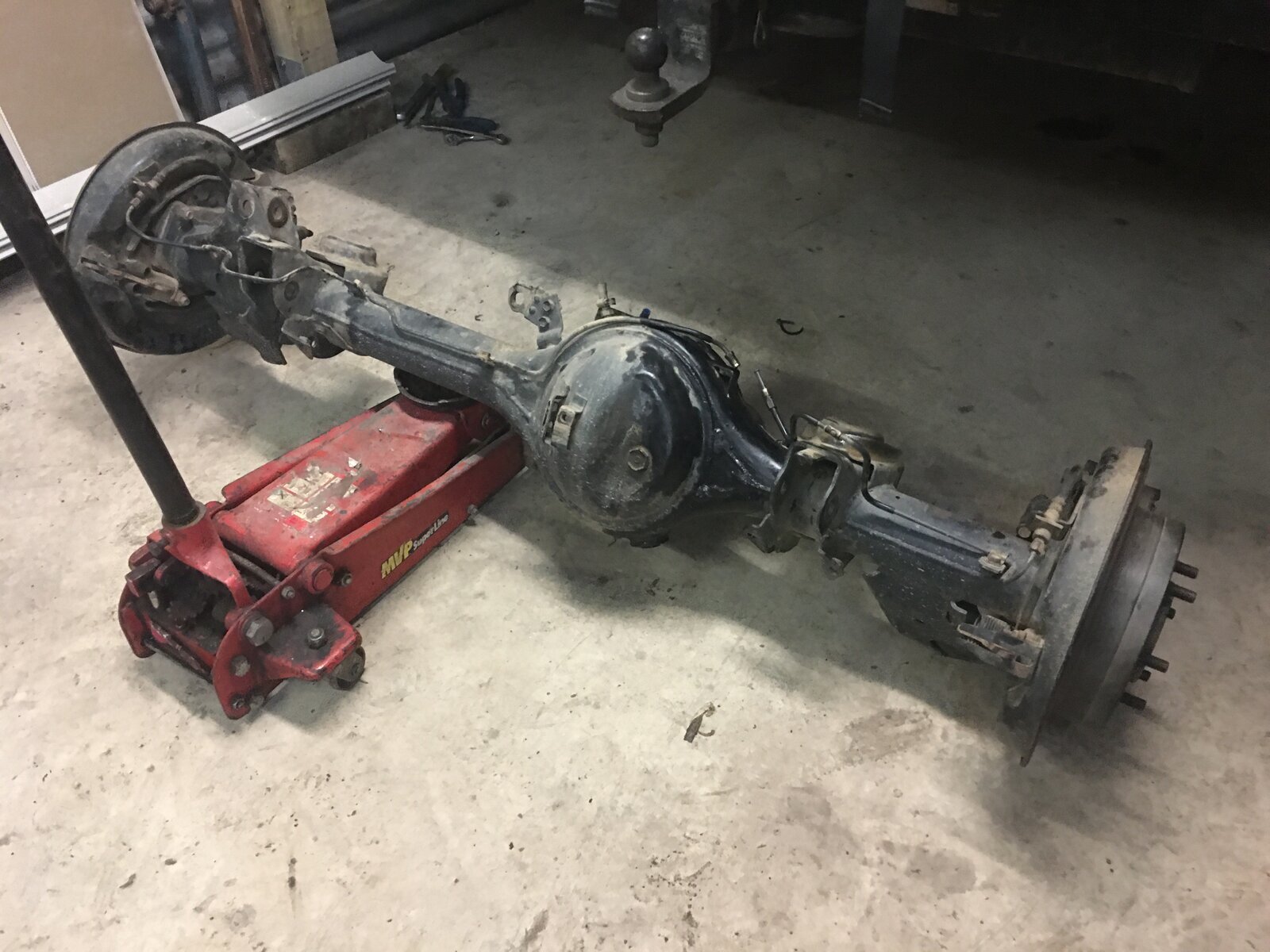

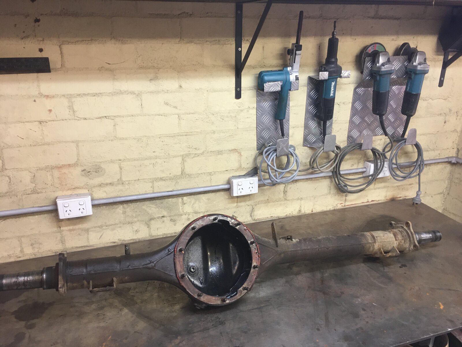

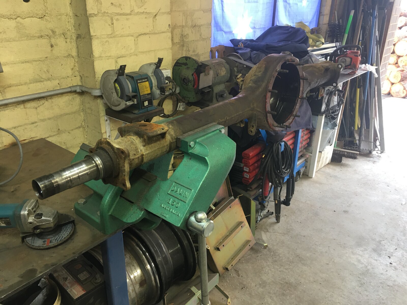

Axle removed.
Damaged 8” diff.

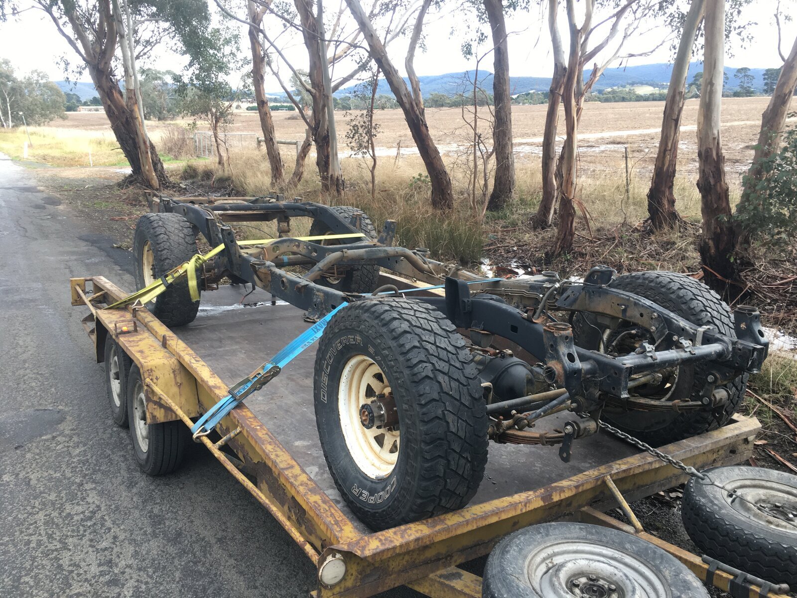

I picked up a rolling FZJ75 chassis for $1050 (I went on to make $1300 selling the bits I didn’t need, as all I used was the housing and axles).
I also picked up a 100 series rear axle and I made $200 profit selling all the bits I didn’t need, such as the housing, axles (half shafts) and brake backing plates.F93B9FF1-CE02-4FEE-AC92-8194D1D3C292.jpeg

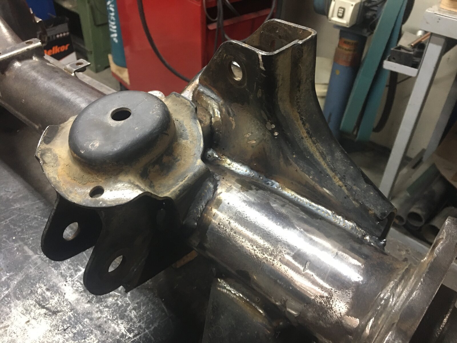

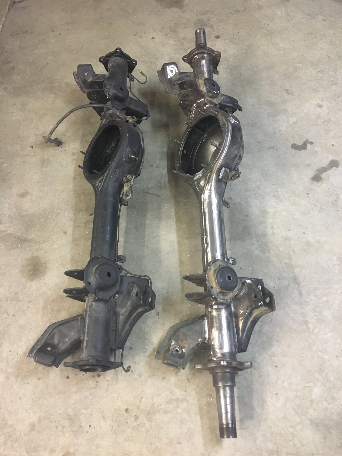

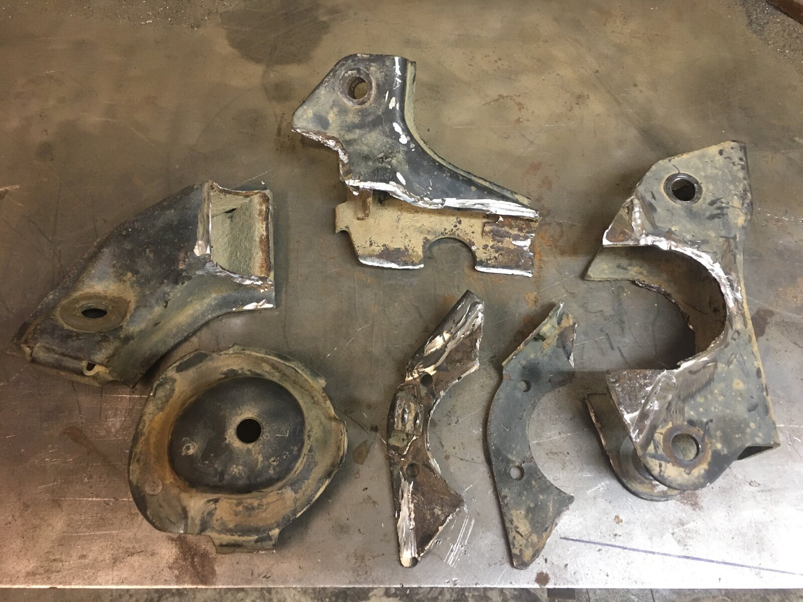

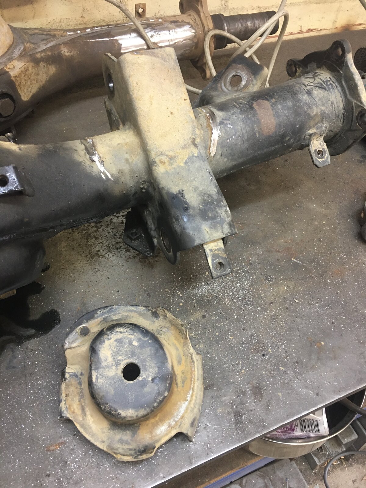

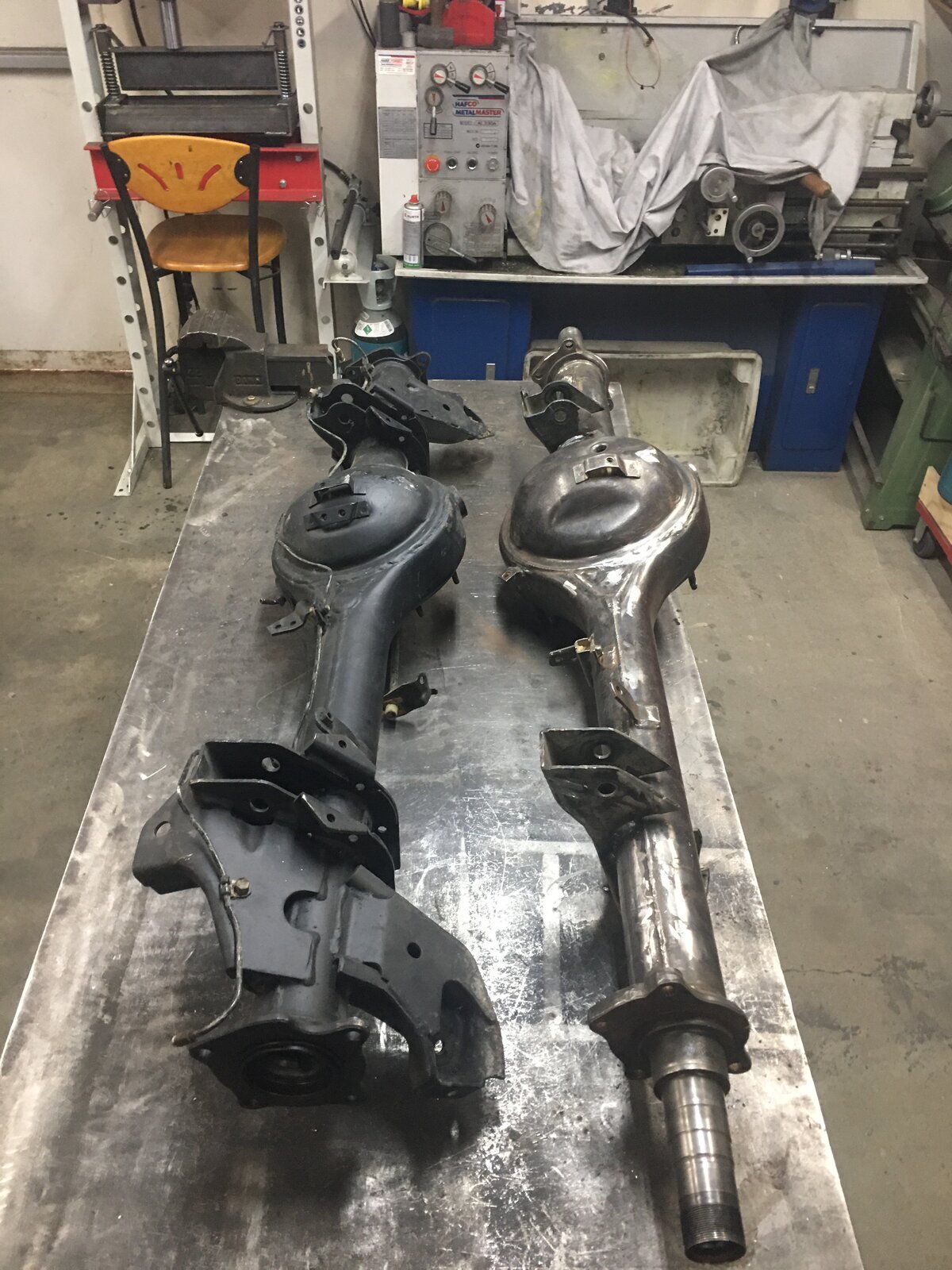

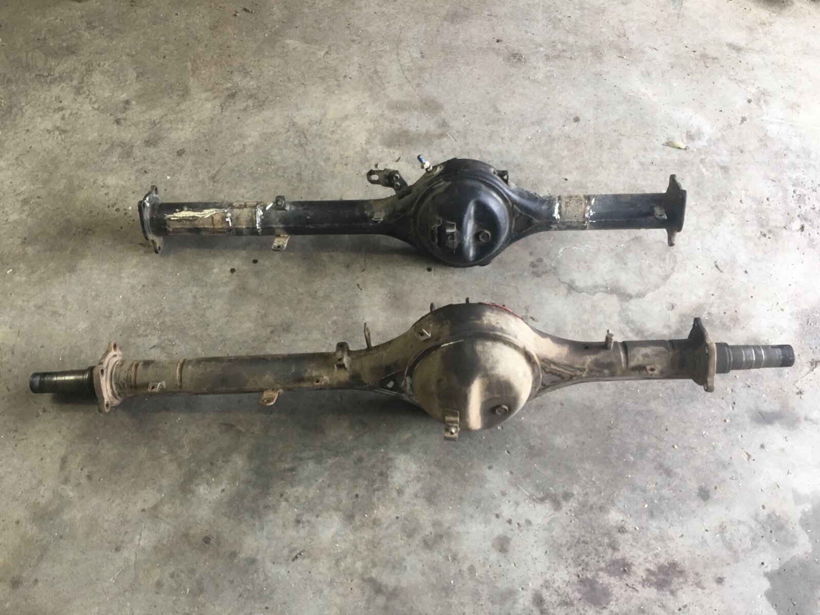

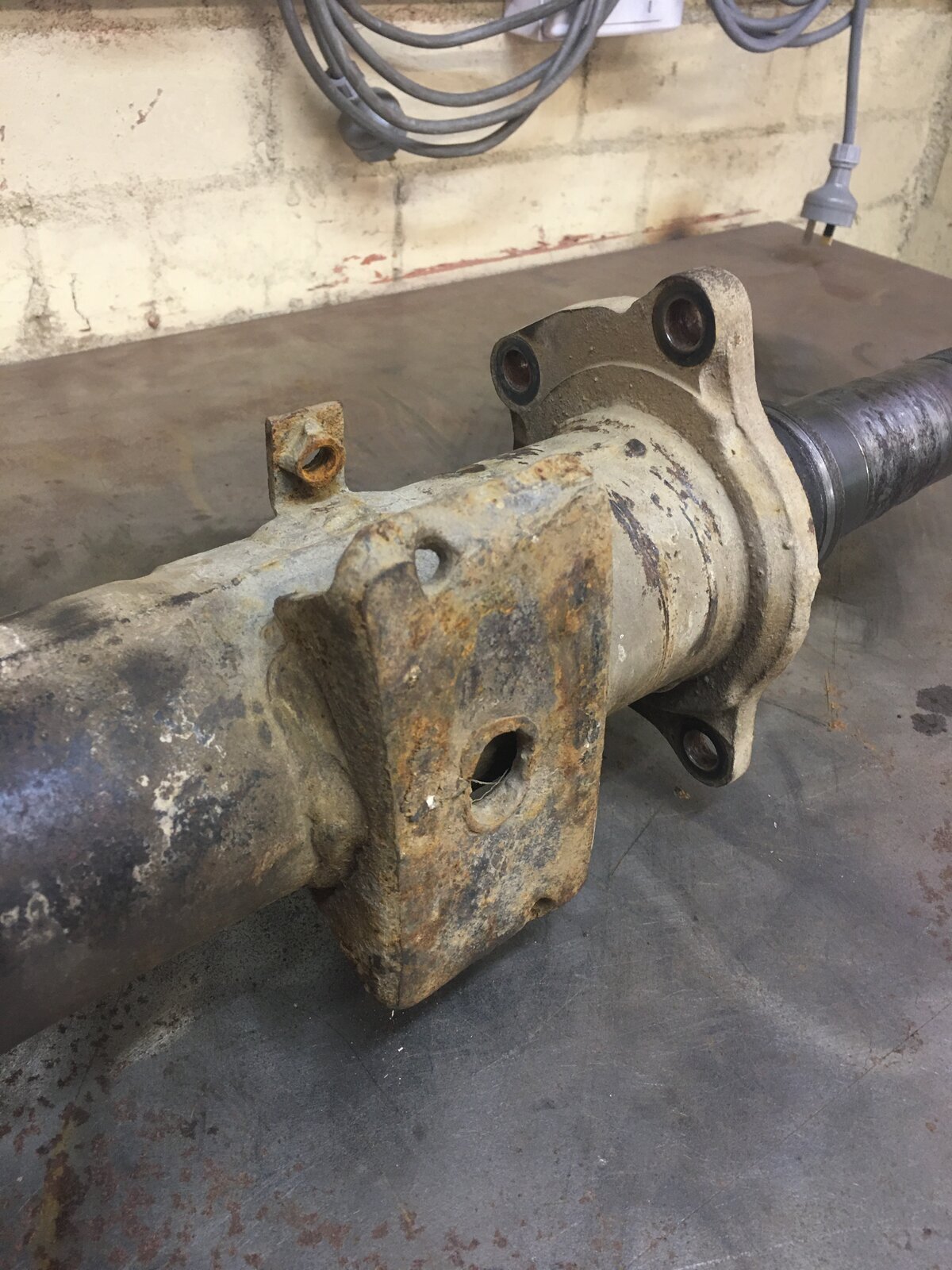

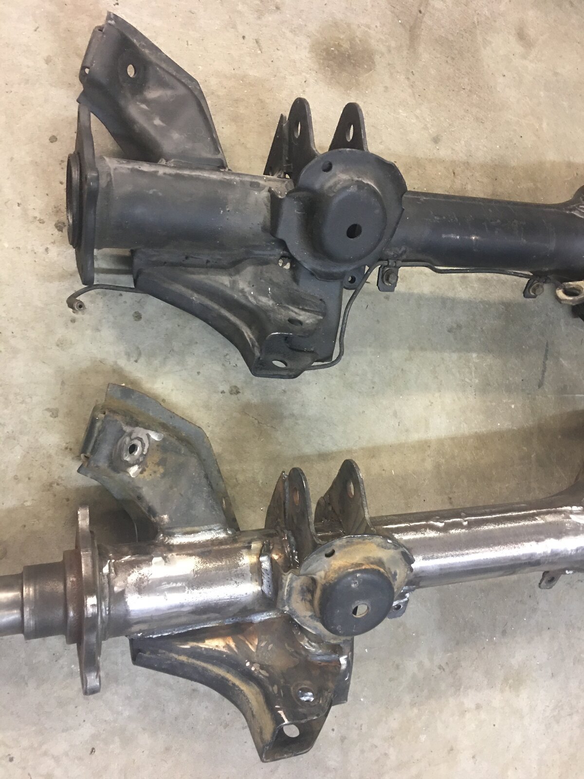

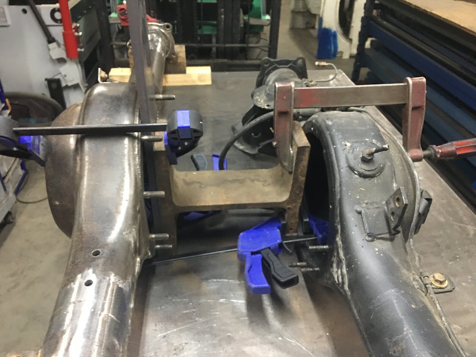

Cleaned up the 75 housing and removed the leaf spring mounts.

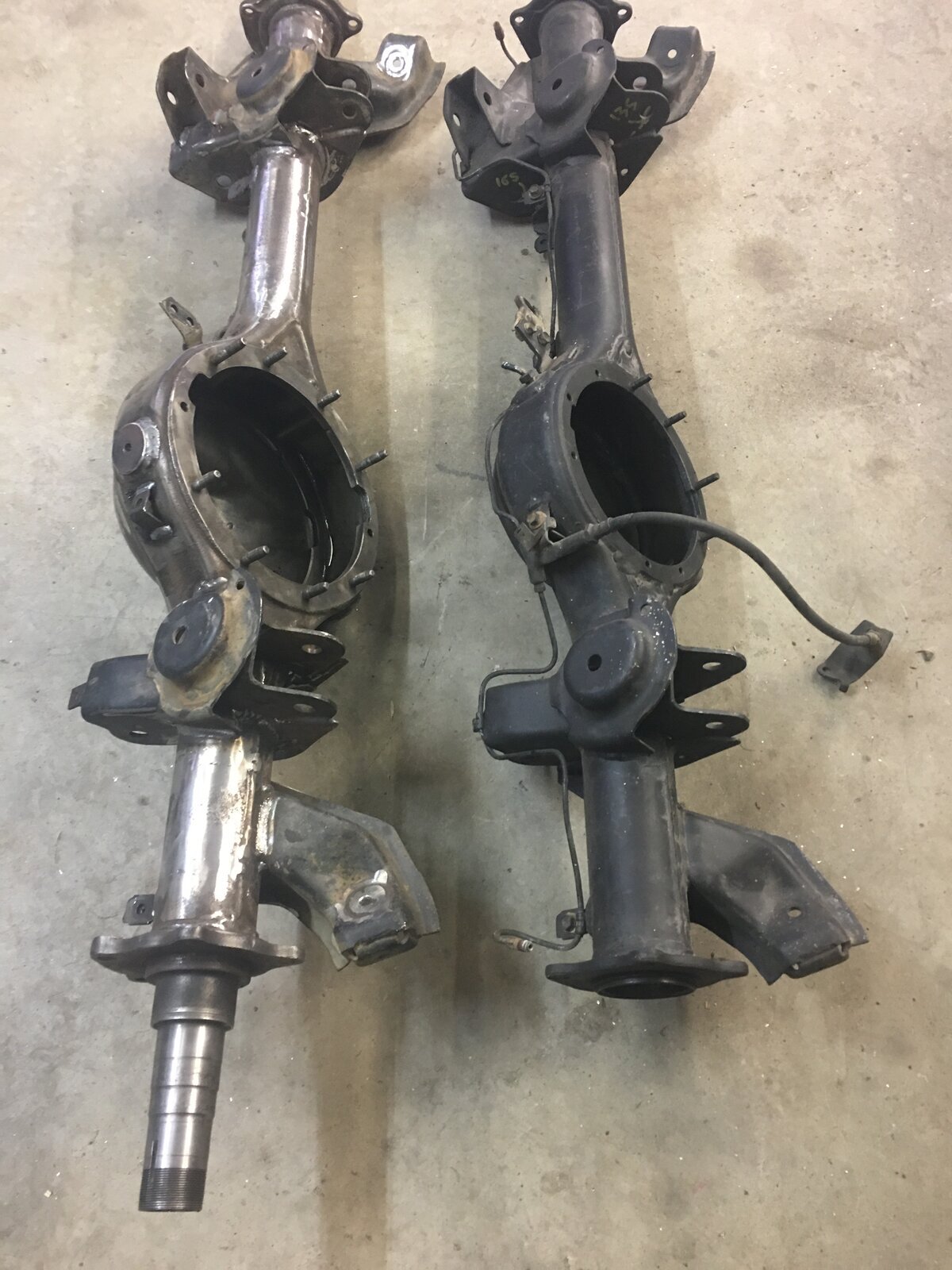

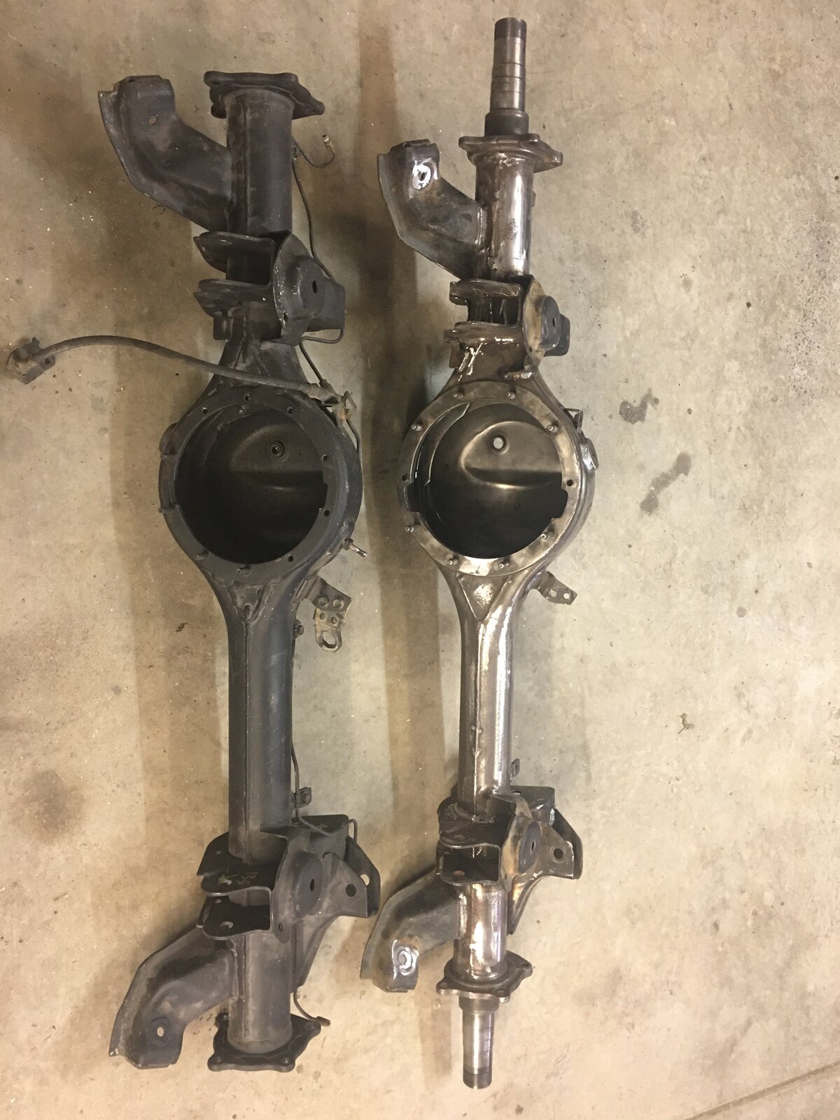

Carefully removed all the brackets from my old LJ78 housing ready to weld onto the 75 housing.
Stripped 78 housing.

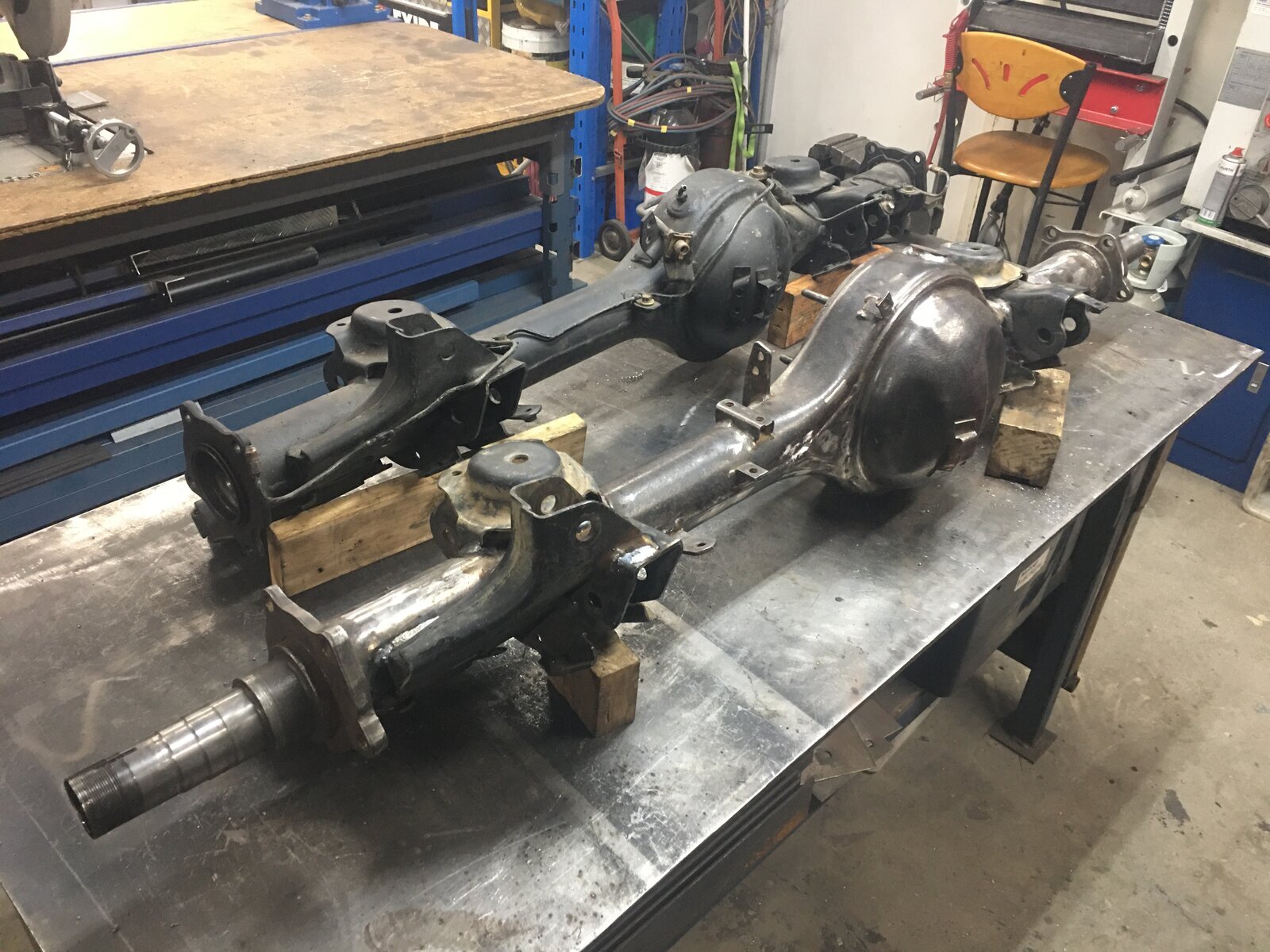

The 2 housings together.

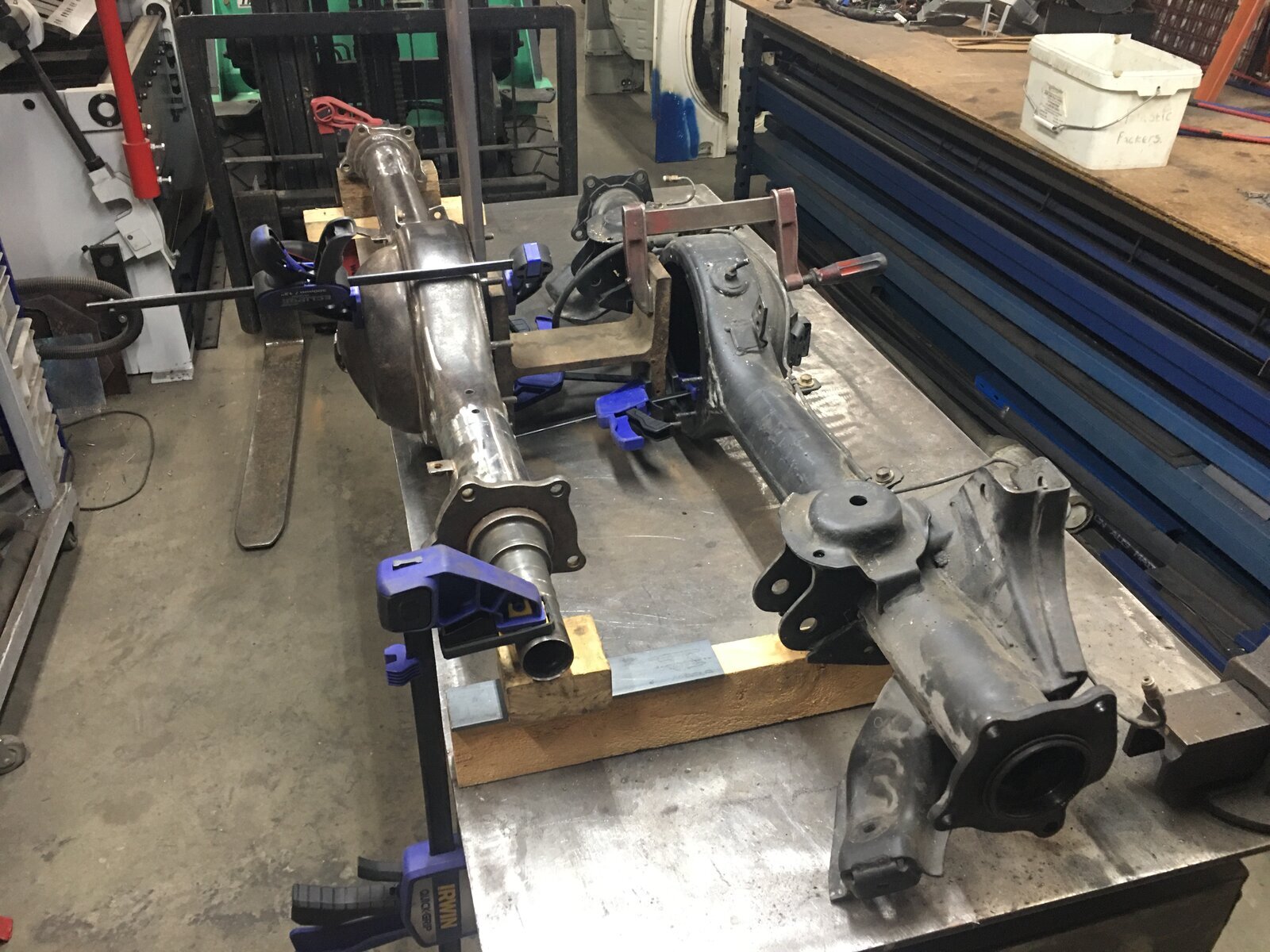

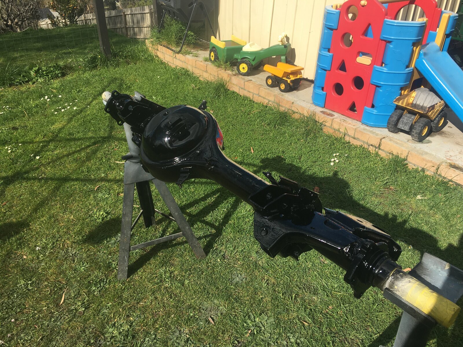

Both the same width, but the 78 is semi floating and the 75 is fully floating, which is a big advantage!
I took the 75 housing to work along with my spare KZJ78 housing, which I used to take measurements and angles from for the brackets.
Brackets all welded on.

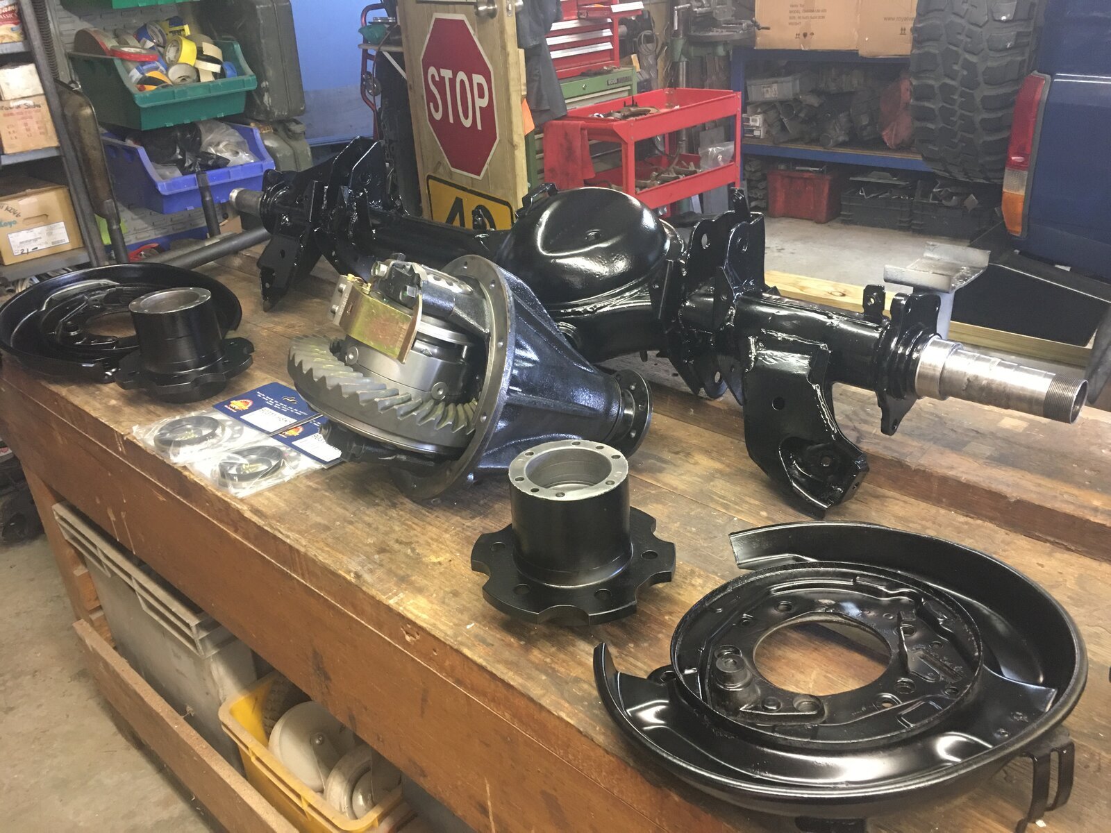

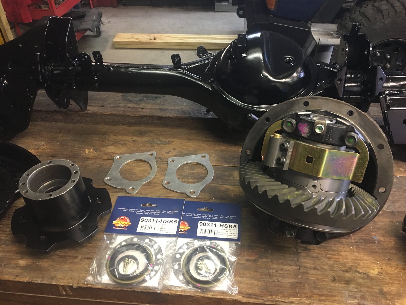

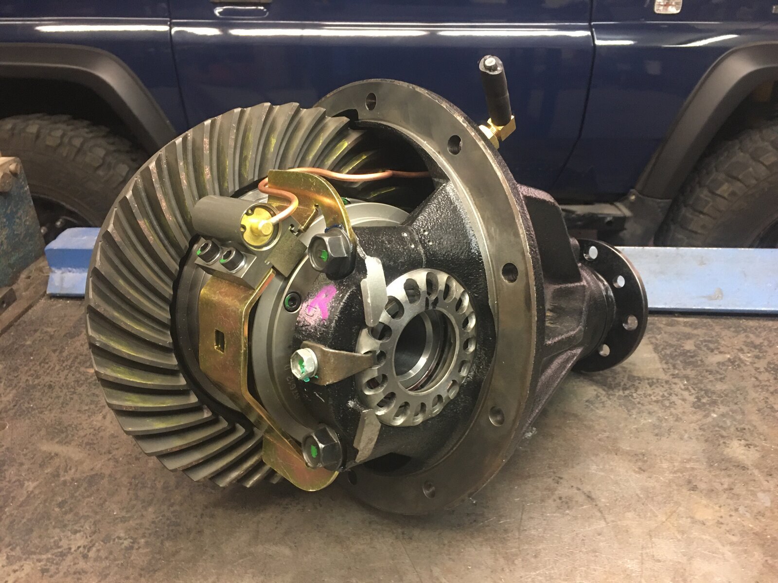

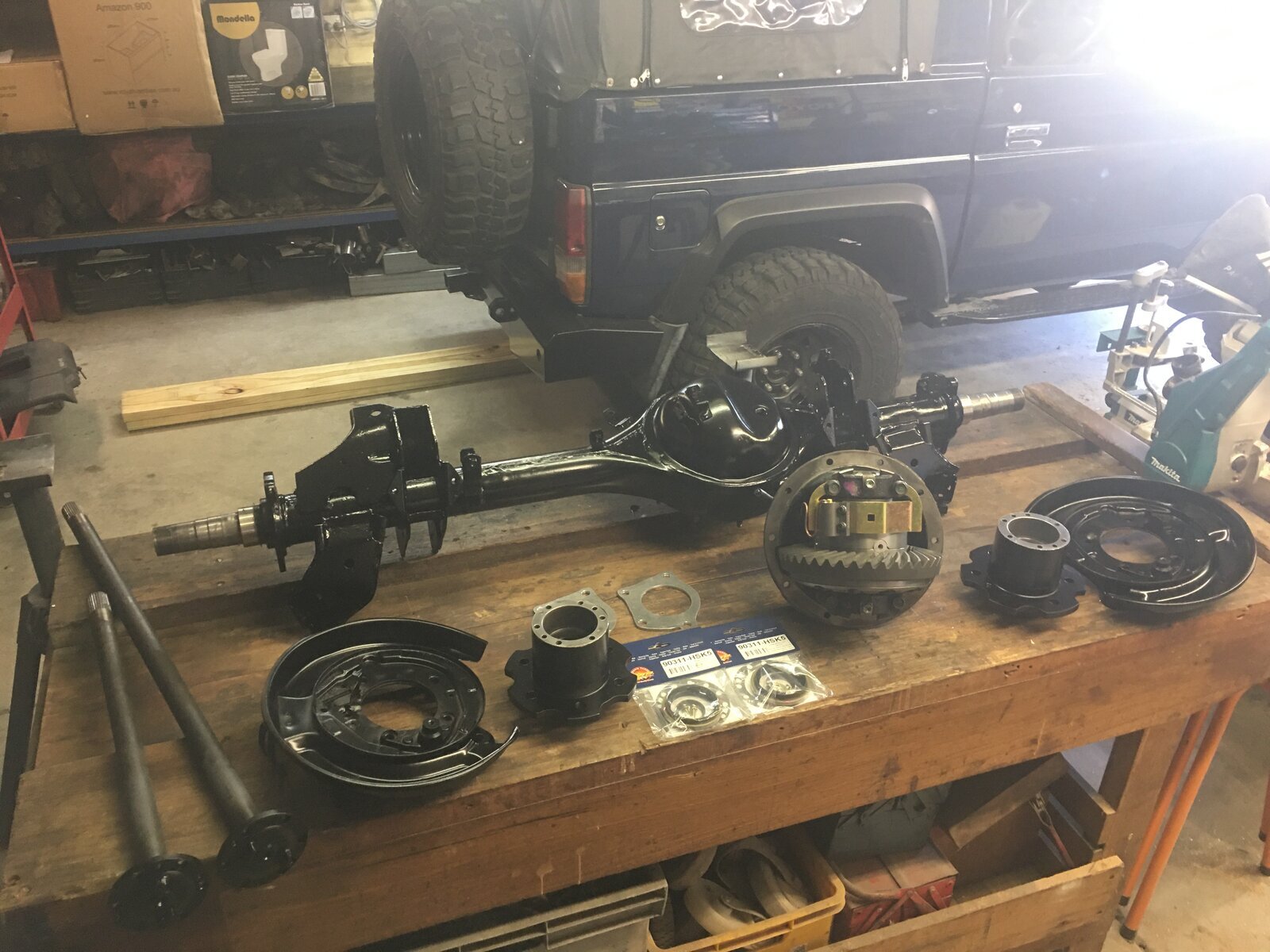

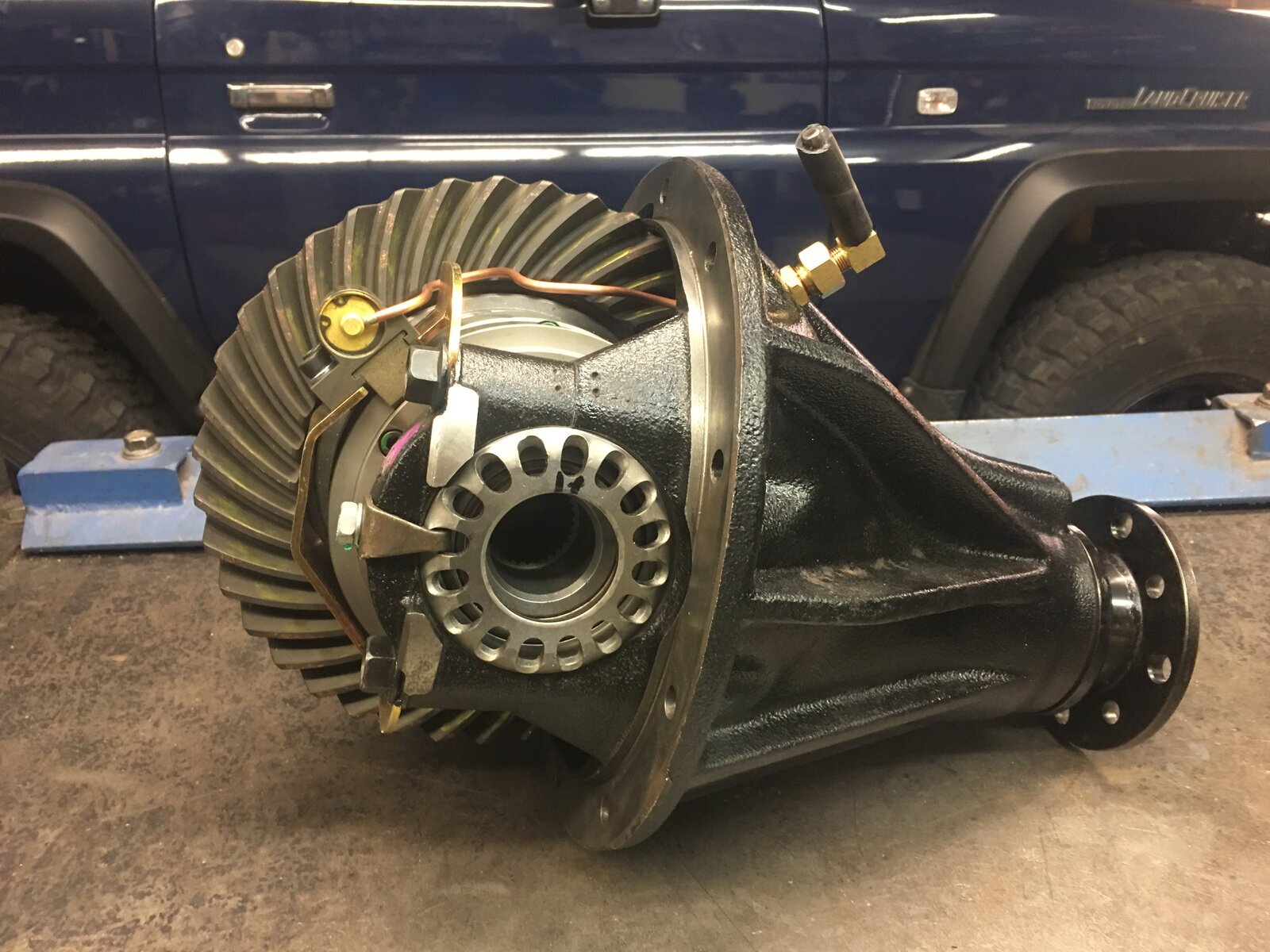

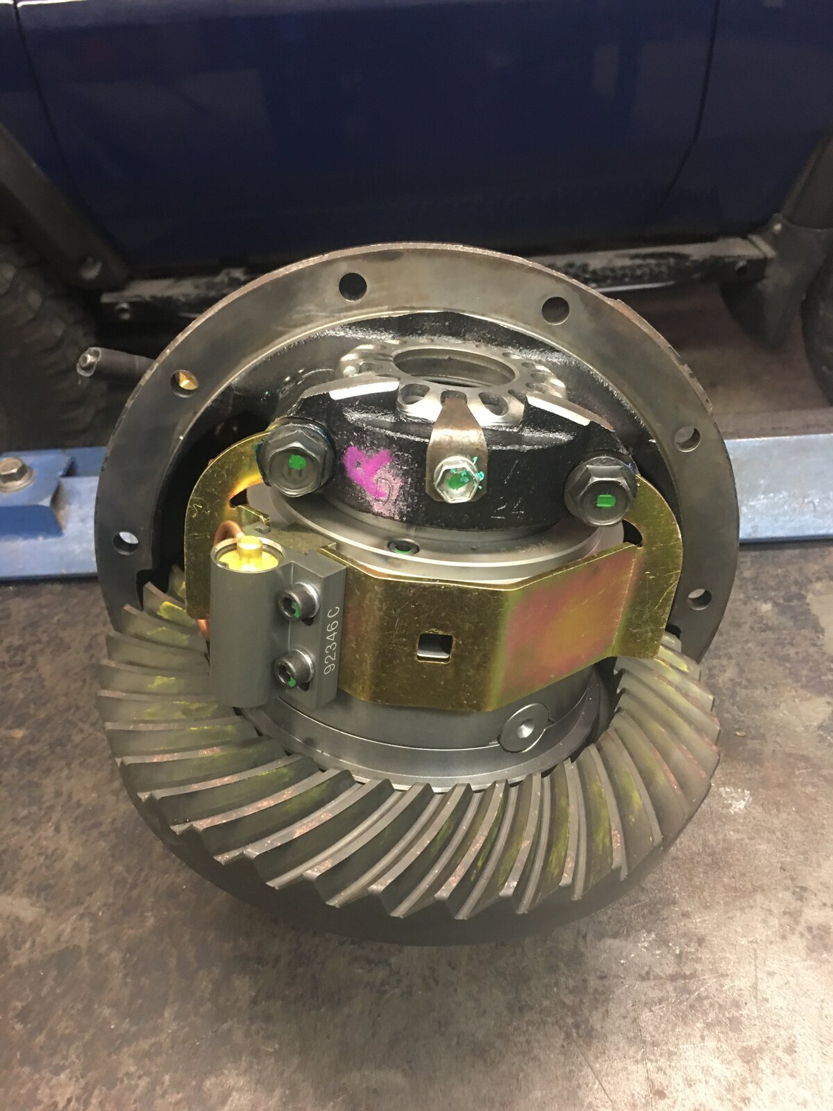

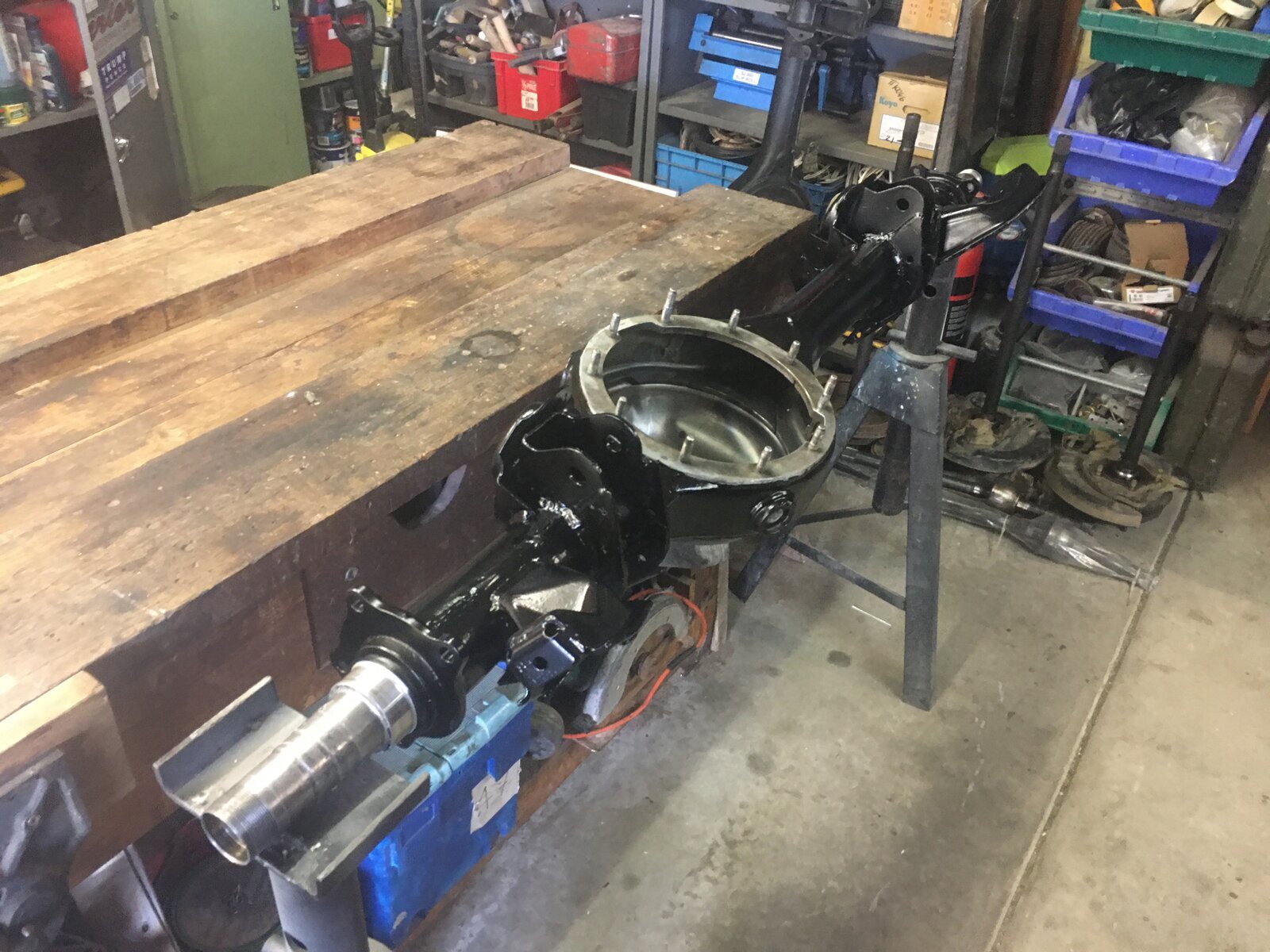

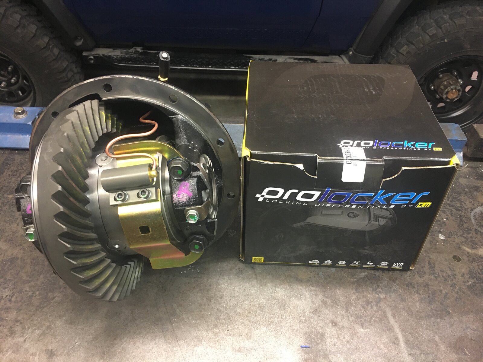

The 100 series diff centre got fitted with a TJM Pro Locker (the best locker available) along with a solid pinion spacer and new 4:88 ring and pinion.
The diff guy also checked and adjusted the housing on his hydraulic press because the heat of welding the brackets on had distorted it slightly.

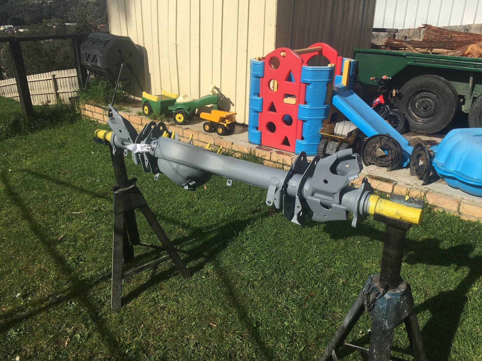

I then printed it with etch primer followed by 2K primer and 2K satin black.

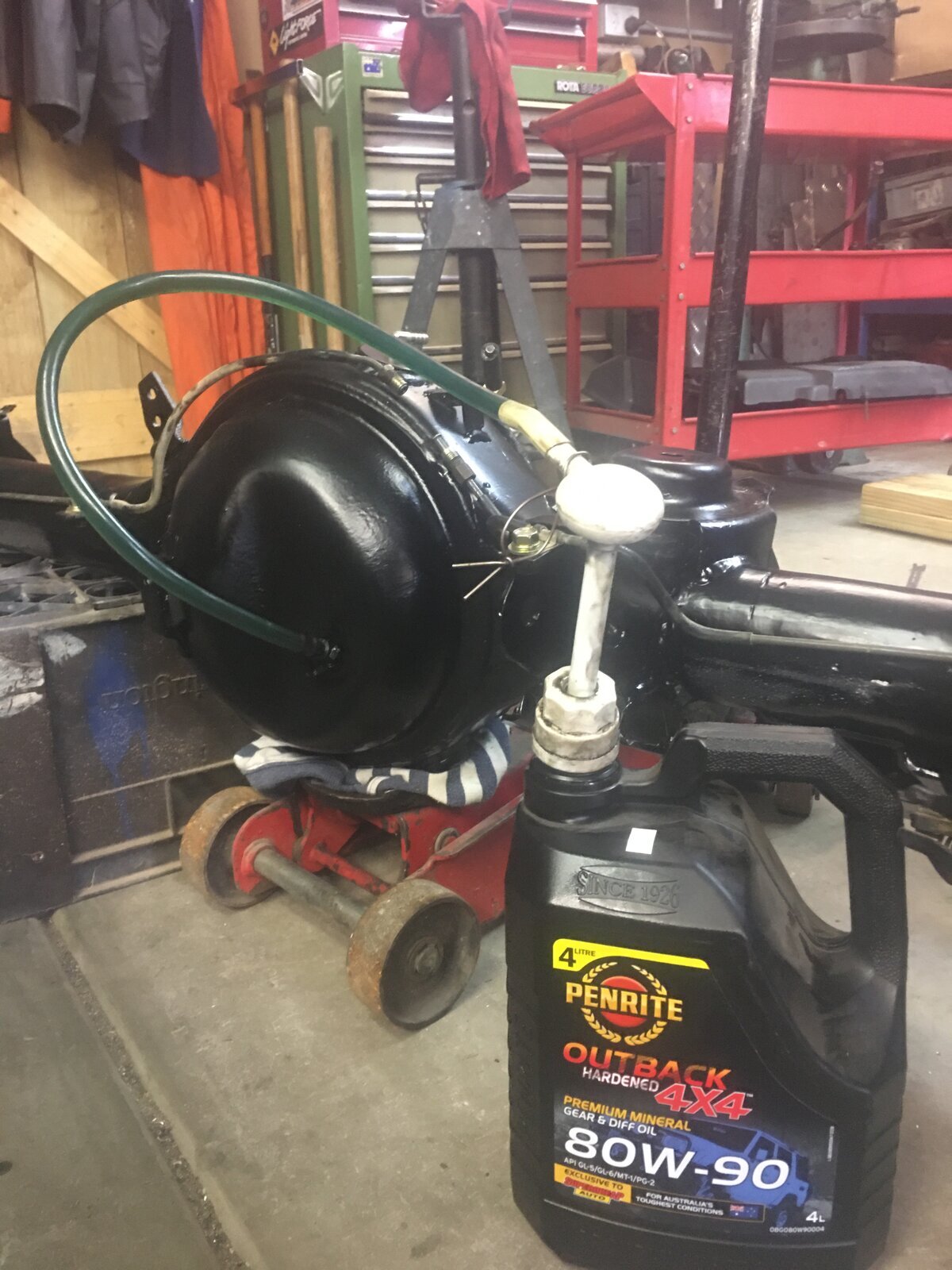

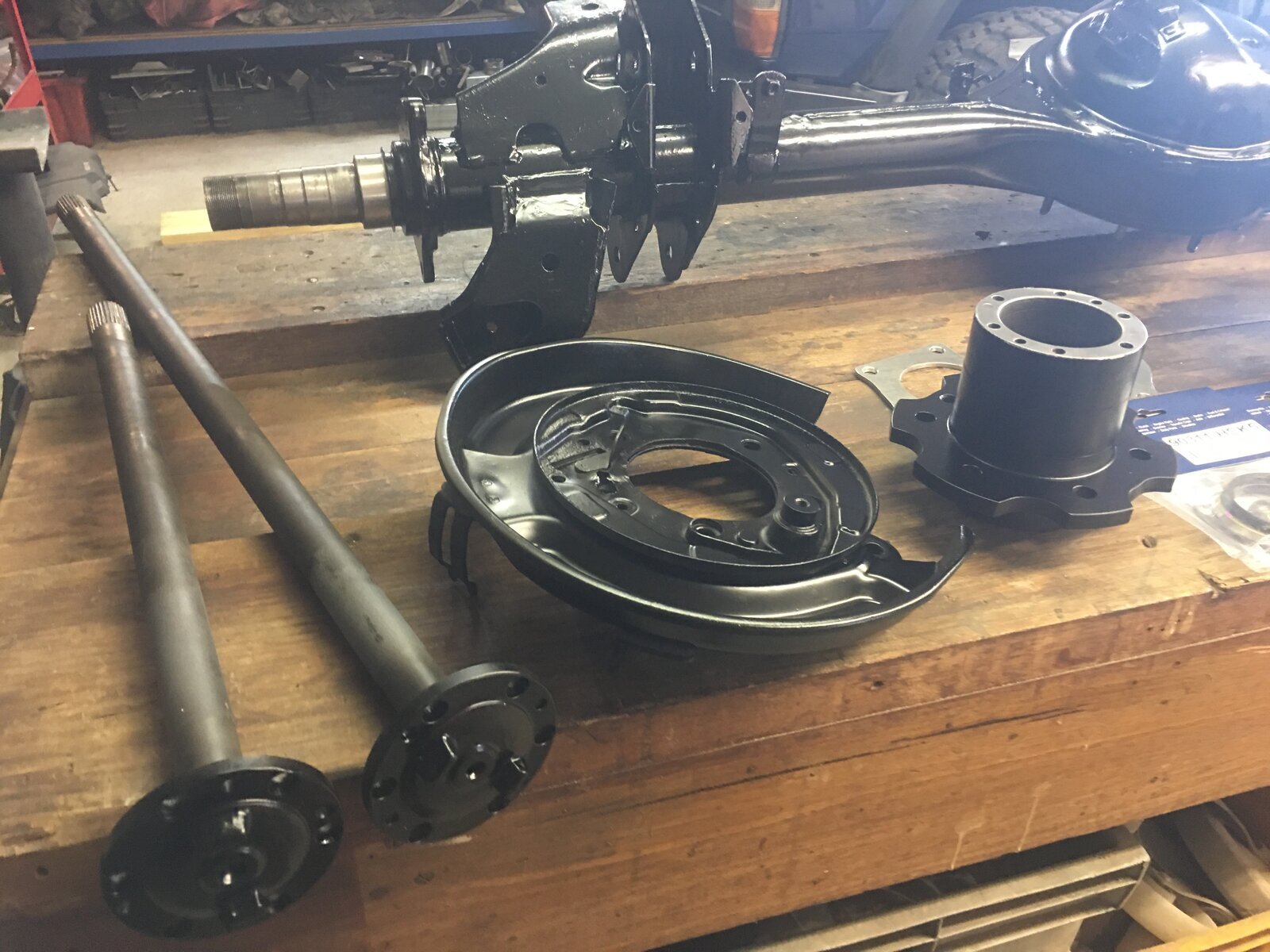

Re-assembled it all.
Filled it with oil.
And refitted it to the vehicle.

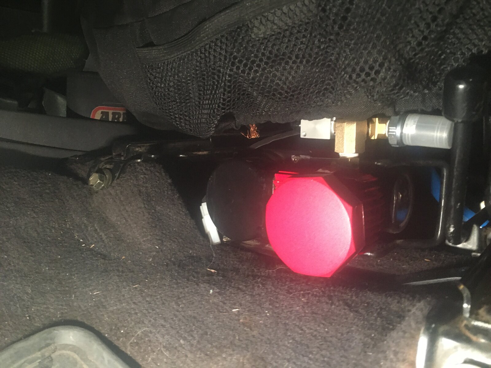

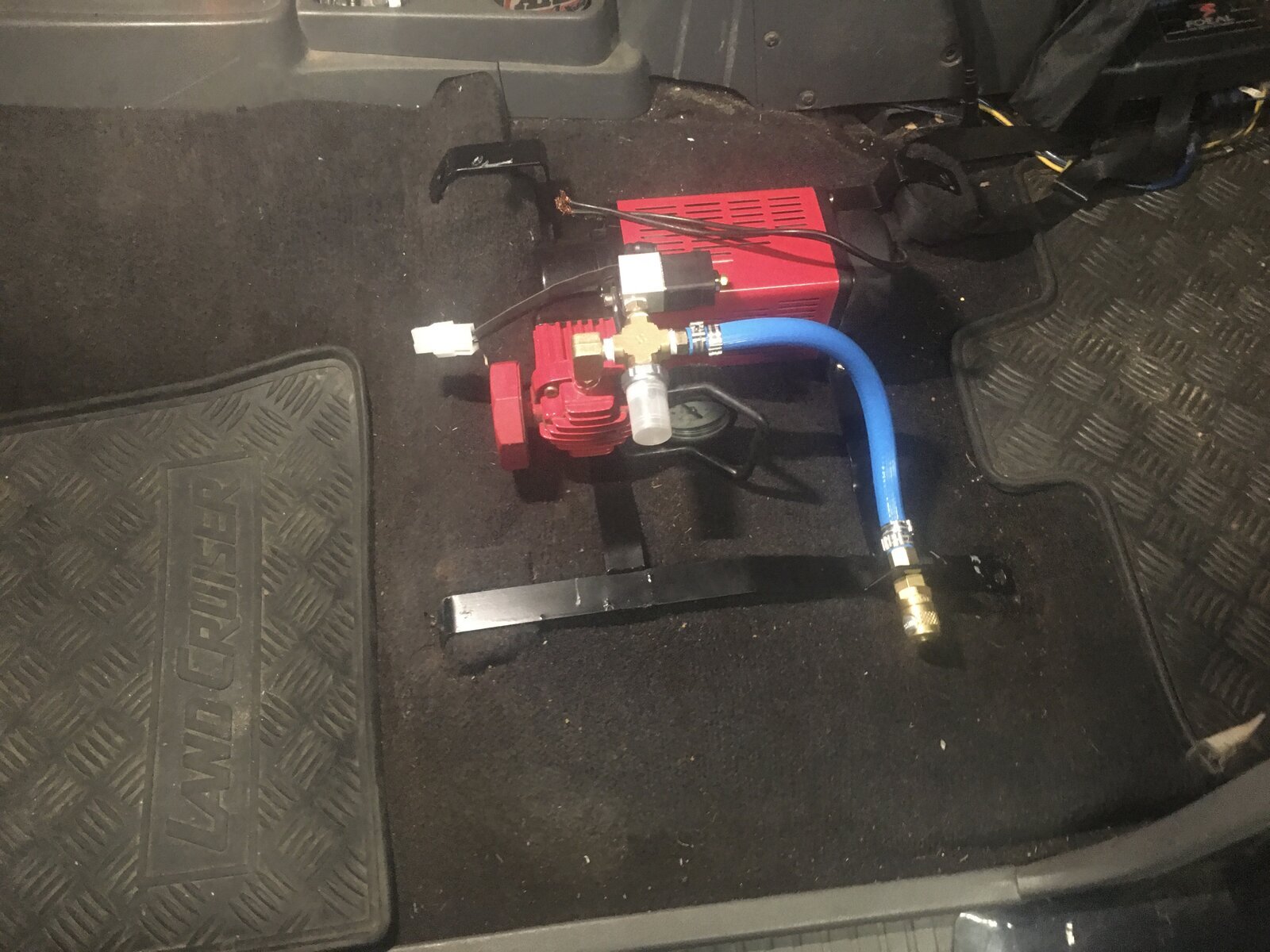

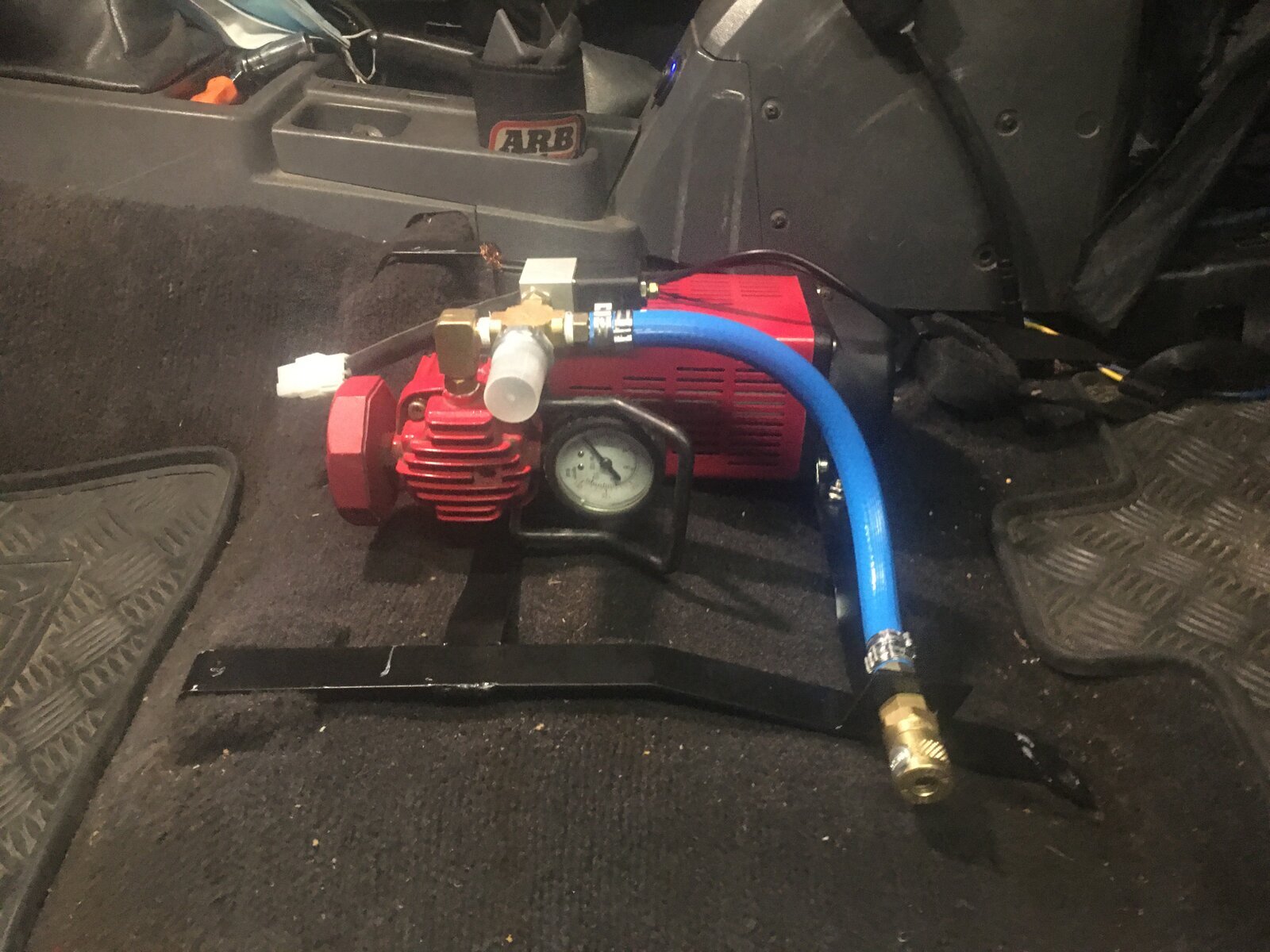

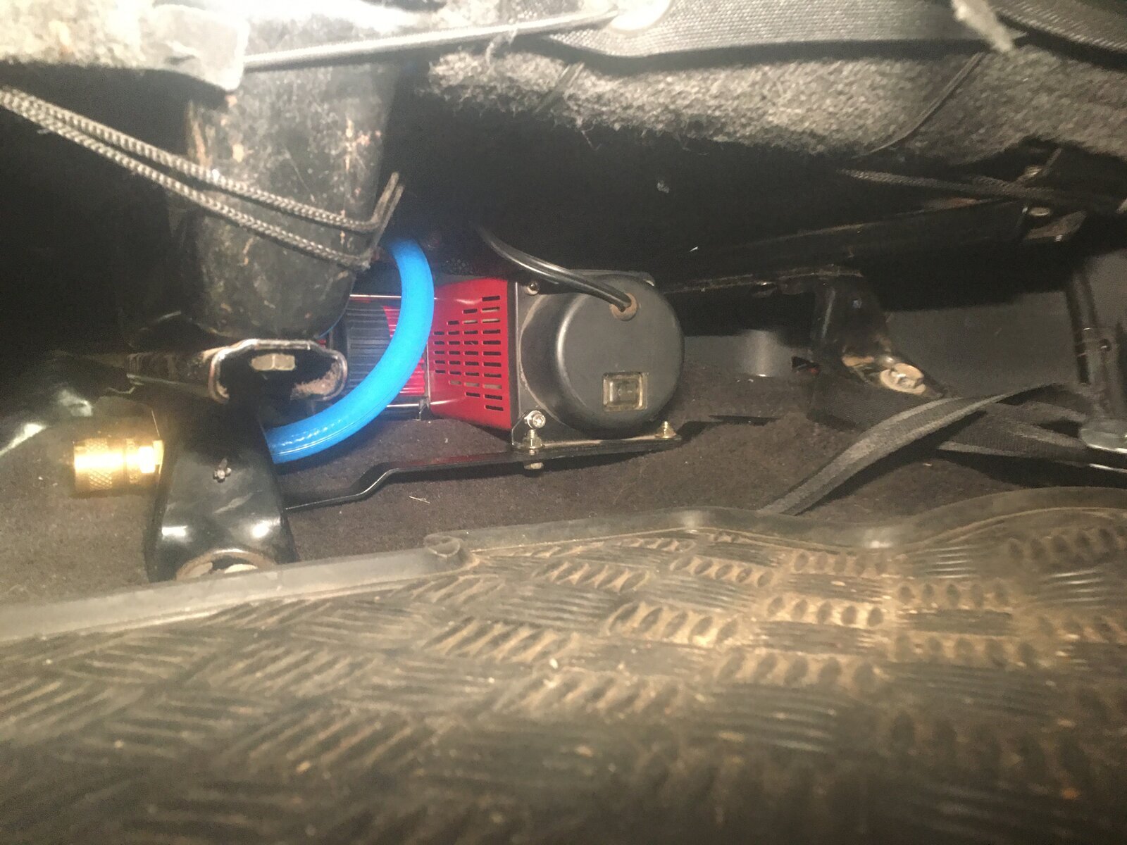

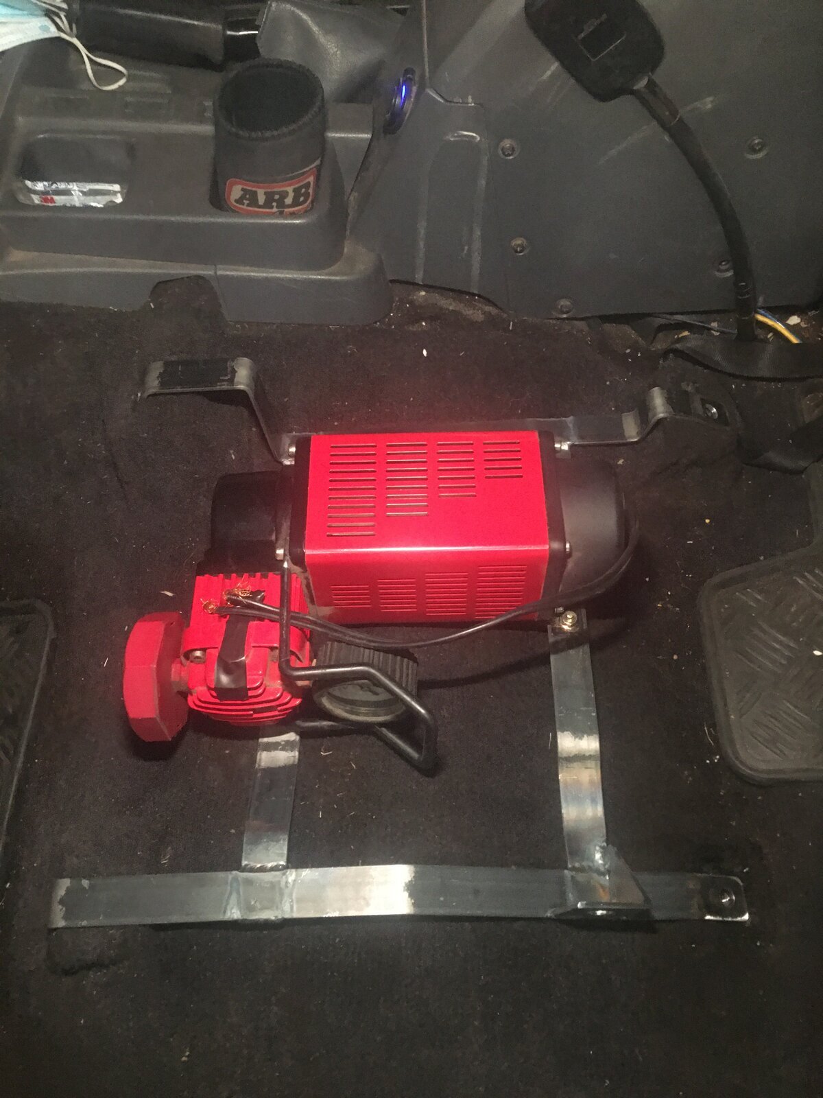

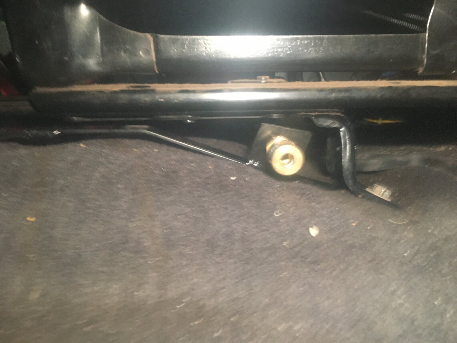

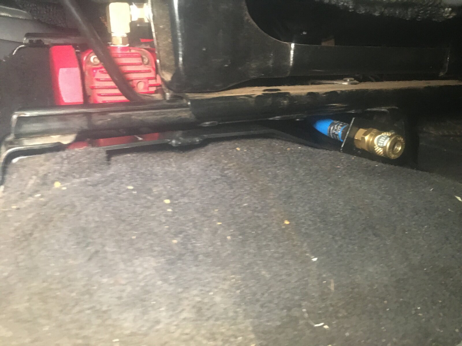

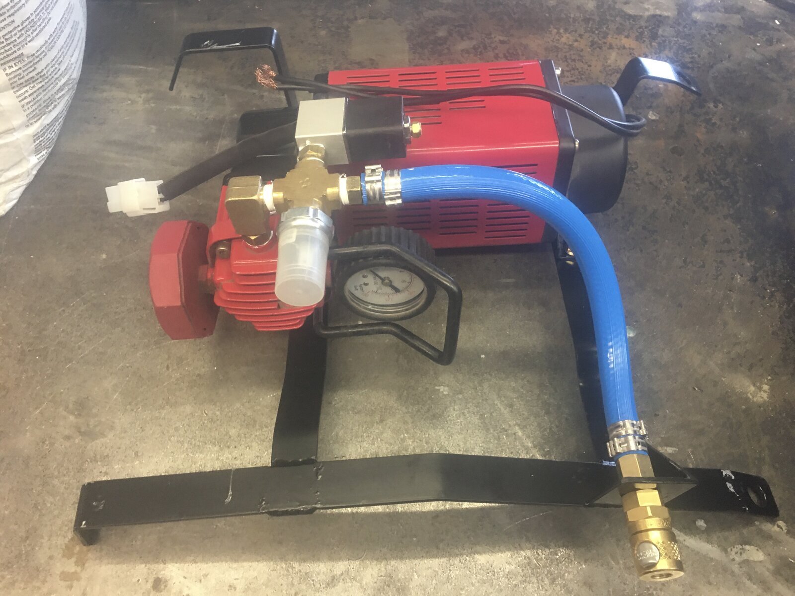

Being the Pro Locker is air operated, I needed to hard mount a compressor. I’ve always just carried a portable 12v compressor in the 78 in the past, for tyre inflating, but those days were over.
I considered using an ARB twin cylinder compressor as we fit them a lot at work, as in Australia at least, they’re regarded as the best 12v compressors you can buy.
But to save some money I decided to use a 12v compressor I got free from work, years ago.

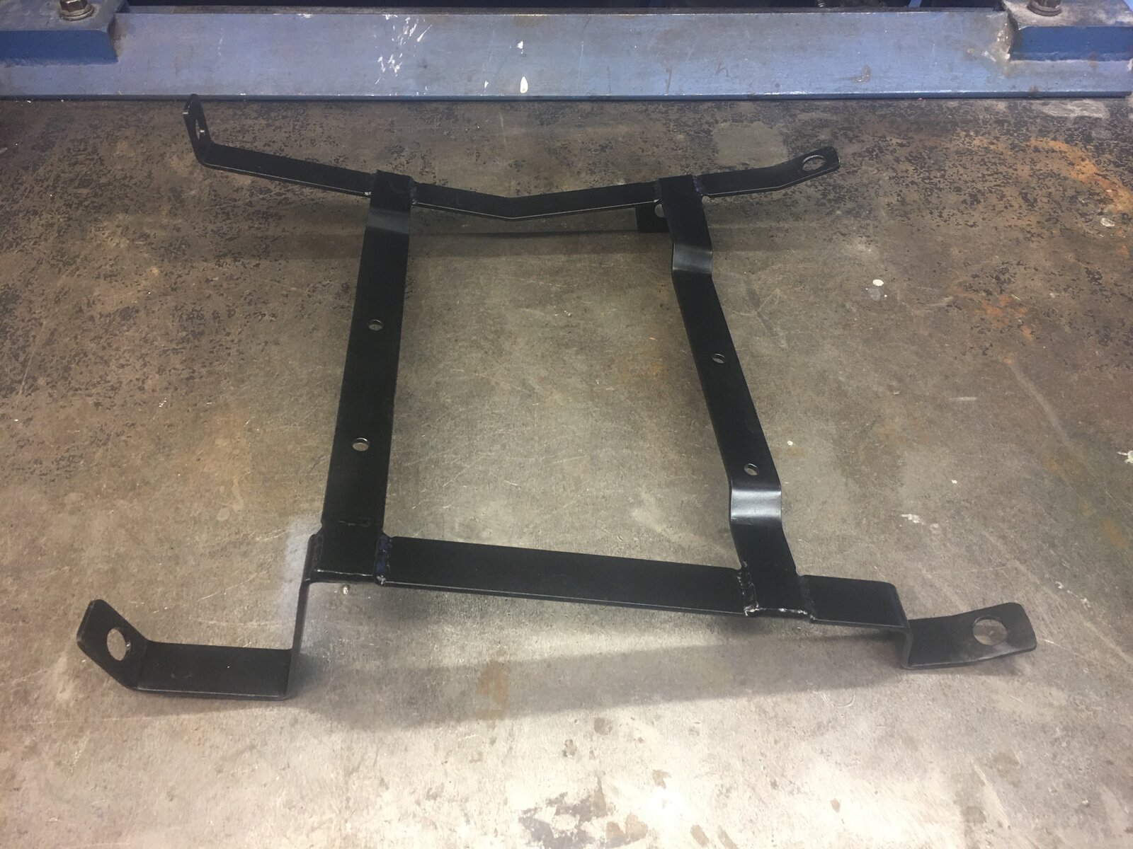

I made a mount to fit it under the passenger front seat.
And that was that job done.

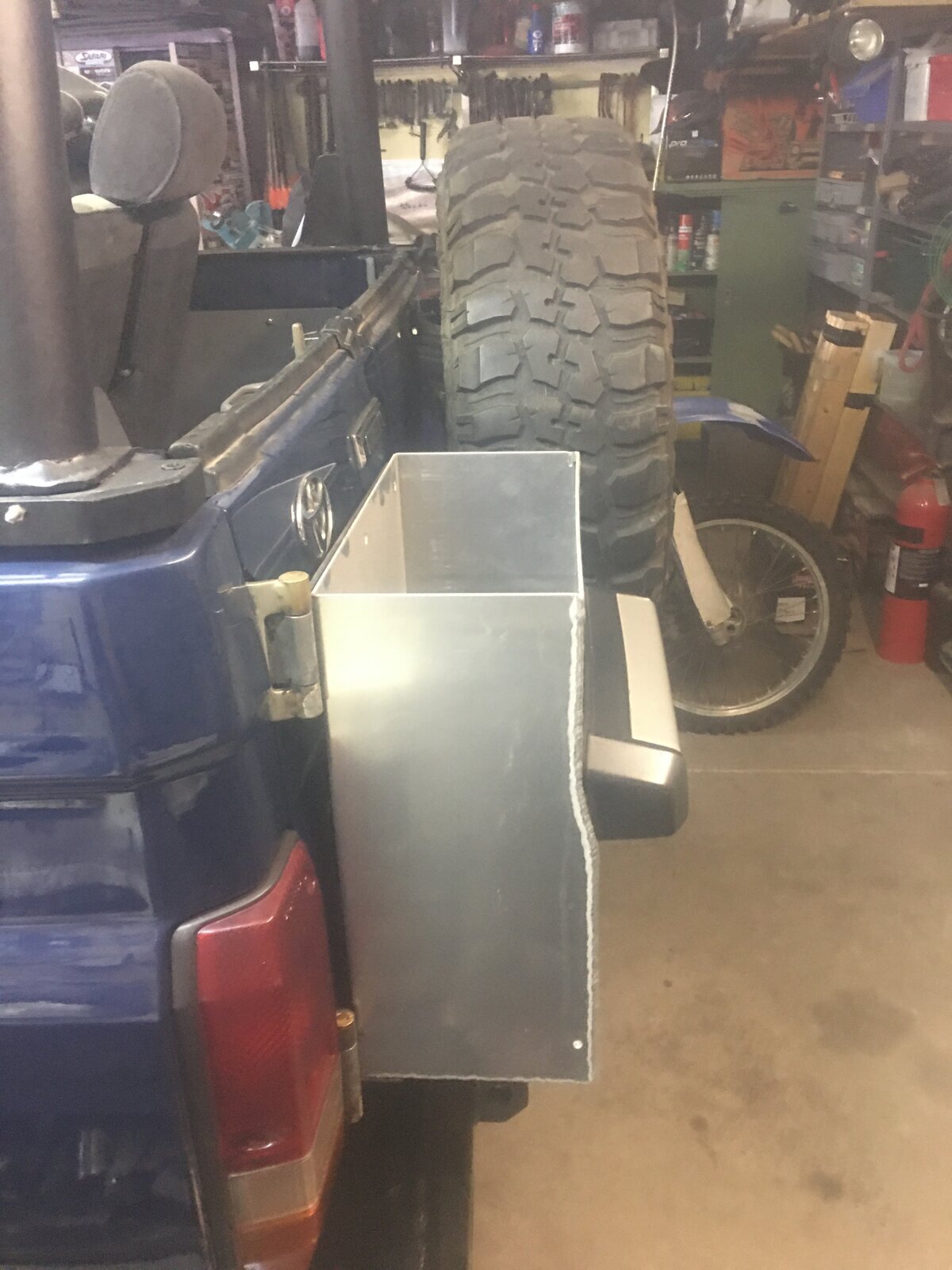

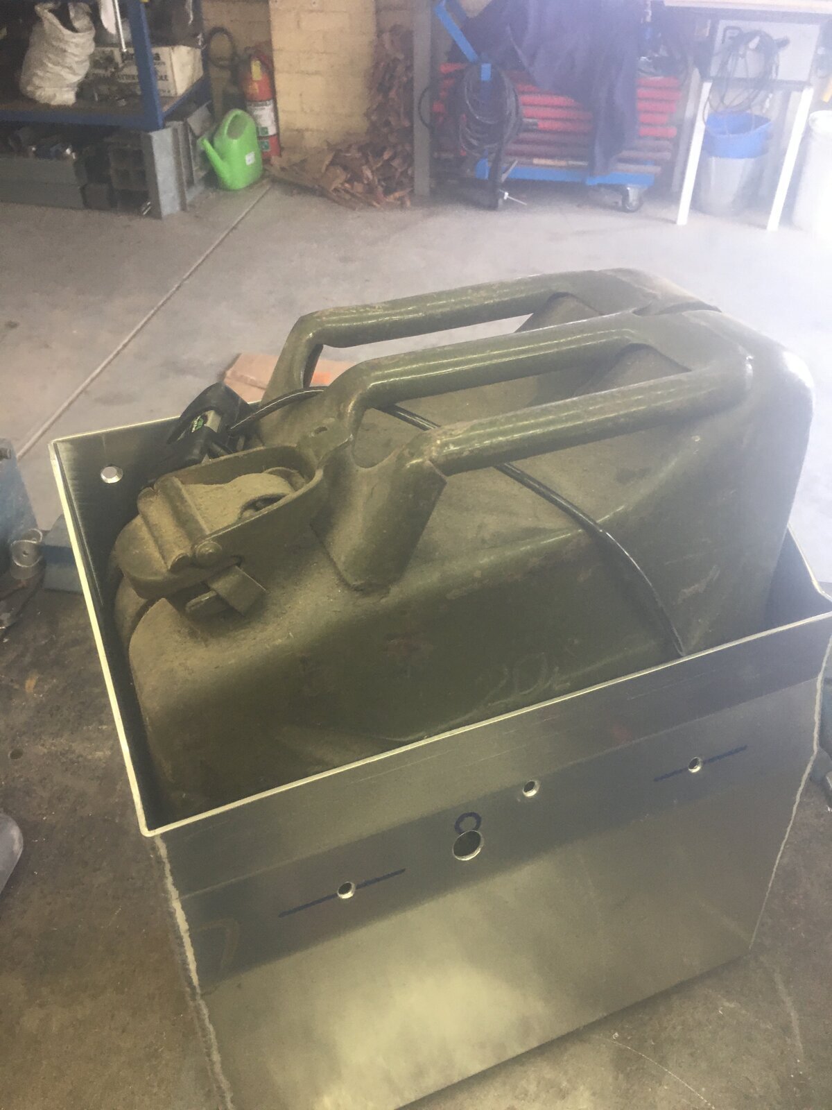

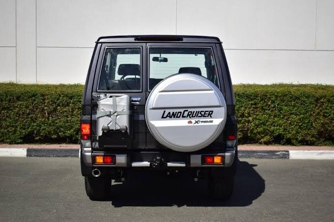

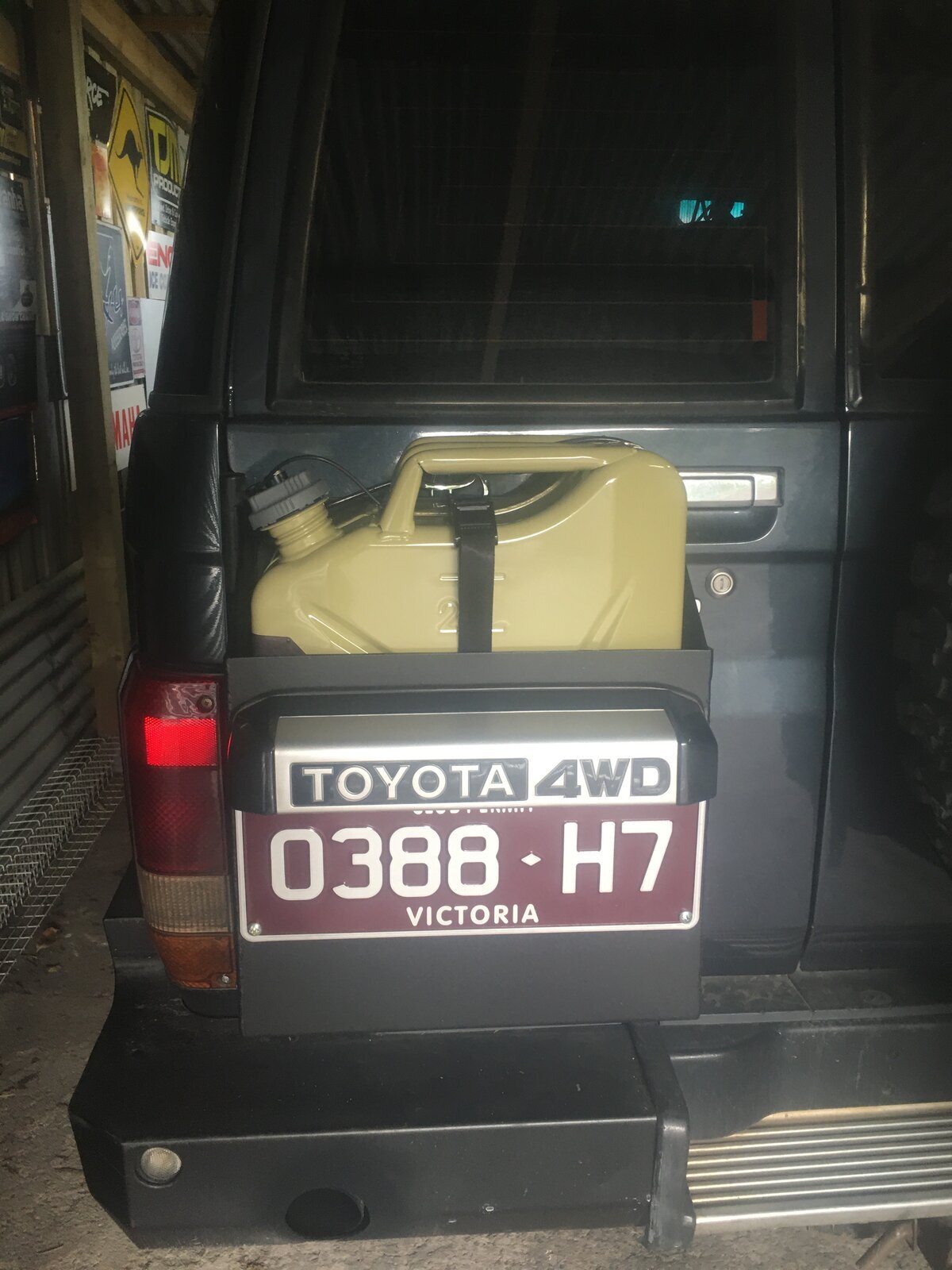

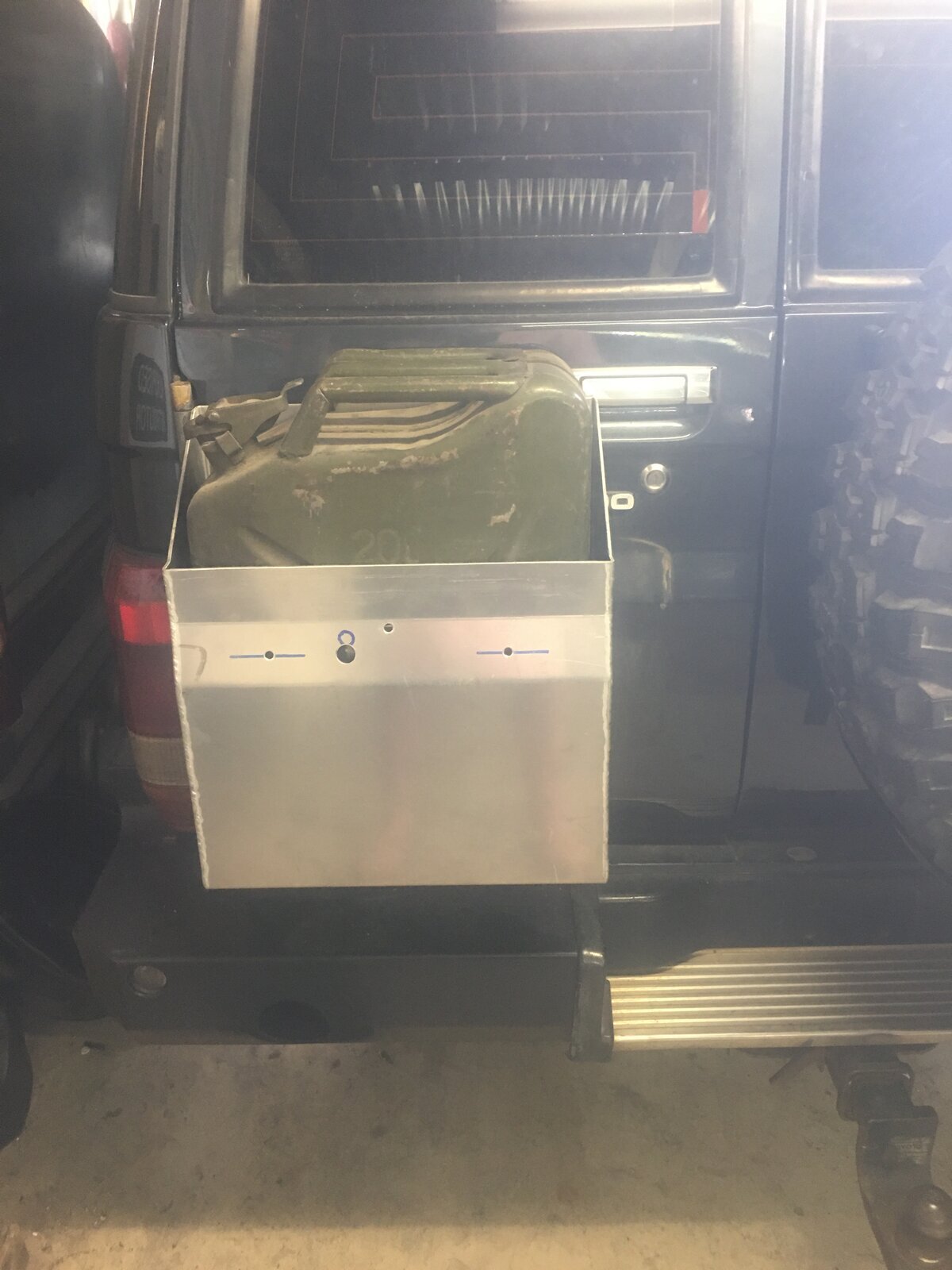

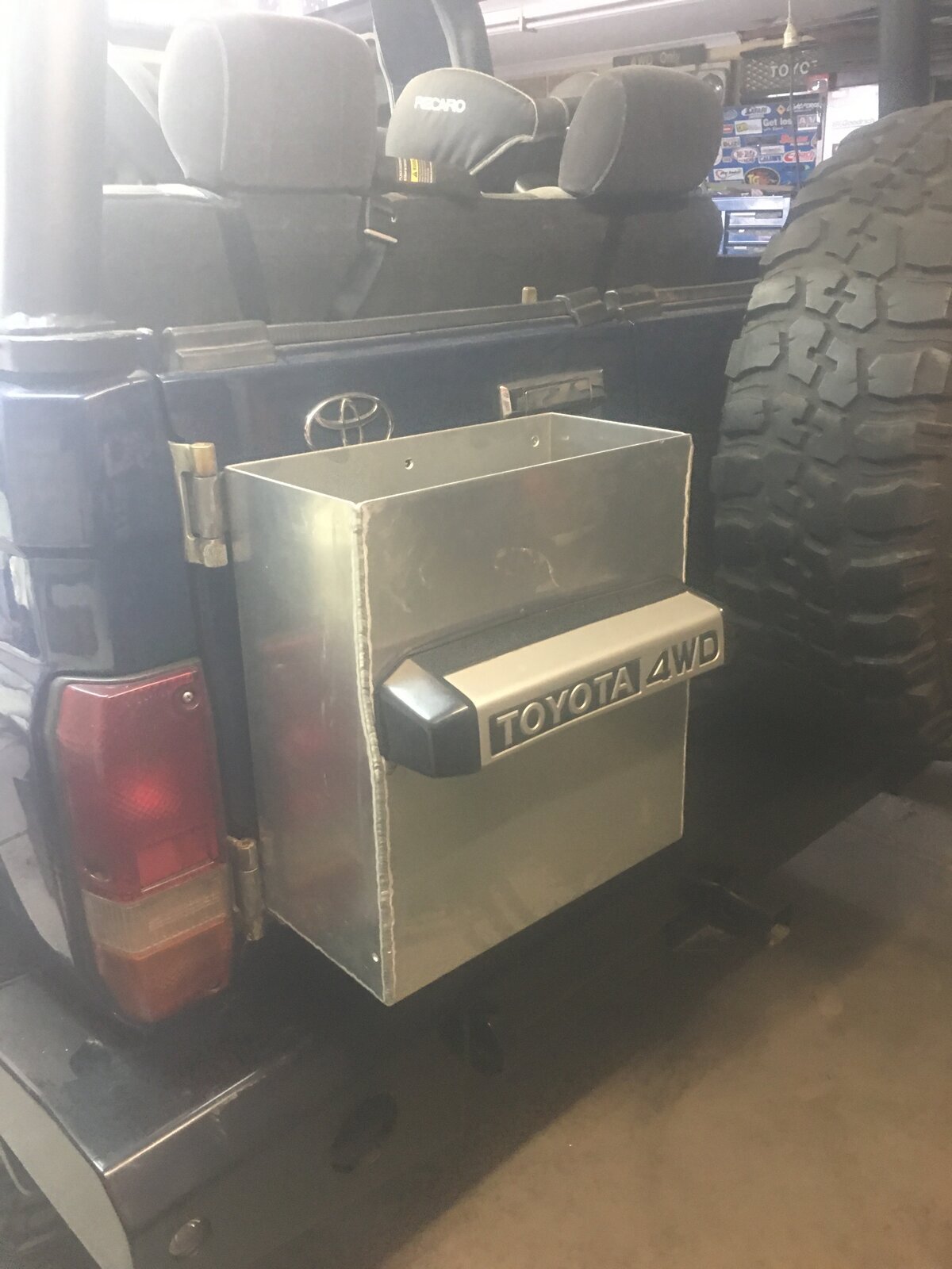

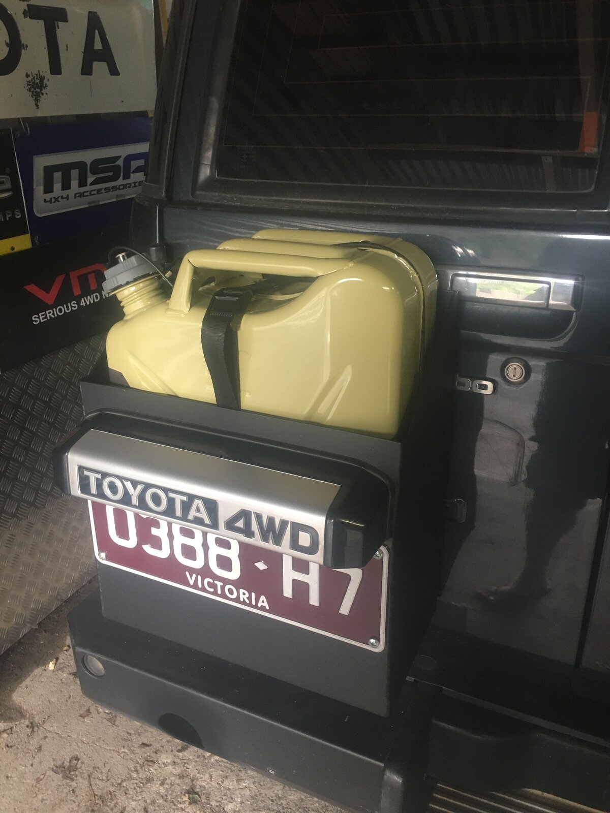

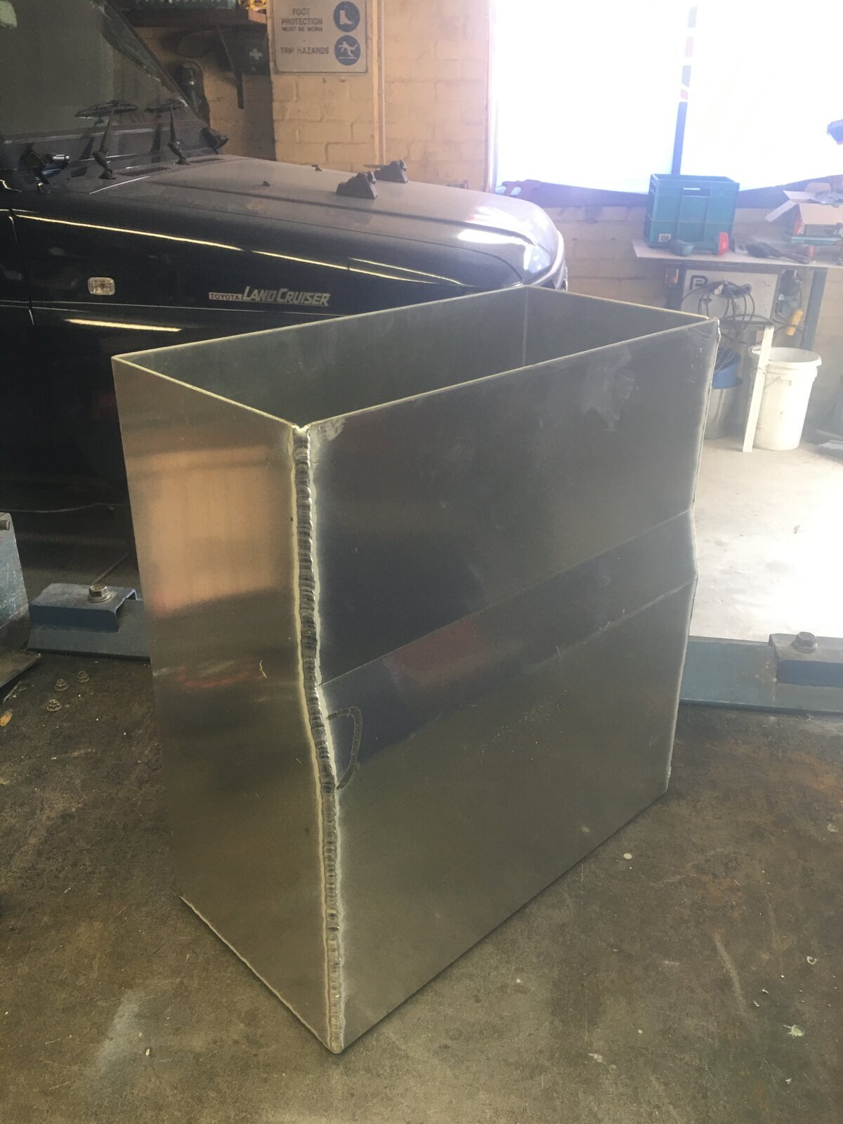

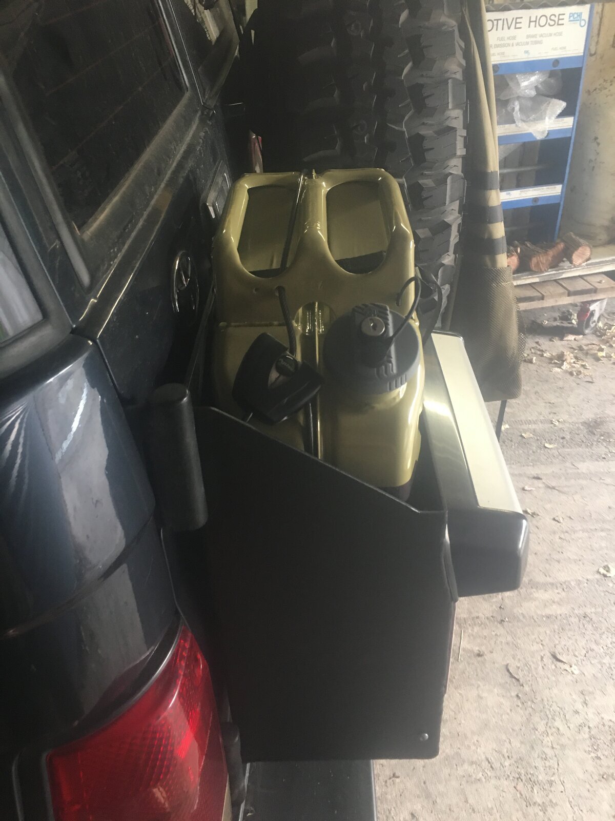

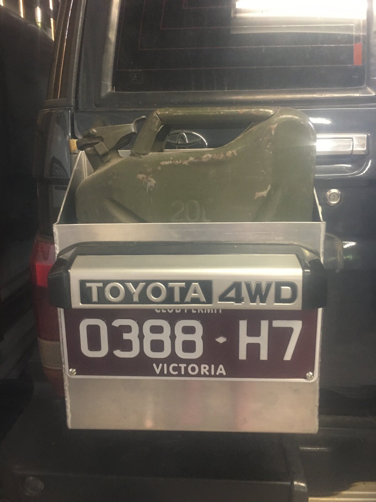

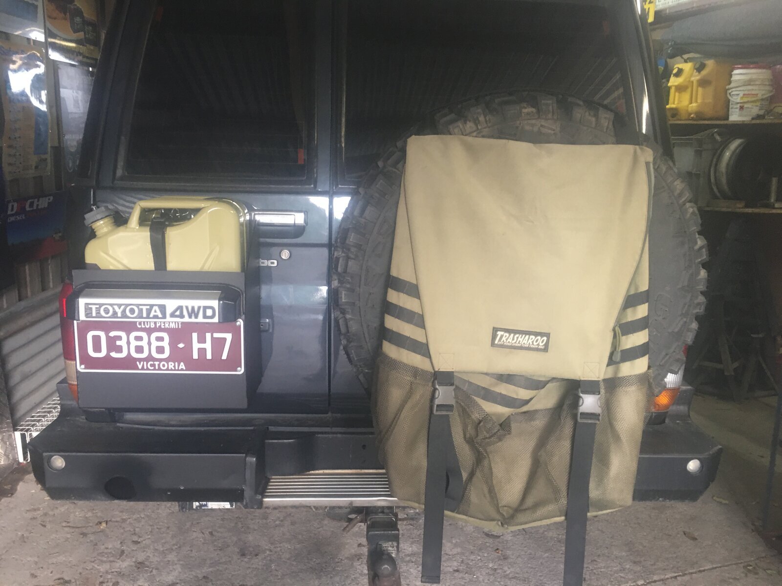

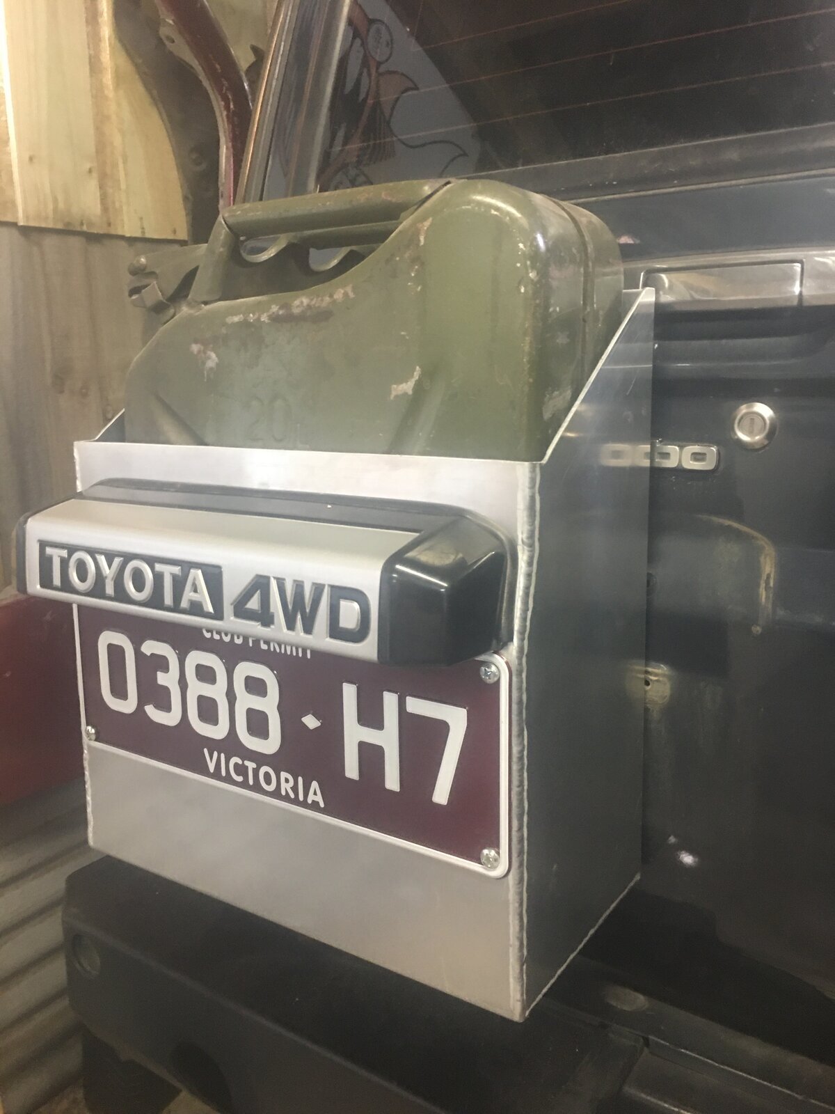

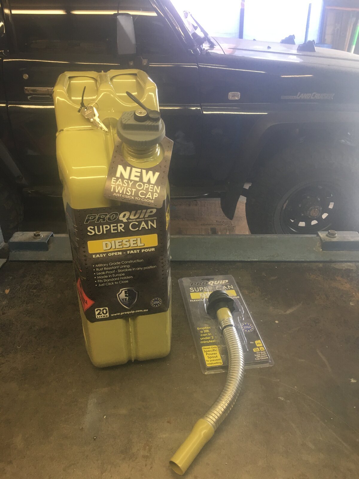

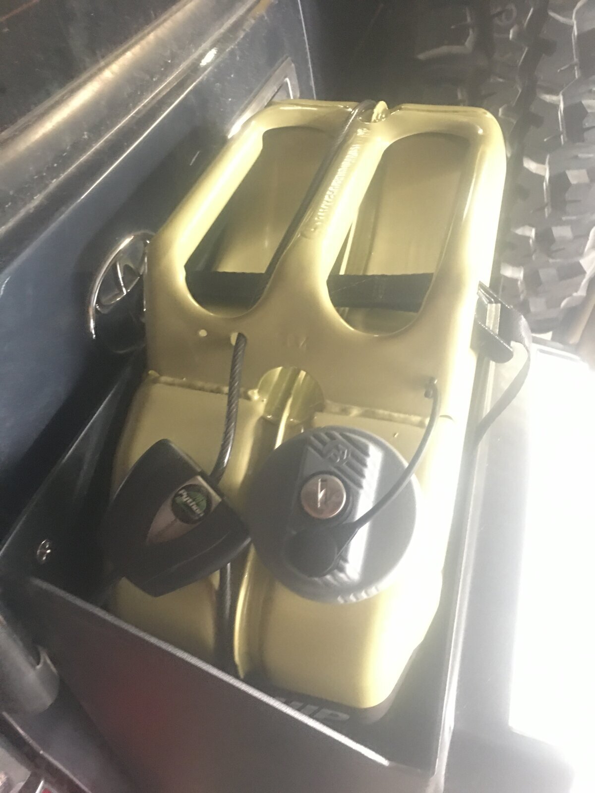

I decided to extend the fuel range of the 78 by carrying a 20 litre jerry can on the little rear door.
The genuine fuel can holders available in the GCC market GRJ70’s is what inspired me.73FD243A-2DC6-4E36-98DE-5826F85637DB.jpeg
What I didn’t like was the fact the can and can lid is unsecured from a theft/vandalism point of view and I also don’t like the number plate light or how low the number plate mounts.
I knew I could do better!
This is what I came up with………

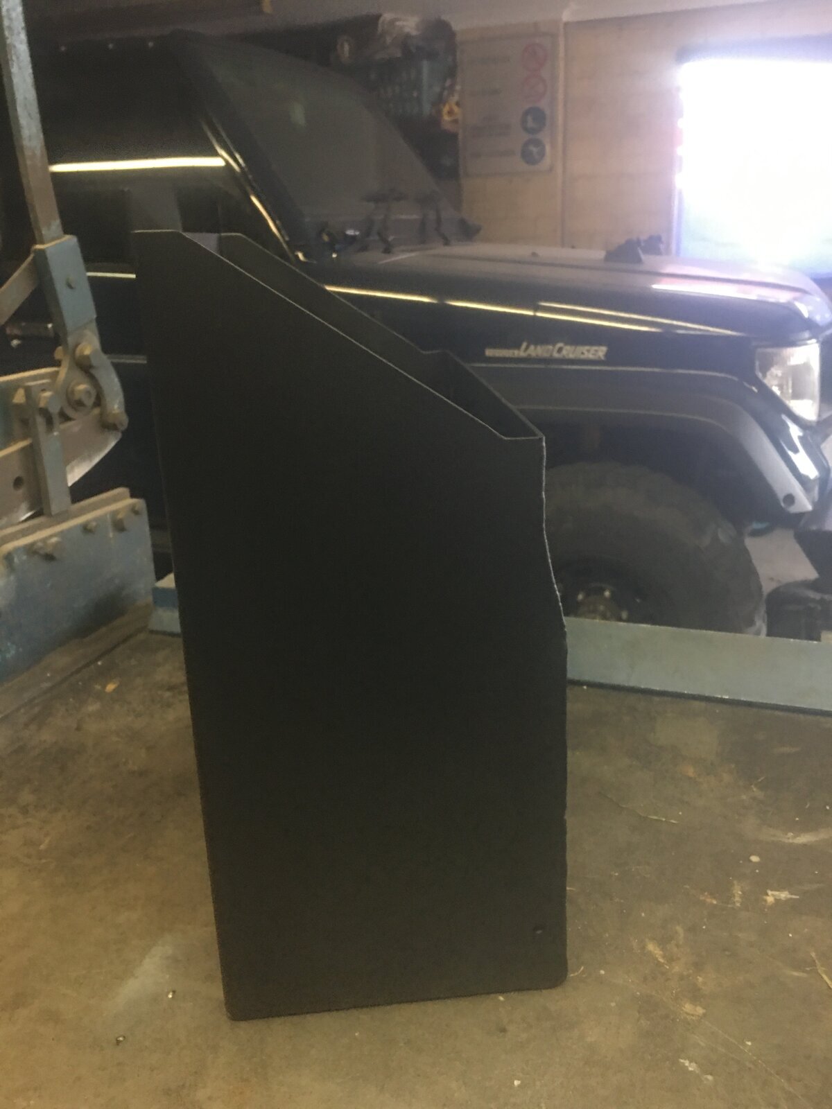

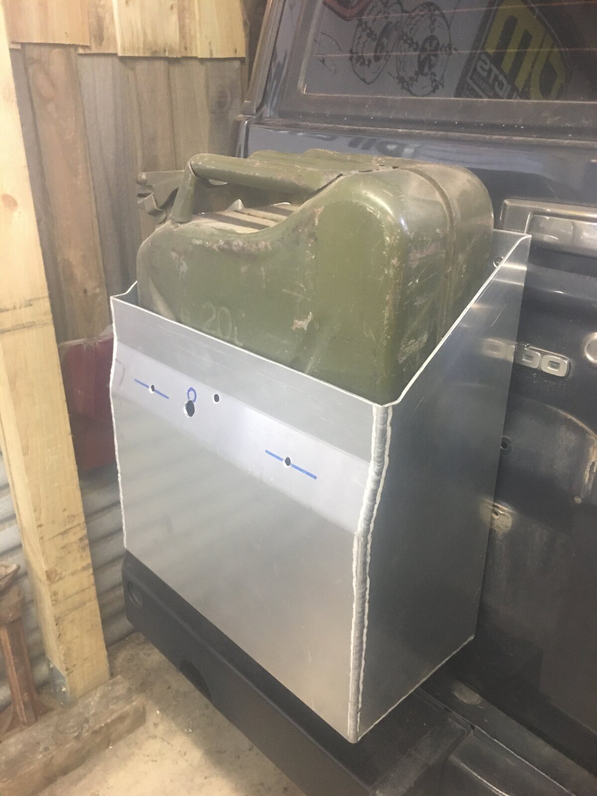

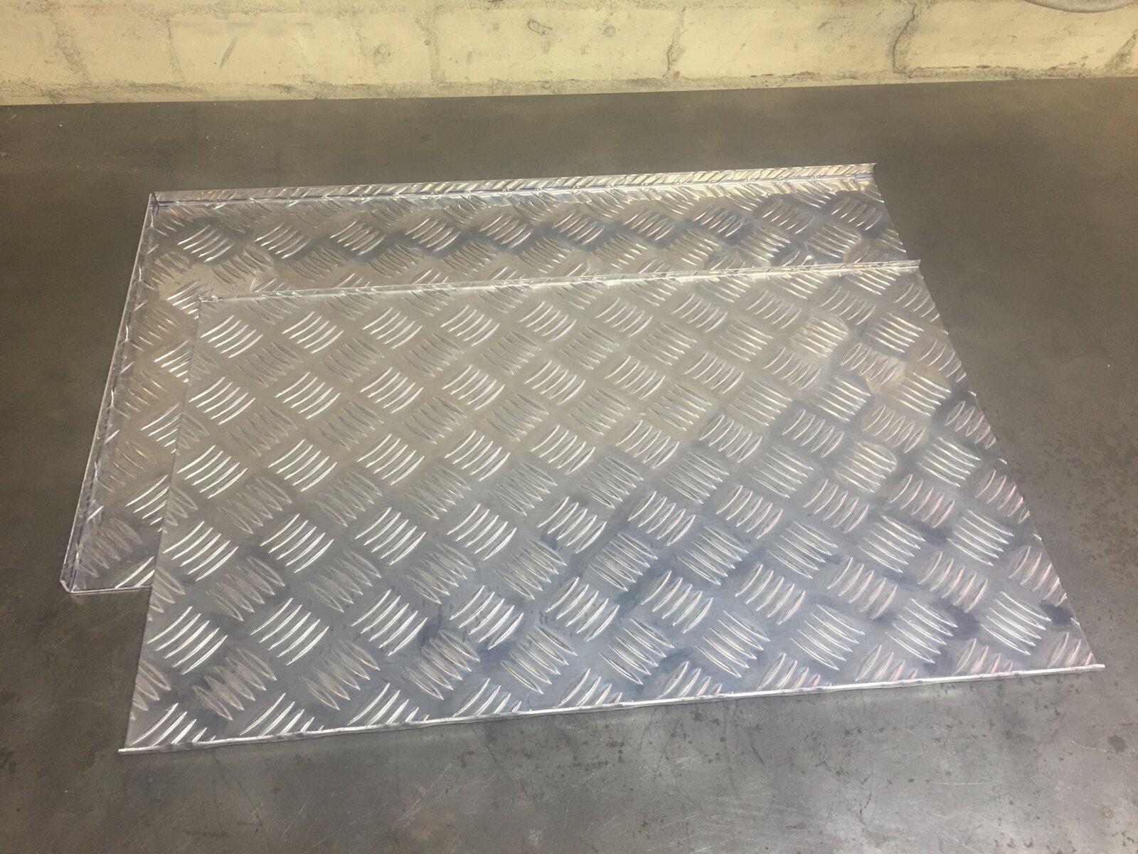

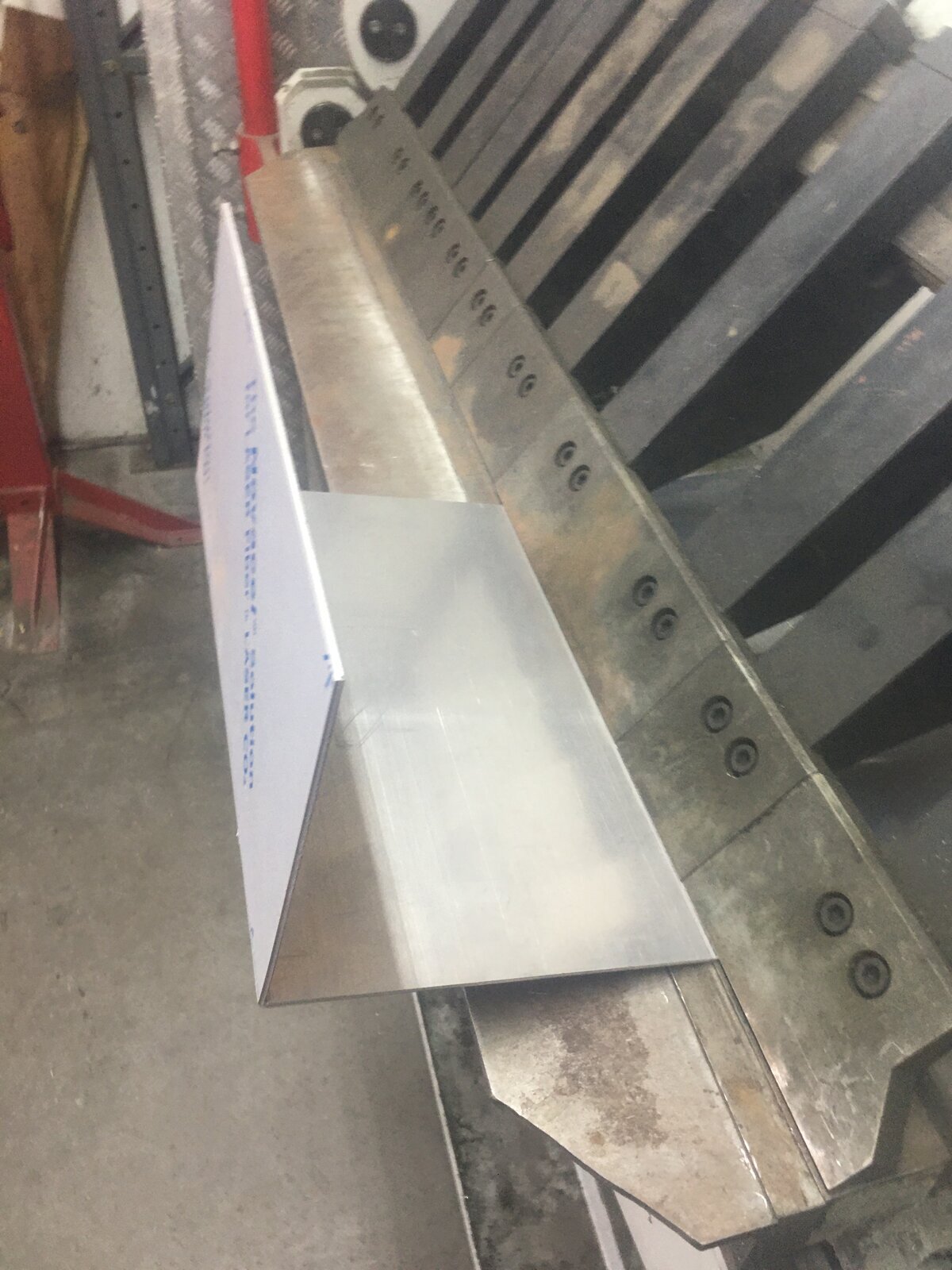

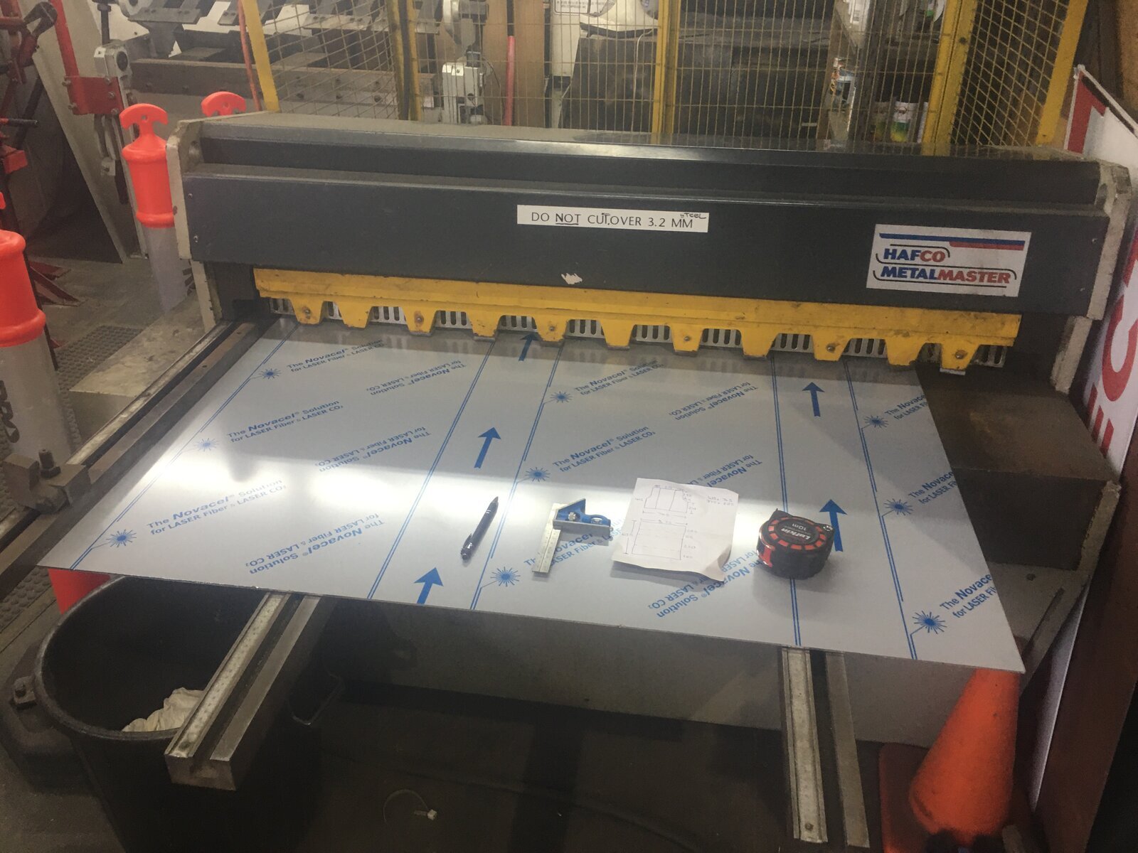

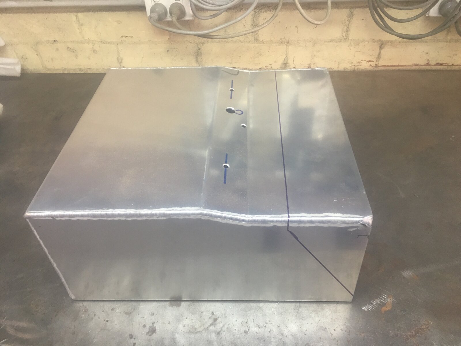

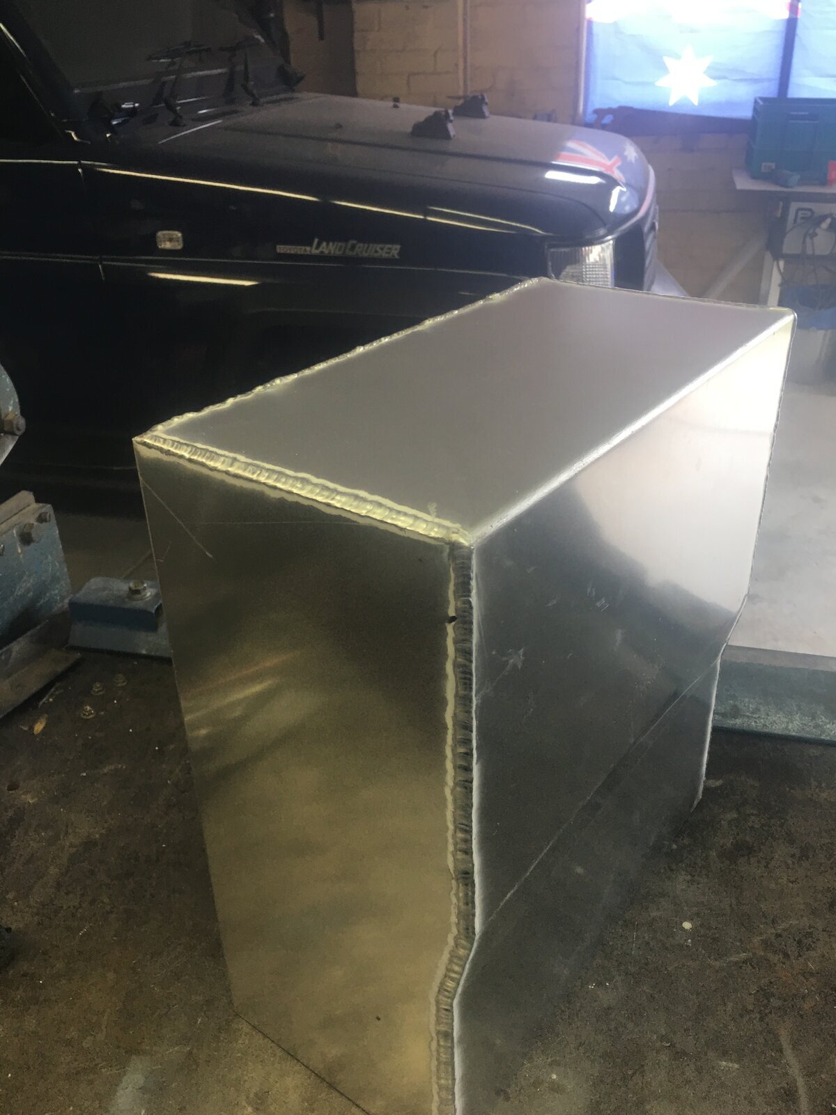

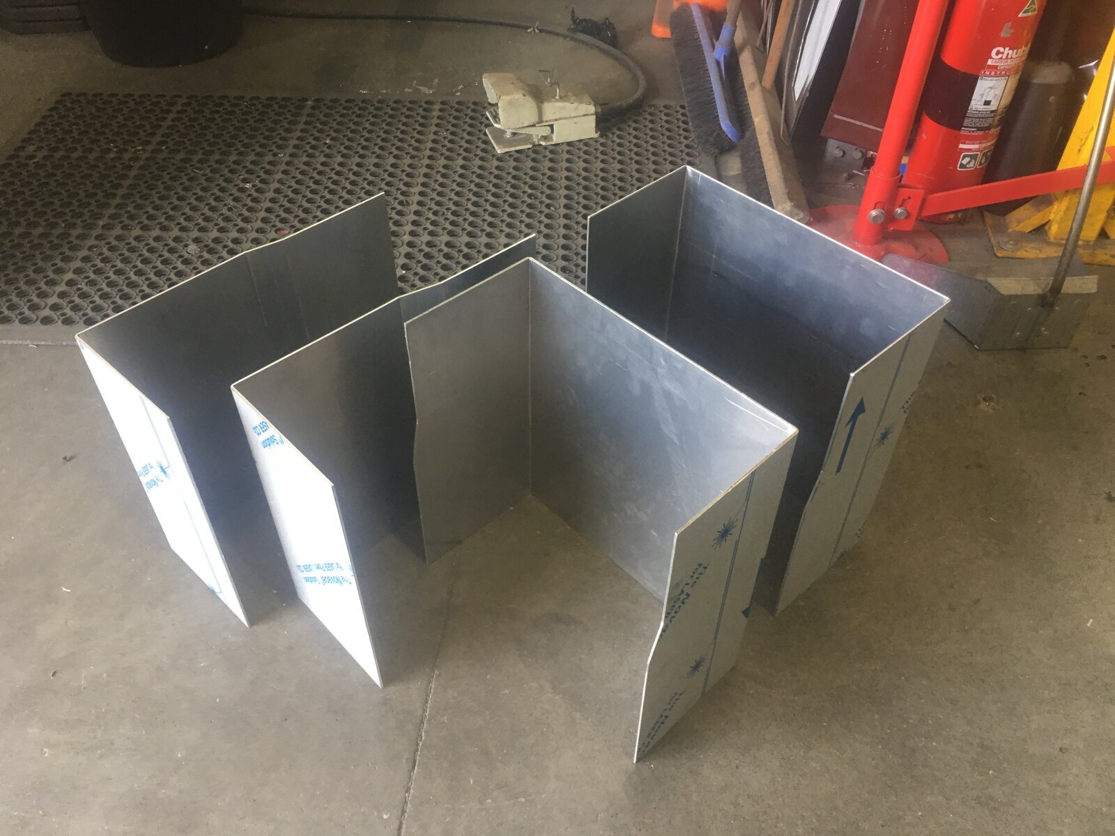

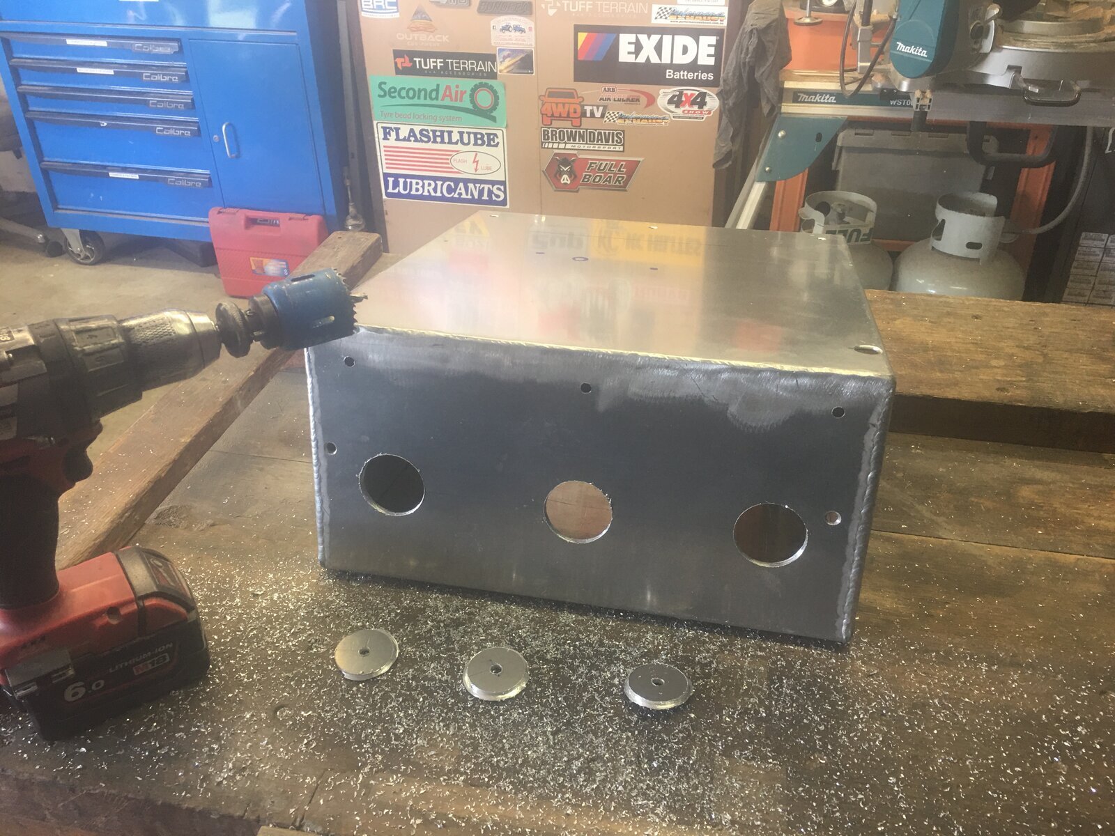

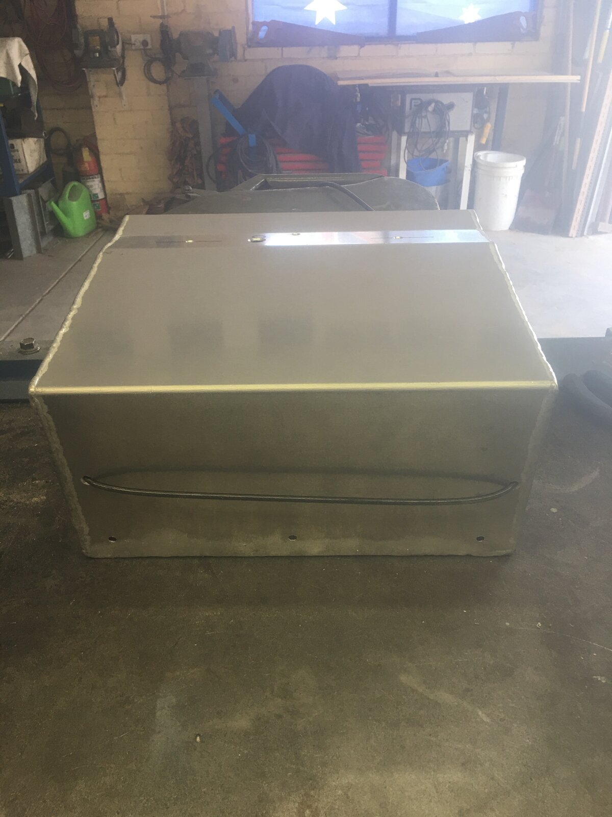

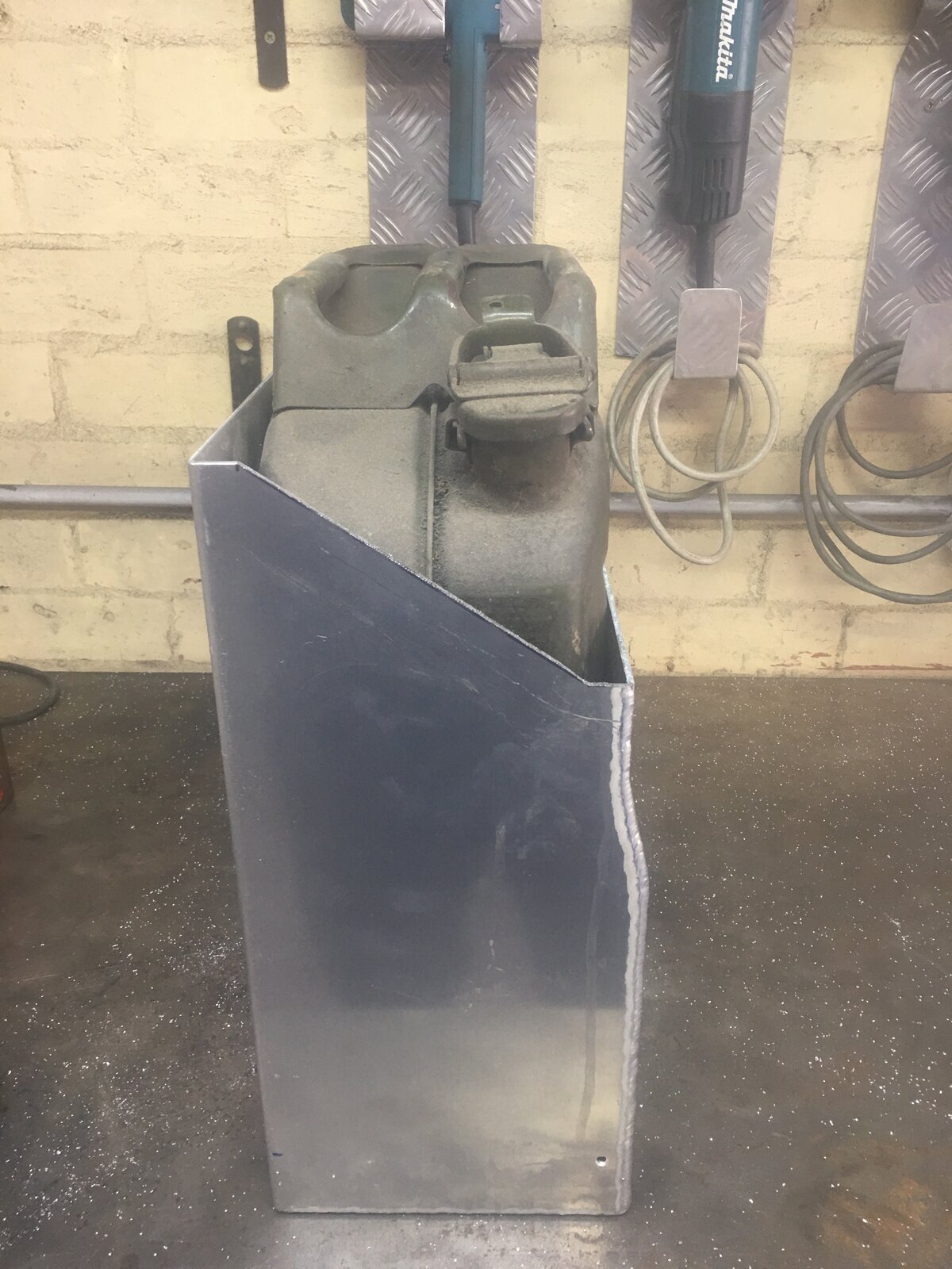

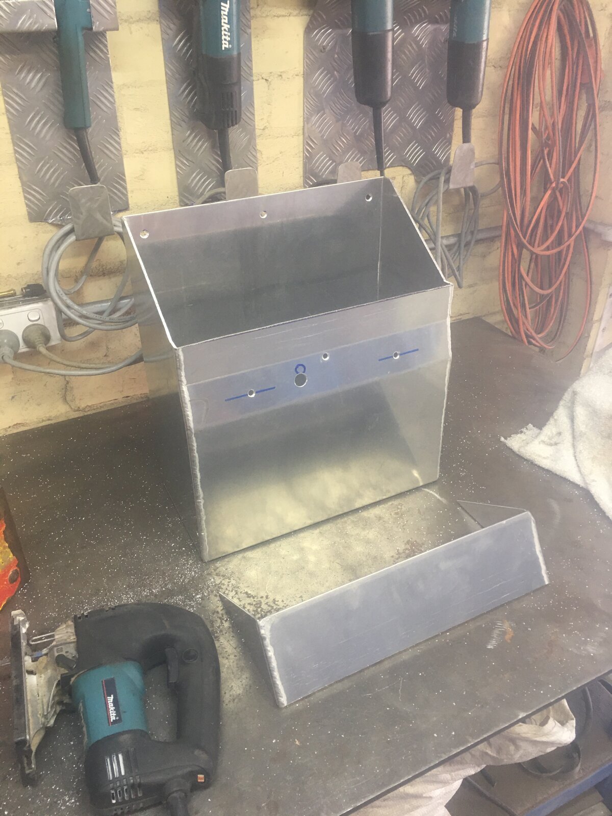

Cut some 3mm thick aluminium sheet.

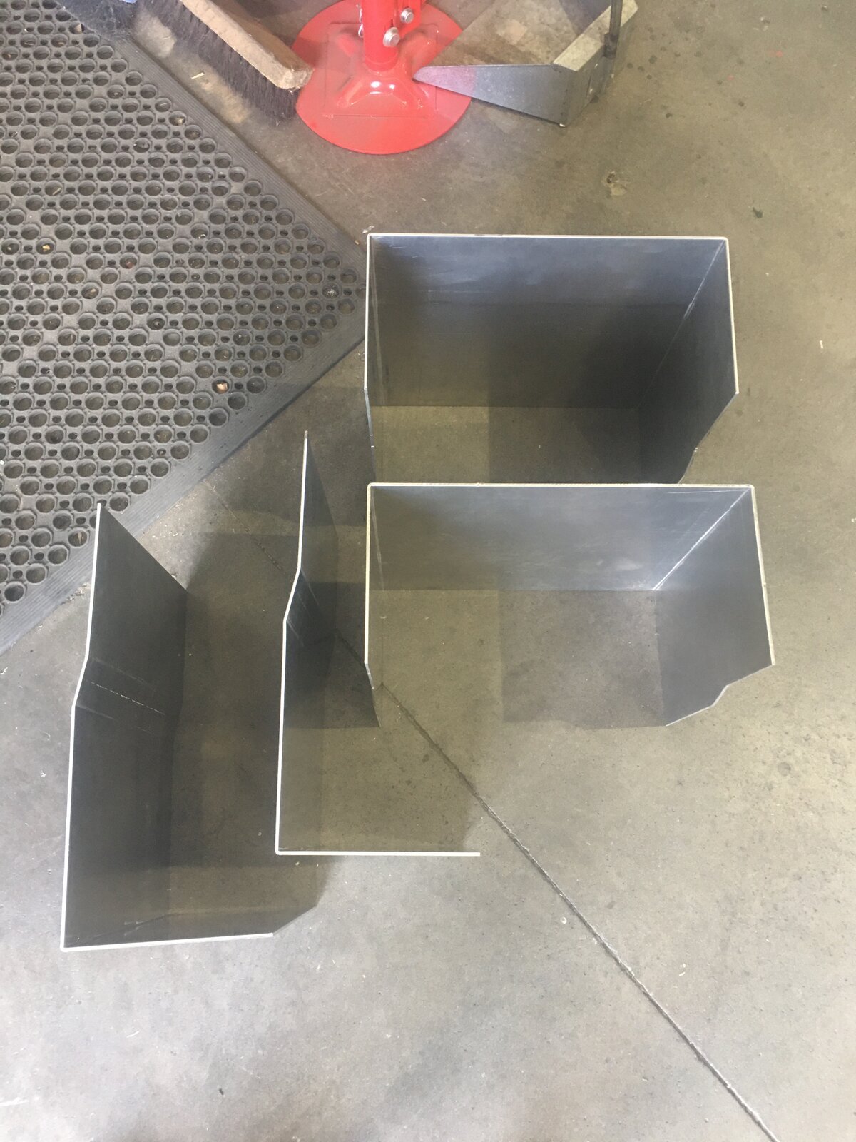

Folded it.

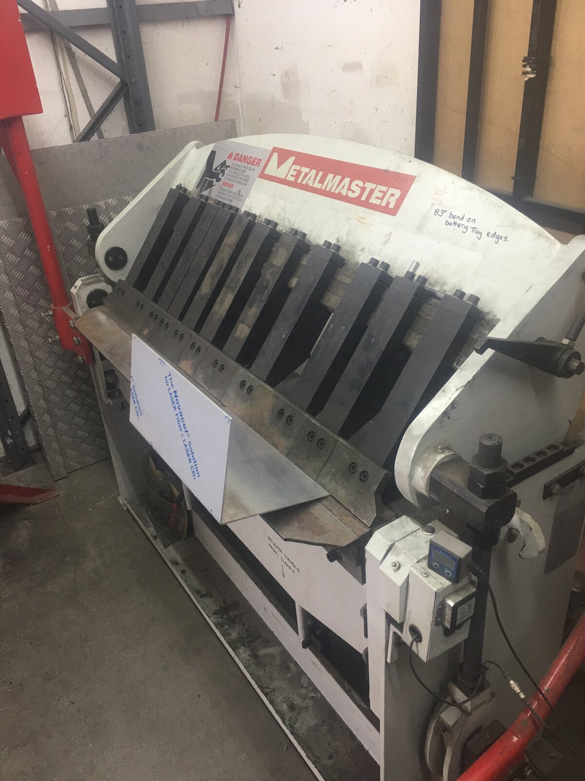

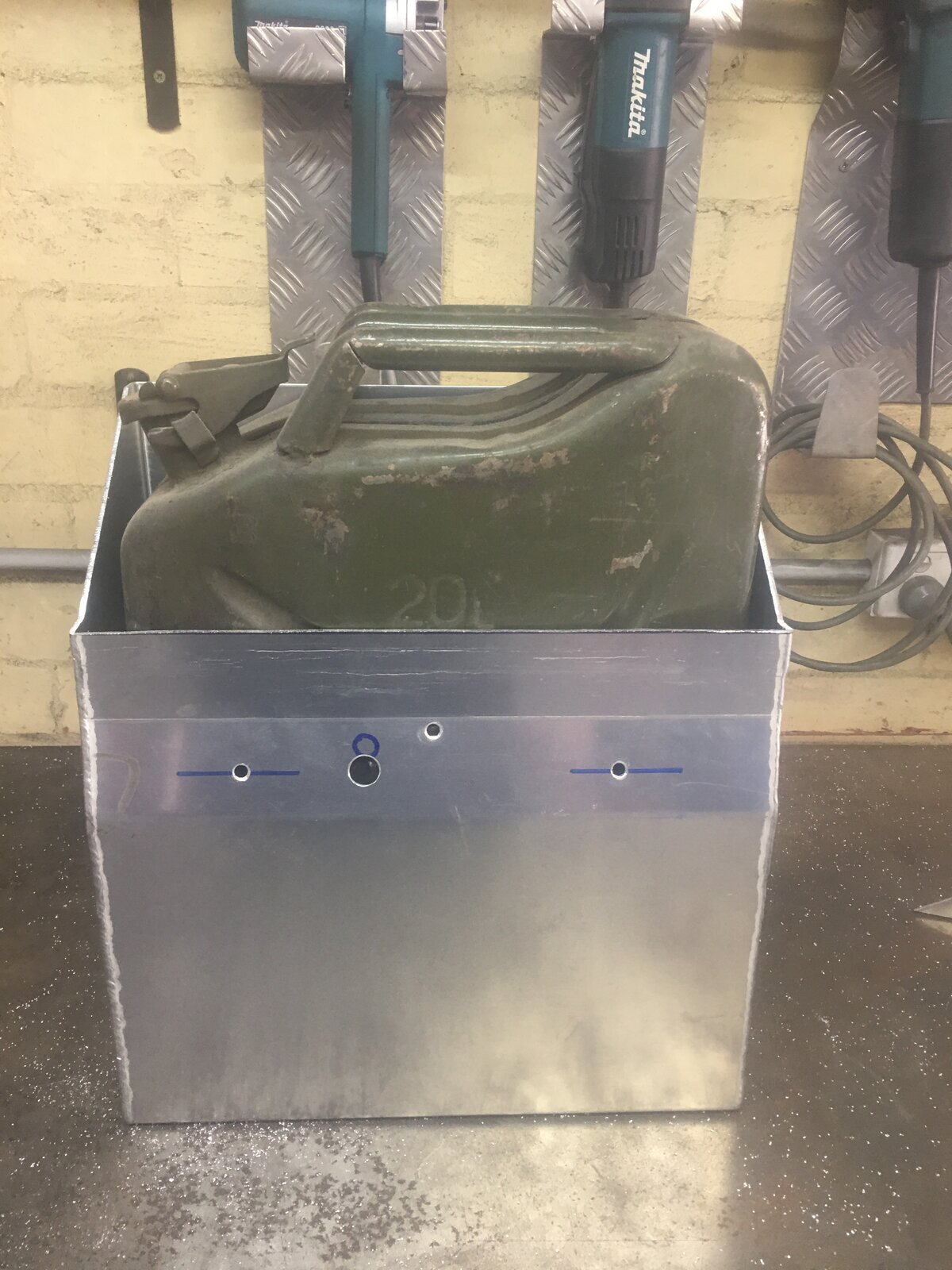

The half sheet of aluminium was enough to make 2 can holders, so I figured I might as well make 2.

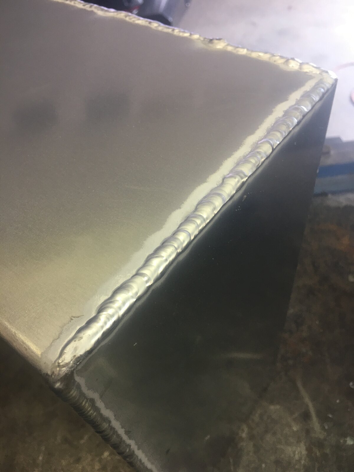

Welded the 2 sections together.

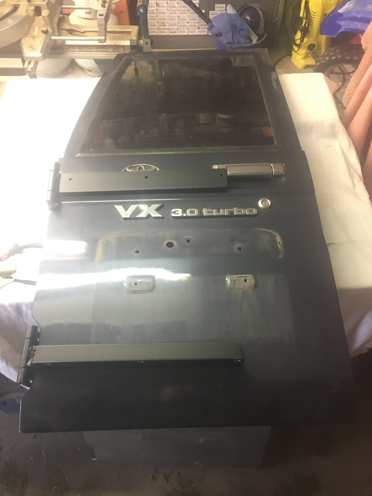

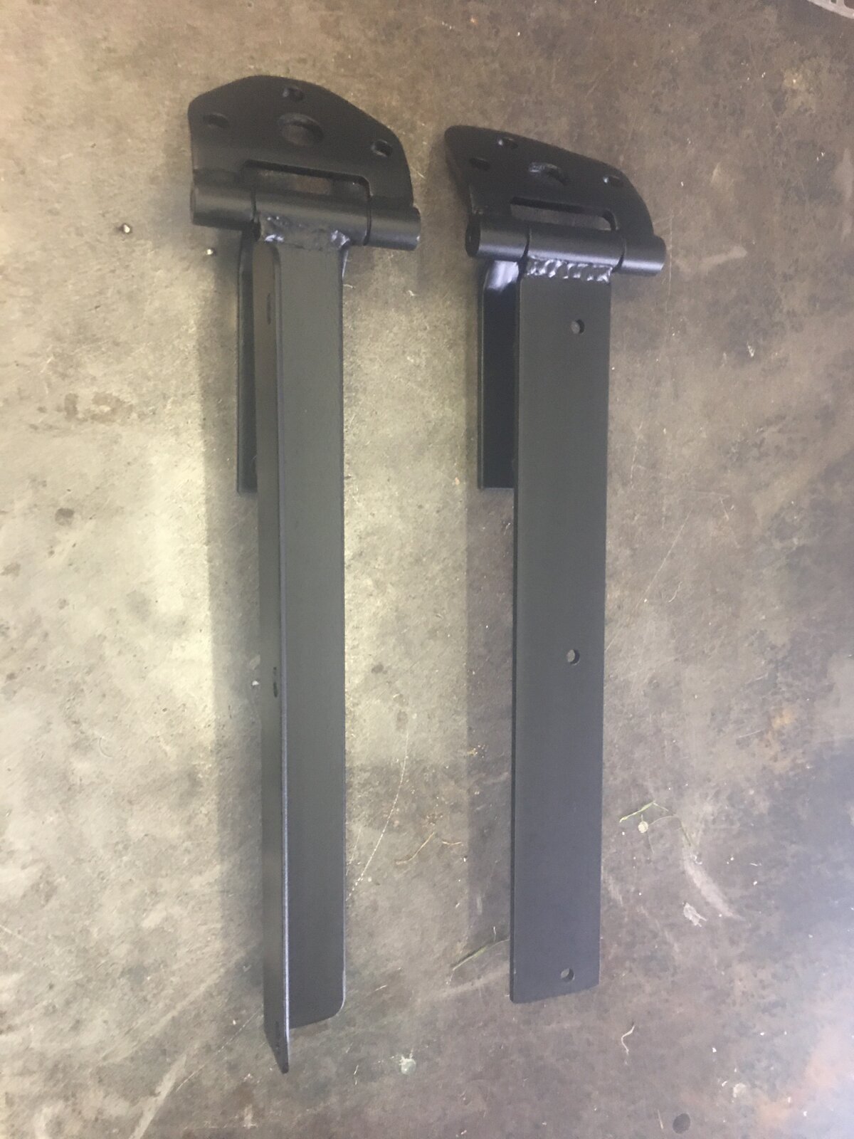

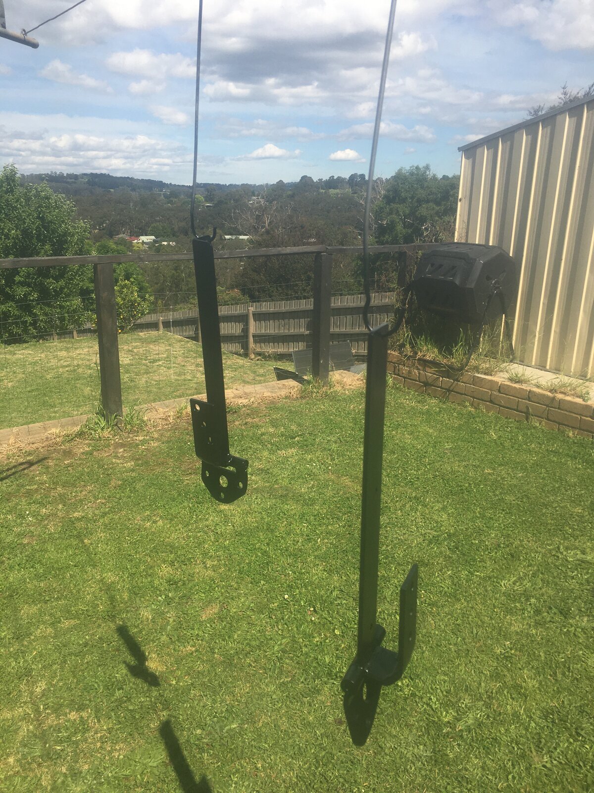

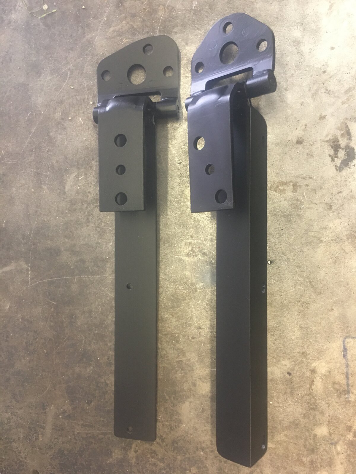

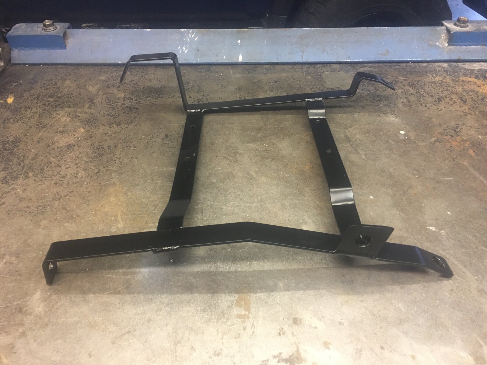

I made up the steel brackets that get welded to the door hinges, on a spare door.
I actually changed from this first design, to a piece of flat on the top hinge and angle on the bottom.
This first one was flat top and bottom.

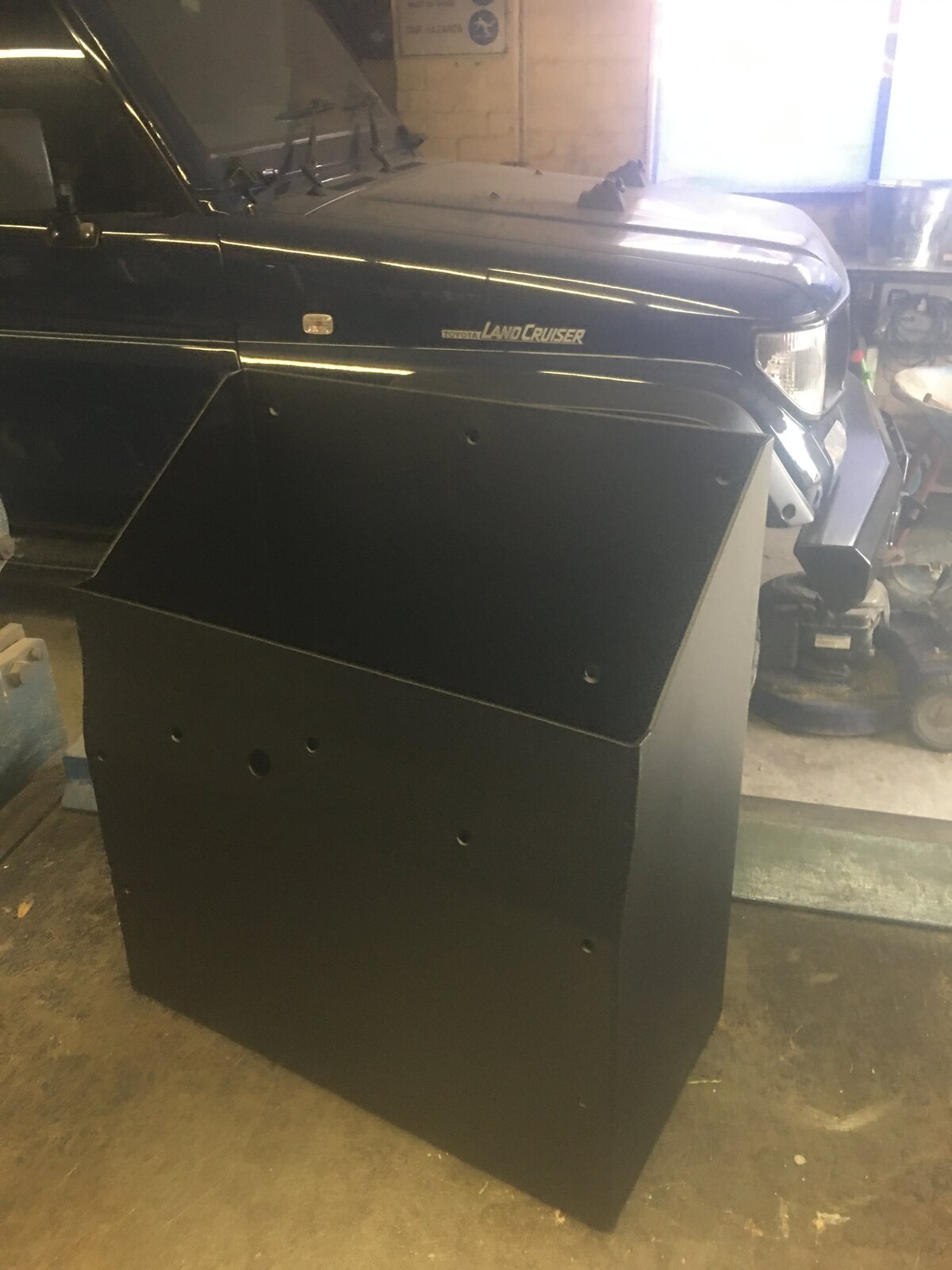

I bolted it onto LJ to see how it fitted and worked.
I didn’t like how square and boxey it looked so decided to trim it down.

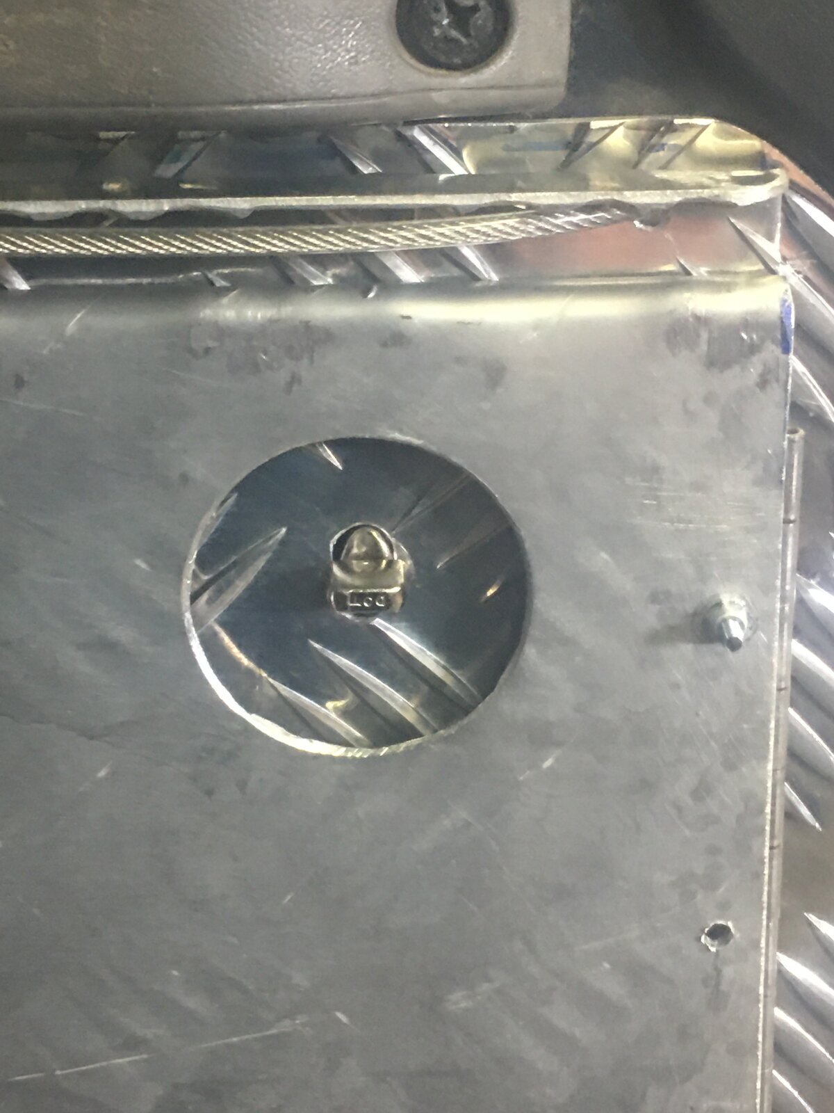

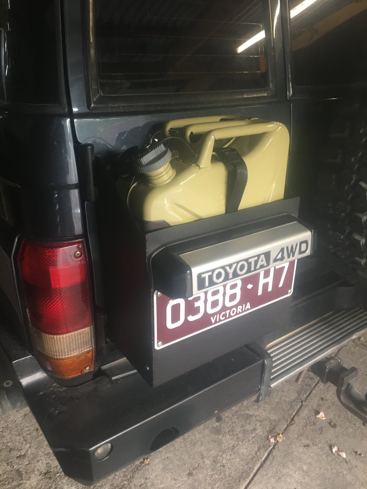

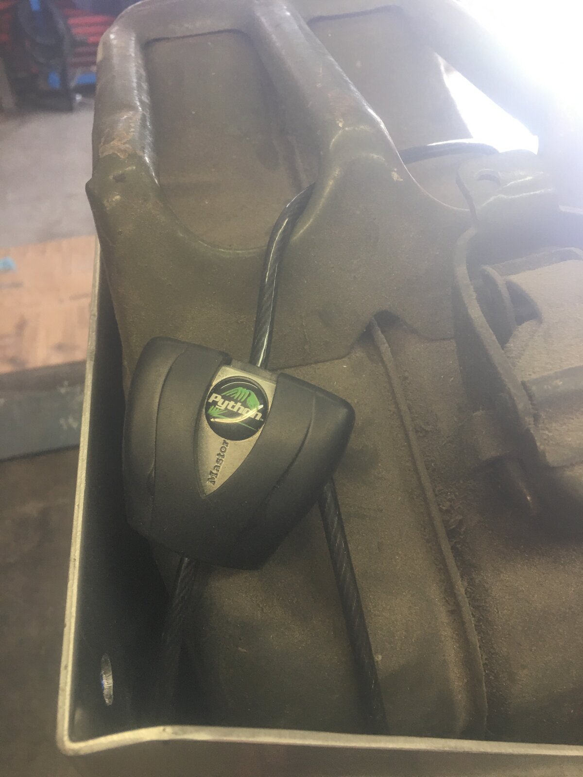

I purchased a lock to secure the can.
I made some water drainage holes.
Trial fitted it onto The 78.
I painted the brackets rather than powder coating as I thought the powder coating would crack with the hinge moving.

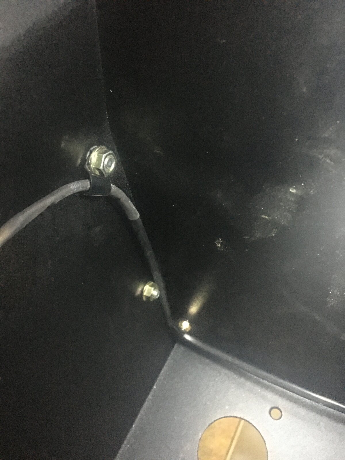

Bolted them to the door.
I got the can holder powder coated textured black.

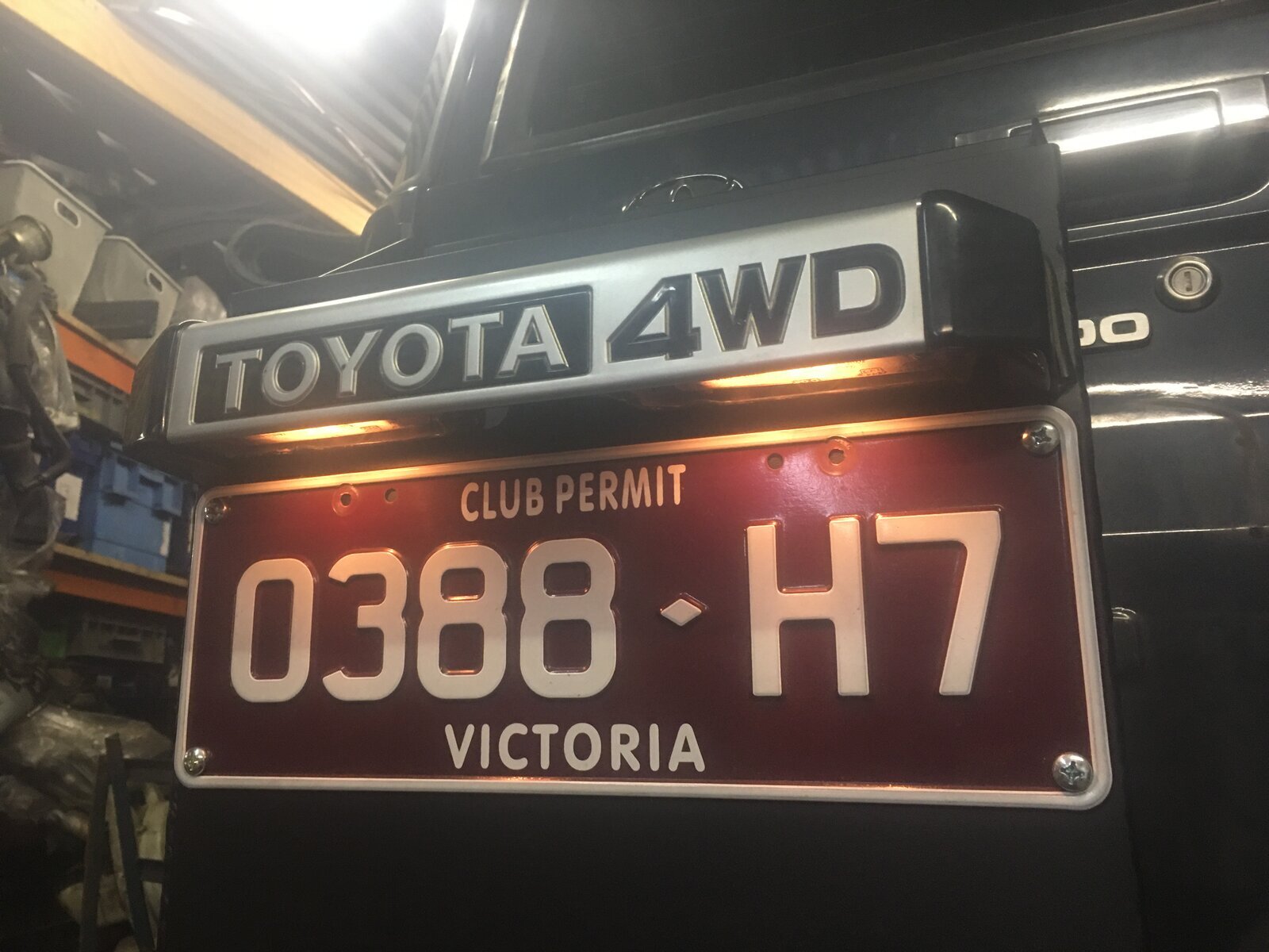

Wired up the number plate light.

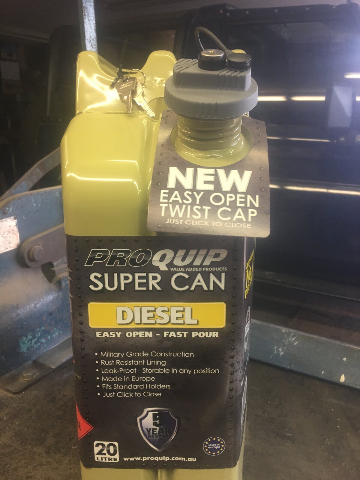

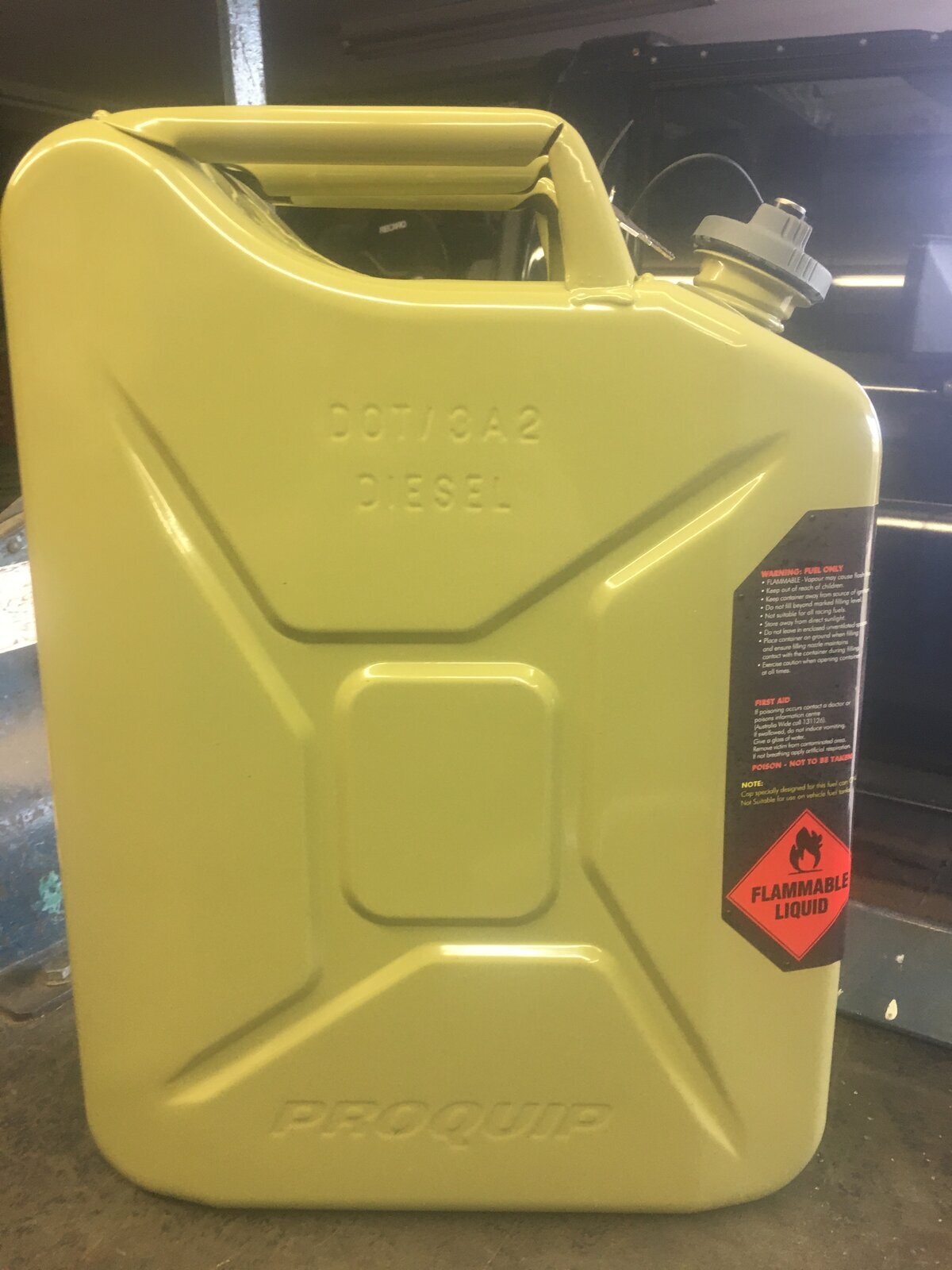

Picked up a new fuel can with locking cap and screw on spout.
I also got another can for my internal jerry can holder.
So the can now has 40 litre in jerry cans plus the 90 litre main tank.
That will be enough for the trips I plan on doing.

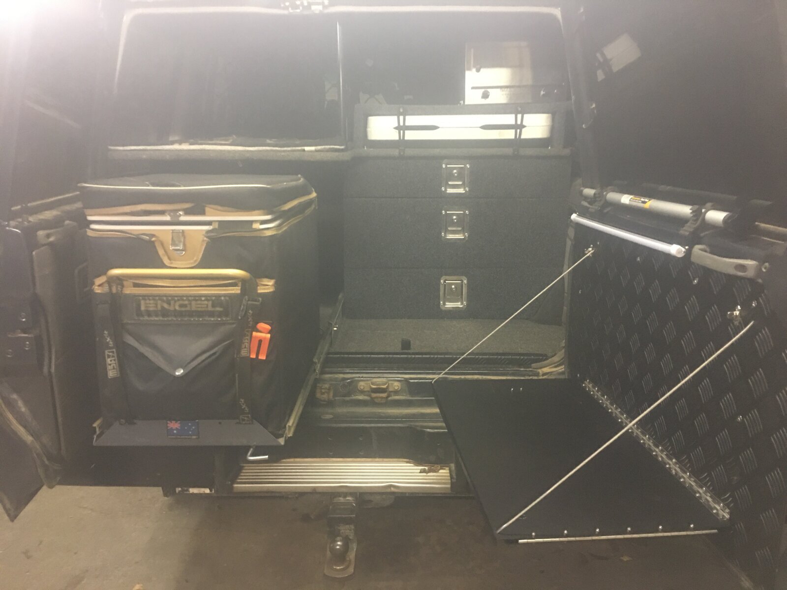

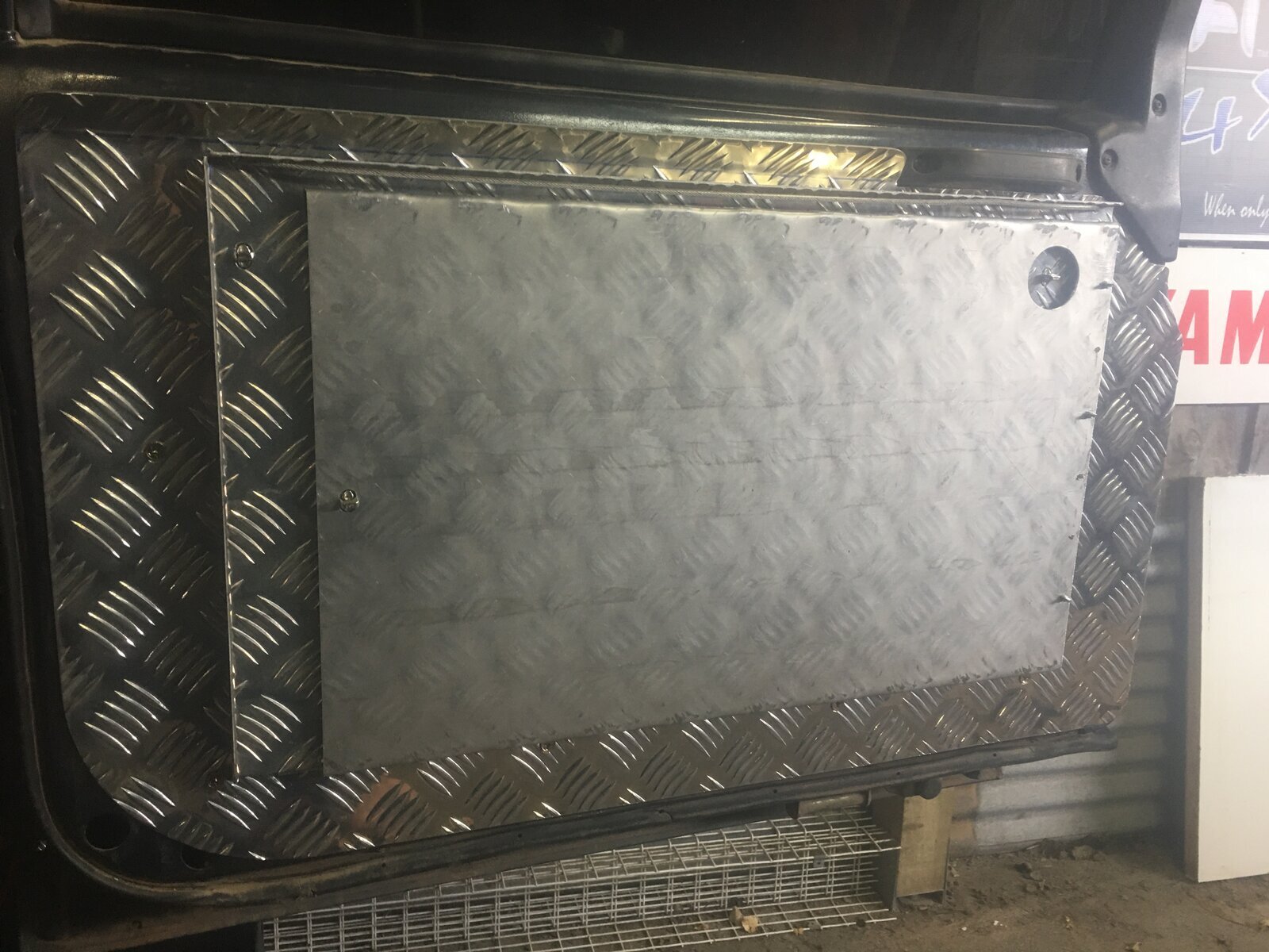

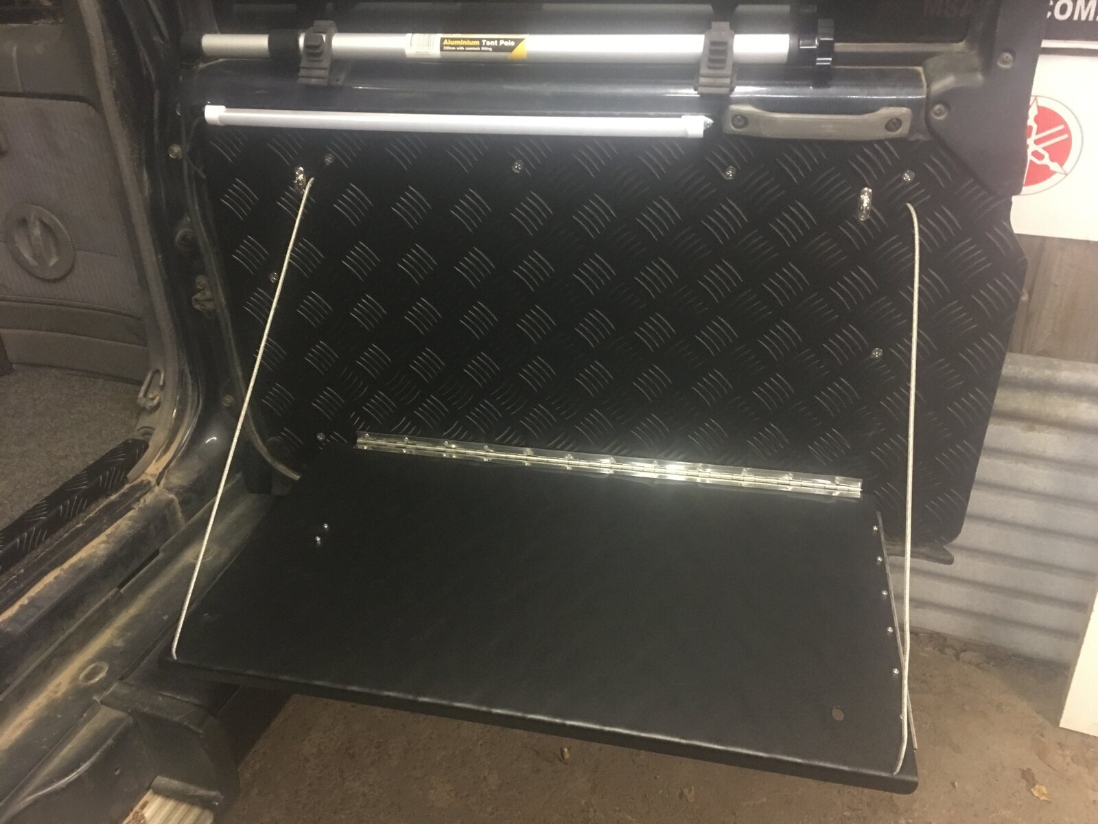

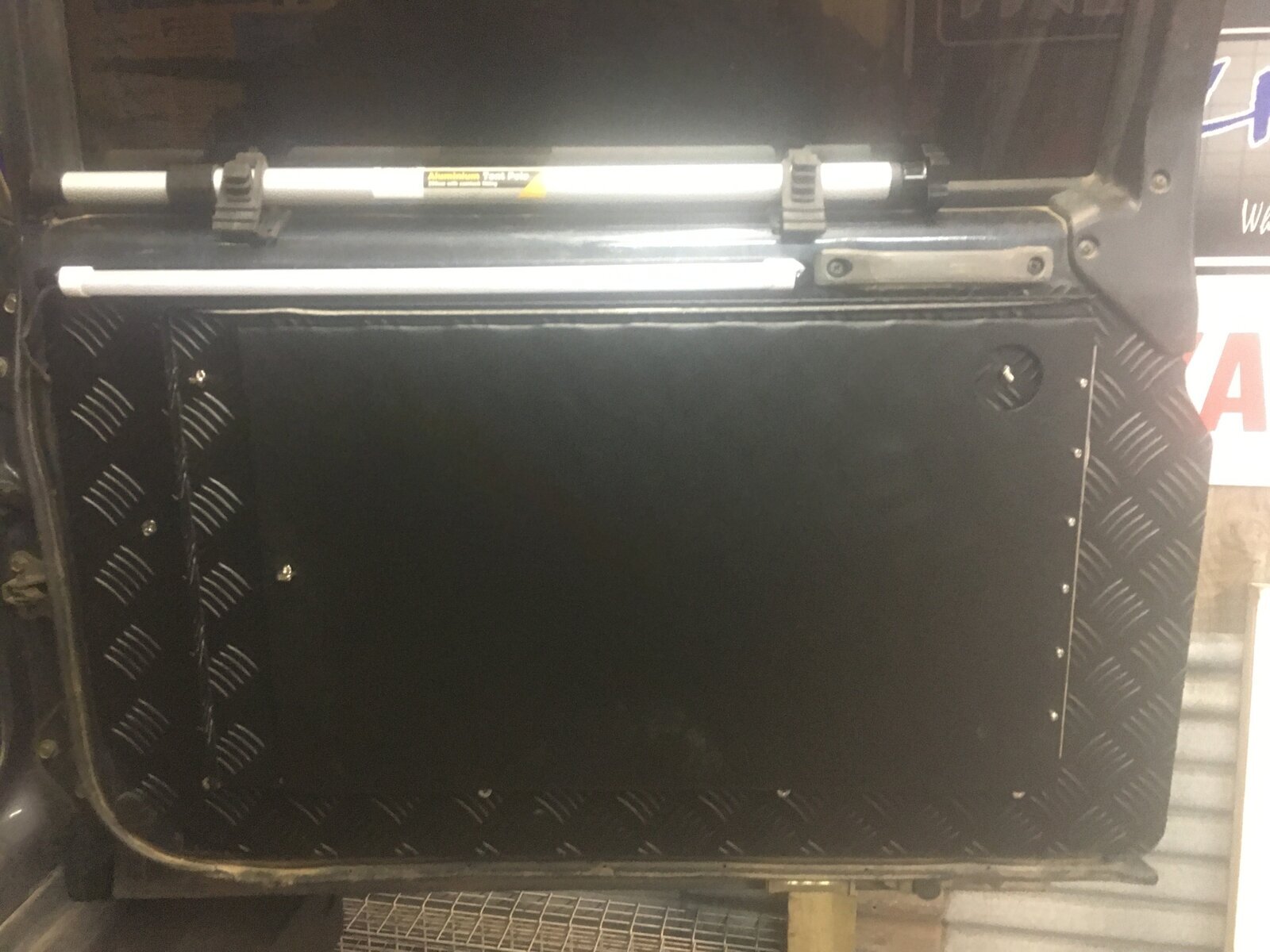

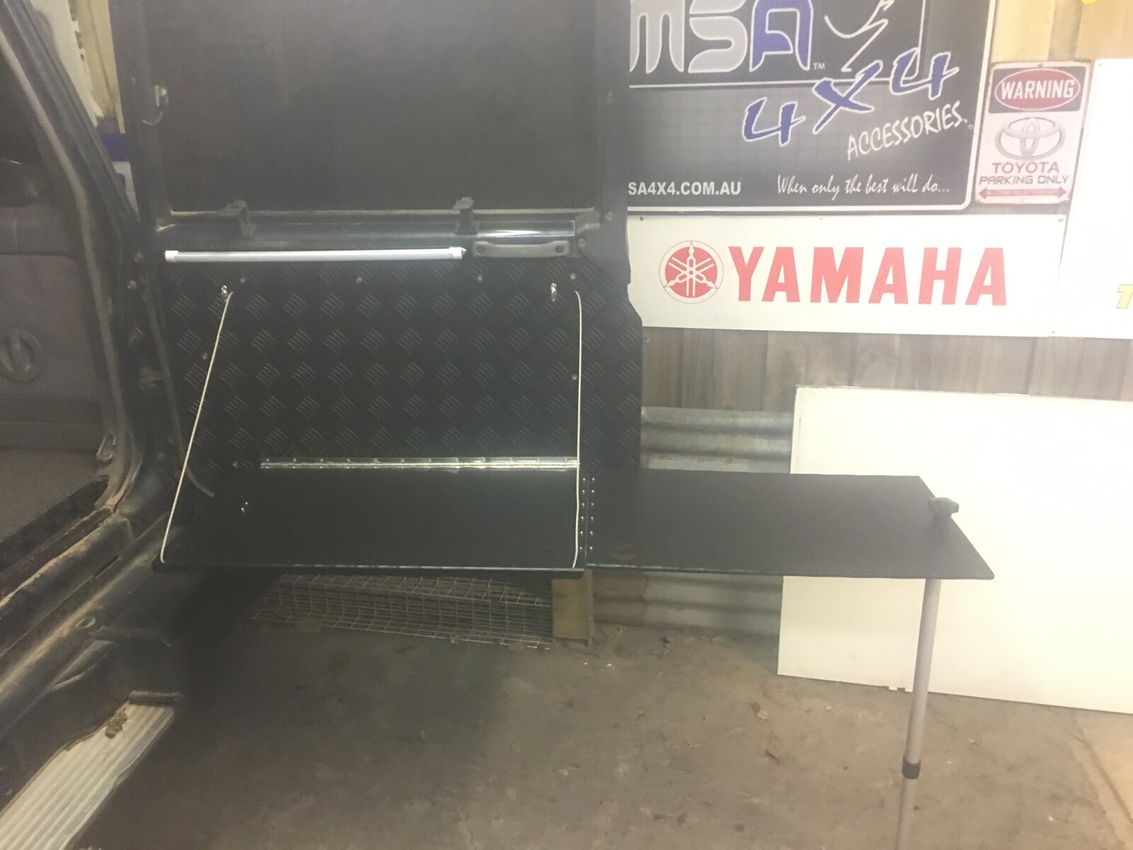

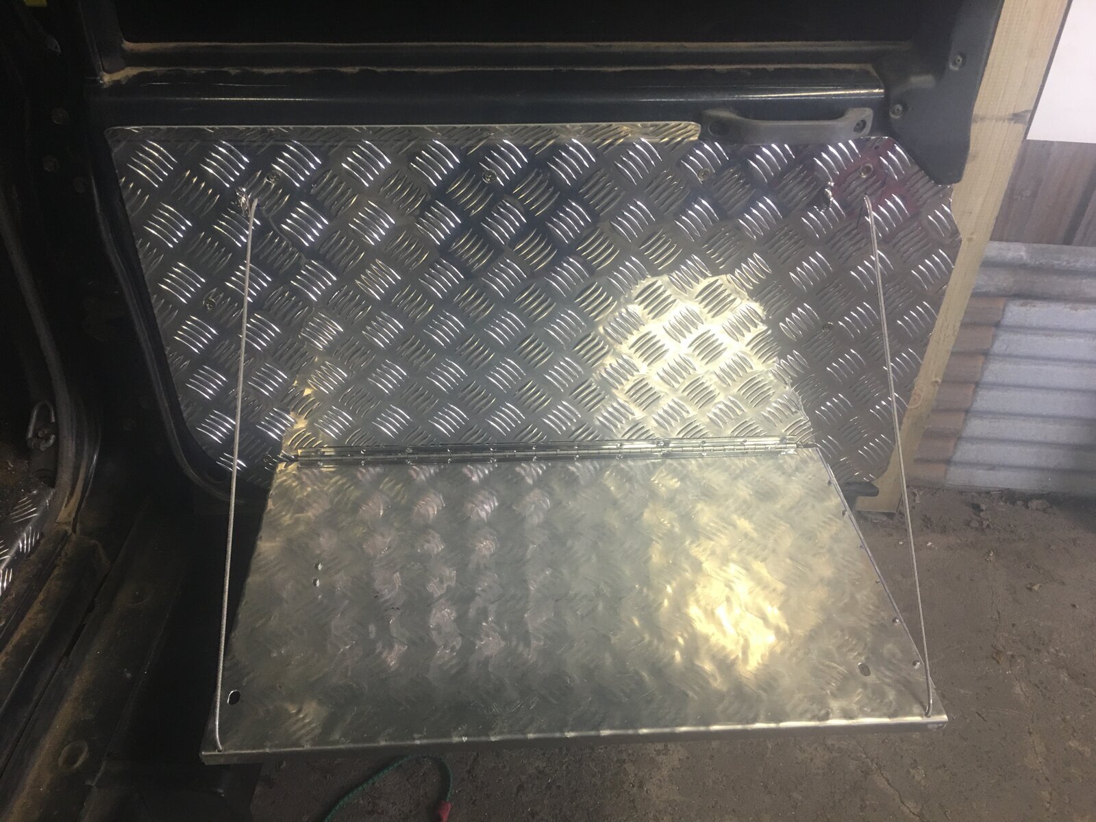

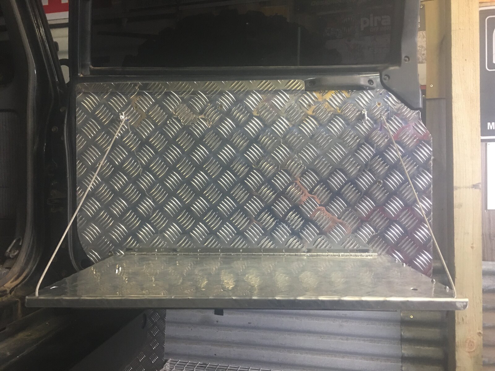

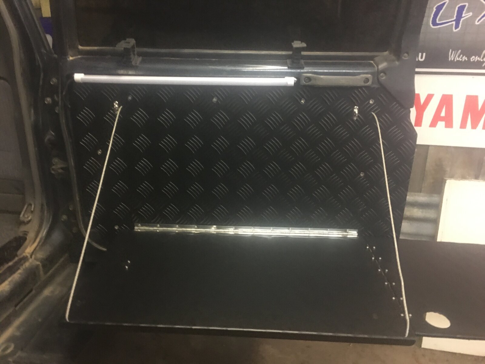

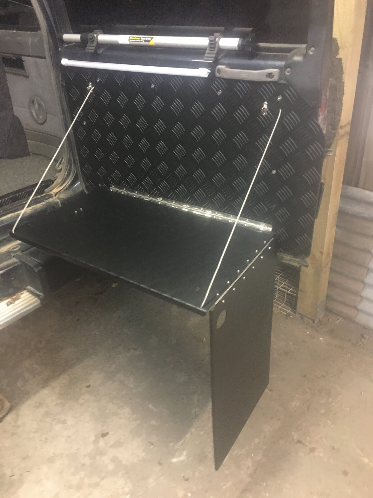

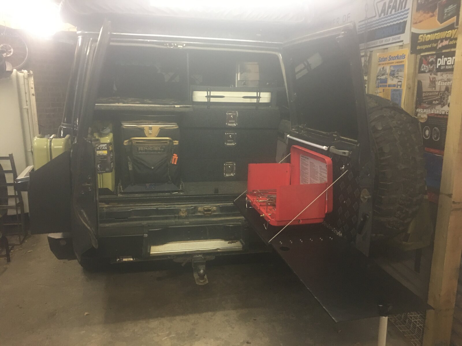

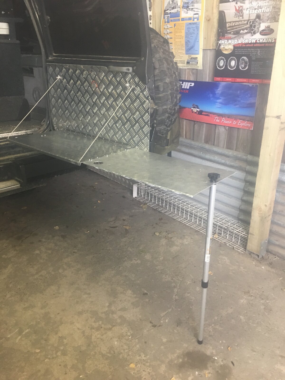

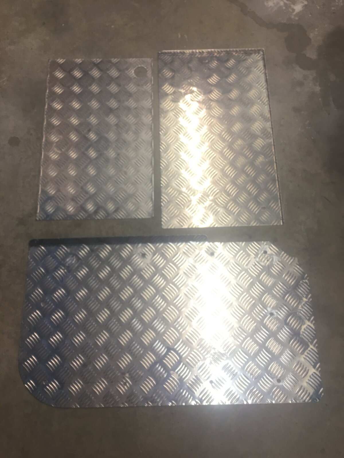

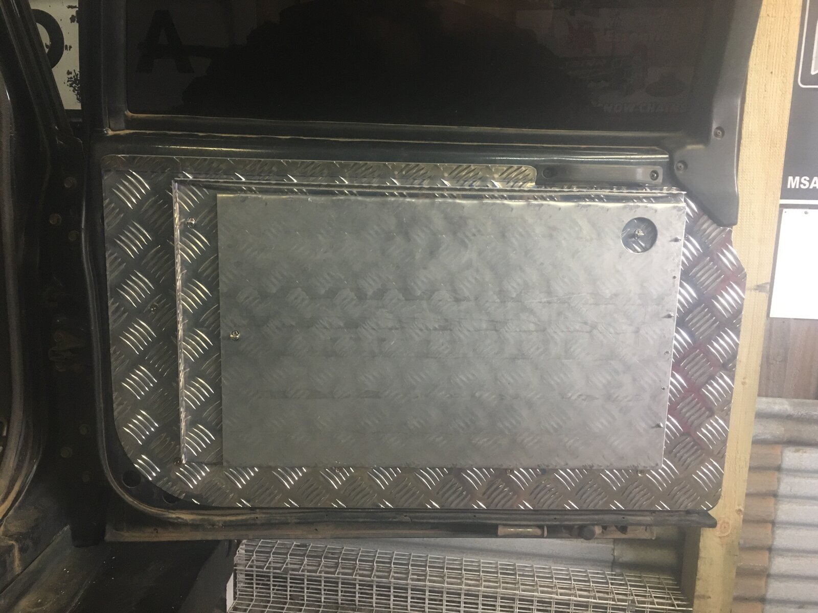

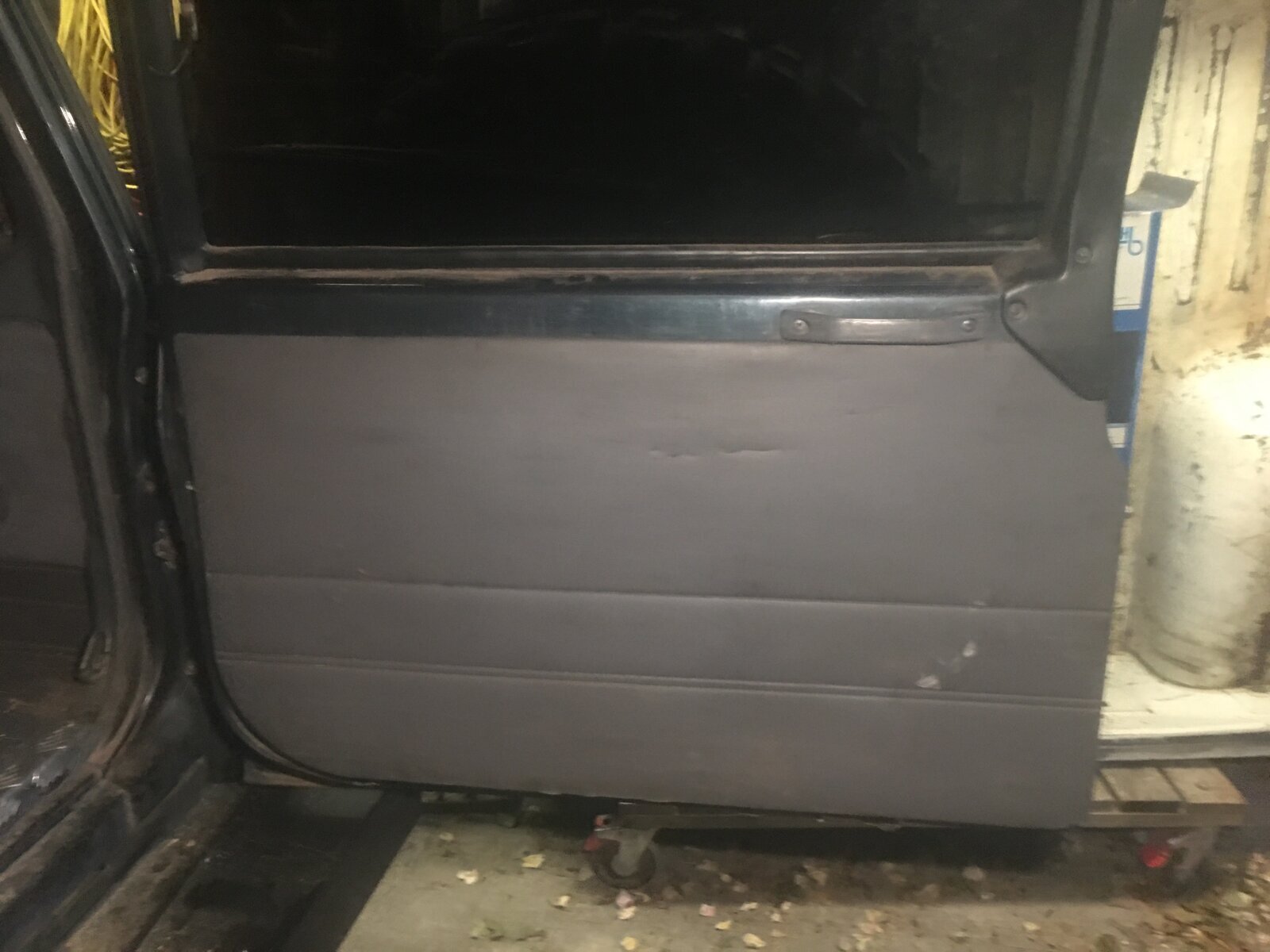

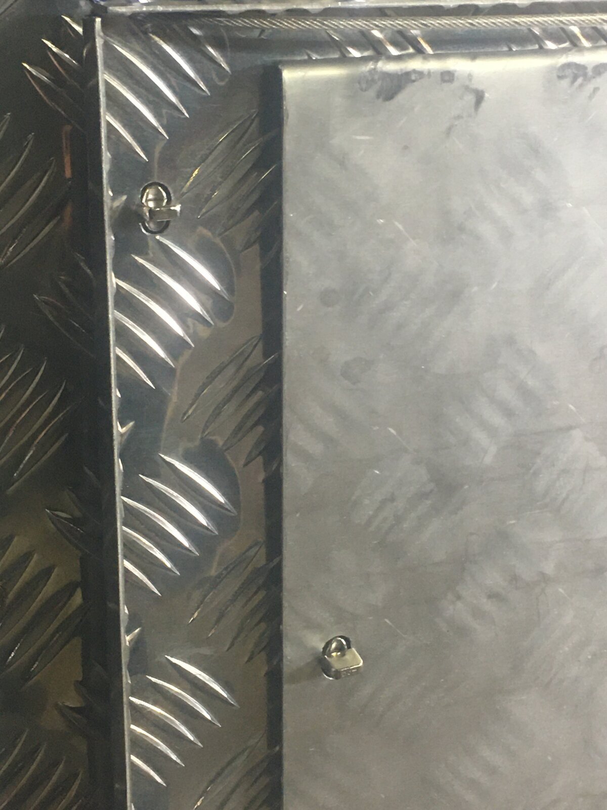

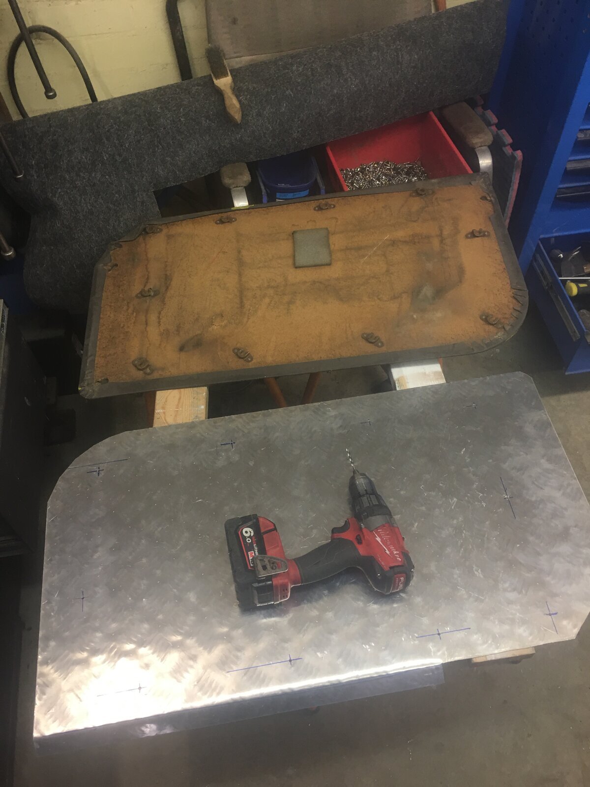

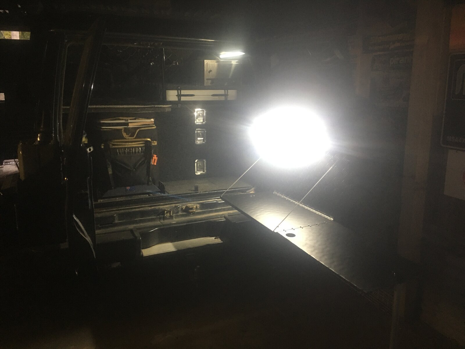

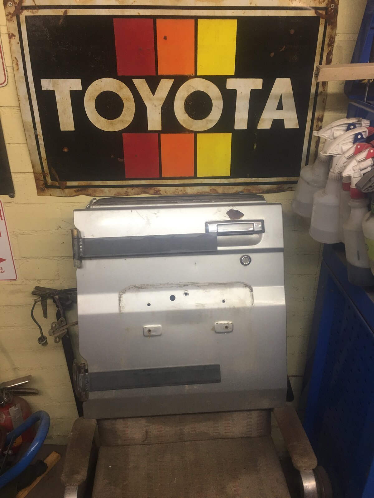

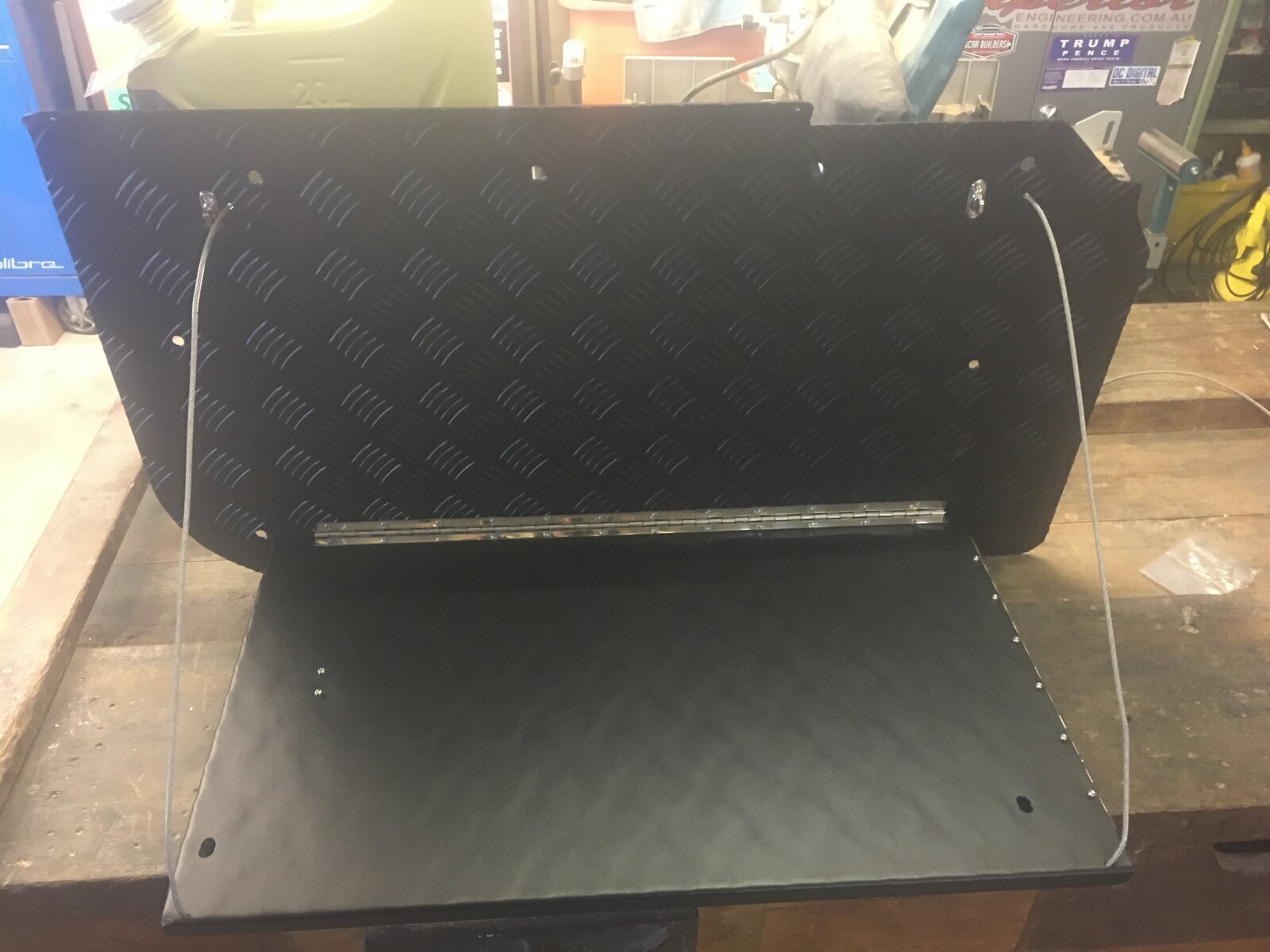

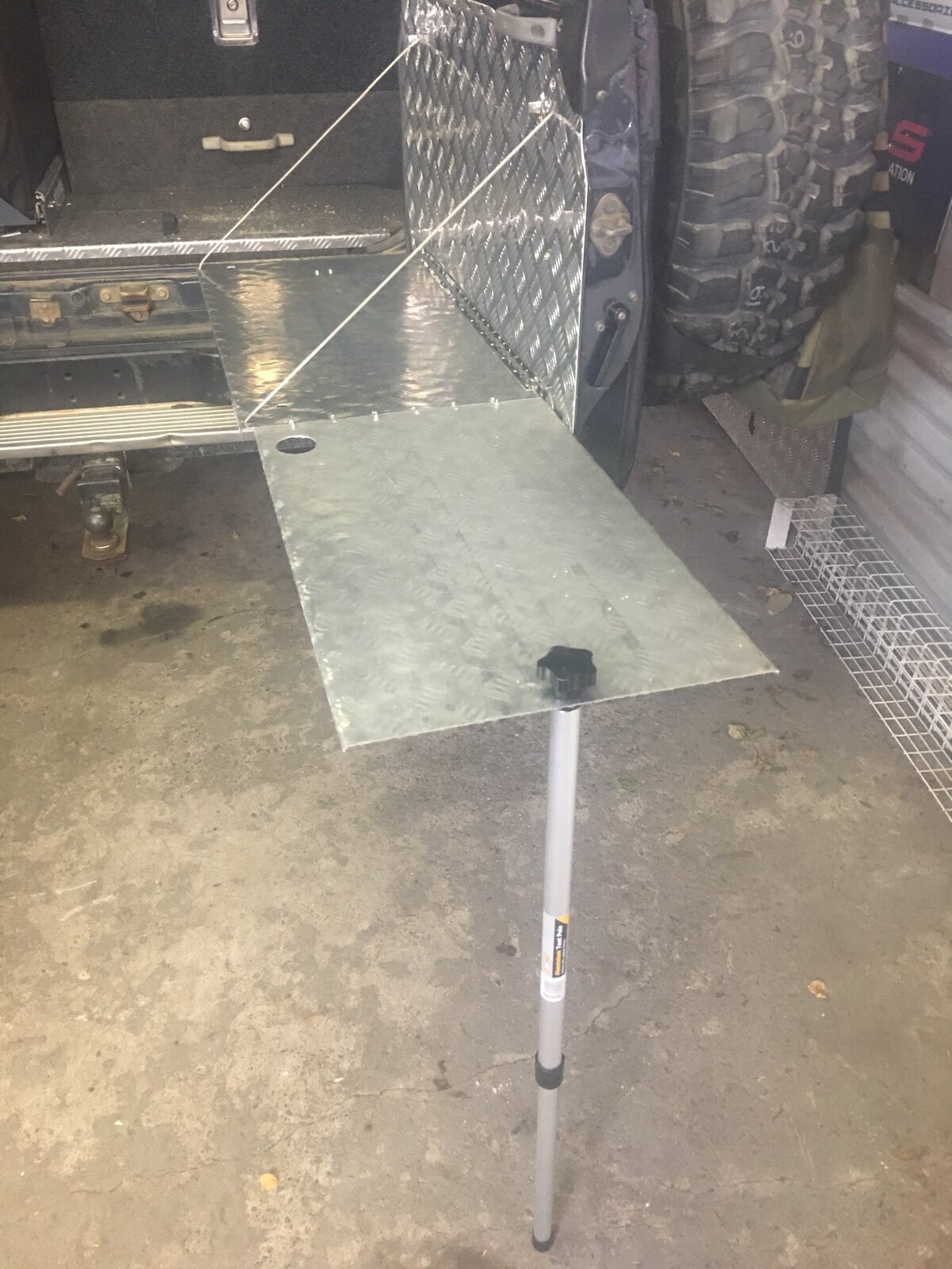

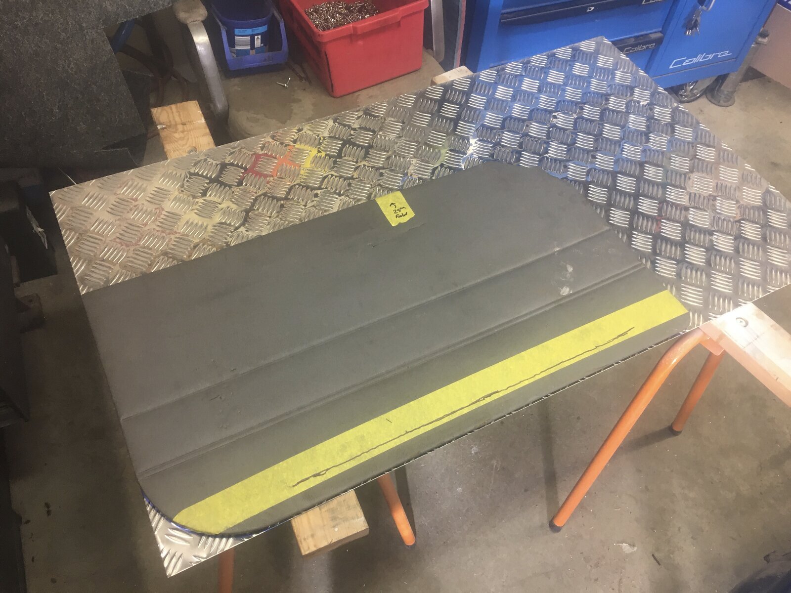

The original 30 year old door card on the back of The 78 was looking a bit tatty and I decided a table would be handy for food preparation when camping.

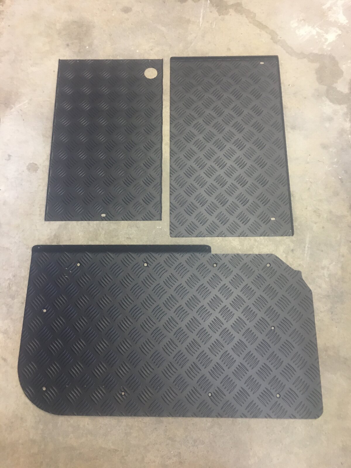

I removed the door card and drew around it onto some aluminium checker plate sheet I had spare.
Cut and drilled it.
Cut and folded the 2 table tops.
Bolted it all together and fitted it to the car.

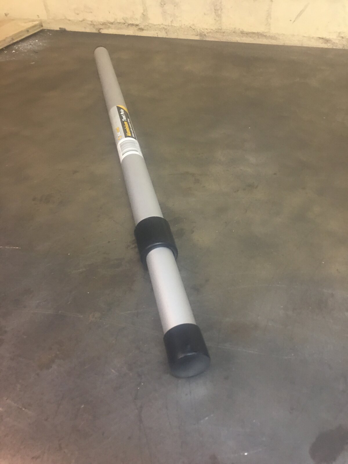

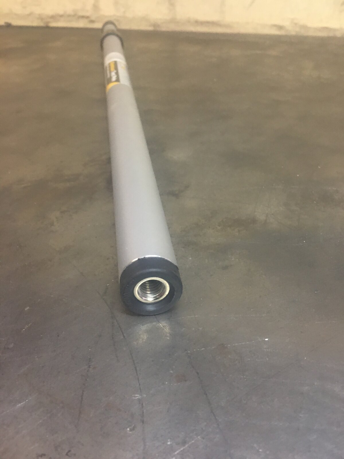

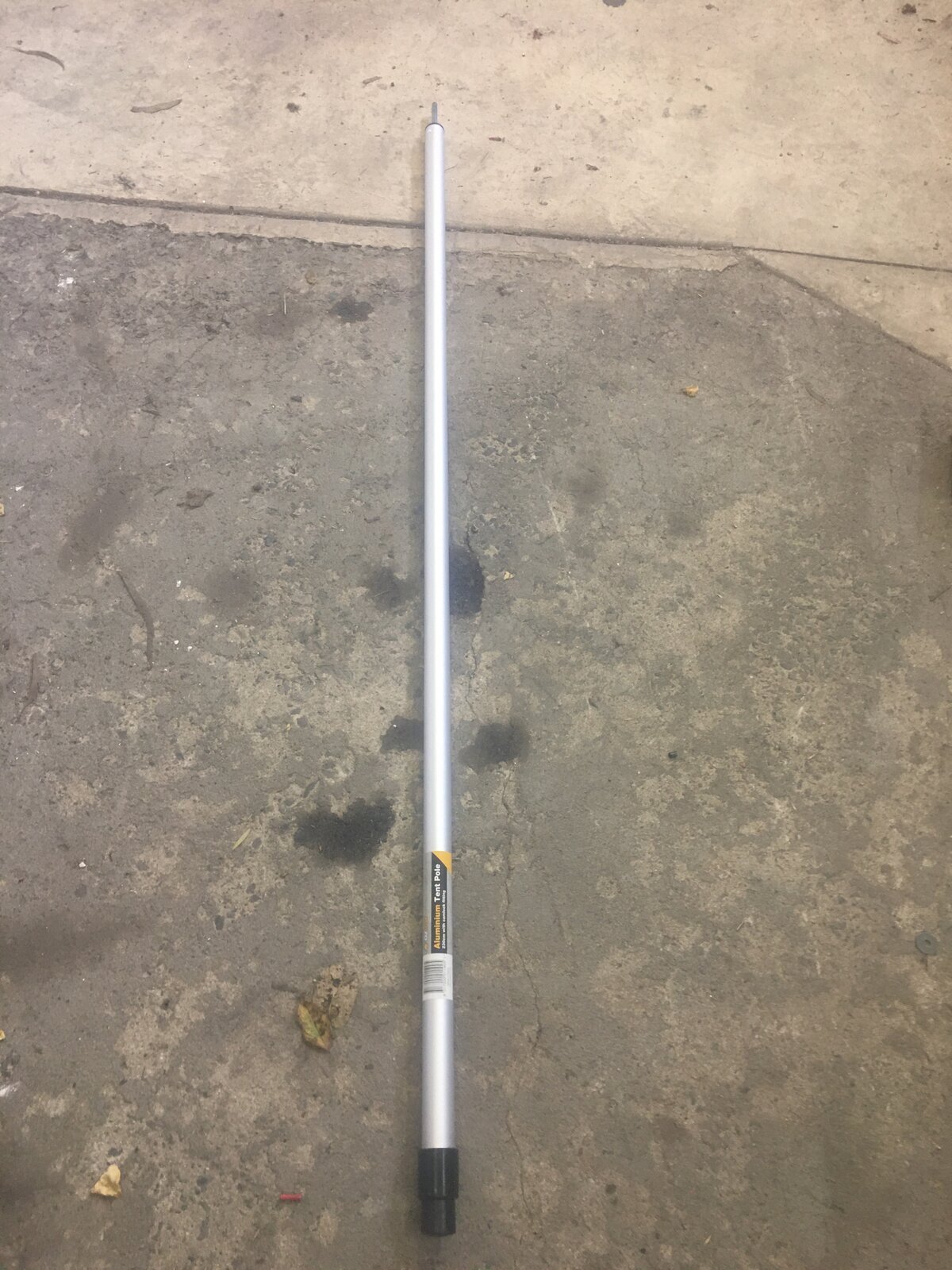

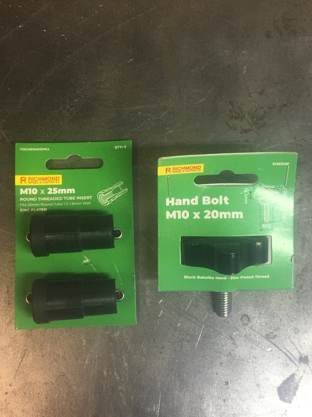

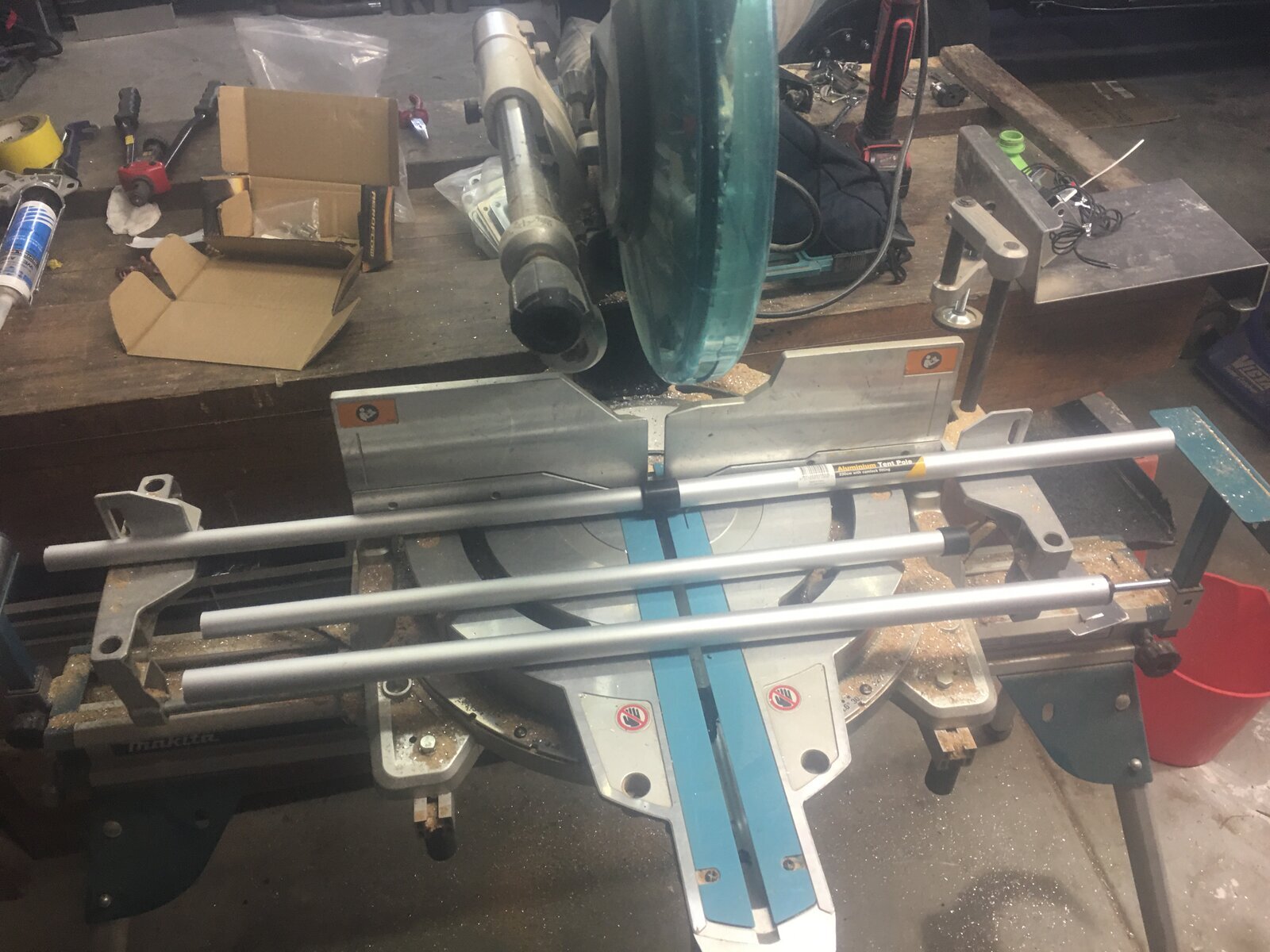

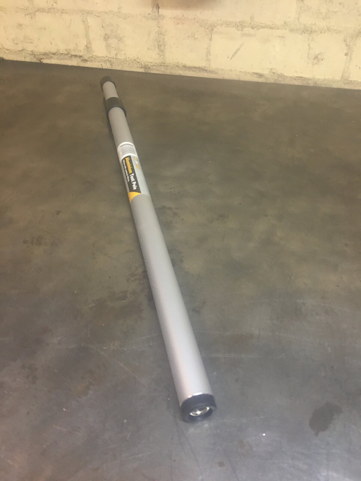

I picked up a twist lock aluminium pole.
And some of these from Bunnings:
(I wish Europe got Bunnings, it’s such an amazing store!)
Cut it to length.
Fitted the threaded insert.
Tested the leg.
Stripped it down ready for powder coating.
Got them powder coated textured black.

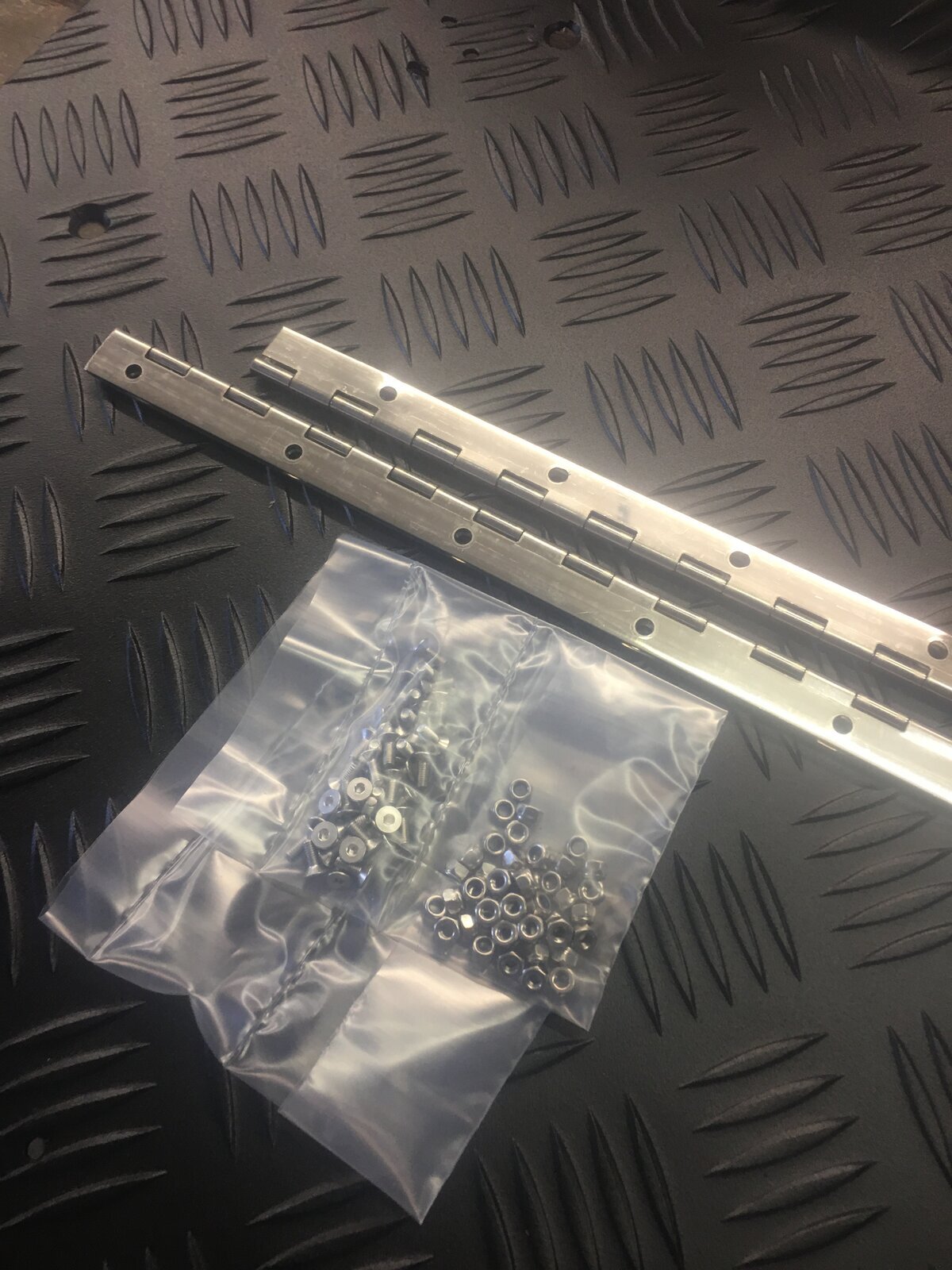

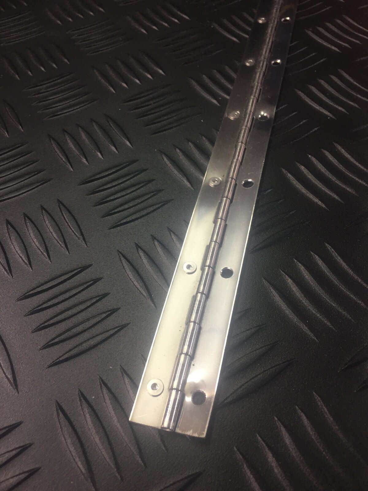

Stainless steel hinge and stainless steel M3 countersunk bolts and nylock nuts.

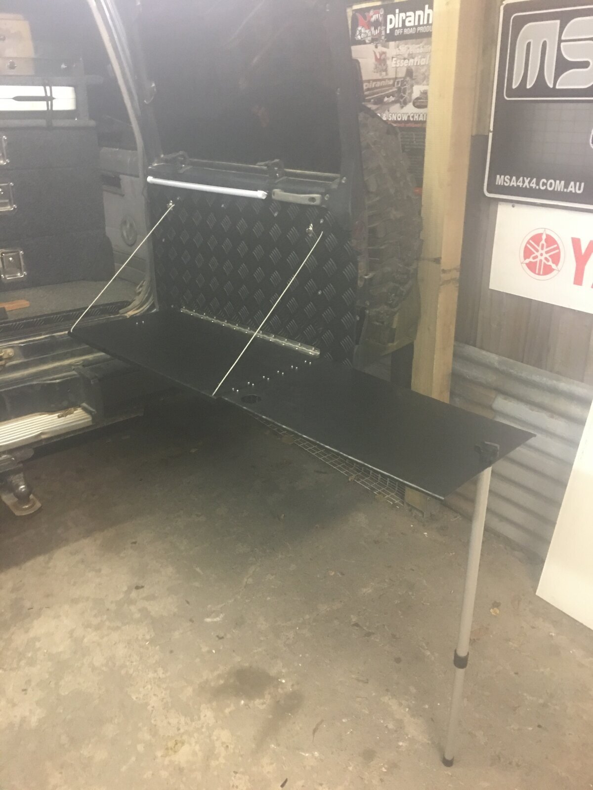

Assembled it.
Plastic coated stainless steel braided wire supports the main table.

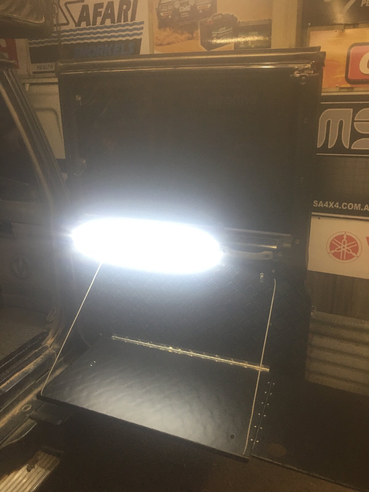

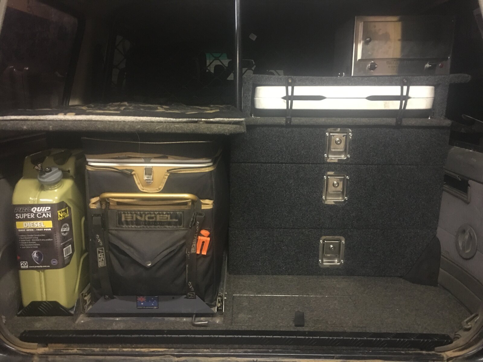

Fitted it to the vehicle along with the 12v LED light and the table leg aluminium pole mounted to the door above it.
It works really well and means I have a nice triangle between the Engel fridge, 12v oven and the new table where the gas stove will go (on the rare occasions I’m not cooking on the camp fire).
