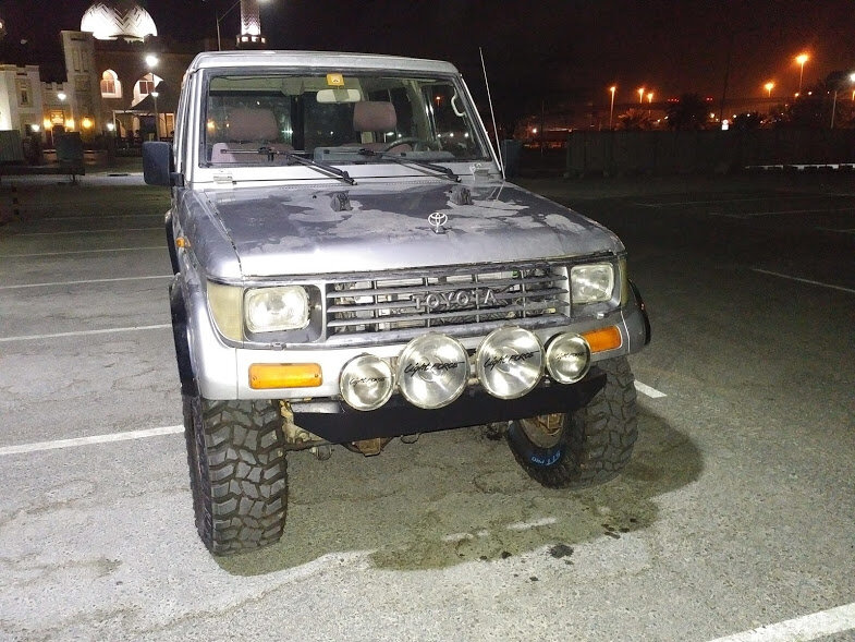

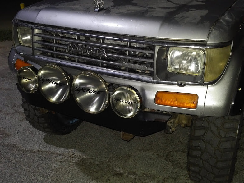

As for the shortie, I think it would look better with tapers coming from the ends as they are now, sloping up to the seam between the body and the arches, but that might be complicated to fab and TBH it does look fine as-is.
I think this is what you meant. Anyway I cut two more tapers in the bar when I had it off to drill some light holes.

New holes through frame, new stainless bolts and cleaned up the old faithful Lightforce lights. Been with me on a few vehicles now, think this is the 5th 4x4 they have graced. Just plain old bulbs, no HID or LED here.
Now all the installation is done, will sort some wiring and alignment tomorrow.
