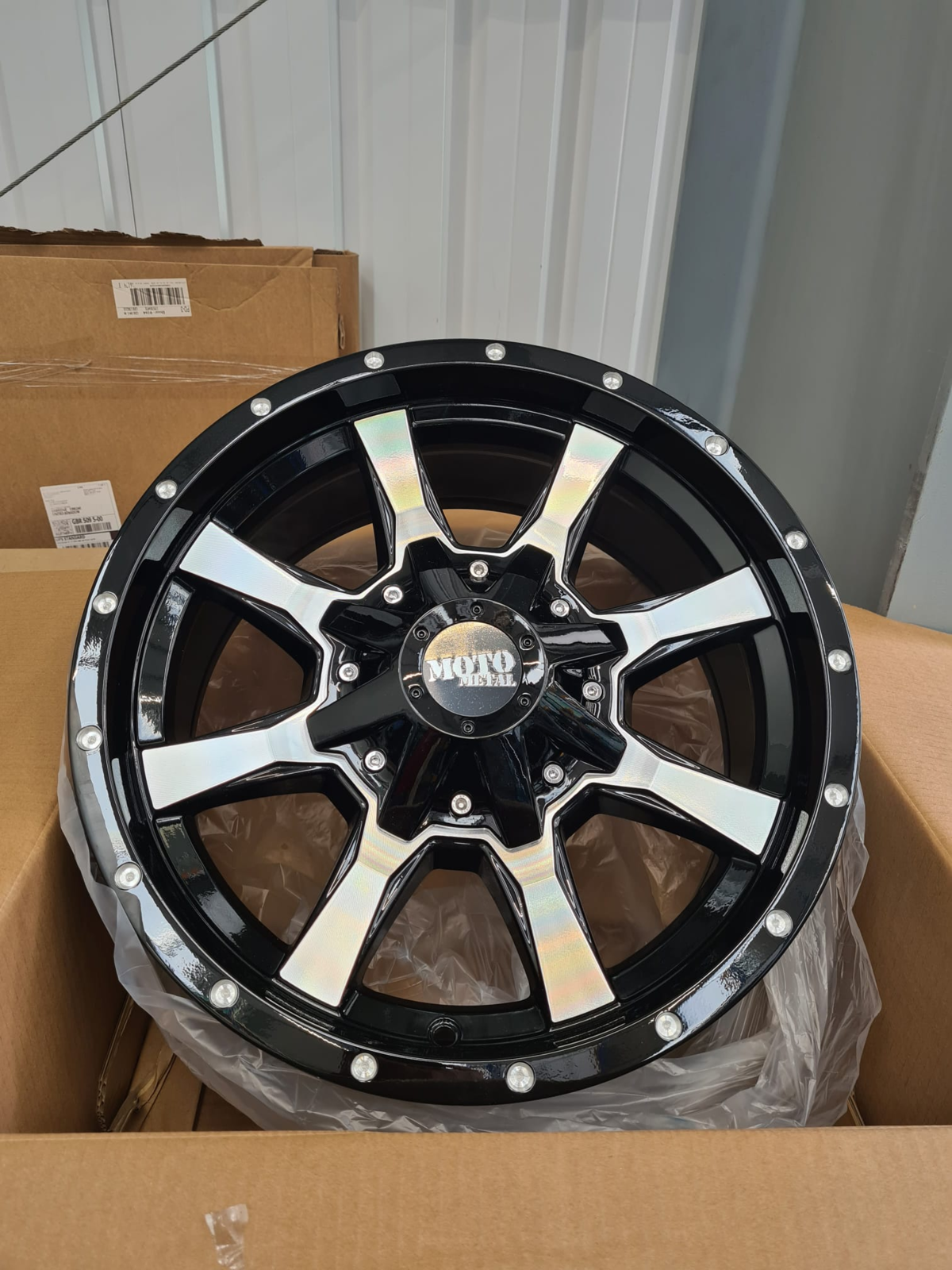

Hi there,
I bought the one below (Moto Metal). 17x8 zero offset 5 x 150 PCD. It wasn’t easy to find zero offset though.
The shipping won't be cheap though, and would have to be extremely well crated from USA.
