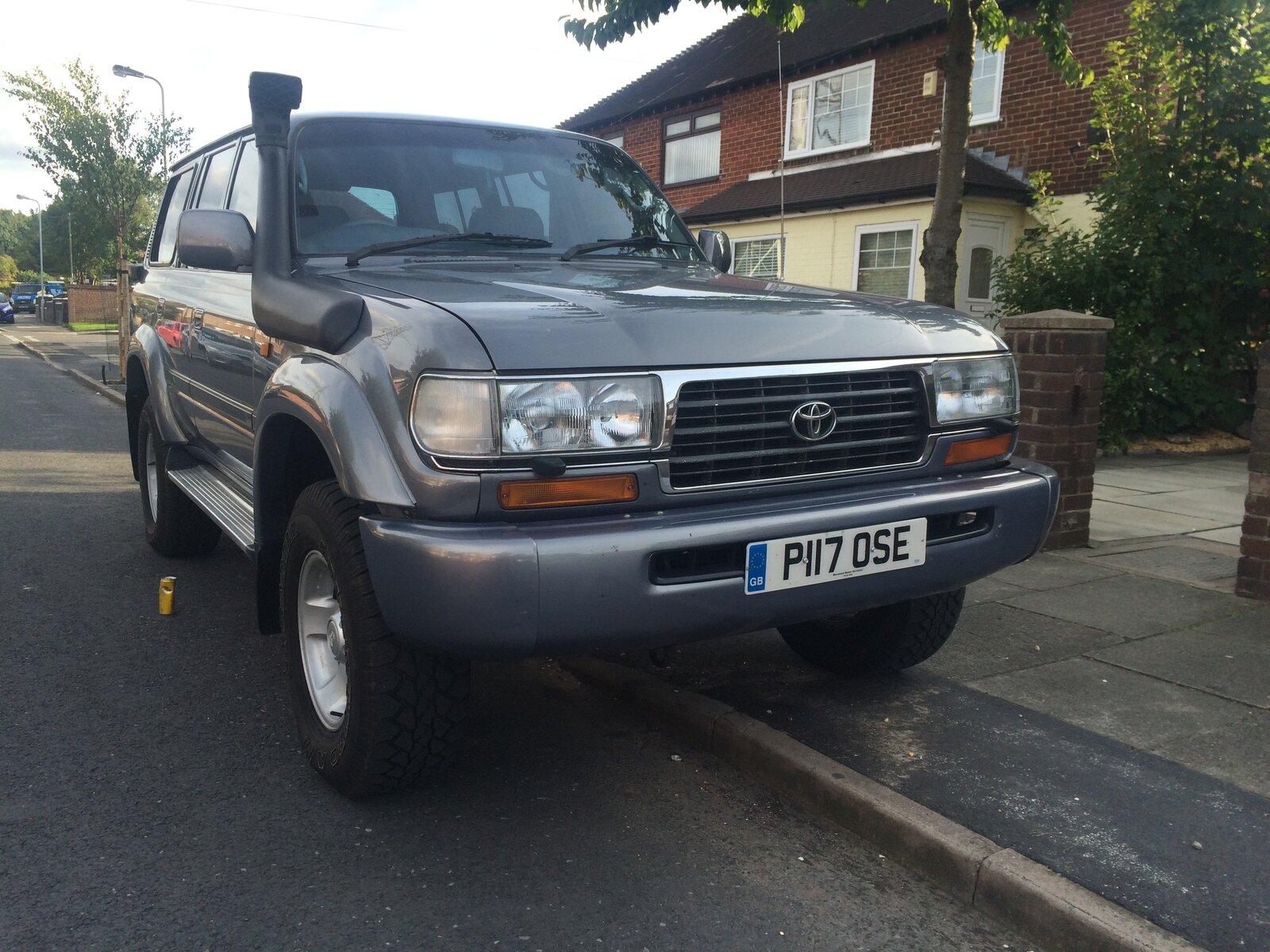

Looks handsome. Now the fun begins. We're here to guide you. How'd it drive?
