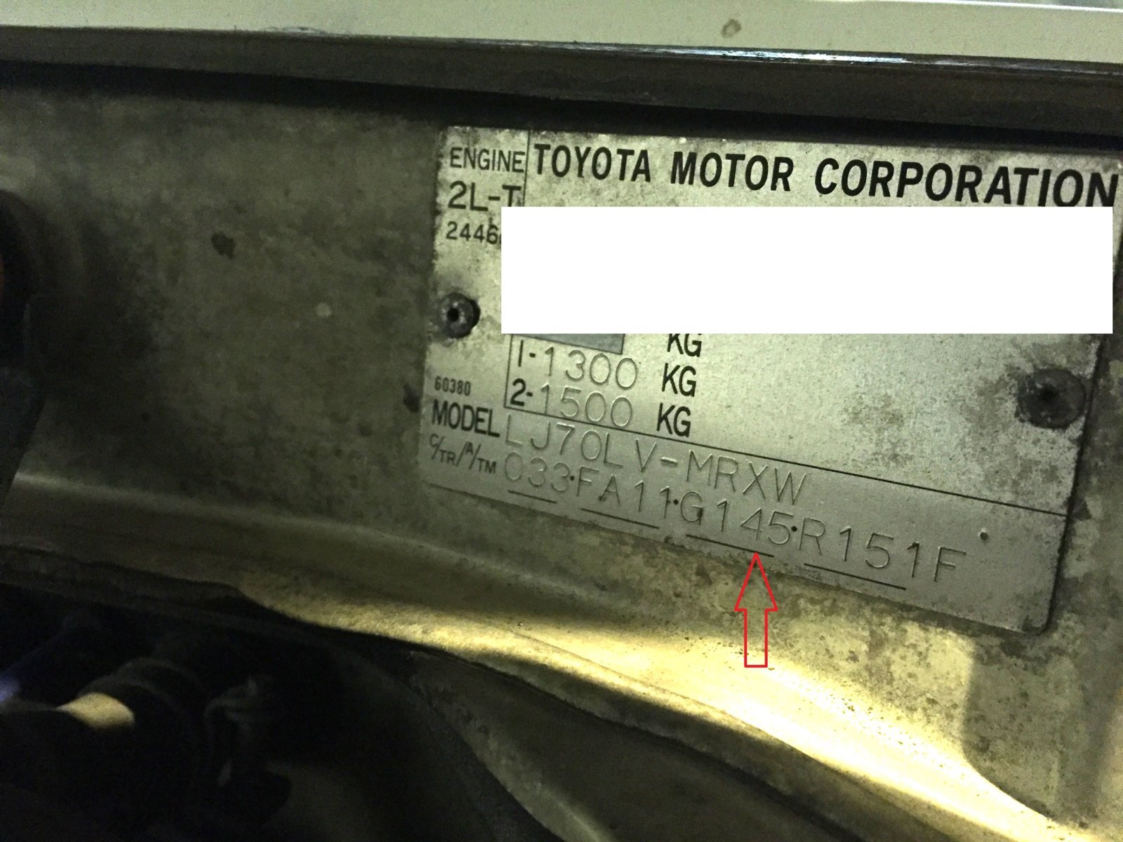

If you have LSD diff, you will see LSD stick in the rear of diff. cover and you could see it in the plate with VIN number in the engine bay.
See picture below:
G145 will be
G = 8" diameter crown wheel
14 = 4.875:1 ratio
5 = 4 pin LSD
So if you have 5 in this plate, you'll have rear LSD diff.
If you have LSD is most important use correct OIL, if not this will not work
Use only LSD EPX90 oil (SAE 90 for l.s.d.)
See picture below:
G145 will be
14 = 4.875:1 ratio
5 = 4 pin LSD
Hi there!
Thank you for the excellent explaination! It seems I have G144, so not with LSD?
Yes, G144 = 4.875 gear ratio - open diff - standard
