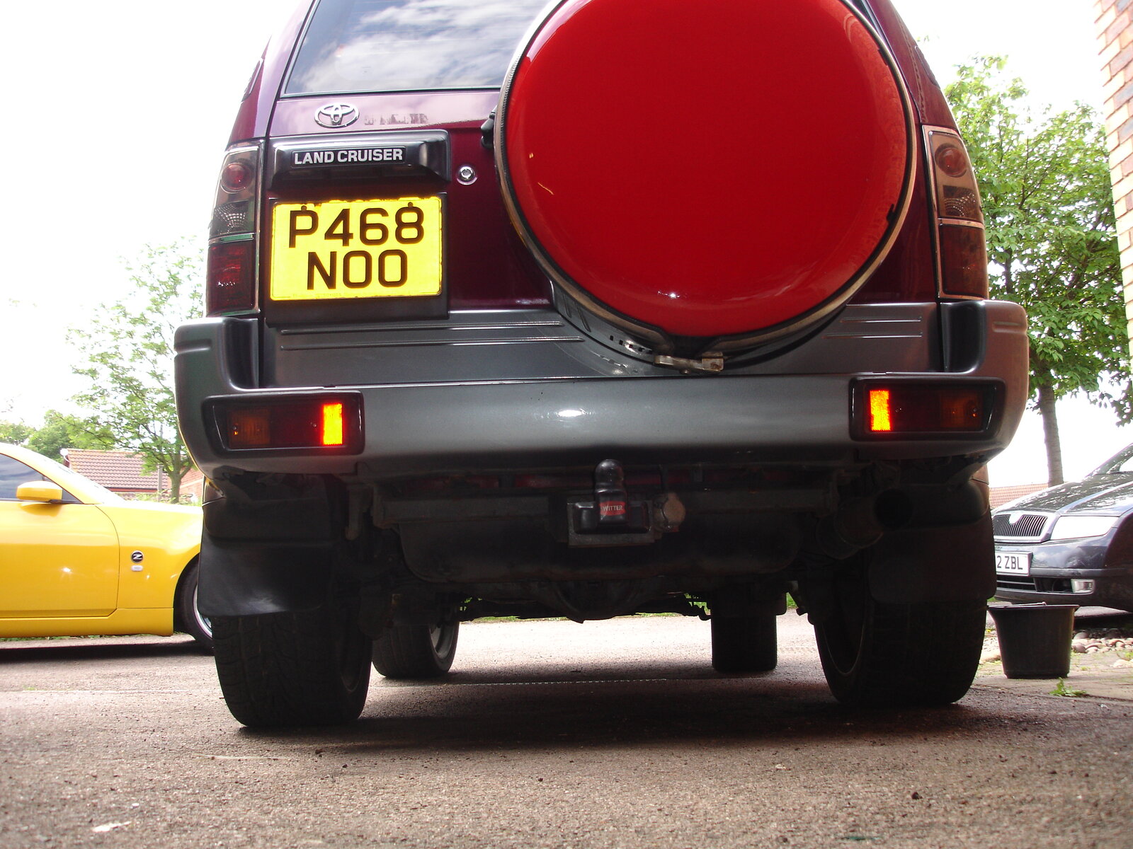

I'm a bit puzzled why they would be different for SWB and LWB models. I would assume the chassis ends would be the same on both types. How does the bottom of your SWB look Shayne, is it similar to the ones above? Any noticeable different. Here's a pic of my truck at the rear end with my tow bar. It's quite simple in how it's put together.

Thanks for the pic Beau looks like it will fit to me :think: Bob may have explained why the swb won't fit a lwb and sellers may have assumed it works or rather doesn't work both ways .
