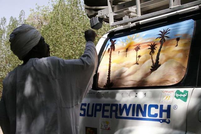

Well mine looks like this:
[attachment=0:3r0kt2z8]E002.jpg[/attachment:3r0kt2z8]
so anything other than a Sudanese desert scene looks novel to me :lol:
I am going to remove the panel [painting gone already] and the glass behind it [weight] and just looking at alternatives. I was hoping Julian was going to say this is a Milspec polyarbonate 13 gram kevlar-laced panel which makes the rear cargo area like Fort Knox......... :whistle:
[attachment=0:34o3eplz]E002.jpg[/attachment:34o3eplz]
very sweet looking mural, appropriate for the vehicle I think.
