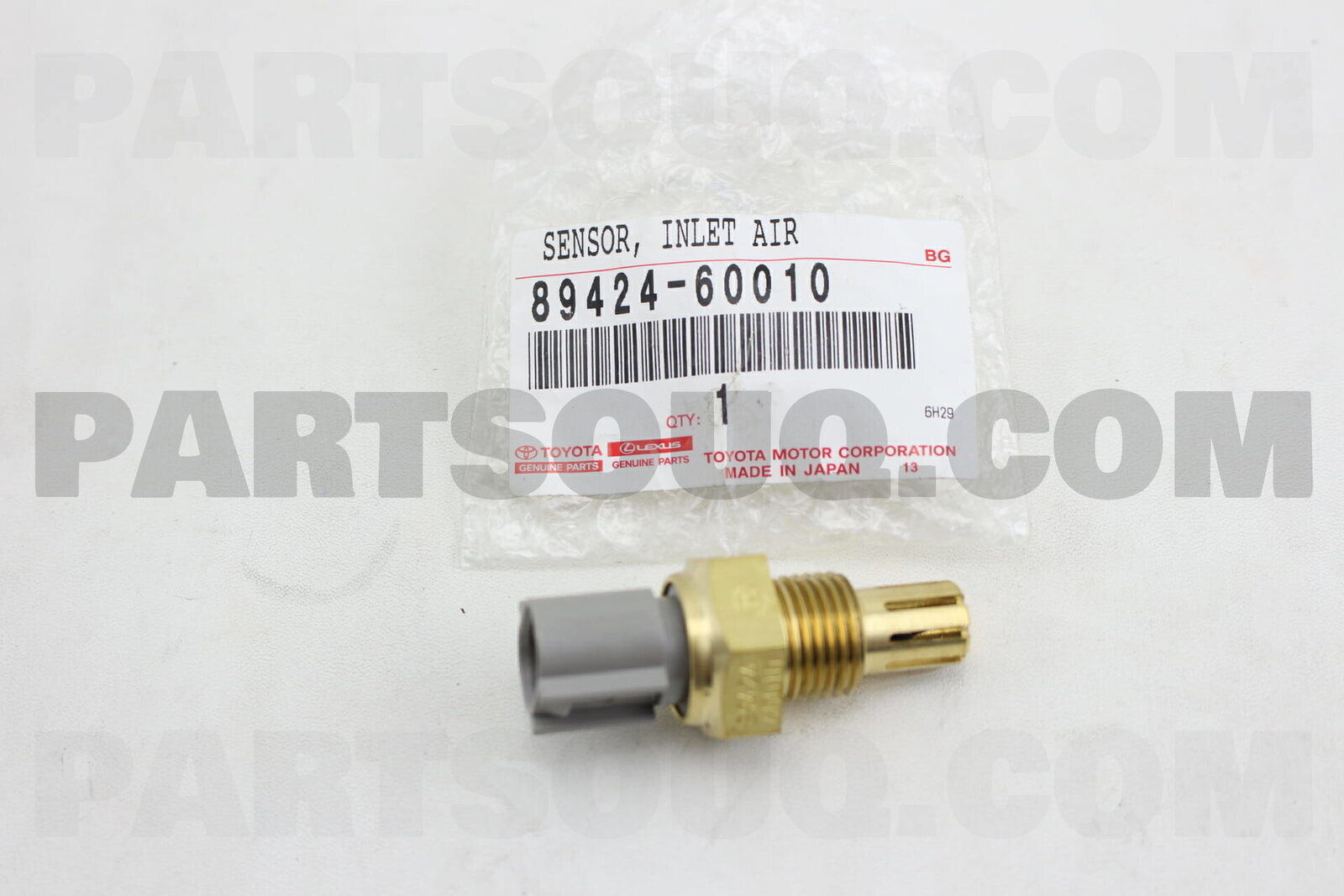

Air temperature sensor is part number 89424-60010 on partsouq. Diagram is also on there showing its location. Personally I'd check that first because thats what the truck is telling us!

As per some of the posts here (thanks for the part number @karl2000 ), the Air Temp Sensor is indeed listed in the workshop manual as one of the suspects for the reported fault code. However, they are £140 quid. Hence the wait.
A couple of days ago I decided I had no choice, bit the bullet and ordered one. I then felt the panic and decided I had nothing to lose by seeing if I could work out if it's actually broken. Here was my thinking...
- I've got a new one on order - what can go wrong?!

- Remove engine cover. Unclip wire connector.
- Use voltmeter to check angry pixies are making it to the clip - assume that the measured "just under 5 volts" is ok
- Remove Air Temp Sensor. Look at it. Smell it. Poke it. Zoom in on it with phone zoom magic. Ponder.
- Note how much oil/diesel residue it has on it.
- Consider that it must be some kind of resistor with air temperature changing the flow of magic pixies through it.
- Remember the magic pixies in electricals like Isopropyl alcohol.
- Pour the pixes an Isopropyl drink. Dunk the sensor in said drink. Wiggle and woggle it.
- Reinstall sensor.

Bought and fitted - but as expected, not the issue.
Also checked the magic pixie feed to the connector terminals again to be sure. Just under 5 volts.
