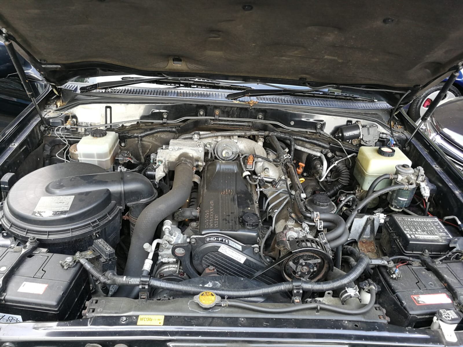

Looks tidy but they can be very deceiving till you get underneath... Almost certain to be a 100 not a 105 though IMO, I wouldn’t know the difference without a view of the front end underneath...

This would have independent suspension on the front or solid axles, V5 state 2x axles so thought this was a 105 though eng would have been in a 100? Getting confused.

If it’s in good order underneath (manageable rust) the price is OK IMO, but there’s a lot of very rusted shiny ones on forecourts these days, beware. I’m still not convinced it’s a 105 but who knows till you have a look.

That's a 100 series or Amazon as it was badged over here. The 105 has a much more basic configuration and is very rare in the UK/EU as it was only sold in Australia, Middle East and other key markets.

It has airbags and ahc, so not a 105.

AHC has been covered elsewhere in more detail but, yes, you're right - when the system goes you're well and truly stuck. You'll see a few VX trucks for sale that have had the air bags ripped out in favour of springs and shocks. Parts alone can be around £1,000 so that's an obvious bonus.
The 100 series don’t use airbags. They have deliberately weak springs assisted by gas spheres on hydraulically controlled shock absorber type cylinders. The major failing is the springs get weak over time and therefore more strain goes onto the hydraulic struts, nitrogen spheres etc. So, if it’s got old springs, bargain on replacing them with same and you’ll take the load off the rest of the system. Other problems include broken or corroded pipe work, low fluid etc. They also have a power assisted brake setup which can fail but there’s info and repairers on here.
