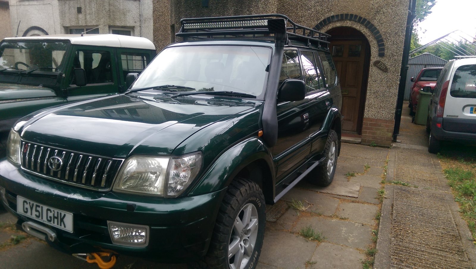

My 90 series colorado, laning spec to begin with..

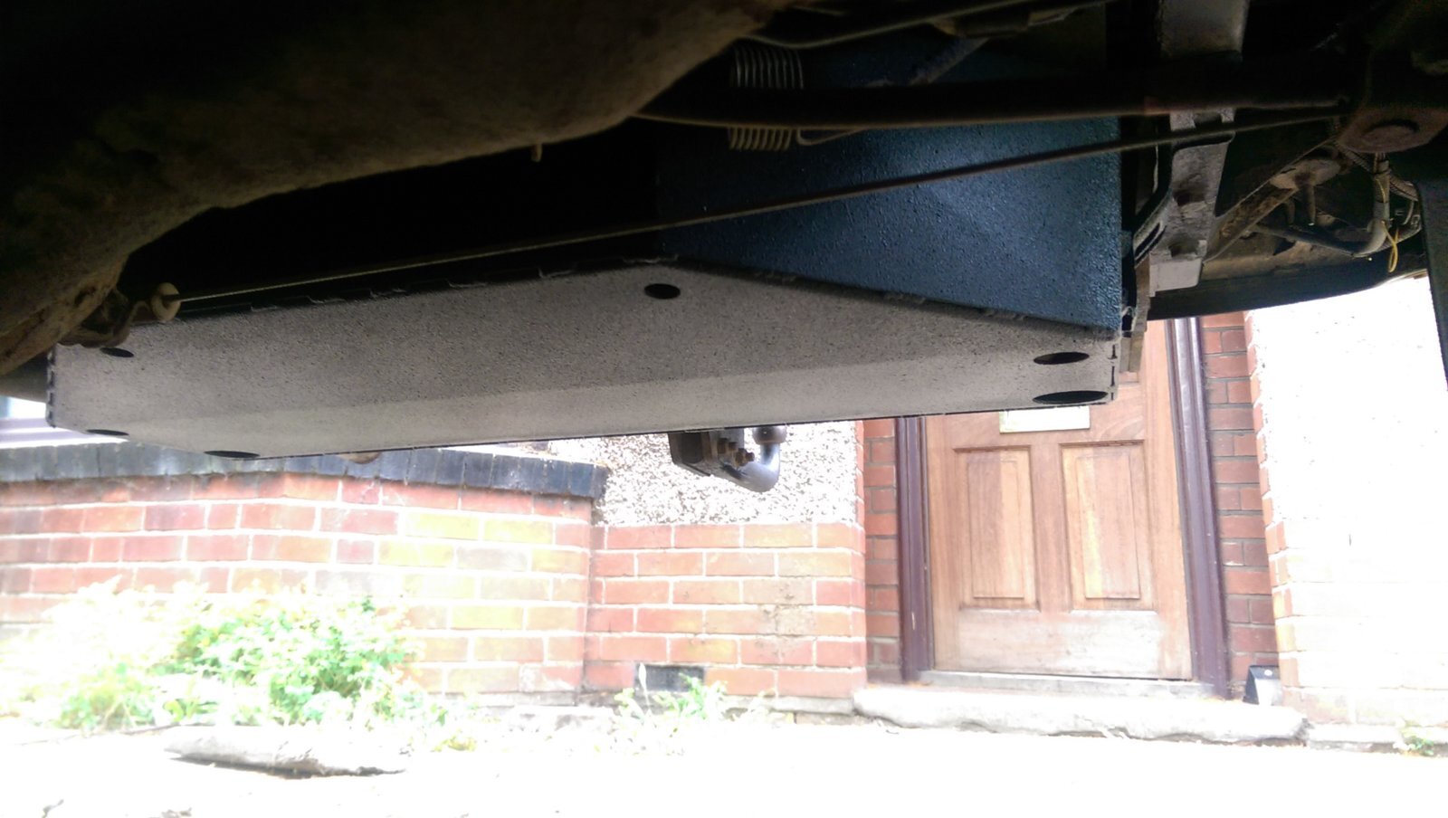

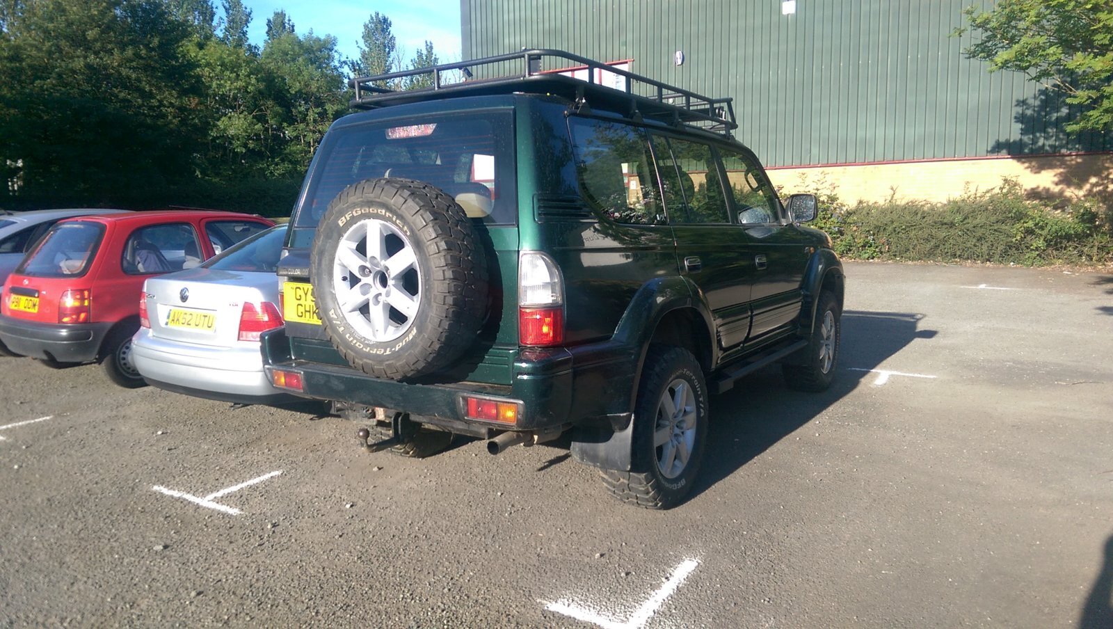

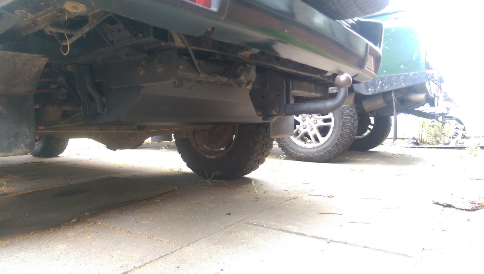

Externally the truck is about complete at last. So happy with it. Just fitted the light bar and my new (home made) fuel tank guard.
It my not be an 80 series but in my opinion a pretty tough 90 series :).

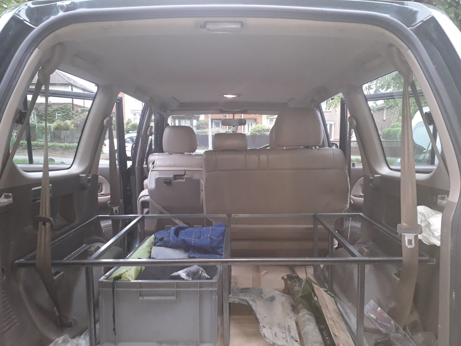

Next stage will be camping kit and storage in the back.

Thanks guys, just got a matching spare wheel so that's a new job on the list to get mounted up.
I really like the look of the almost standard front end. You have incorporated the winch nicely.

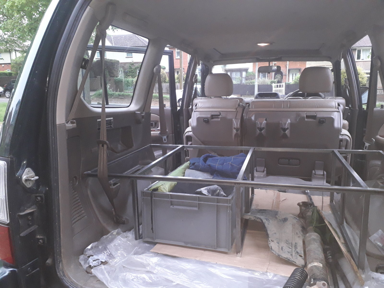

While I wait for a transfer box chain and the 2 gears I am driving 2wd. Thought I would delve into the metal rack and start creating again. This is stage one below. Having to pull out draws on ballbearing sliders. Will ply board to top and make access for the space either side of the 2 draws.
