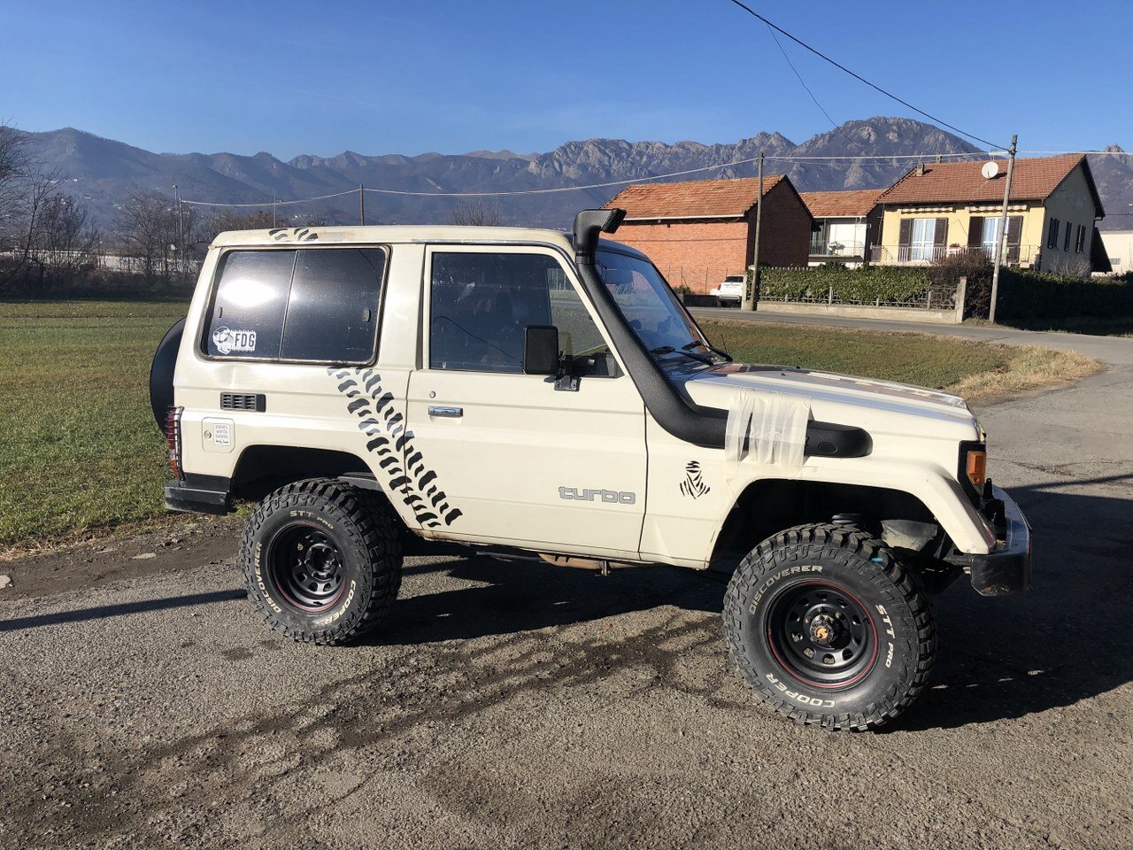

My Lj70 '86 from Italy

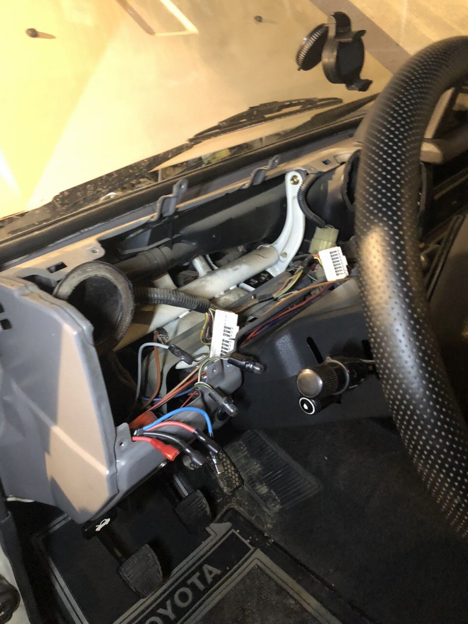

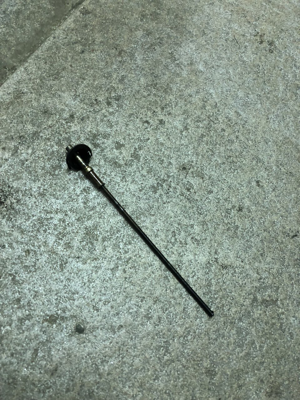

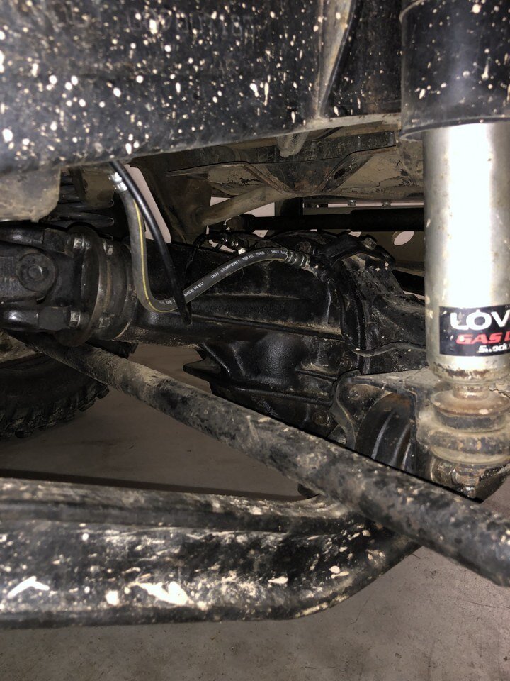

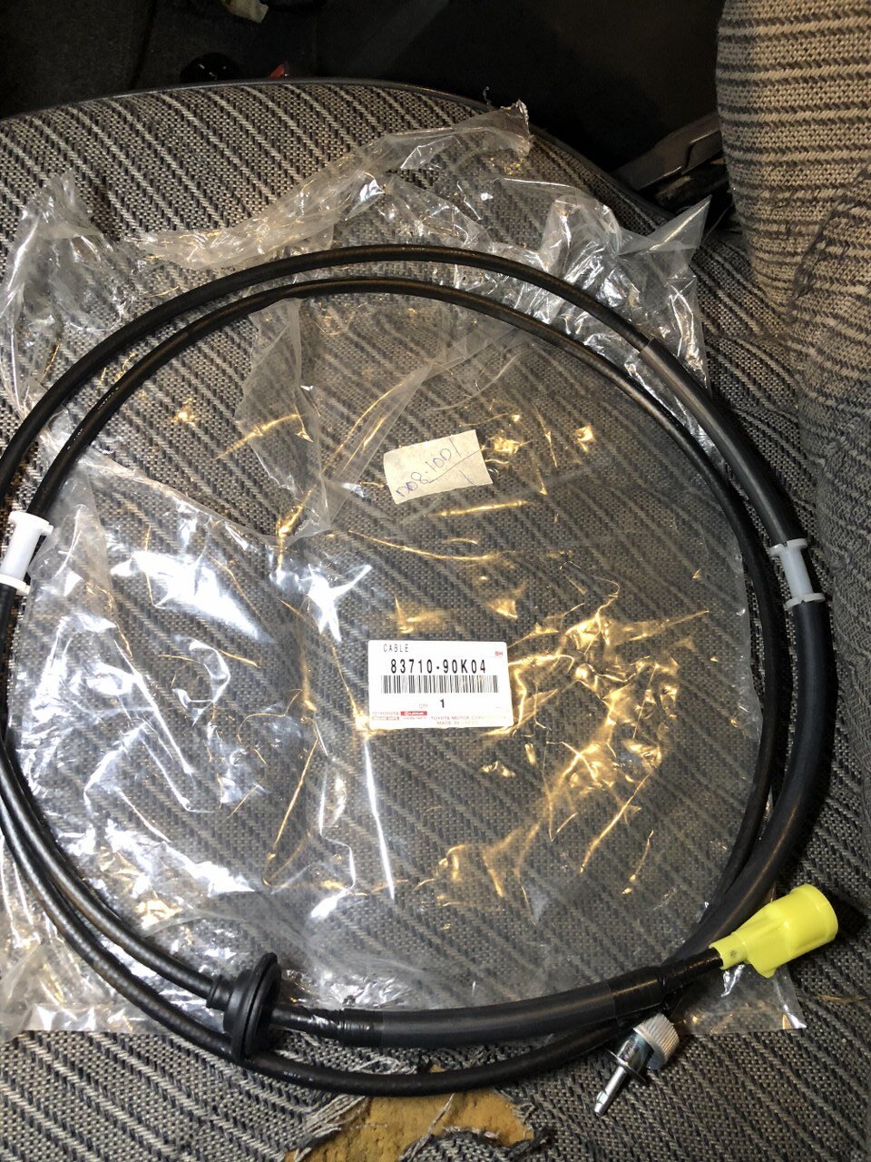

Here my speedmoter cable KO!
Called in Toyota Italy, the want 164€+VAT for original cable, buyed at 62€ + Duty import from partsouq!
Remplacement is very very EASY. 15min and new cable is on!

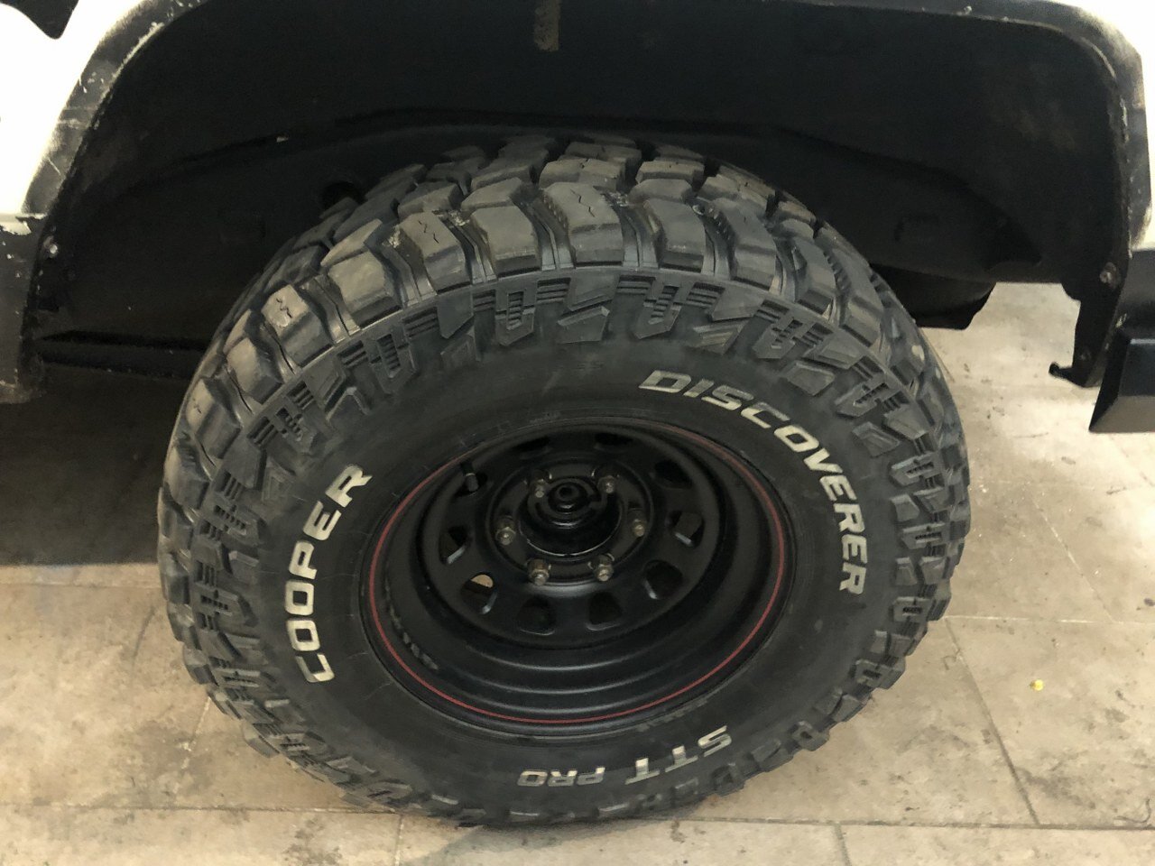

Also changed my tires, adding +3cm spacer. next month I have one of bigger meeting in Europe, I'll be ready :D

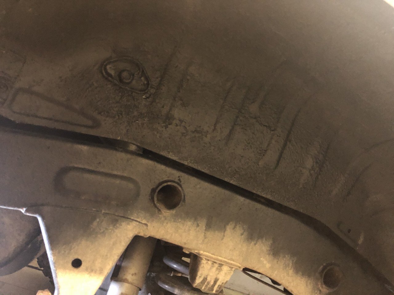

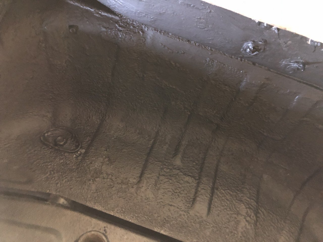

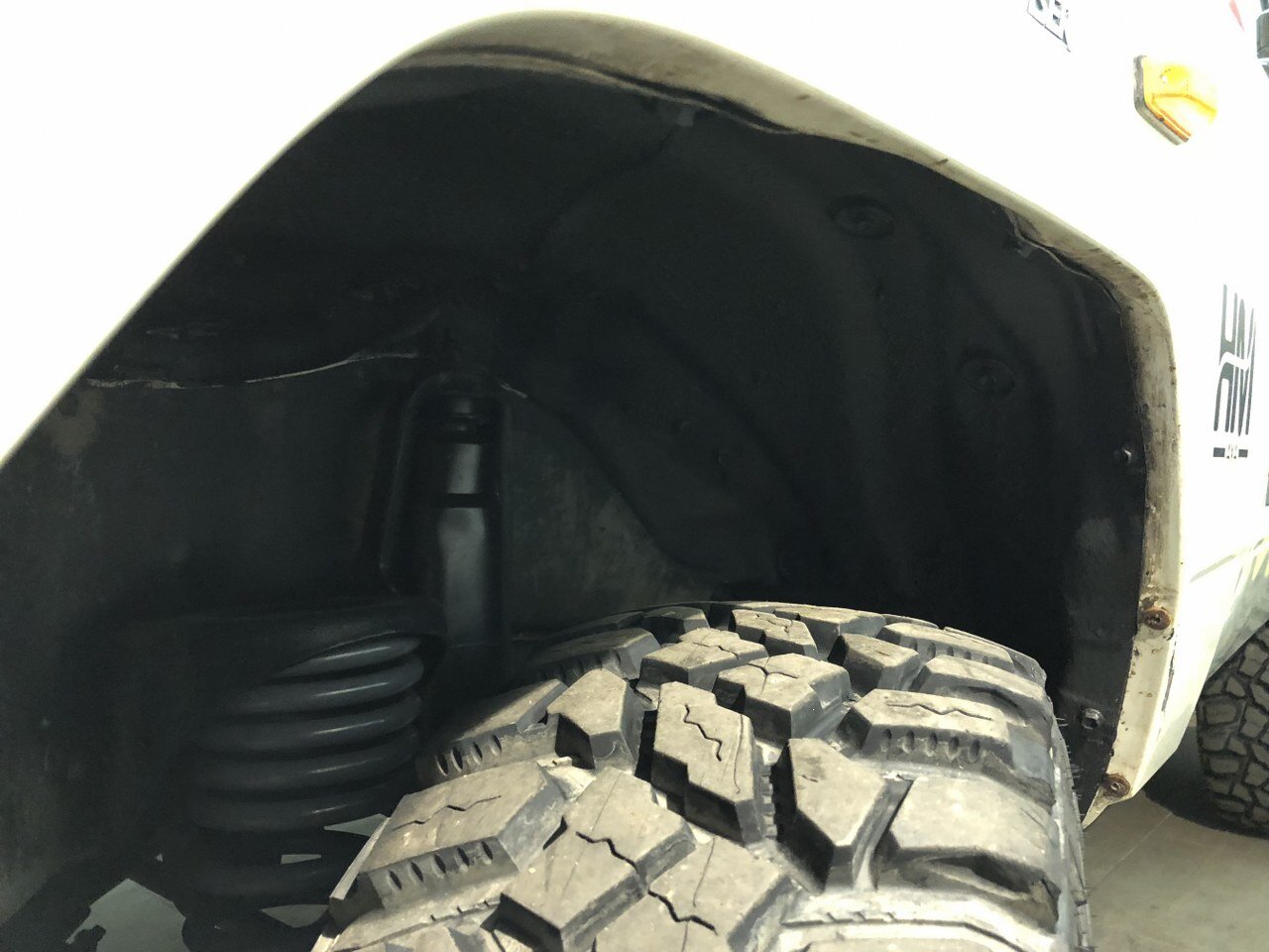

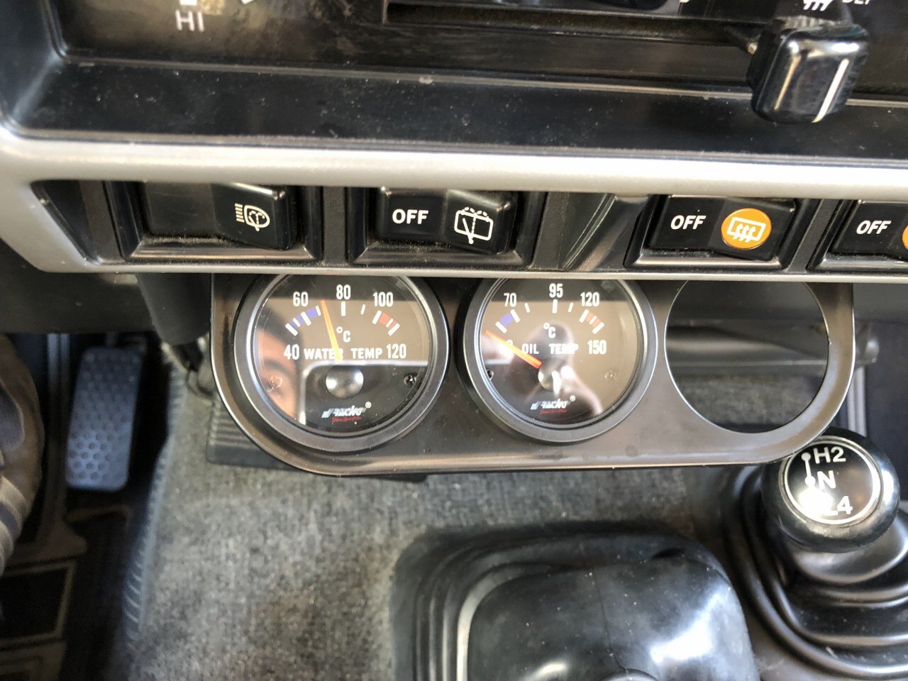

Furthermore installe water temp gauge and added 3m Protective Sealant in my internal wheel arches.

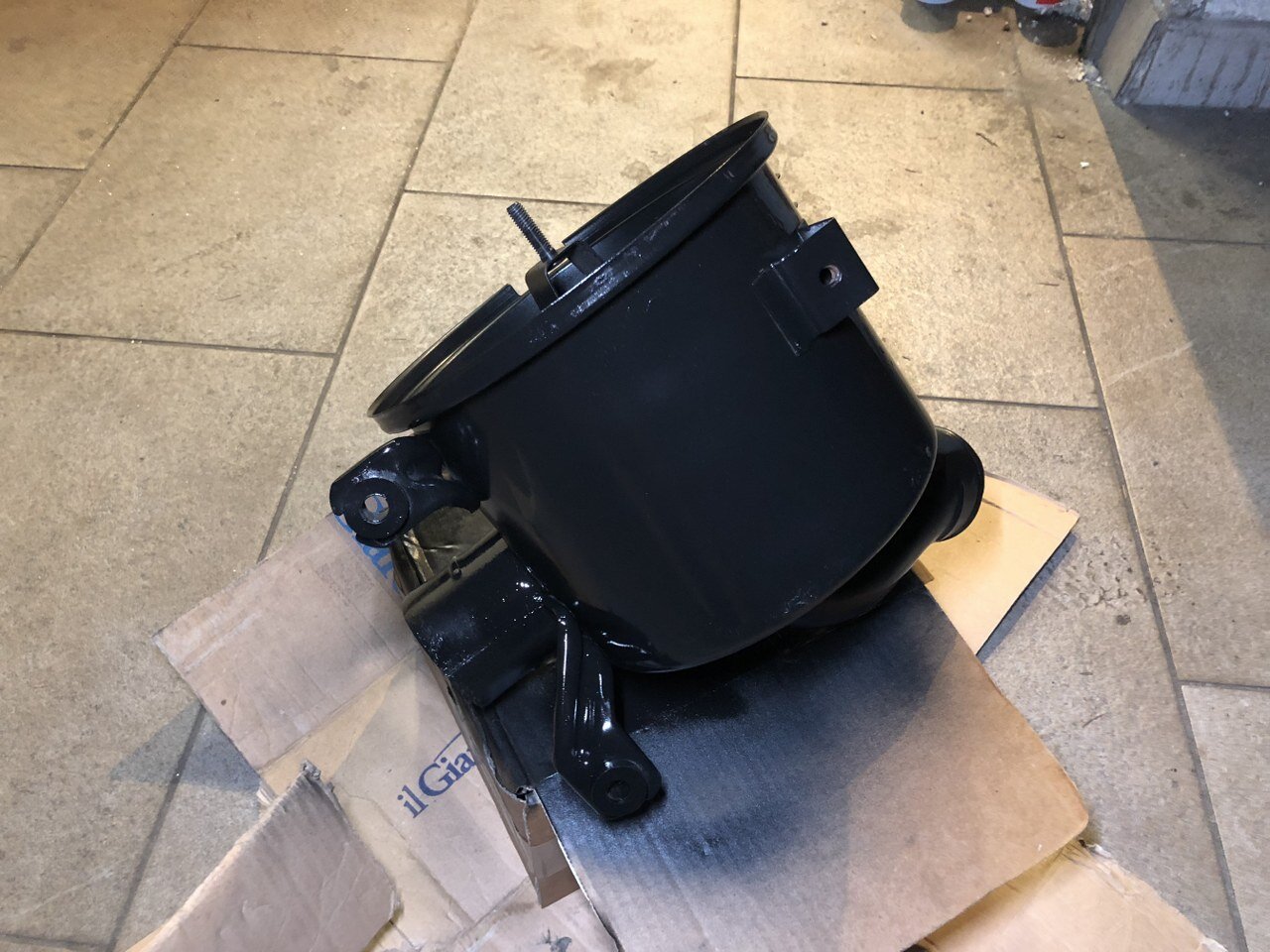

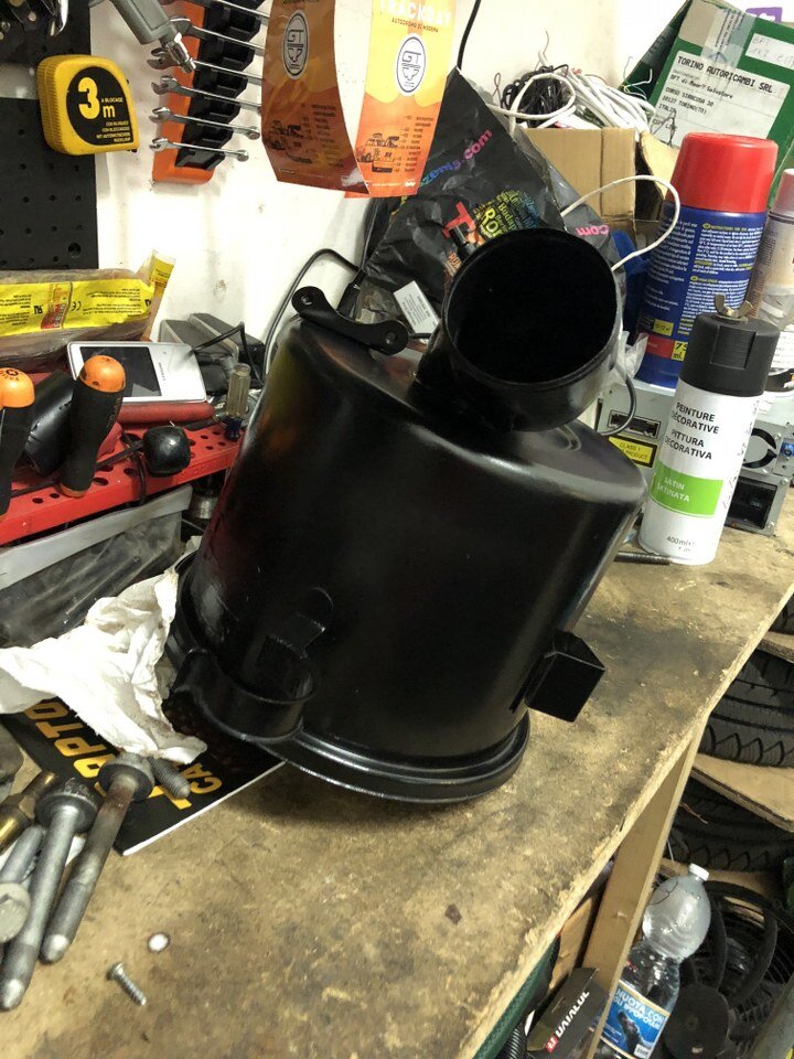

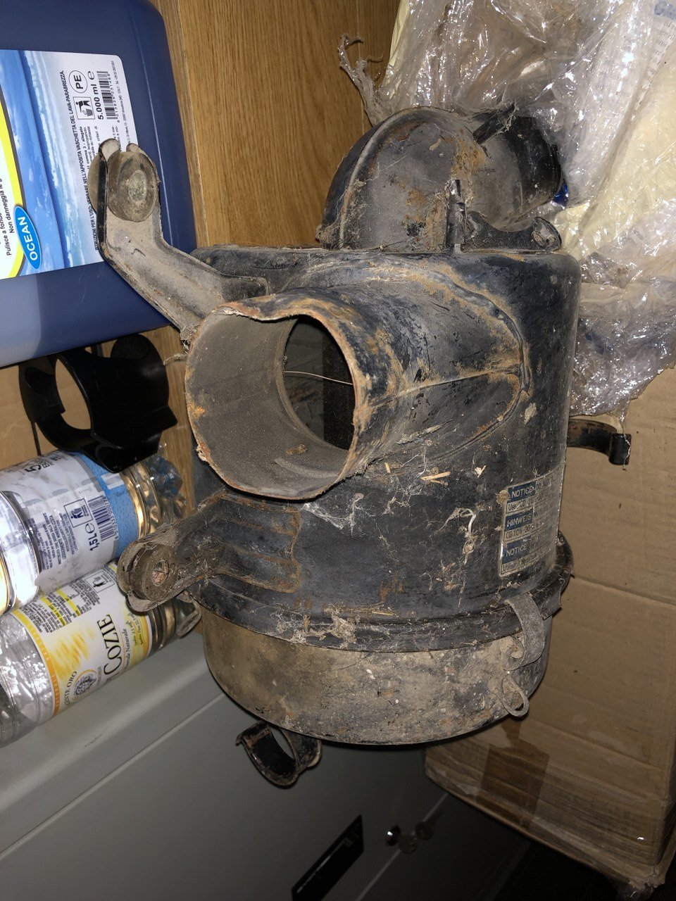

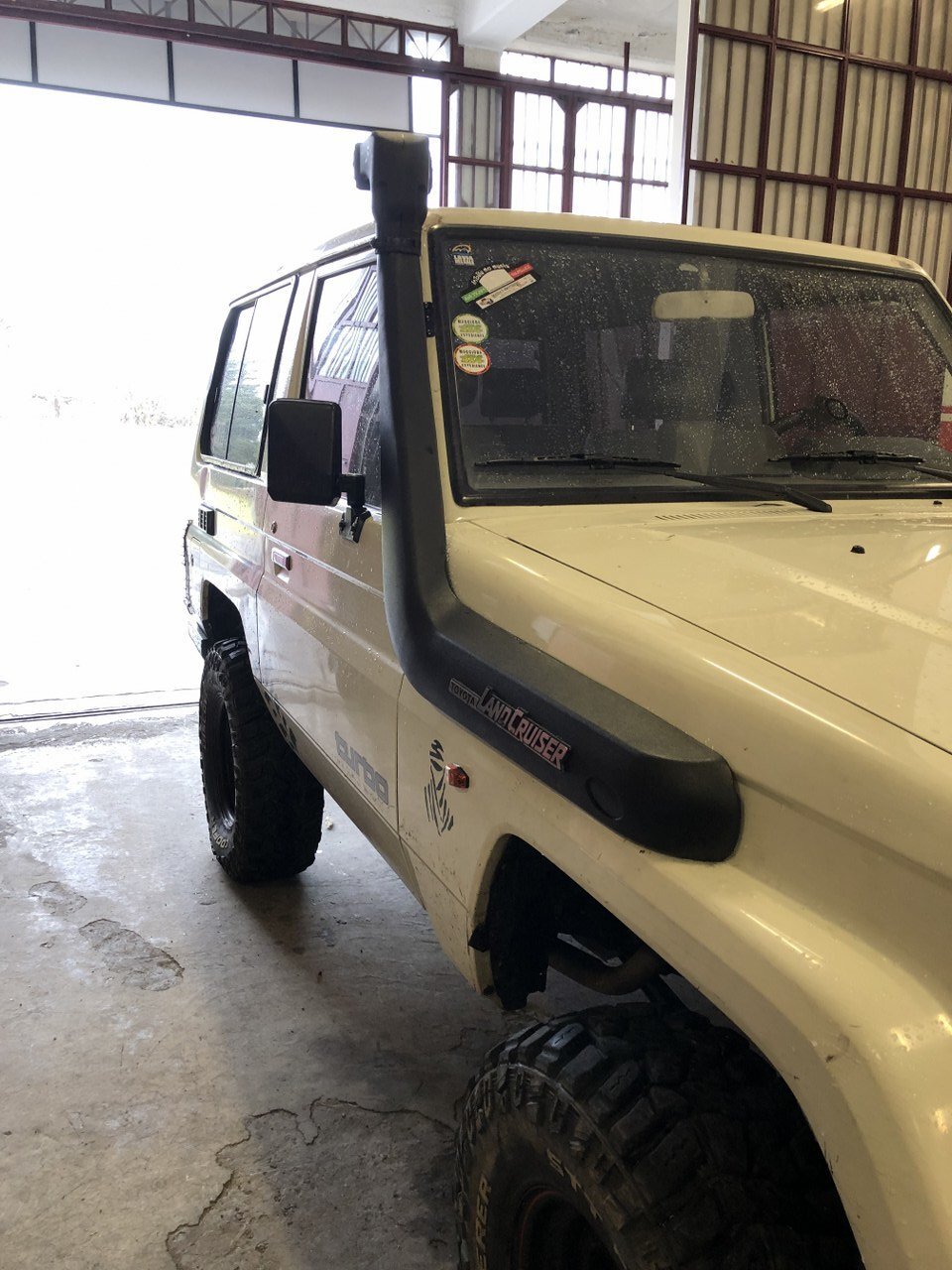

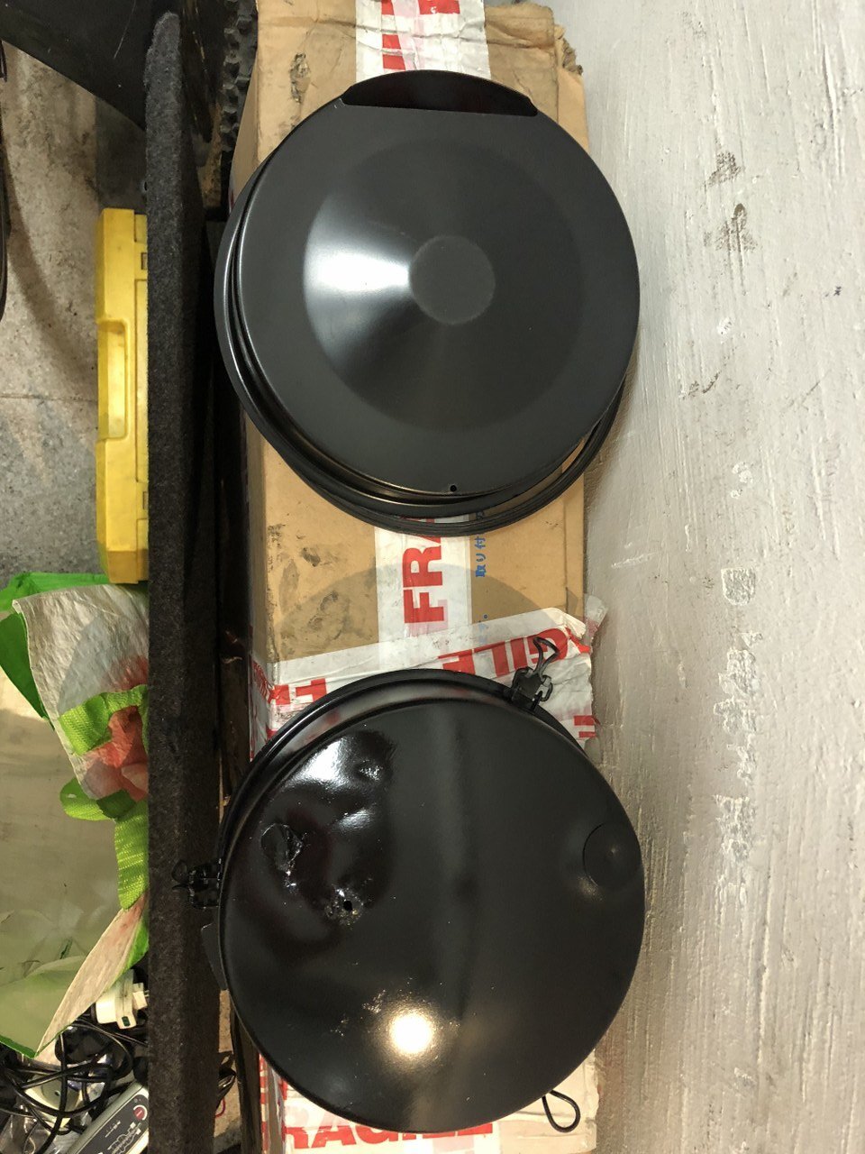

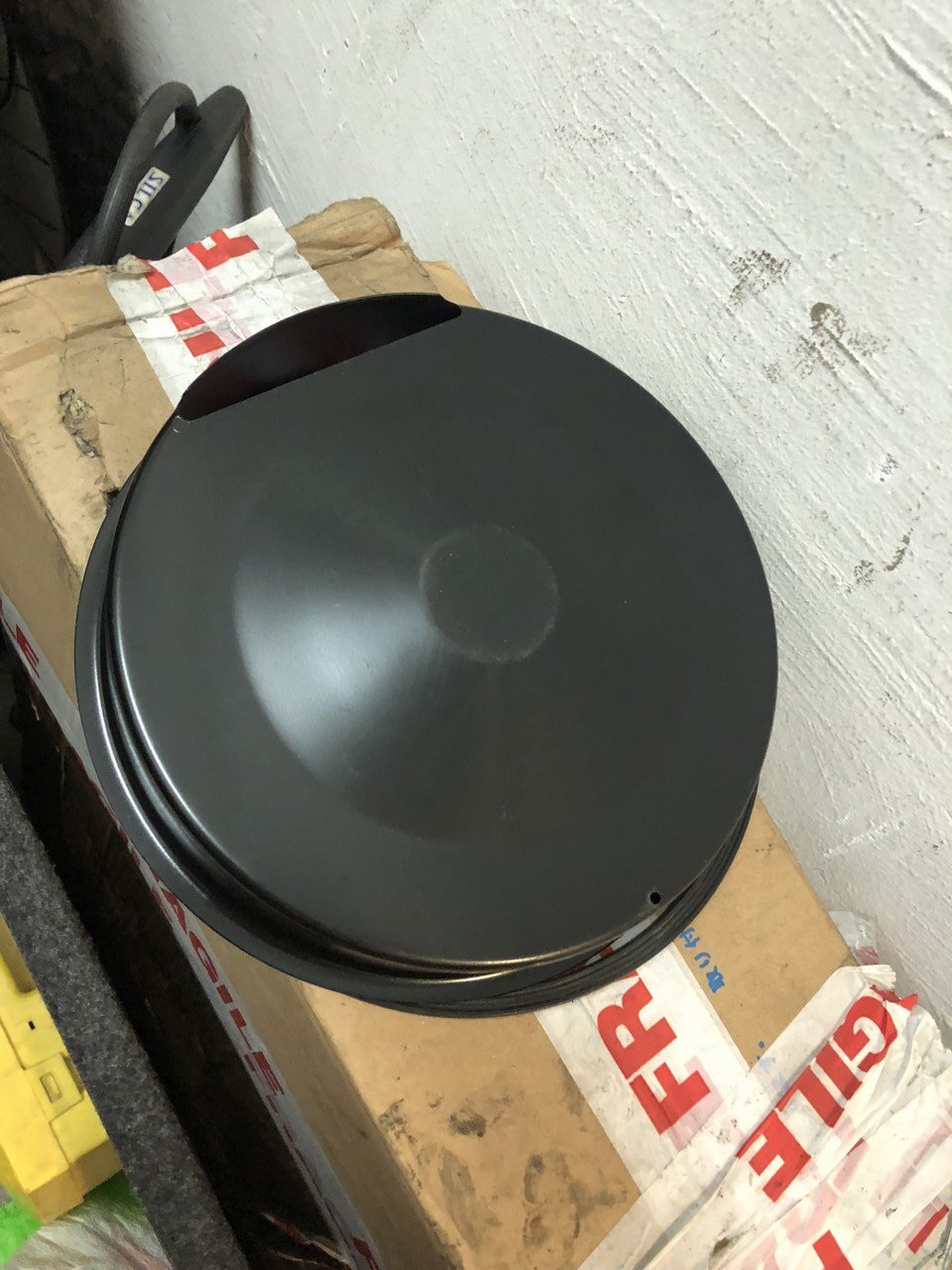

Little update, my brother gave me for my birthday a snorkel for my lj :D

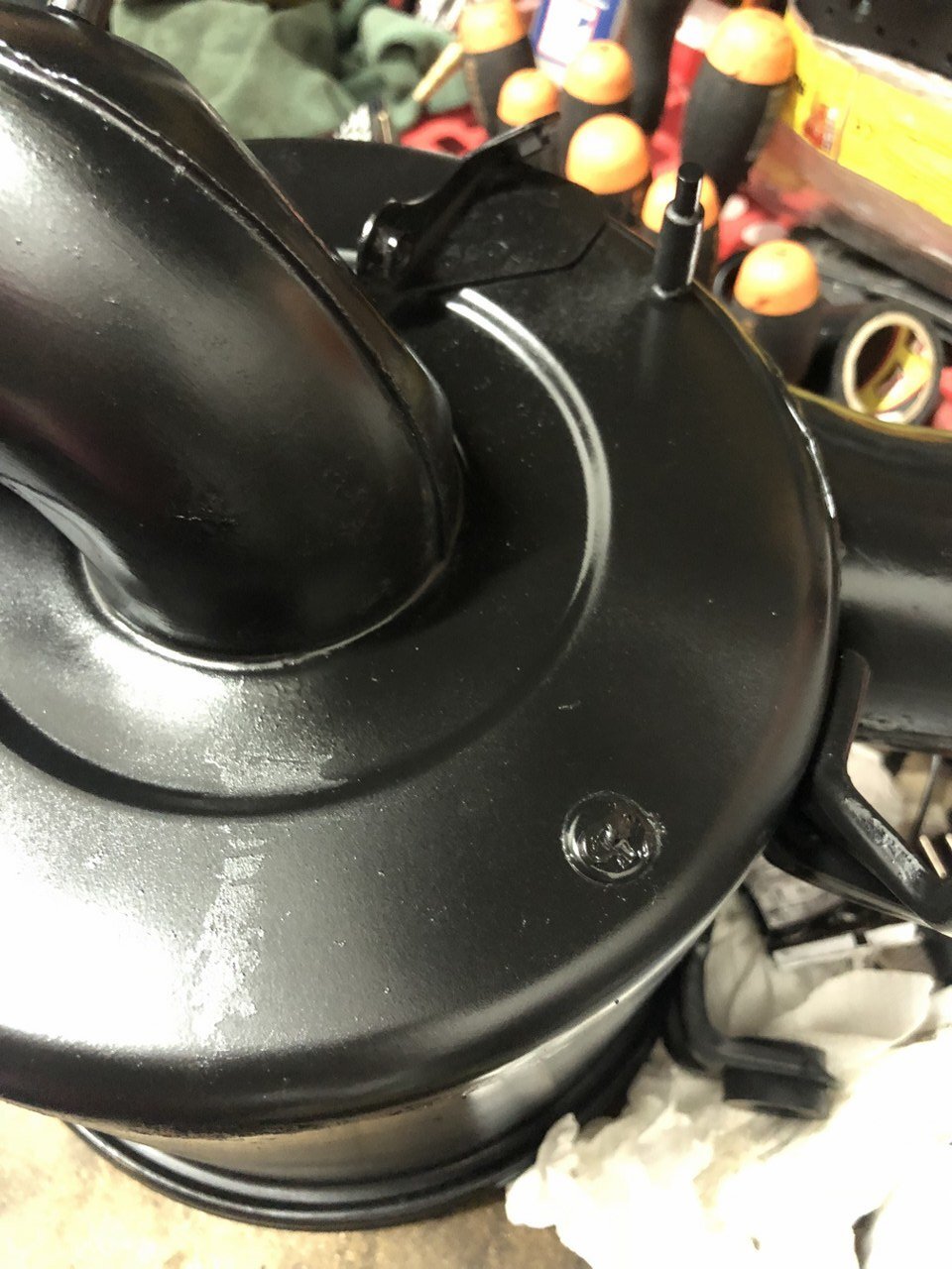

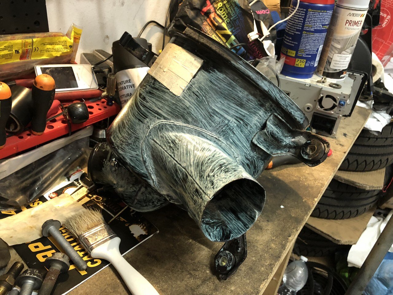

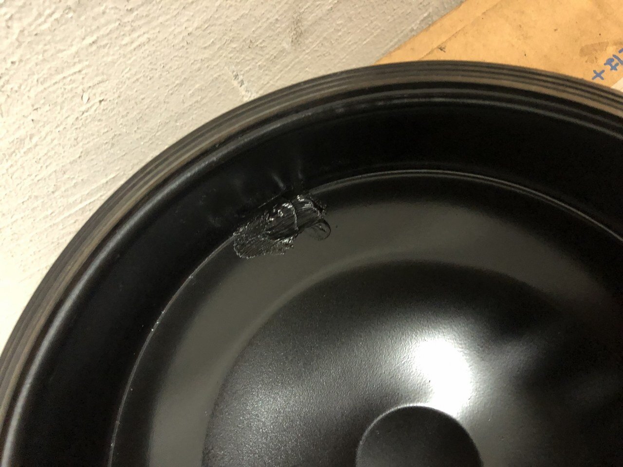

So first thing to was buy a square head lamp air filter...I found one that wasn't in good condition...but i little bit of work and it became like new.
Also closed all the hole to became hermetic
ATTACH]149755[/ATTACH]

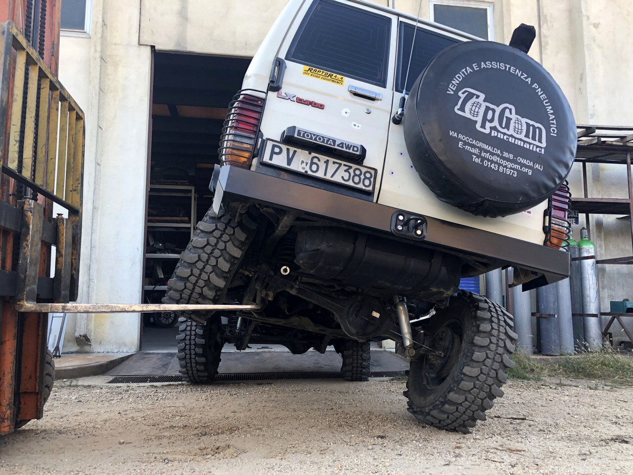

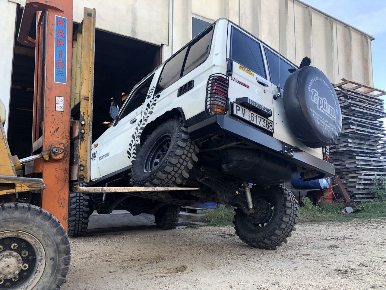

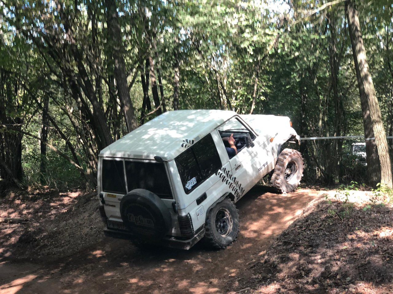

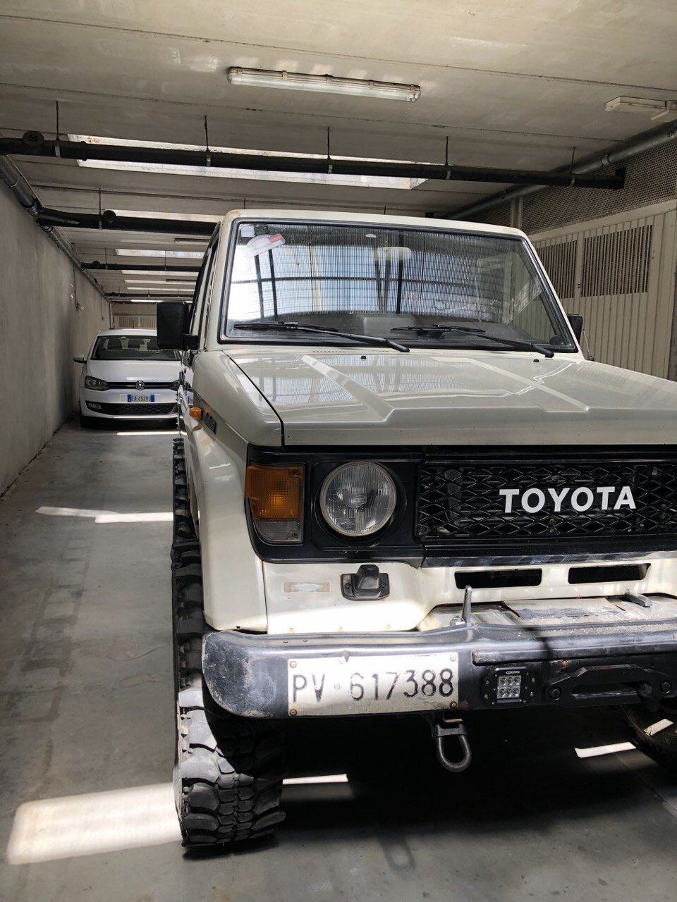

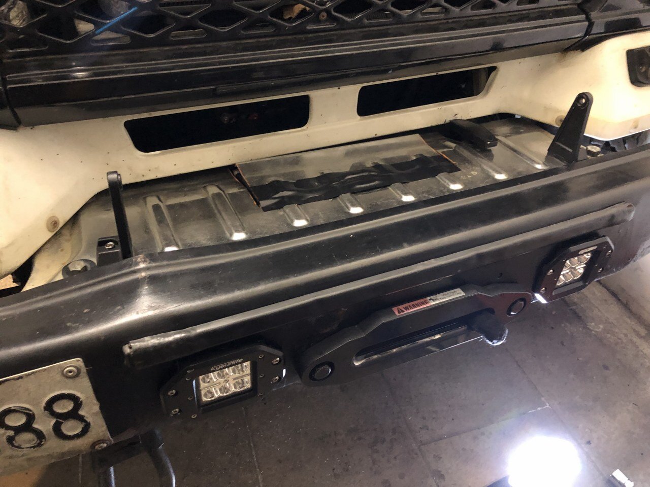

Slow update...New bumper is fitted...I love it, here you can see during a twist test
Twist is 71cm, not bad for a Lj70 I think...

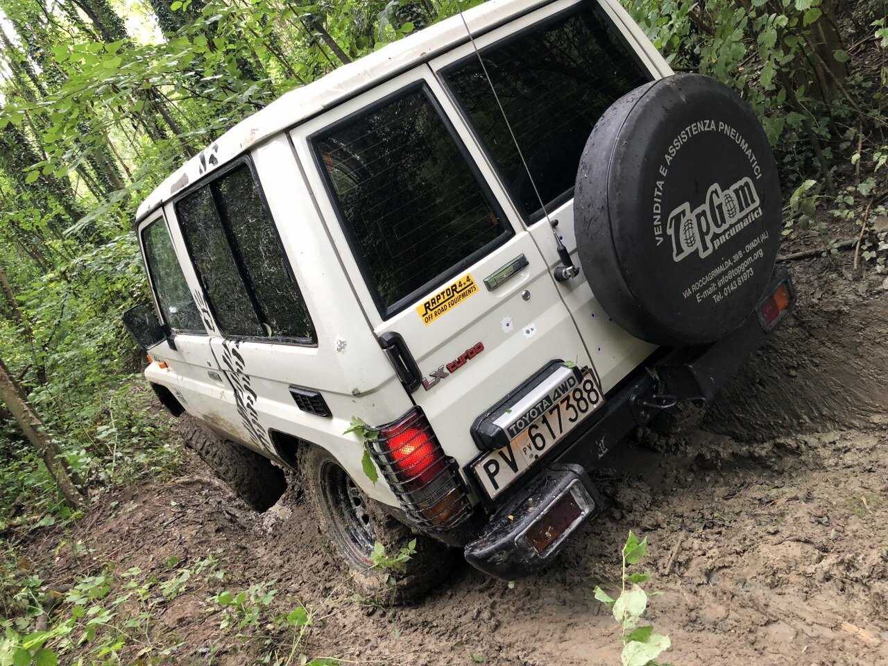

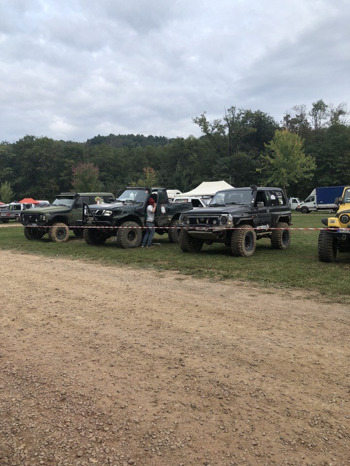

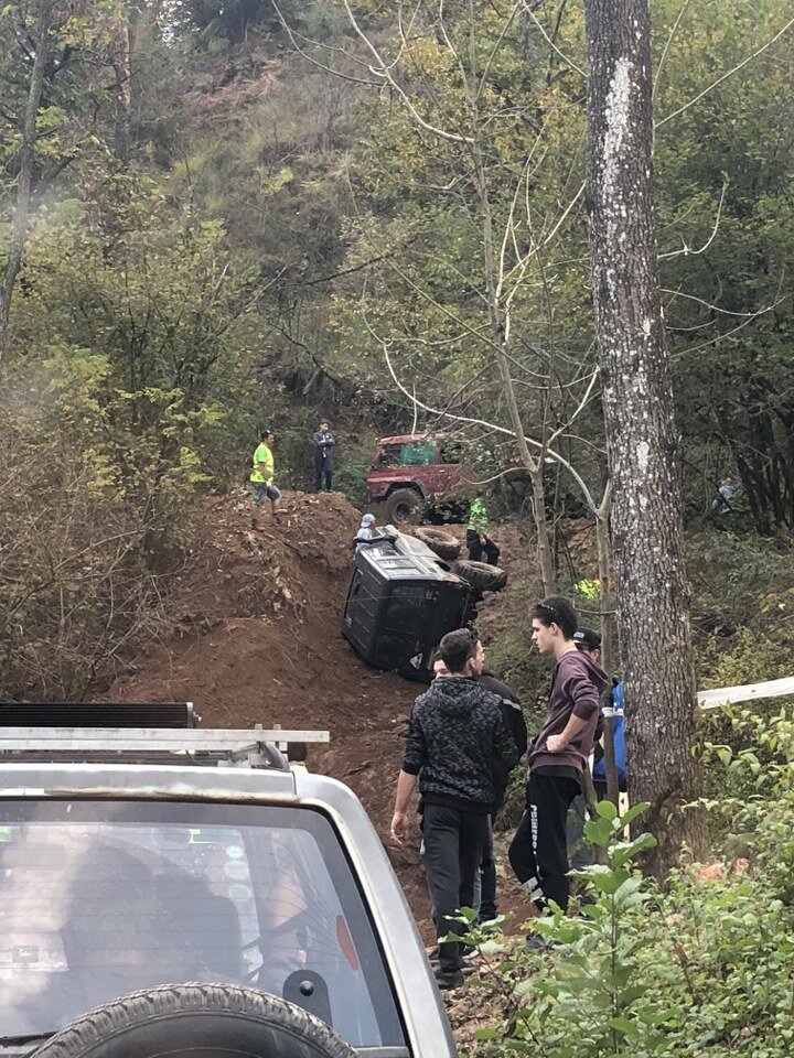

As I said, there was the Maggiora meeting, 3 days of 4wd ! And also this time I come back home without big damages! My toyota was one of most stock car, the other ones have bigger wheels and high lift
Not a good day for all...
Or new type of door opening ?? :D

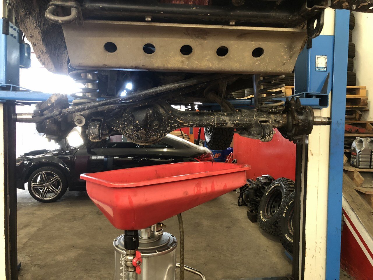

Interesting new diff oil change :D :D

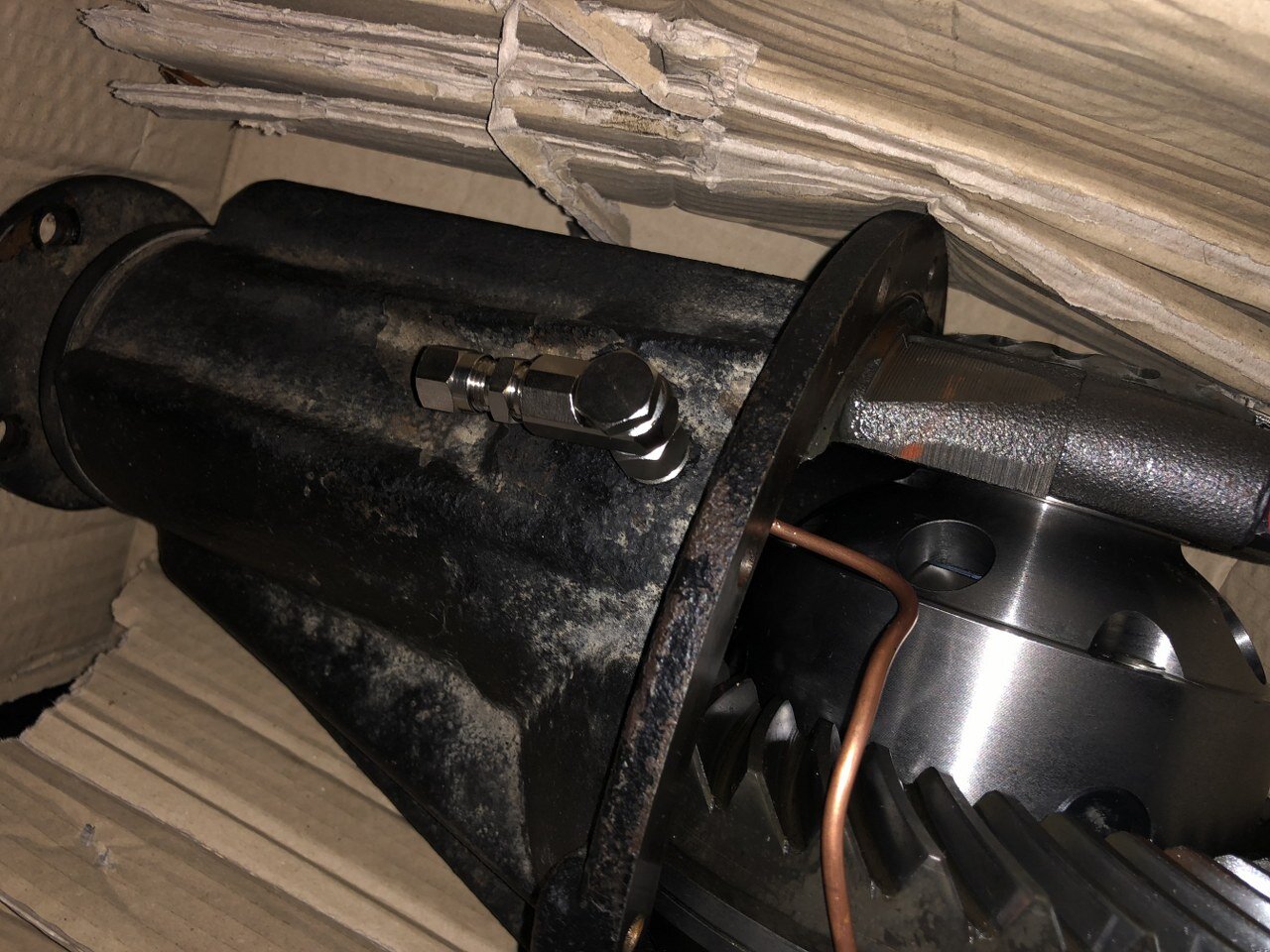

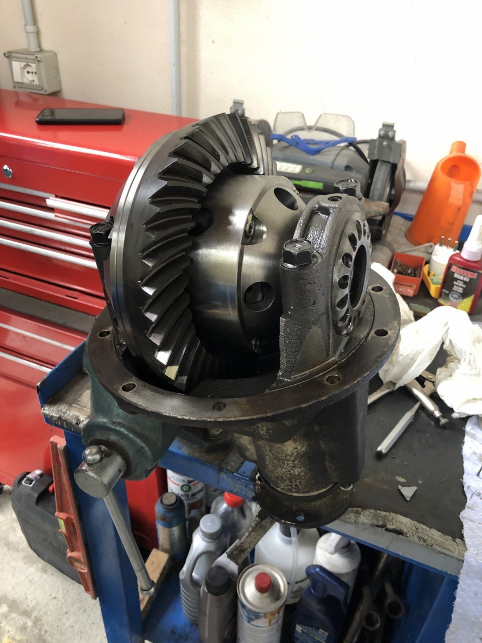

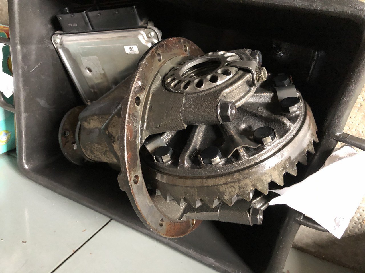

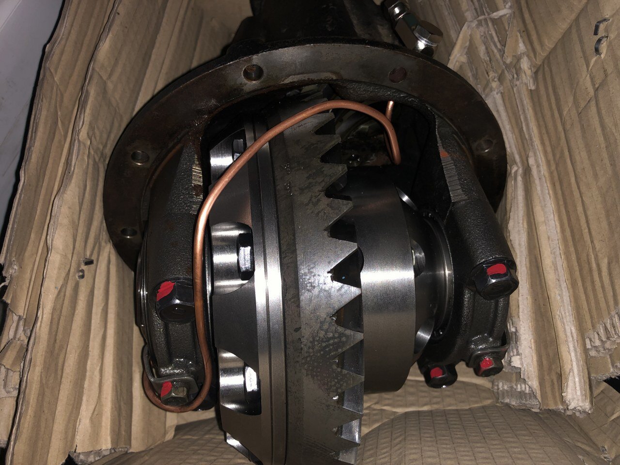

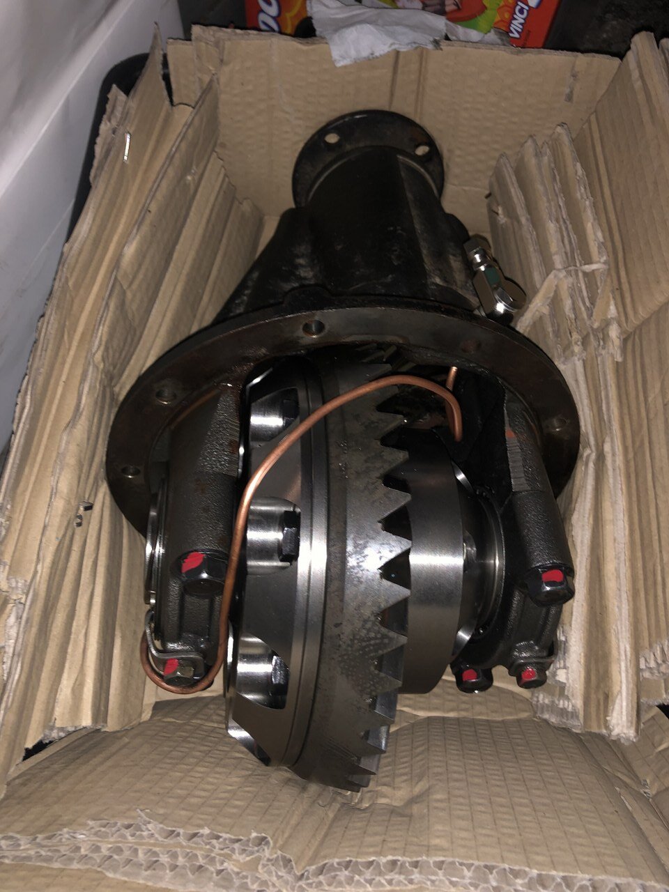

Front ARB Diff. I Found a really good price and I can't resist it

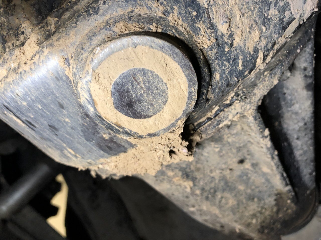

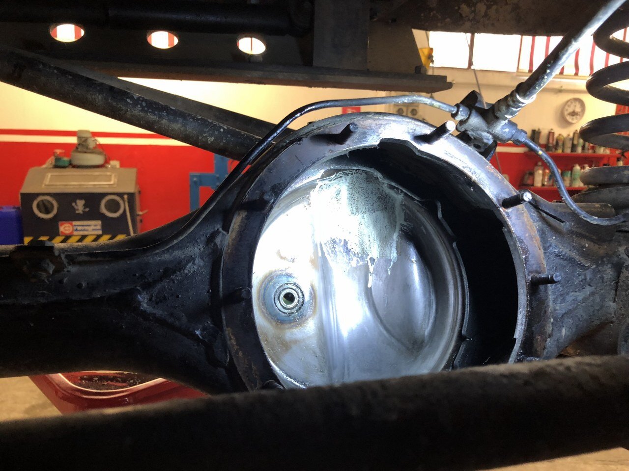

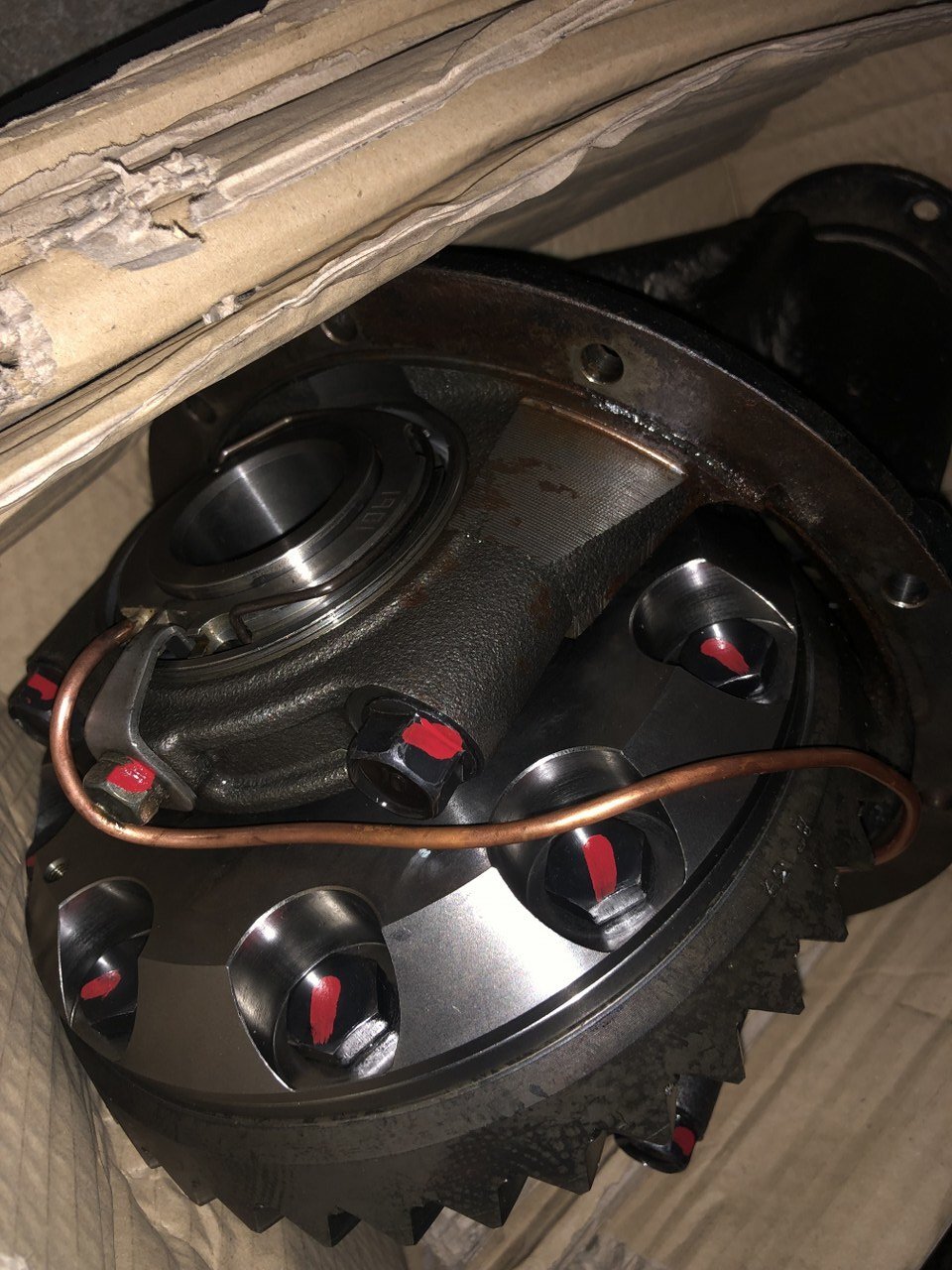

So I started with disassembling my front axle...and I Found RUST inside the diff...I can't believe!! I decided also to change front bushes, that were destroyed....but old one are really hard to extract
IMG_5255_1280x960.JPG IMG_5256_1280x960.JPG IMG_5259_1280x960.JPG IMG_5260_1280x960.JPG IMG_5261_1280x960.JPG
Now I have to bring front differential to a professionist to assemble it
See you soon....for next update :D

Very cool. Rust inside eh? Looks like it has been wading then.
I don't know why....is first time it has been opened in 32years....maybe your right...some water was inside...I put some rust converter as you can seen...I hope it could be enough

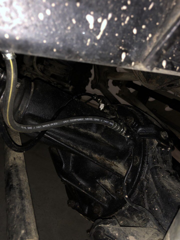

I've just installed rear arb locker and I have not had any issue...For the front one I also get new bearings 50mm instead off 45mm ones

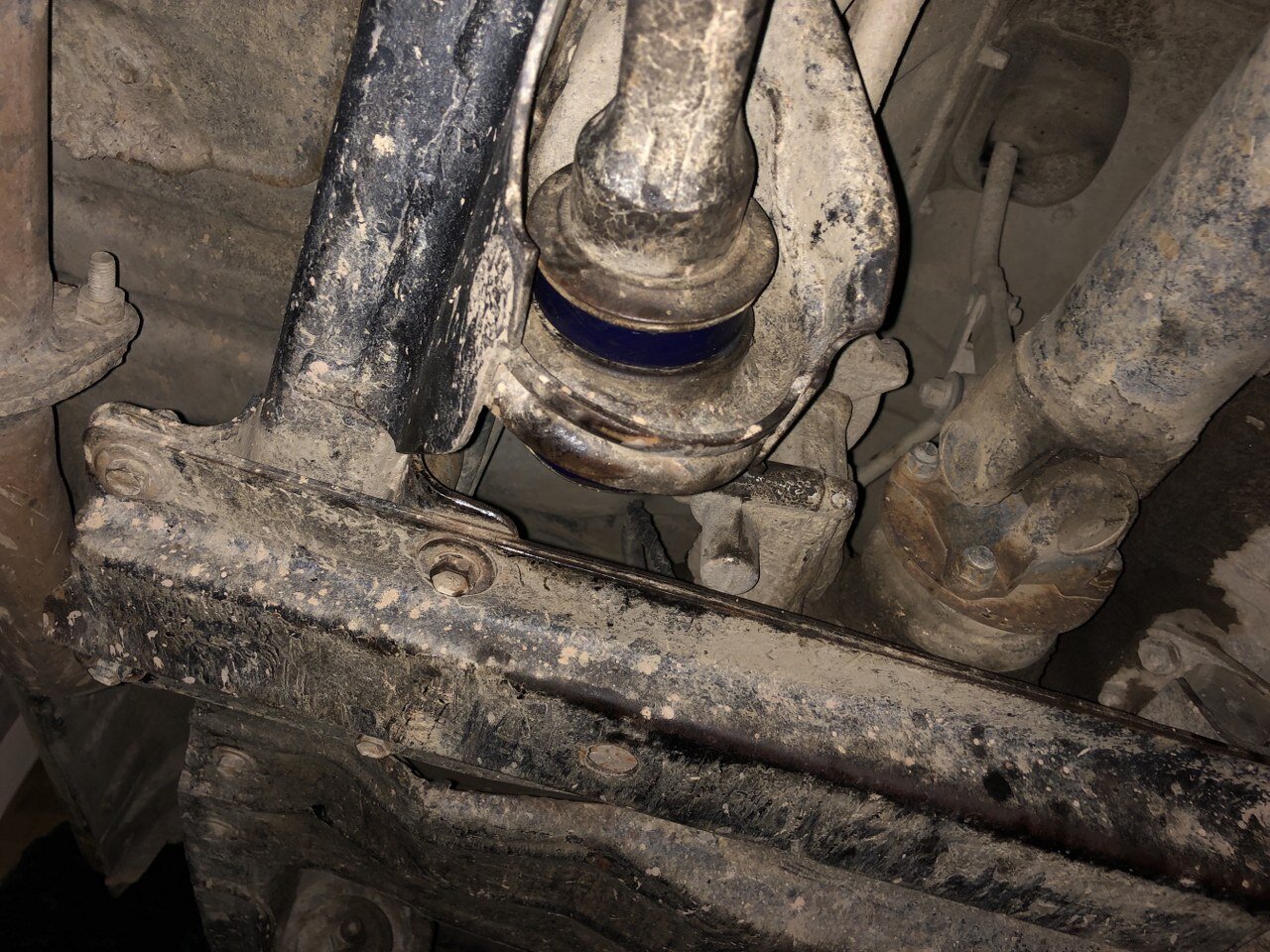

Front Diff with ARB was fitted, and arms come back on toy with OEM brushes on the front and superpro for the rear. Next time, I have do to same thing for the rear, but I wouldn't spend (40$x4) for original brushes, I'll try japanparts'one, hoping the could work on the rear.

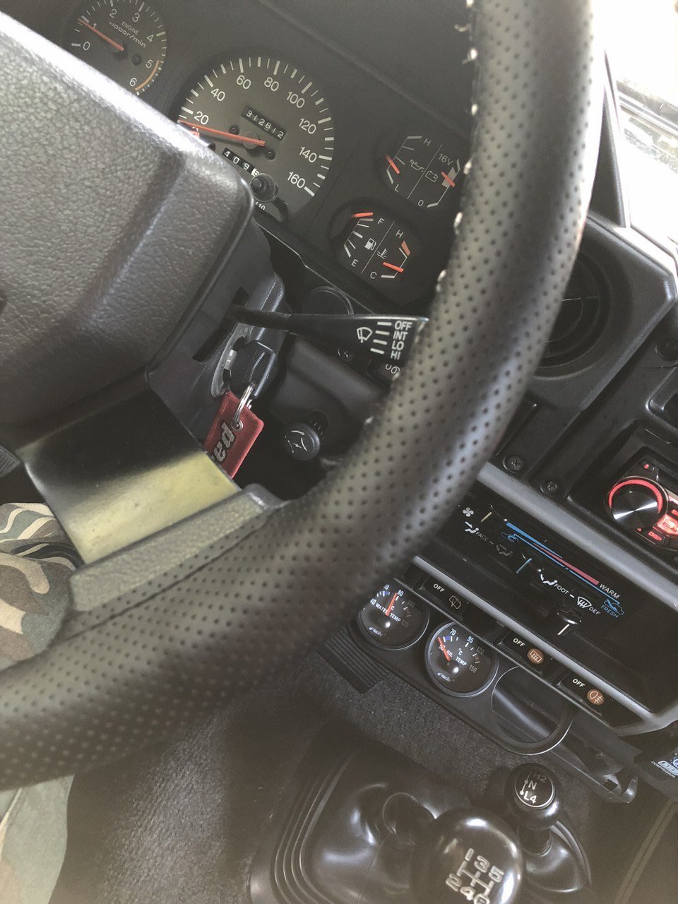

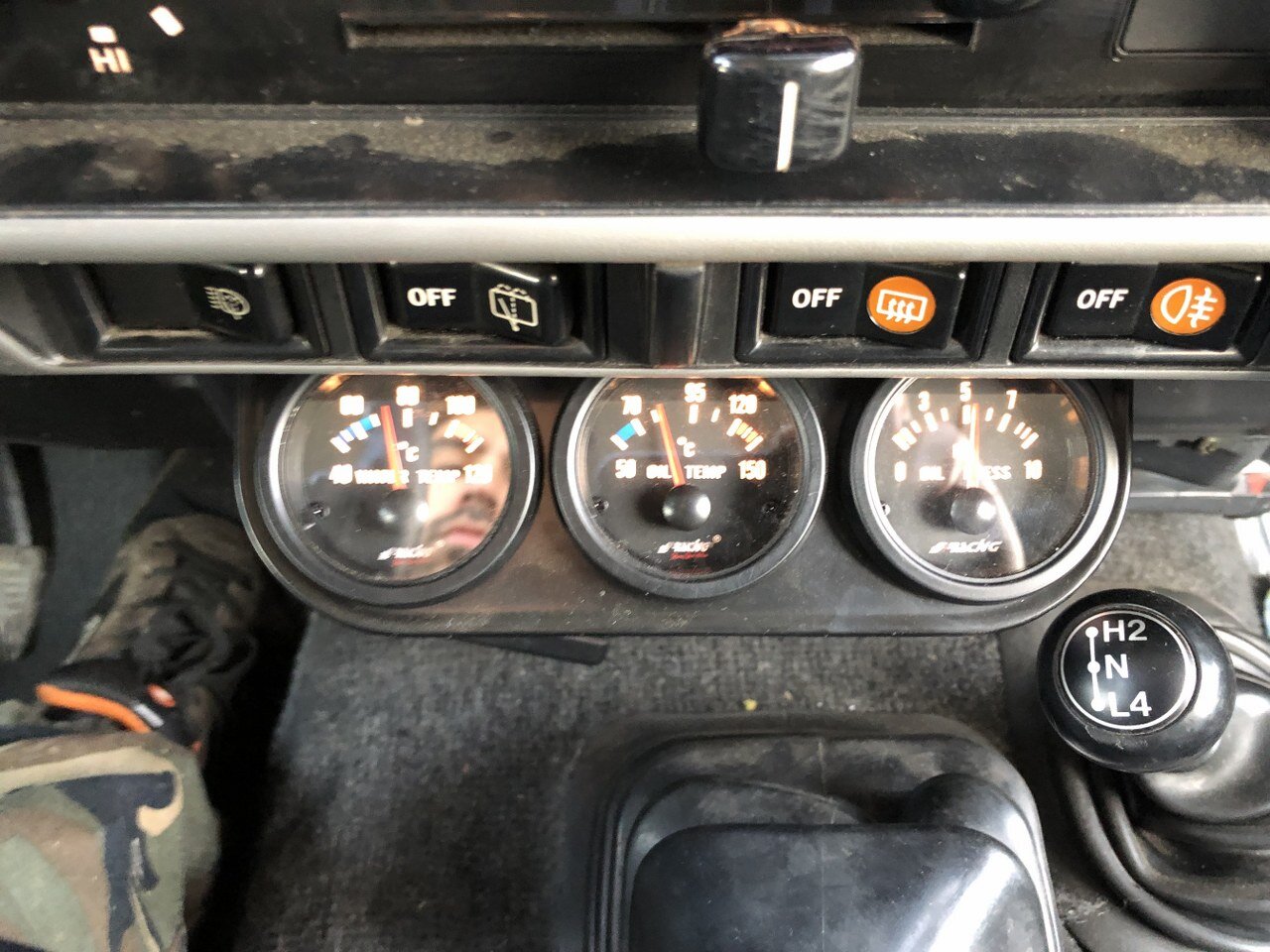

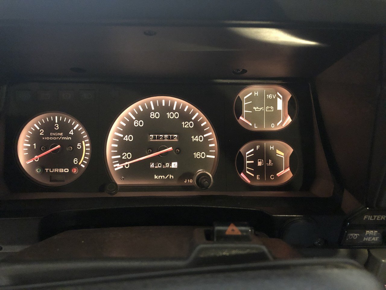

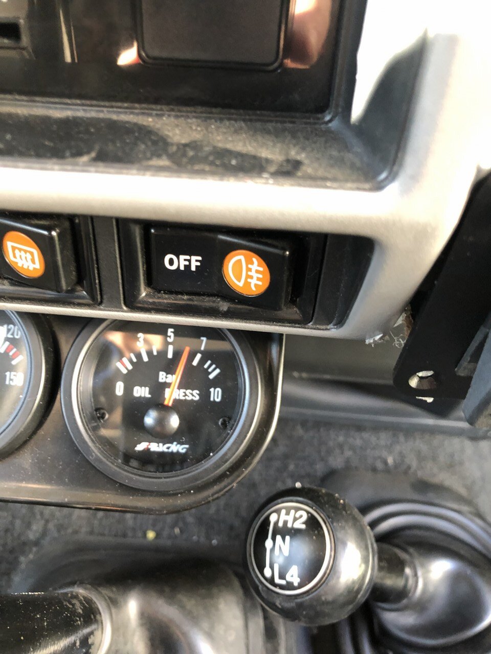

I've also connected all the gauges, so now I have Water Temp, Oil Temp and Oil pressure (turbo gauge is in a different position) and added new position for arb switch.
I believe that oil pressure is high when engine is cold...I hope that gauge is no perfect, when is hot I read good value(2bar at idle and 5bar at high rpm)

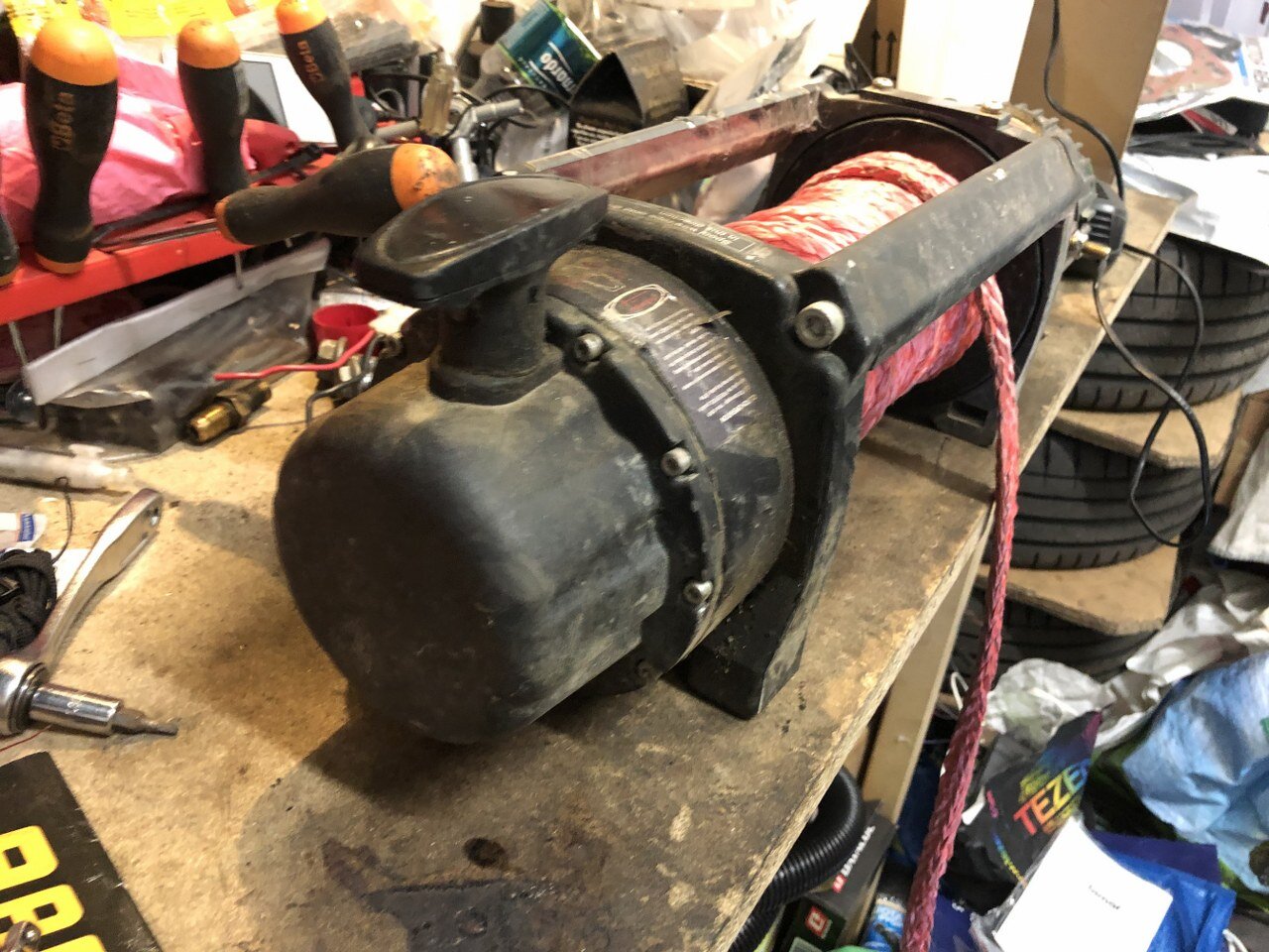

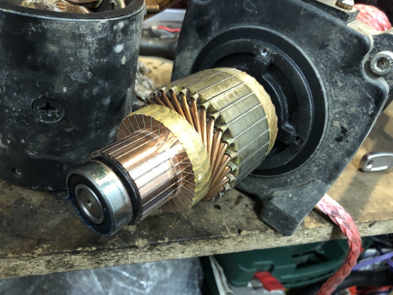

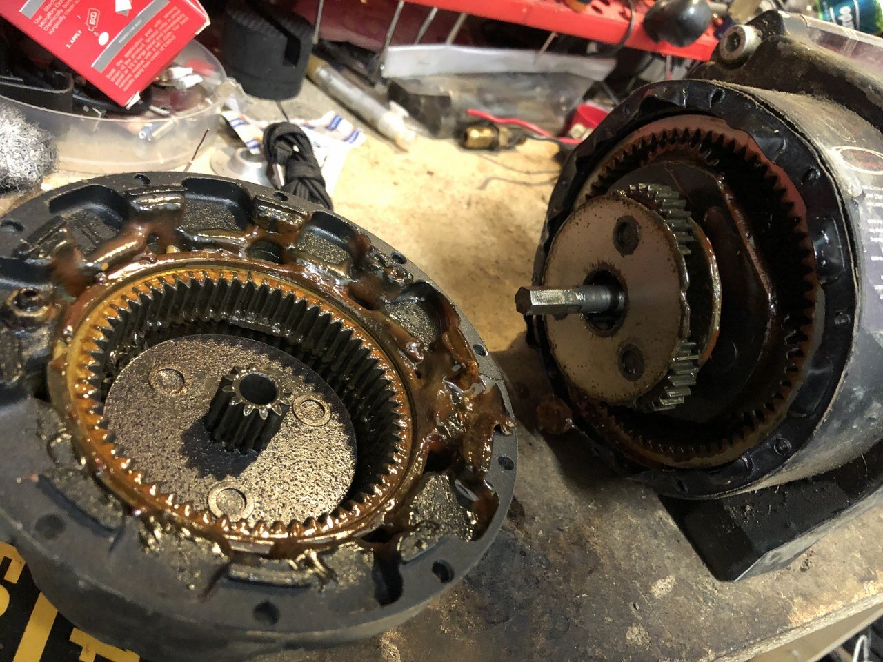

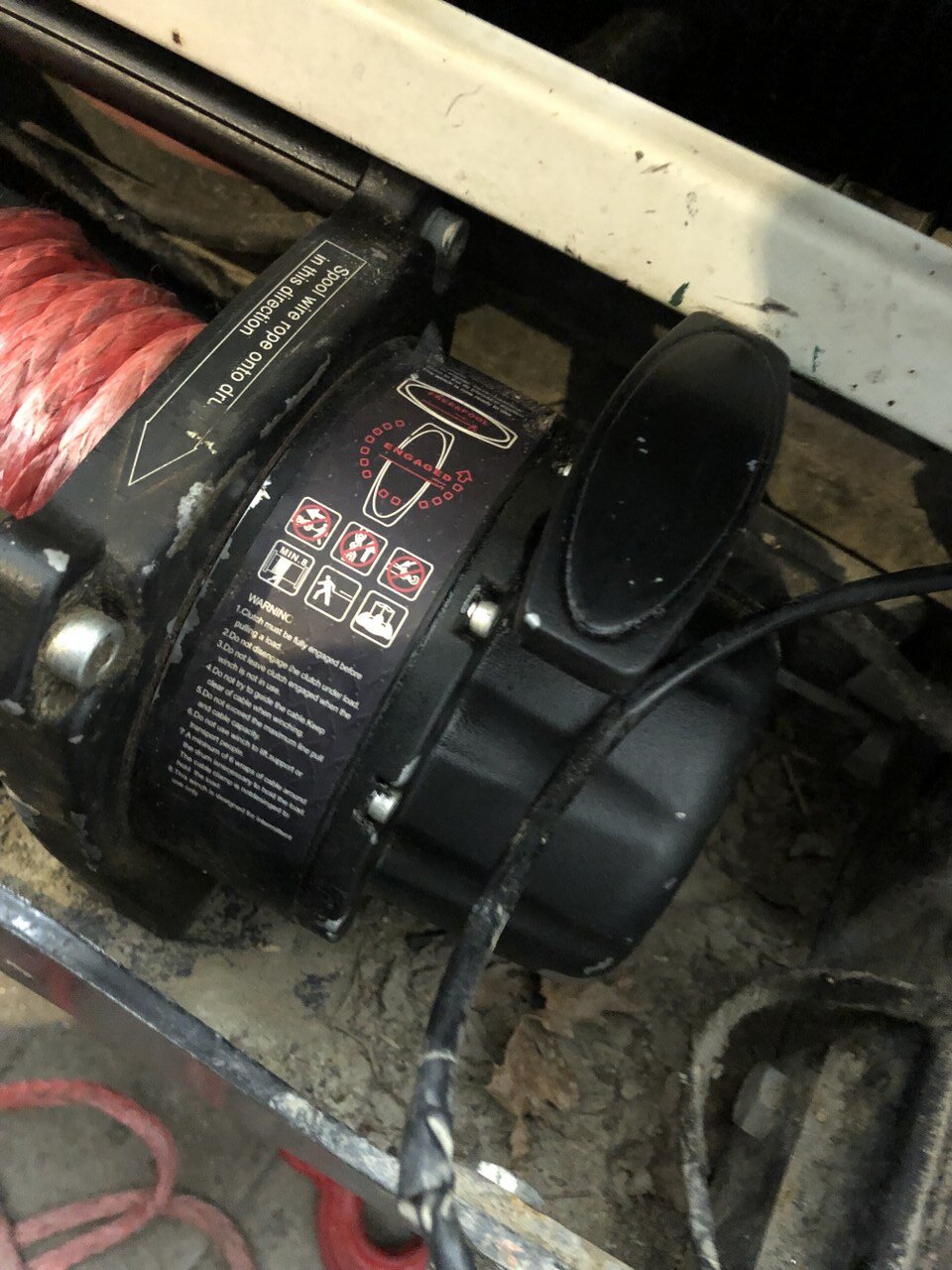

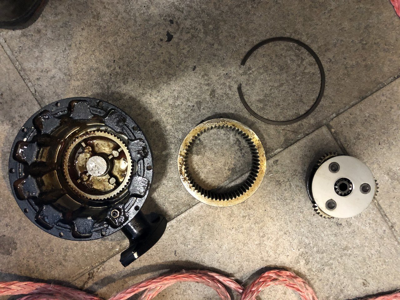

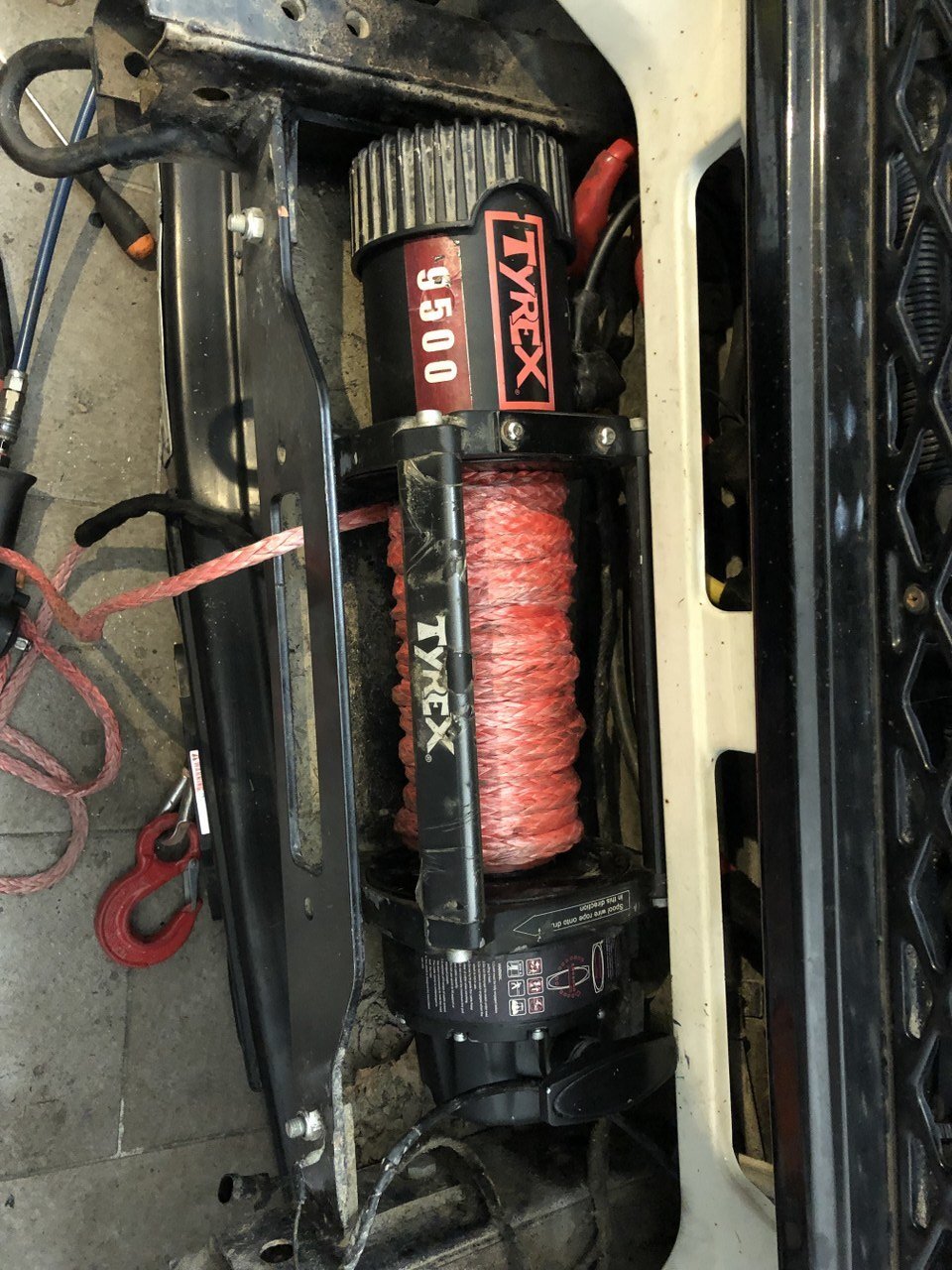

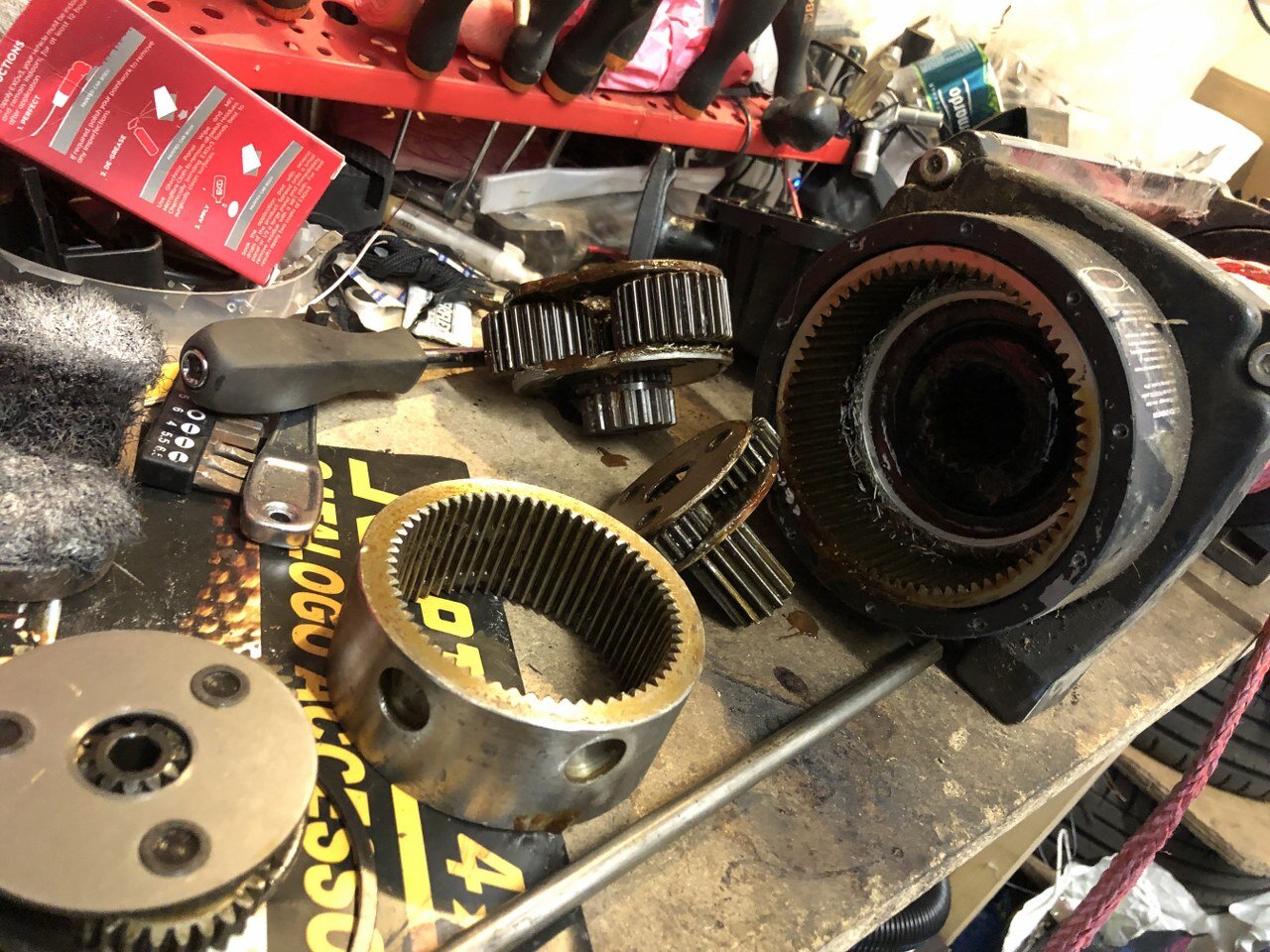

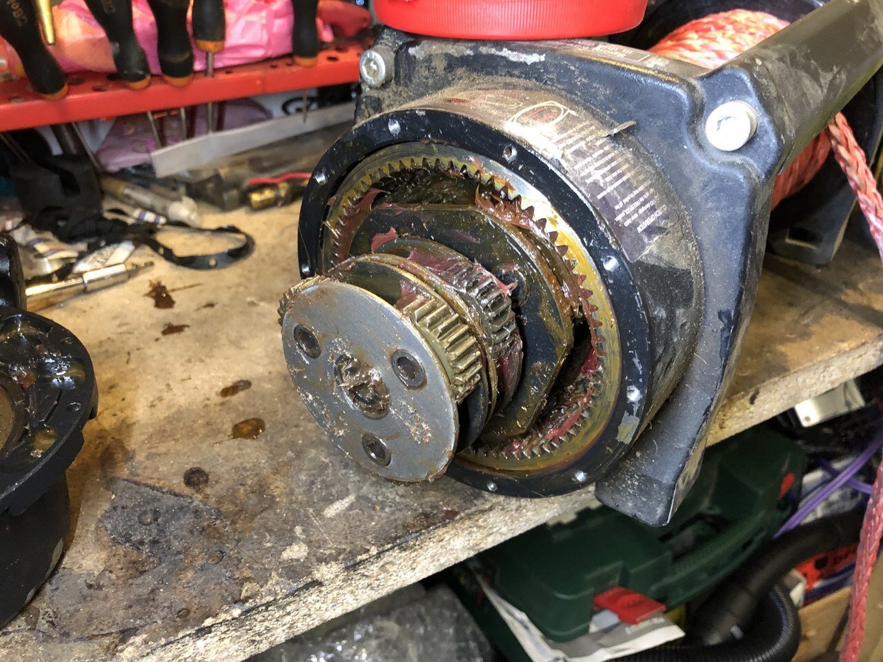

During a short trip in the evening with my friend, I have to use my winch to recovery him after rear differential explosion, it was a long recover, so after that I prefered check inside my winch and have a good cleaning of it
Is a cheap chinese shit winch, slow but it works :D :D :D

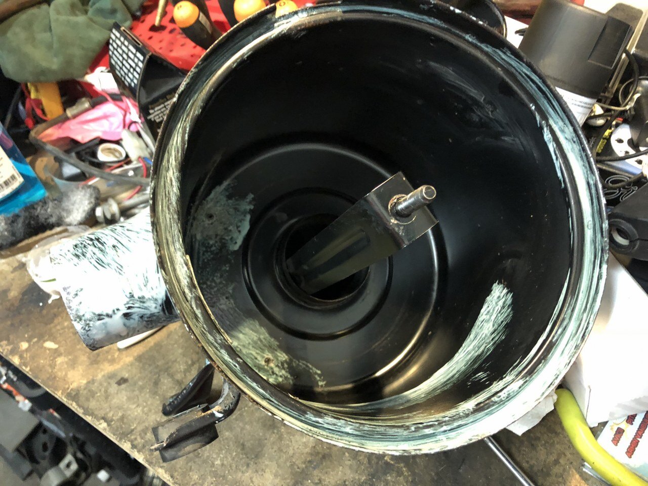

Inside I think that water is passed, so a good cleaning and new grease is a must
IMG_6416_1280x960.JPG IMG_6418_1280x960.JPG IMG_6419_1280x960.JPG IMG_6424_1280x960.JPG IMG_6428_1280x960.JPG IMG_6429_1280x960.JPG

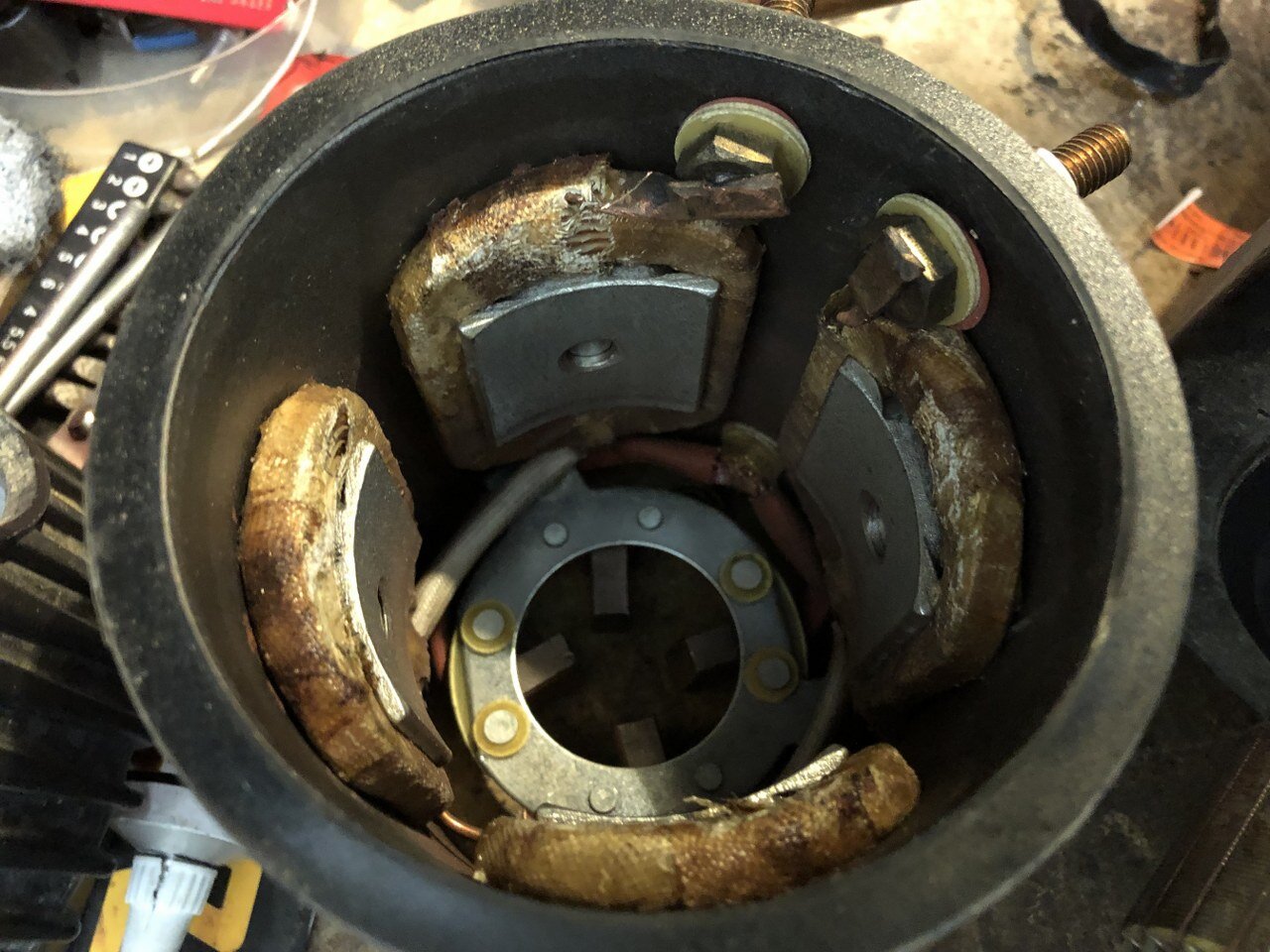

Engine side was perfect instead...IMG_6432_1280x960.JPG IMG_6433_1280x960.JPG
And the winch come back on toy :D

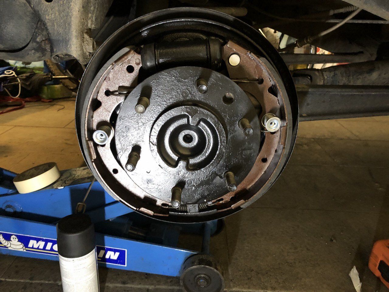

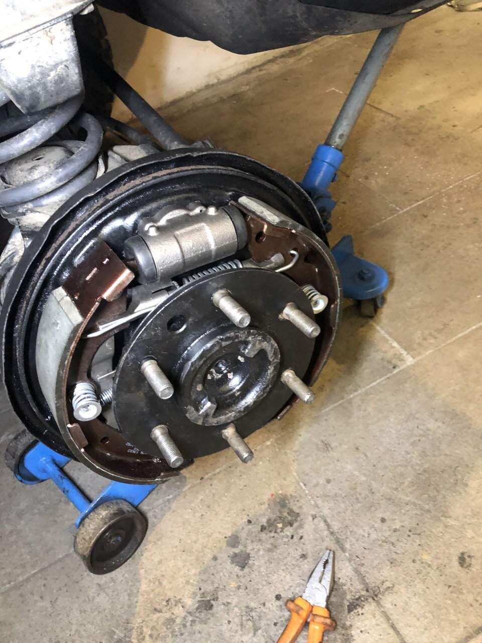

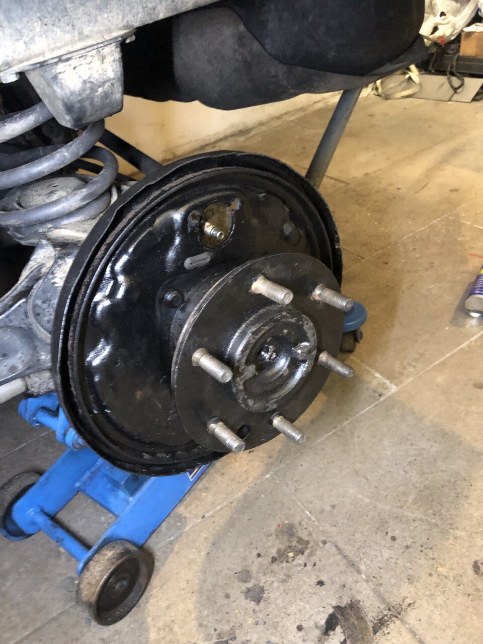

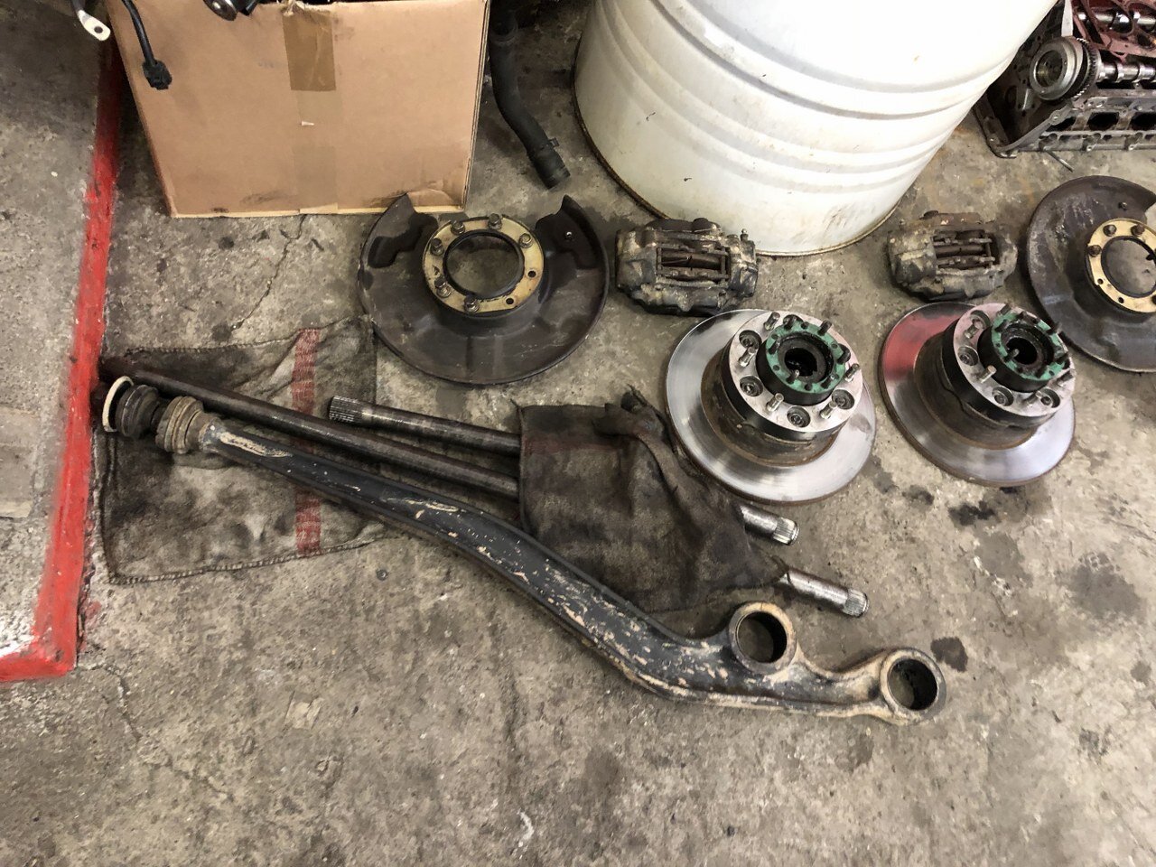

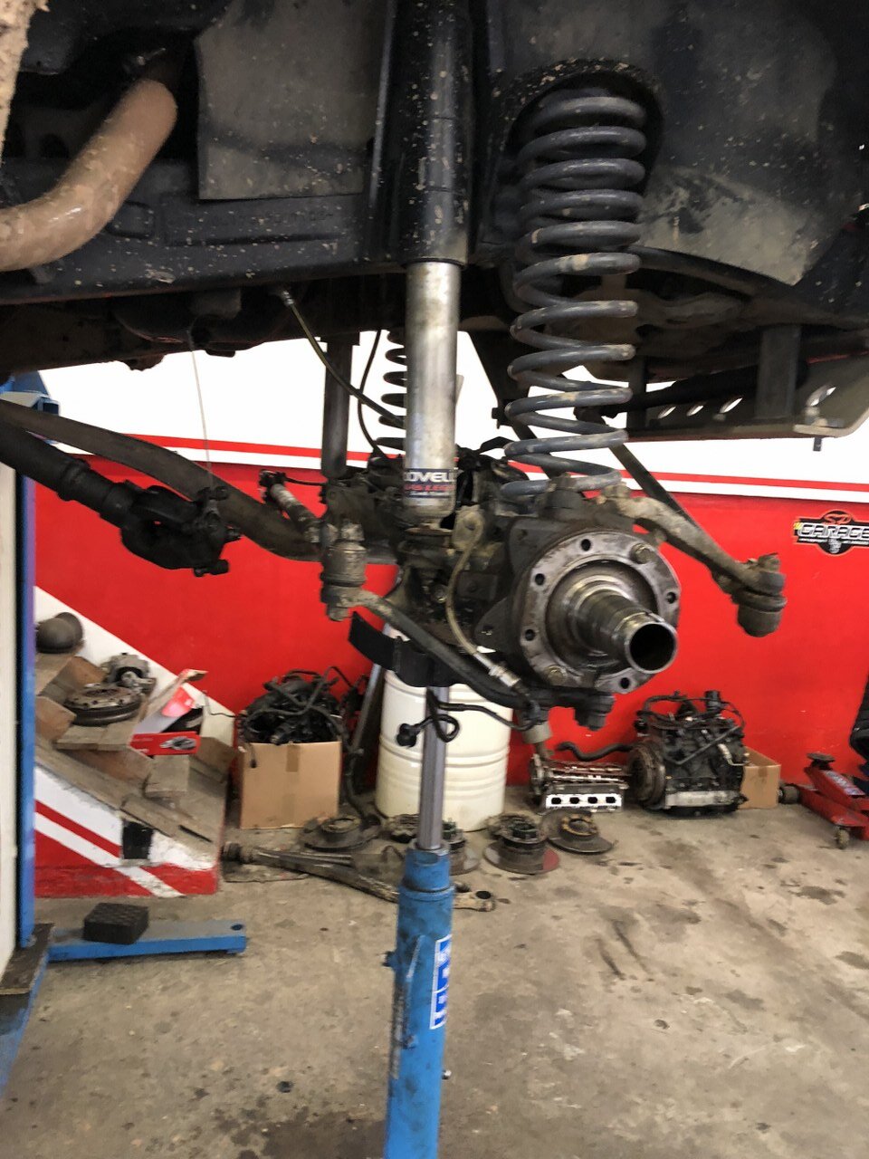

Well....After the old two days of off road meeting last october, I have a strange vibration on the rear left..

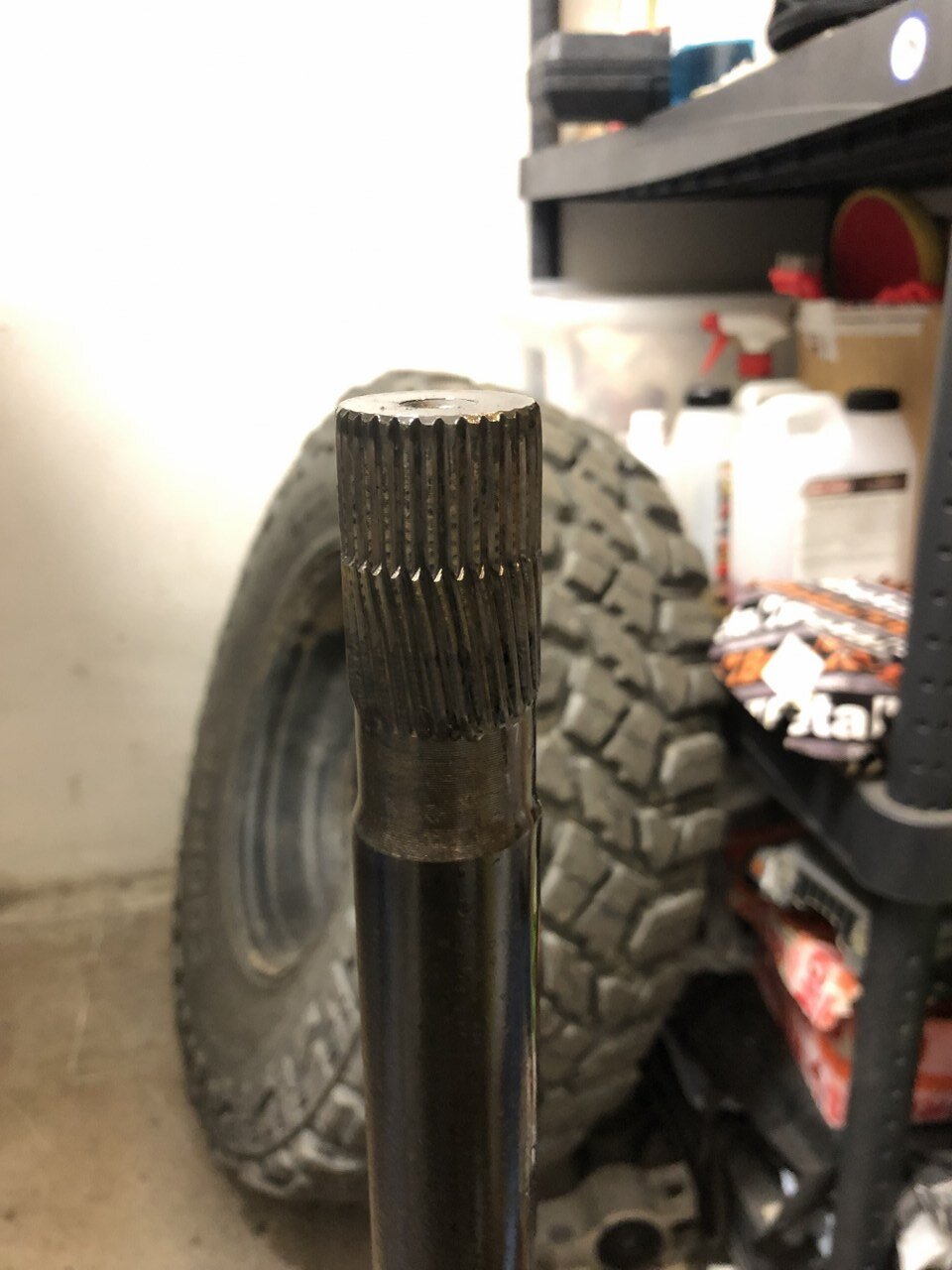

So i decided to change rear left axle....and it was a good choose :D :D
The only HARD THING to do, was change rear bearing on the axle! It was incredible, axle is so long that didn't enter in the press... It wasn't a nice work :D but with good hammer i WIN :D
And new pads is on :D
(new pads also on the rear right :D)

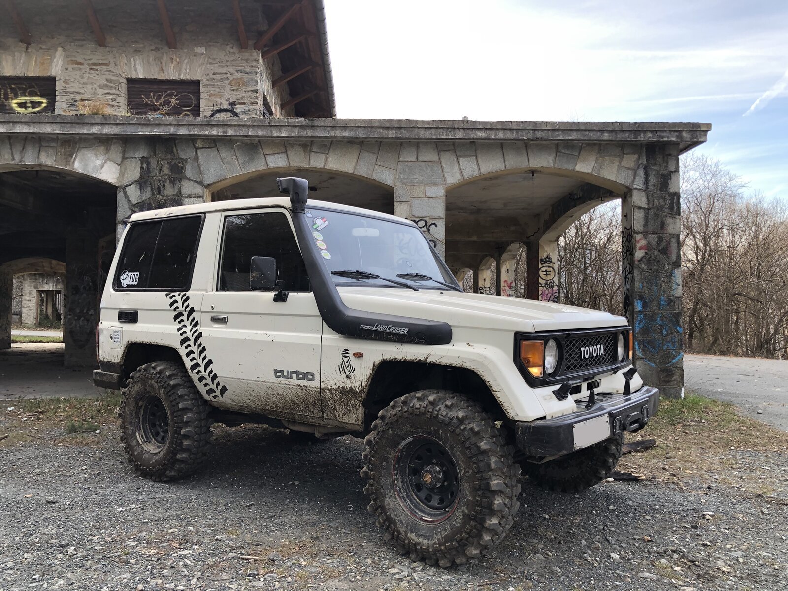

And last thing I've done is fitting the snorkel!
I tried to install the "land Cruiser badge" on the snorkel, but I wasn't able to fix it right! Subsequently i added a chinese (less that 2$ ) chinese side light :D :D IMG_6533_1280x960.JPG IMG_6537_1280x960.JPG
