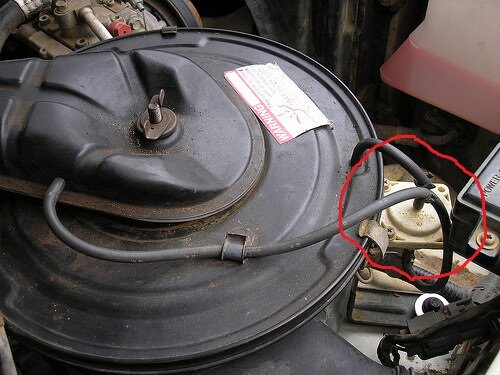

can someone tell me what the little white thing is, that hangs off the airbox?
I've circled it in the attached picture, the little pipe for the bottom hose is snapped so ill need to replace mine.. just trying to figure out what to search for...
By the way that is connected Lockie, I'd say that's a differential pressure switch. It's looking at how much the air filter is blocked and would I imagine bring up a light on the dash, so must be an option for very dusty countries. I don't have one on mine but that's what it will be. Have a look on www.amayama.com and put your model number into their parts search. It should come up under 'engine' or something.

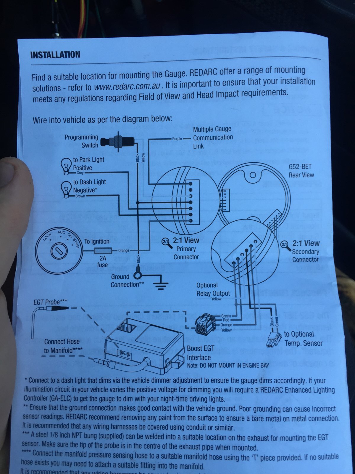

my redarc gauge came this afternoon!!
I've started fitting/wiring it (key word being started and not finished)
word of warning to anyone who intends to buy one, you don't need to buy the lighting control (AKA dimmer) if your car already has a dimmer for the dash.... so don't make the same mistake I did and buy it just in case....

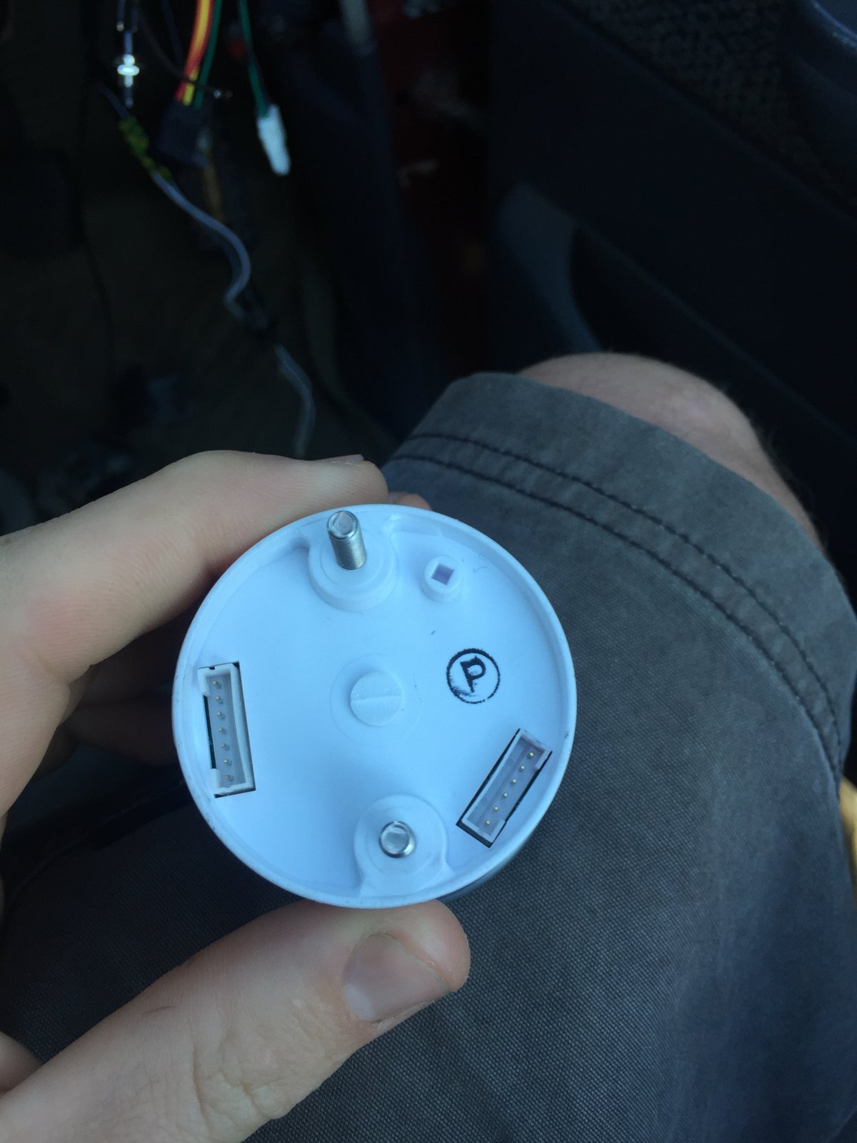

Ive been meaning to have a look at retro fitting one of these for a while. Would you mind taking a picture of the connectors?
Let me know if there's any other pictures or questions C.G
Top man, cheers. I know ive got a few empty connectors around there, ill see if they match the one in your pics..
