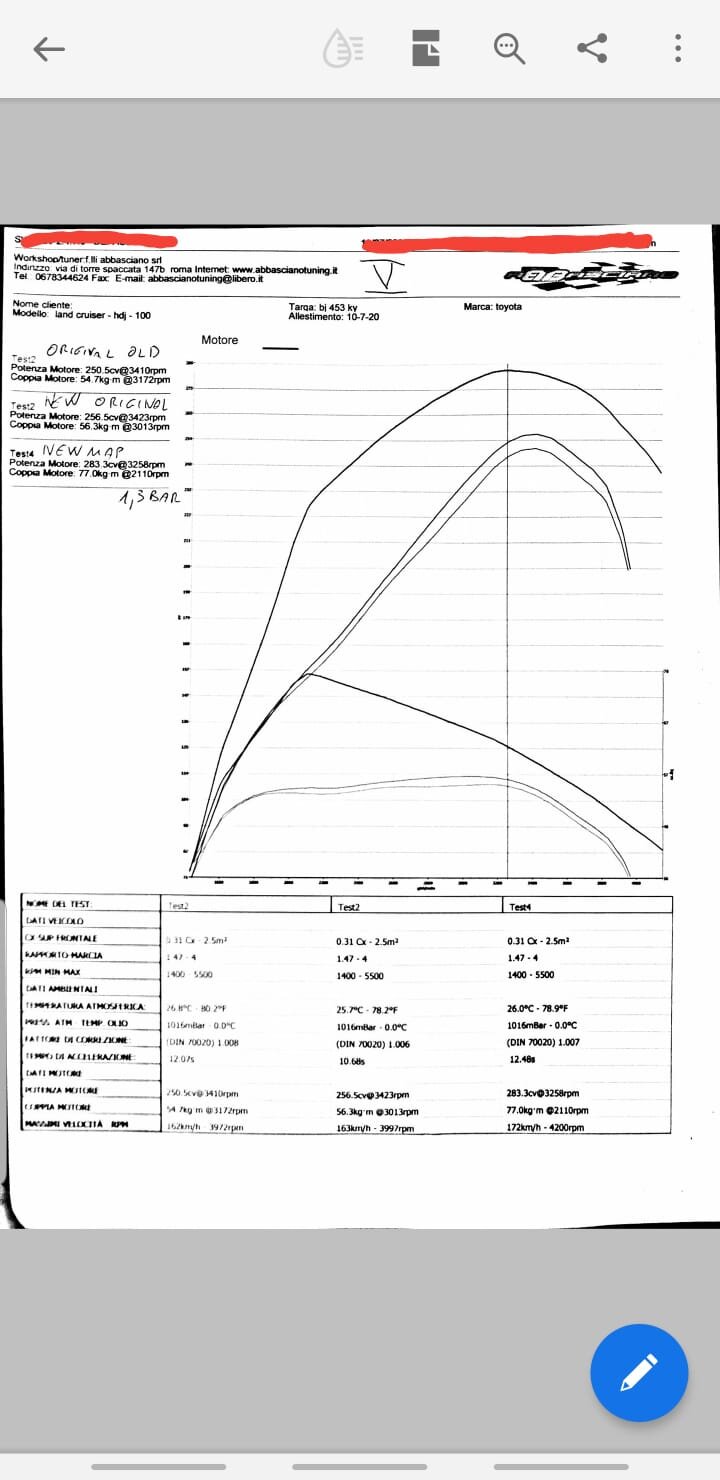

hello sorry for the delay, I have already solved this problem for some time. my 100 develops 77kg of engine torque at 2110 rpm and 283 hp at around 3100 rpm all at 1.3 bar pressure. I still have an oversize turbo and original injectors. there are several upgrades and changes to make. but everything is possible.

Hey, it would be great if any info is also availbale here for the sake of future visitors.
Did you use a Unichip? Who tuned it in Italy? A few words on what you had to do would be greatly appreciated.

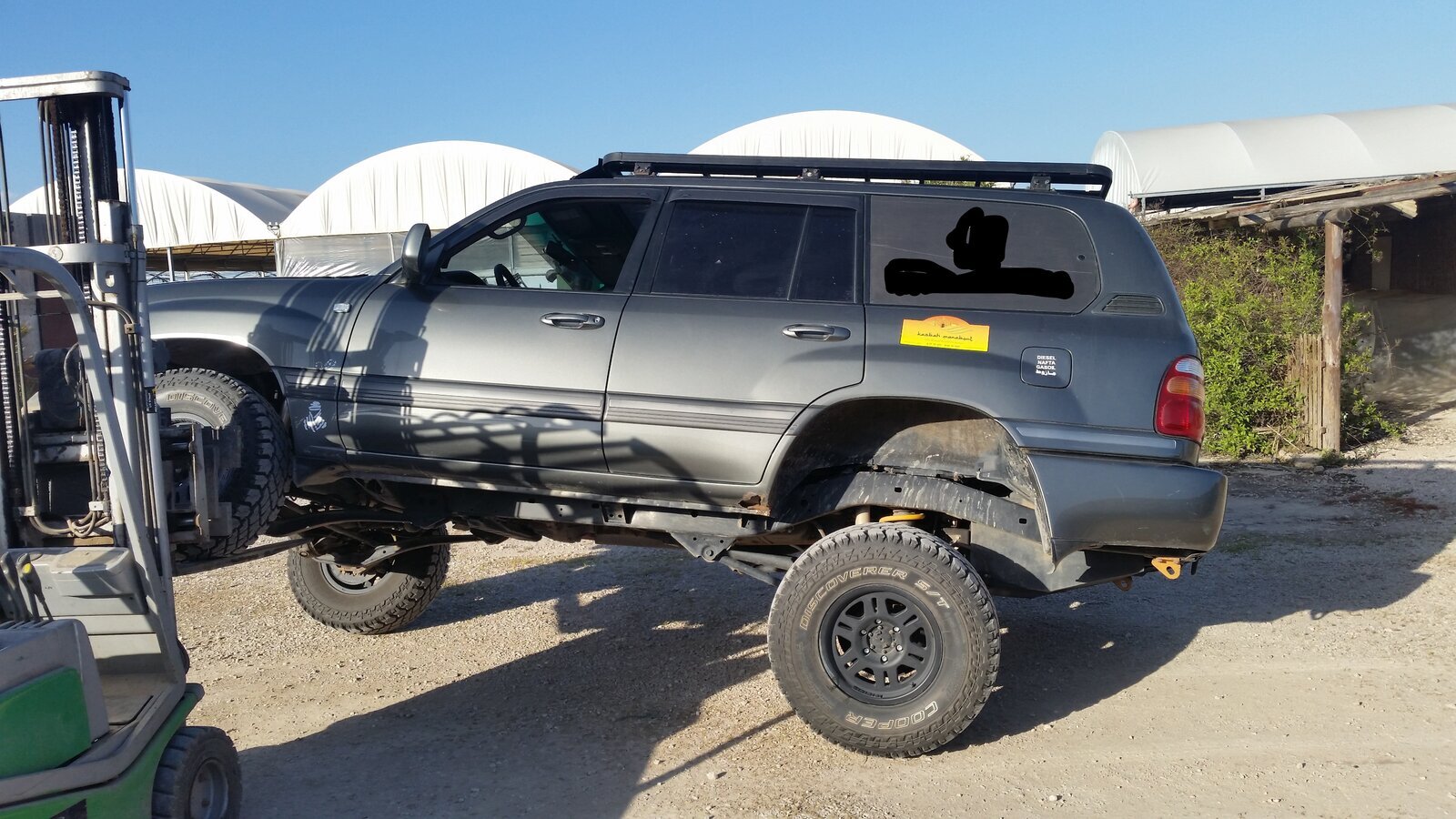

I have a toyota hdj 100 from 2000 manual gearbox slightly modified over the years, I travel a lot and when a few races happen.
I'll list what changes I've made to make it a lot of fun.
I have an air / water intercooler, I had the original turbine overhauled with an impeller of the same size but in avional and reinforced the bearings with the HD ones of the CT26, I made a change to the accelerator pedal bringing it to 88% (original is about 65/70%), two years ago magically after more than 300.000km my pump left me, so I dismantled everything and with great difficulty I reconstructed it .... and here I realized some limitations for the European version euro3 .. modified and reassembled. very prompt delivery from the lowest engine revs, I built a steel hull creating a downpipe divorce, and it is fantastic.
a bit like acting on the lda of a mechanical pump, all without the use of electronics yet .... in the result I shot before you find the result with 2 tests with the control unit off and 1 with the control unit on. where I have 250hp @ 3423 rpm and 56 kg @ 3013 rpm, but already 50kg @ 1800 rpm. an excellent result with 1.1 bar of turbo pression. and 283hp @ 3258rpm, and 77kg @ 2110 all at 1.3 bar pressure with MWR control unit on.

I hope you understand everything, I used the translator. my next upgrades will be the injectors (mine have 350,000 km) and I can't wait to try the variable geometry turbine. I am not looking for CVs but I love motor shooting and my next target is 90kg of torque ... regards Davide
