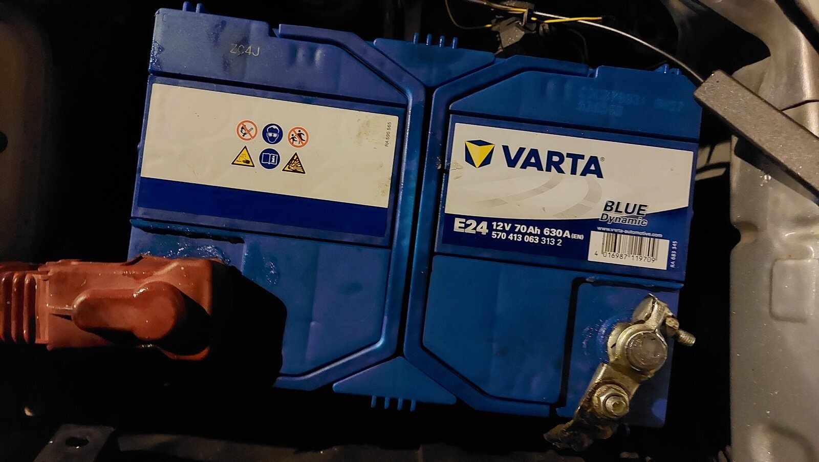

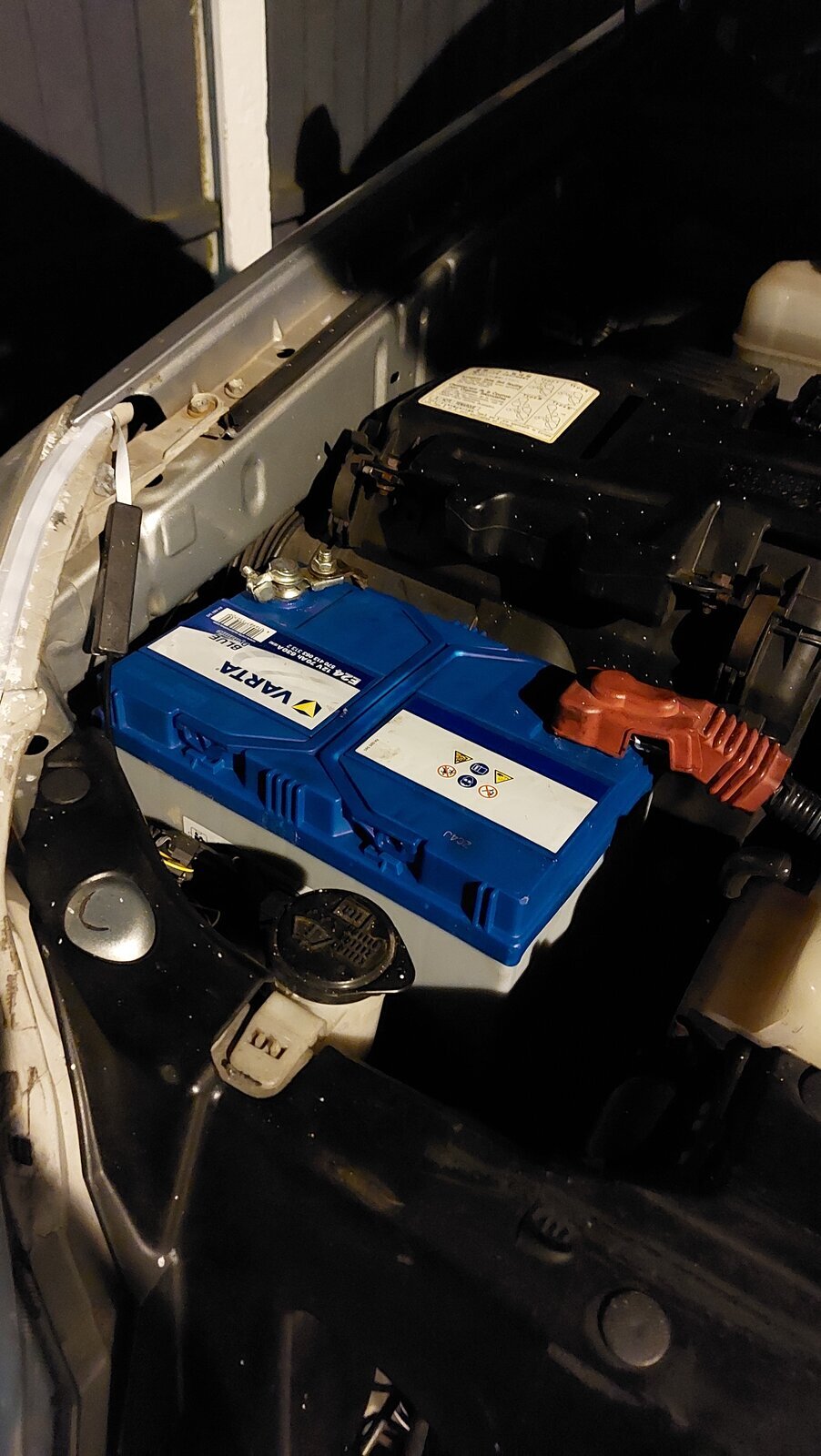

I went to karbar or ( culmac ) as it was once called and got a pair of varta batteries £109 each but good quality.
Since installing new batteries the lc5 now fires up twice as fast.
I have owned my lc5 for over 4 years now and never changed but out with the old in with the new.
Since I intend on keeping my lc5 I have no problems spending cash out to benefit myself and store reliability and piece of mind..

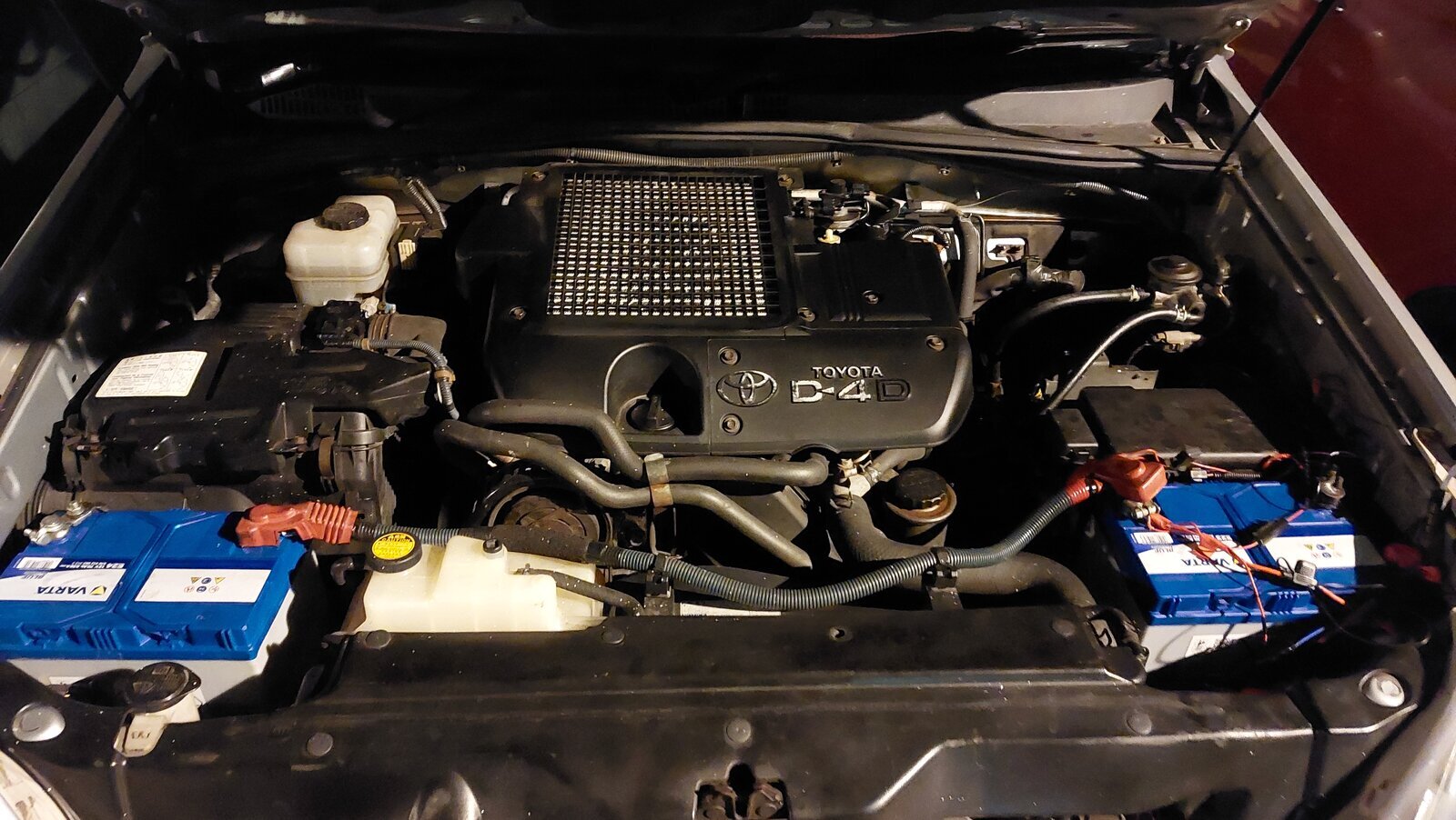

This is my new combination. :text-bravo:

Same here, I put Varta batteries on my 120 3 years ago, after a recommendation by Trevor .
I put the biggest a/h, c/c ones on that just fit in the space and perfect so far, it starts immediately every time.
Bad enough trying to fit new bulbs in with the standard batteries in place, so stuck with them, think several of us were needing new batts around the same time.
Oddly enough the larger and larger capacity size, which TM has jammed in ;) place, were much better value than those meant for the 120 possibly slightly cheaper too, i believe were they meant for the 100 series.
Same here though, no issues since fitting despite it sometimes standing for a couple of weeks between starts in winter, which is more than can be sid for too many modern vehicles which seem to use so much power just sitting that a couple weeks at an airport during winter you're likely to come back to a flat battery, one of the things what saw us move away from Mercs (W124's nothing new) which were always touch and go if there was enough power left after only a short period standing, if a motor isn't 100% reliable i don't want the thing.
Jammed in Jud ??
I nearly got out the BFH !!
They do have some wriggle room and don't contact anything though.
