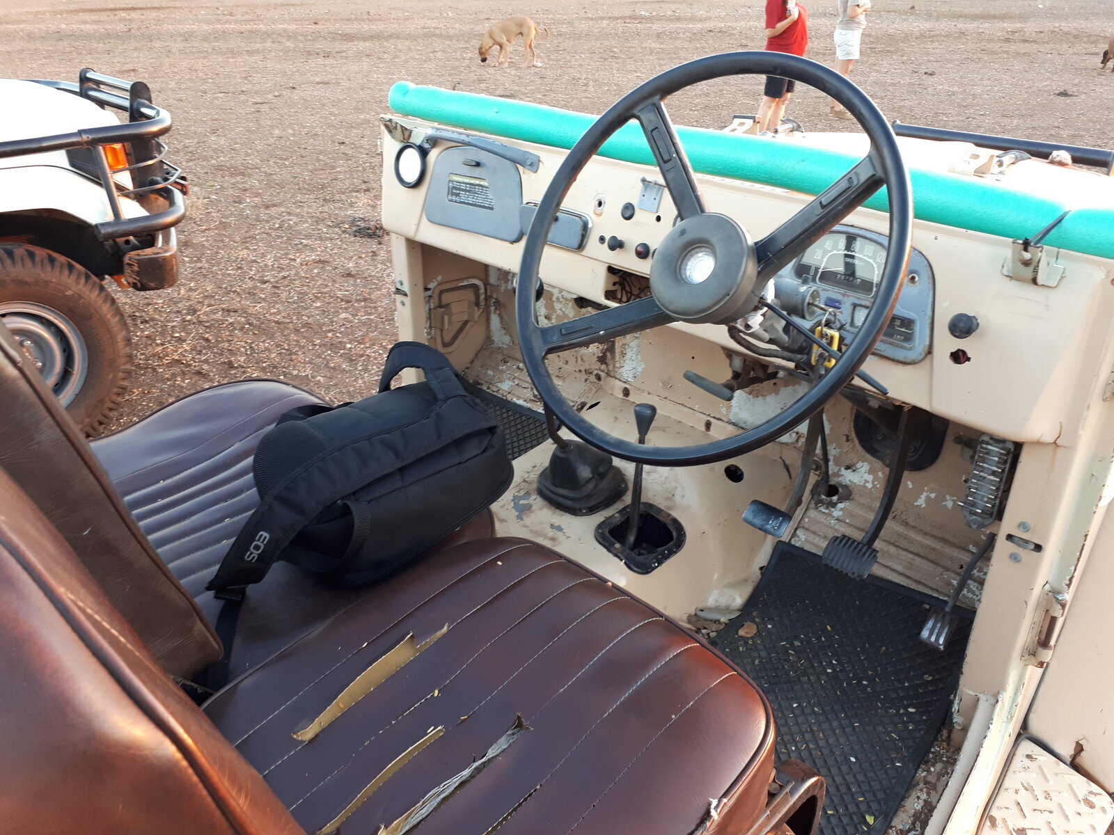

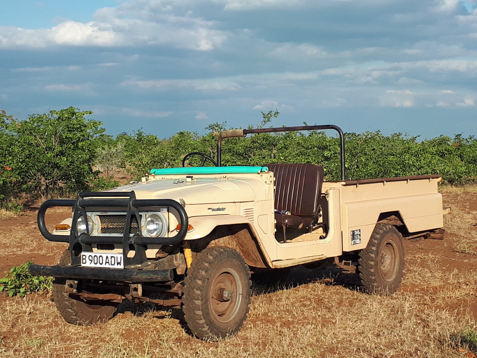

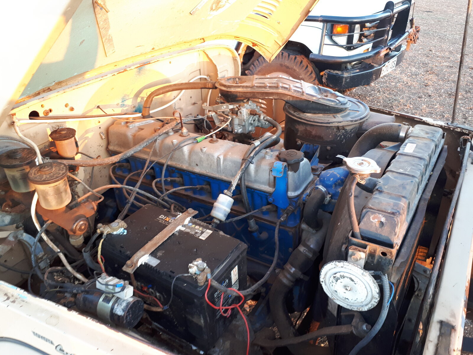

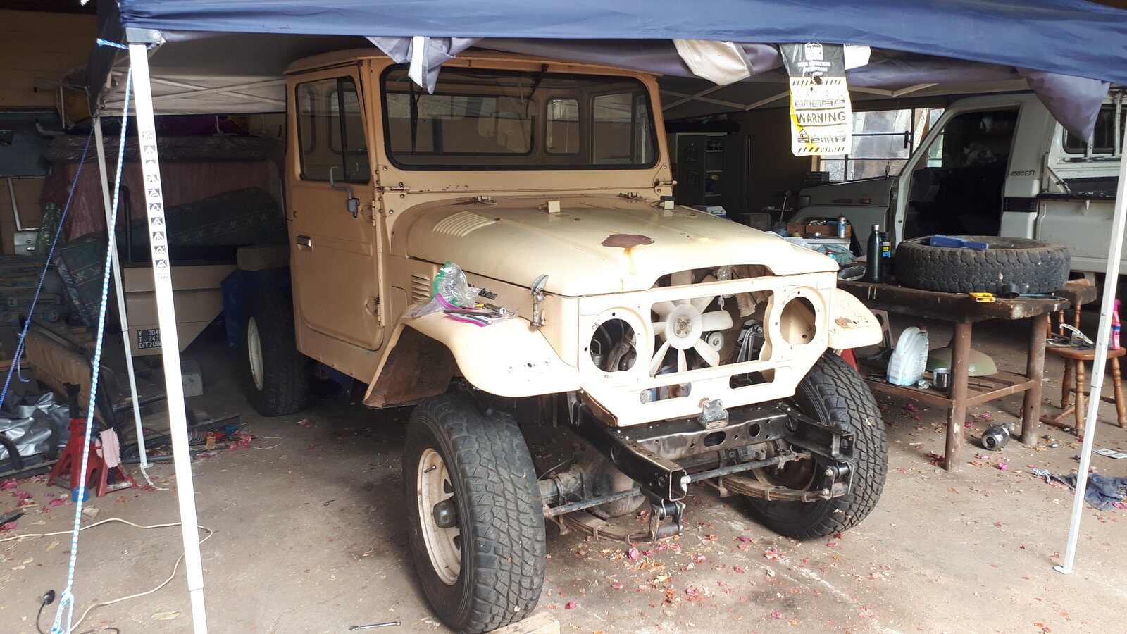

My name is Craig, I'm new here and I have recently been fortunate enough to be able to purchase my 1971 (I think) FJ45 Land Cruiser which I have been chasing for more than a year. The cruiser is running the 2F engine with the 4 speed transmission and has barely been run in with 29122km on the clock (the odometer seems to be working fine so I'm hoping that those are original kilometers). This has been a long time goal for me and I'm over the moon that my cruiser finally found me
*The chassis # is FJ4594537, if someone can provide a more accurate estimate on the year of production I will be very grateful, I may be way off. The regisration papers I have say that the year of maunfacture was 1985 but they are notorious for making mistakes as the details would have been filled out by the importer. The chassis # also doesnt seem to match those made in the 80s....
The vehicle was bought in South Africa and from what I can work out from the chassis # it would probably have been among the first batches that were imported into South Africa at the time. I dont have any more info on its life in South Africa but it was likely used on a farm as were most cruisers. It was then imported into Botswana in December of 1996 where it was put to use on a game reserve in the Tuli Block as a safari/game viewer vehicle only being used once or twice a year. This is propbably the reason for the low km reading. Thankfully they kept it original and didn't cut or convert the body in any way, they just added some bolt-on seating at the back and the original body, roof, windscreen and doors were all preserved. I would say that about 75% of the original interior trim remains.
I took over management of the game reserve in question just under 3 years ago and at the time the cruiser was owned by the outgoing manager. He tried a few times to export the vehicle back to South Africa with him but C-19 coupled with a few other things made it nearly impossble and after a year of me nagging he finally agreed to sell it to me.

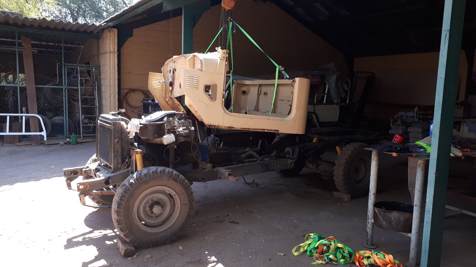

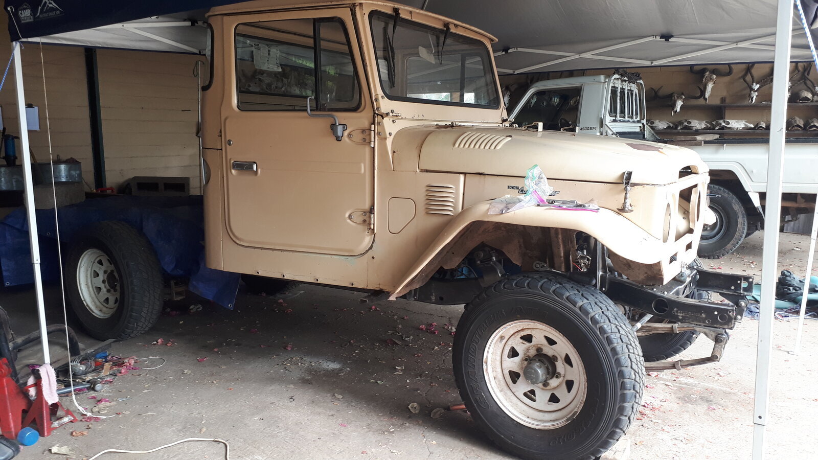

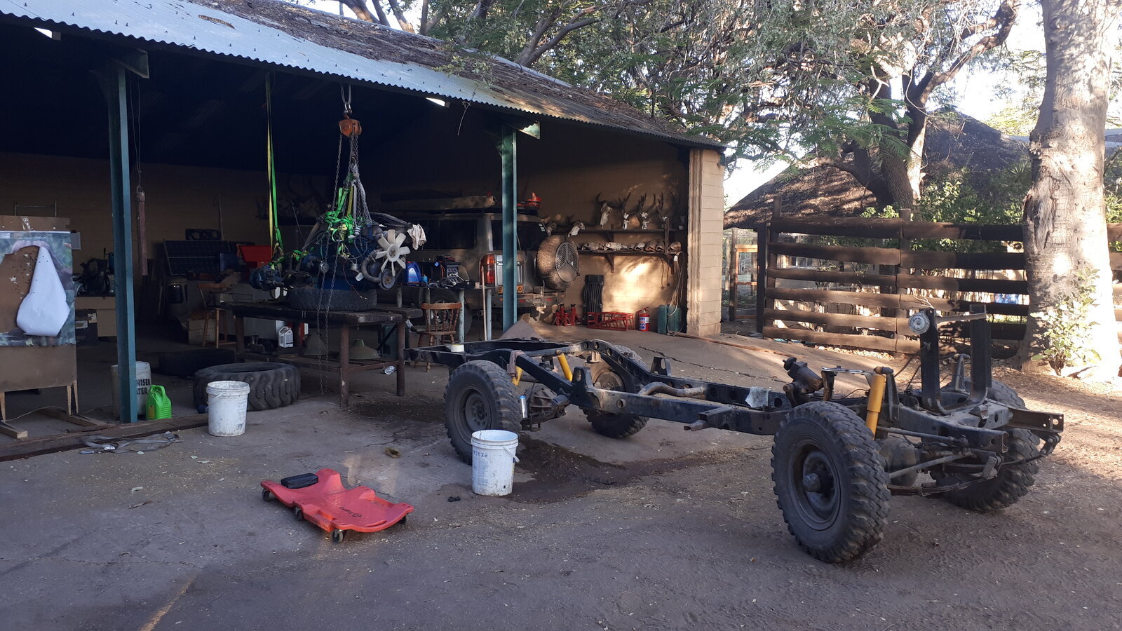

I haven't wasted any time and I dove straight in, I have so far pulled off the body and removed the engine and drivetrain. At the moment the cruiser in in bits with all the different pieces, nuts and bolts ect all carefully photographed, catalogued and stored. As you will see from the following pictures, I am now at the stage of prepping to remove the wheels and differentials so that I can start cleaning and sanding down the chassis for paint. I am not a mechanic by any means and we are located way out in the middle of the Botswana bush under my humble workshop roof but with the help of the workshop manuals, help from those on the forum and hopefully a bit of common sence, I will manage to give the old girl a decent restoration. This won't be a nut and bolt resto as I simply can't afford that but rather a soft restoration with the ultimate goal of being able to use it as a daily drive and capable mid-range overlanding rig.

Ok been a bit busy lately so I havent done as much as I'd like to have done but I have at least managed to pull out the diff and strip the last components off the chassis so it is now completely bare. I also had to go to Gaborone for work so whilst there I also bought the chassis paint and relevant preparation materials. I was hoping to prep and paint the chassis now in November.
Today while in the workshop I had another quick look over the chassis and to my dismay I discovered a 3cm long crack on the chassis at the left-rear engine mount. Looks like someone tried to fix something there a while ago and thier welding was not up the scratch and it has cracked along the weld. It actually looks like they replaced the engine mount itself, it does not look original...
Then, just when I thought that's ok it can easily be fixed, I I removed the rear bumper and tow bar and discovered that someone had been let loose, with what I think can only have been a blow torch, on the rear end of the chassis trying to make new holes for the rear bumper. Clearly they had never heard of a drill or the last owner possessed a very casual attitude towards vehicle maintenance :flushed: . They made a complete mess of the rear of the chassis on both sides and this is going to require a skilled welder with an engineering mind to brace this up so that its strong enough to tow things again , skills wich sadly I do not possess.
This all means that I have to get the chassis to an engineering or panel shop which are 3 hours from here and also means that I have to push the paint work back a while until I can get this done.
Still, it could be worse, at least there is no rust and it's part of the adventure and process so onward and upwards, just hope that the old girl isn't hiding and more surprises from me
Take a look at the pictures and see if you can guess what tool was used to make those holes...

Plans have changed quite a bit in the last month! After stripping it down the bare chassis I am now semi reassembling it so that it can be transported to Gaborone to Classic Cruiser Co Botswana for a professional build which will start in January 2021.
It changed because firstly, I underestimated the amount of work needed to get it to where we could use it every day if we wanted, it is just going to take too long. And two, because of where we are located getting specialized parts shipped in is logistically difficult and I would have needed to transport it nearly all the way to Gaborone for paint and panel bearing anyway which is expensive ....
