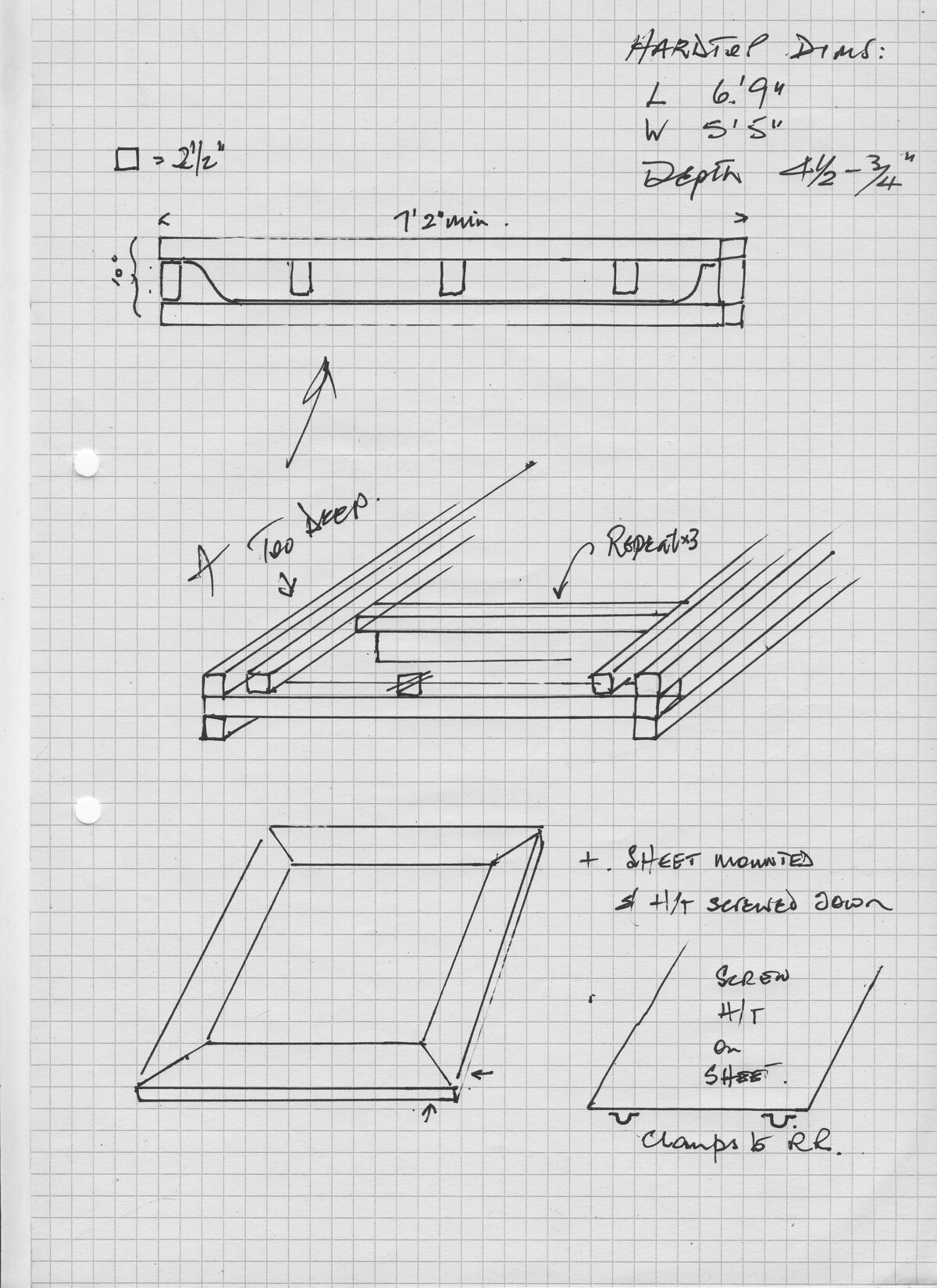

Re the hardtop: I have just measured the one I have and the distance between the wheels and it is just too short but I have big wheels fitted so it might just fit, even if it was slightly angled. I drew out the idea for a 'hardtop cage' using planks and by the time I finished and working out the overall dimensions, depth in particular, it wouldn't fit under my truck and I have a 2+" lift and big wheels! So after a bit of revised thinking for the 'frame' it became four angle planks screwed together to make an oblong, cut an 8' x 4' sheet to fill the underside and attach to the planks. Attach the hardtop to the planks using penny washers and screws. I guess, using pipe clamps it would fix to your Hi-Lux roof rack but with the 8 x 4 sealing the bottom there is much less wind getting inside. If you used the roof rack and a substantial piece of 8x4 then you wouldn't need the planks.
The roof on its own measures 6' 9" long x 5' 5" wide (widest point as it tapers to the front) and is between 4 and 5 inches deep.
Conversely and assuming that the windows on the FJ close, you could drill out the four corner rivet remains and some across the front and put the roof on and nut and bolt it down with spreader washers and then use loads of gaffer tape round the edges. It wouldn't be pretty but the roof is then in its natural position.
Sorry that this is a bit convoluted but when you asked me to explain I thought I better go and work it out and one thought leads to another and so on. And I hope it helps.

Photo of drawing please Rodge, my one functioning brain cell just started emitting steam through my ears…(never a good sign!)
You'll have to excuse my poor drawings but I sort of picture things as I plan...
To me the cut down sheet (I said 8x4 and it would need to be 8x6 but Mitch is builder so that shouldn't be a problem) that's clamped to the roof rack would work or install the roof in its frame and screw and gaffer tape it.
Hopefully the drawing comes out.
Cheers

Thanks Rodger! yeah I will have a look at it tonight and see what I can come up with.
Thanks for that information, im glad star got lost as well cause my brain got fried trying to visualise what you were trying to comprehend haha!
Cheers
Thanks heaps mate! I understand now! haha, apart from the measurements being different as in OZ we are metric not imperial. but I do get your drift, I think best way to do it as you even said you cant fit it under your car will be on my racks on my hilux, my canopy is most likely going to be absolutely loaded with parts that he has taken off already.. gunna be a fun drive home lol
