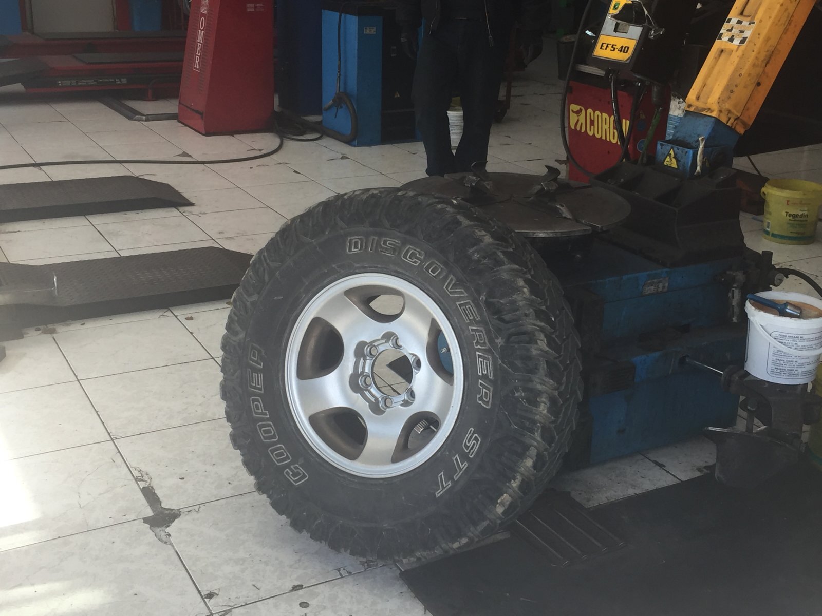

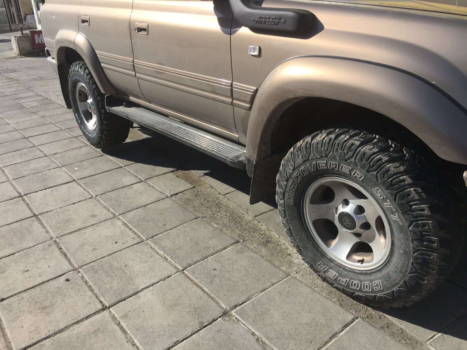

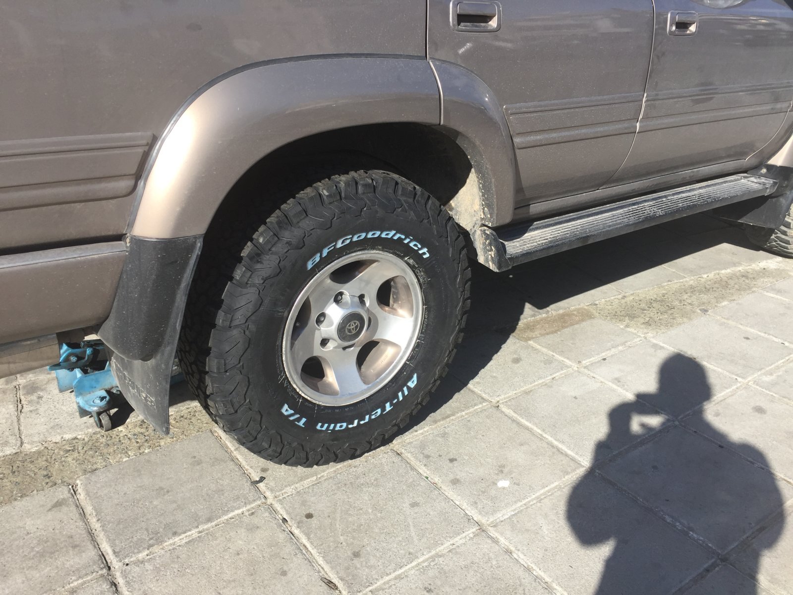

Fresh rubber on unfortunately suffered a broken stud on off side this time..Arrr
Can't afterstand why this happens so often...... anyone have any experience on this?
Having new tyres thinking to rotate the tyres on every service but it worries me in getting more studs snapping!!
Thankfully the ride sits better now & doesn't pull to the left anymore. Blissfully quite too in the short time driving so I'm pleased with the change over.

Dave the tyre guy took the wheel nuts off by hand this time & but used the gun carefully to put them back without over stressing but another one snapped.
Luckily I have some not new but bought from the breakers some years back as spare. Was told their all the same size front & rear back then.
Using the original Toyota bolt head too from the chrome ones I had on before.
Your right on the rears being easier having change them too & fronts being a hassle for sure.
At this point it could be the studs getting weaker over time mostly aged like the car?
Avoid the pressure gun totally?
Or buy Brand new studs?

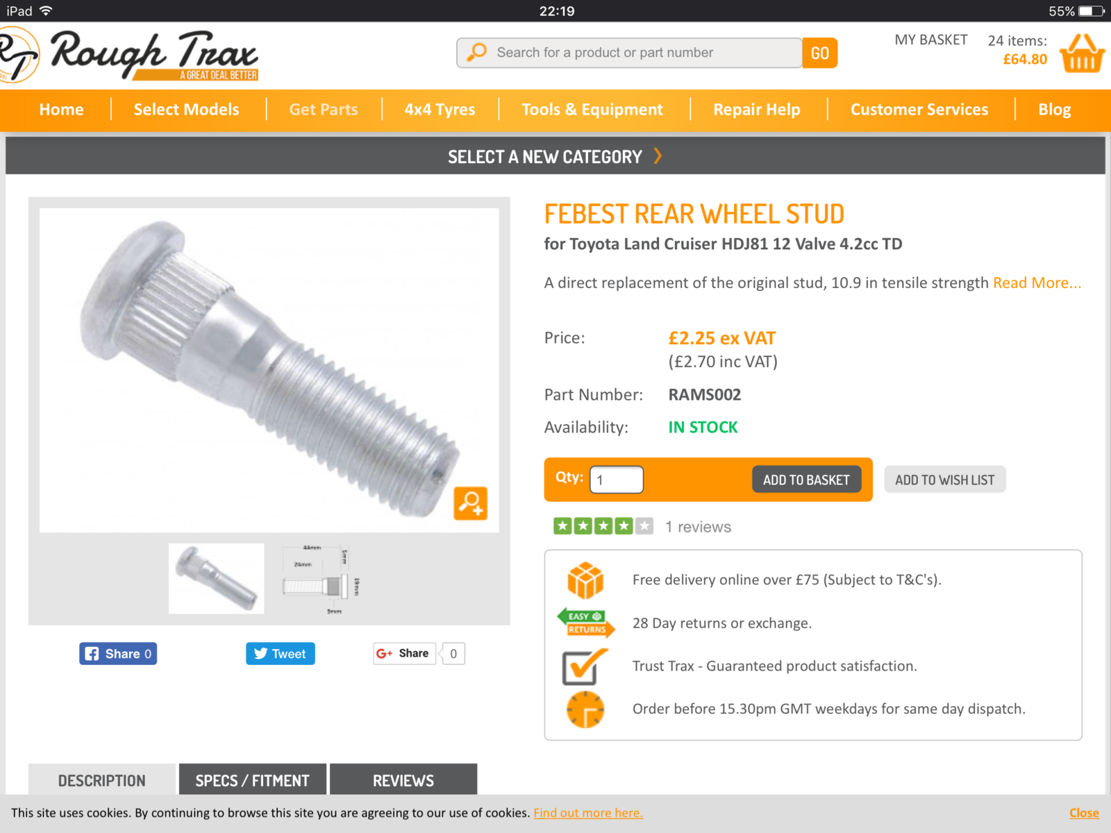

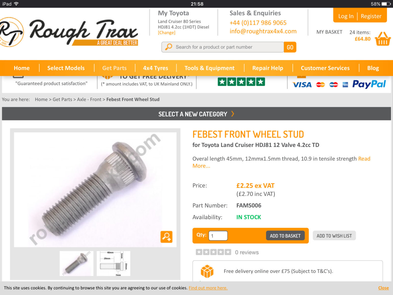

Thanks Dave was looking at Rough Trax having search on here.
Quote 'The new studs are 40mm long including the spline, 45mm overall and made of High-Grade 30MnB3 high tensile steel, 10.9 in tensile strength, thread size 12mm x 1.5mm as per standard'.
Will look up the exact front & rear studs via the chassis vin number soon just to understand if there is a difference in length first.
Looks like I need 4 batches (24) in hand another project added to the list. :weary:
Looks like for just the front wheels only, have a look to see if they have for the rear as well?
regards
regards
Rears they have Dave different size.
Quote 'The new studs are 44mm long including the spline, 49mm overall and made of High-Grade 30MnB3 high tensile steel, 10.9 in tensile strength, thread size 12mm x 1.5mm as per standard'.
Fronts
Here Dave Looks like the Rears are longer!!
The rears may be longer? I did post up my findings last year when fitting all new discs/pads/callipers etc. So it is a little misty in the grey matter?
