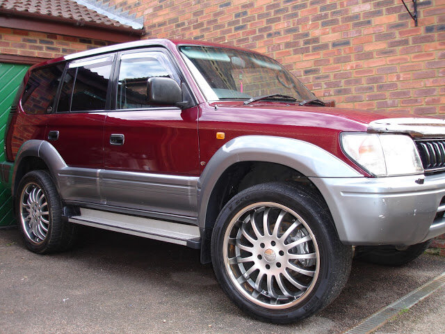

I have read the standard 90 wheels are +15 to +30 offset depending on who wrote it .
Everyone accepts the 80 series 16x8 wheels have a zero offset and fit the 90 series well with the advantage of a wider stance and better look .
My theory , or question , whichever way you choose to look at it is this -
The 16x8 is one inch wider than standard (16x7) on its own , and the zero offset brings the whole wheel/tyre approx one inch closer to flush with outer wheel arch . I would guess the zero offset coupled with the wider wheel actually move the wheel an inch and a half or 38mm outwards .
If i figure this right then this should leave a shy inch of empty space formally occupied by the positive offset of the original wheel .
So the optimum wheel size for an otherwise unmodified 90 series should be 16x9 with a +25 offset .
I'm not sure i follow my own logic here but i would be grateful for opinions from anyone who understands what i'm trying to say .
