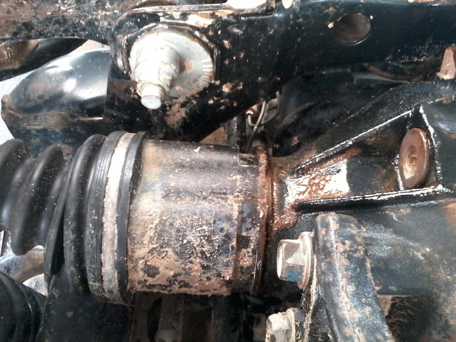

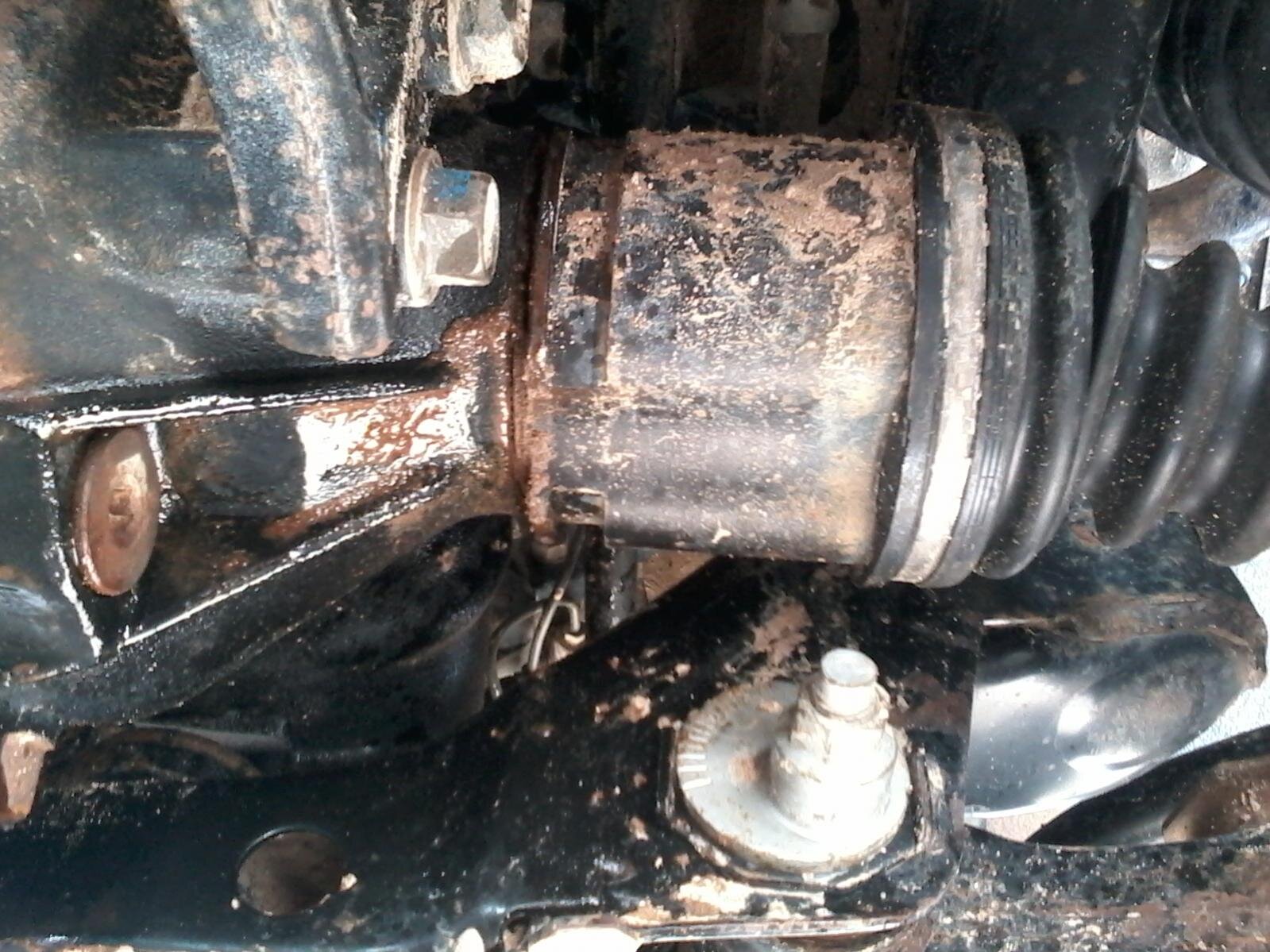

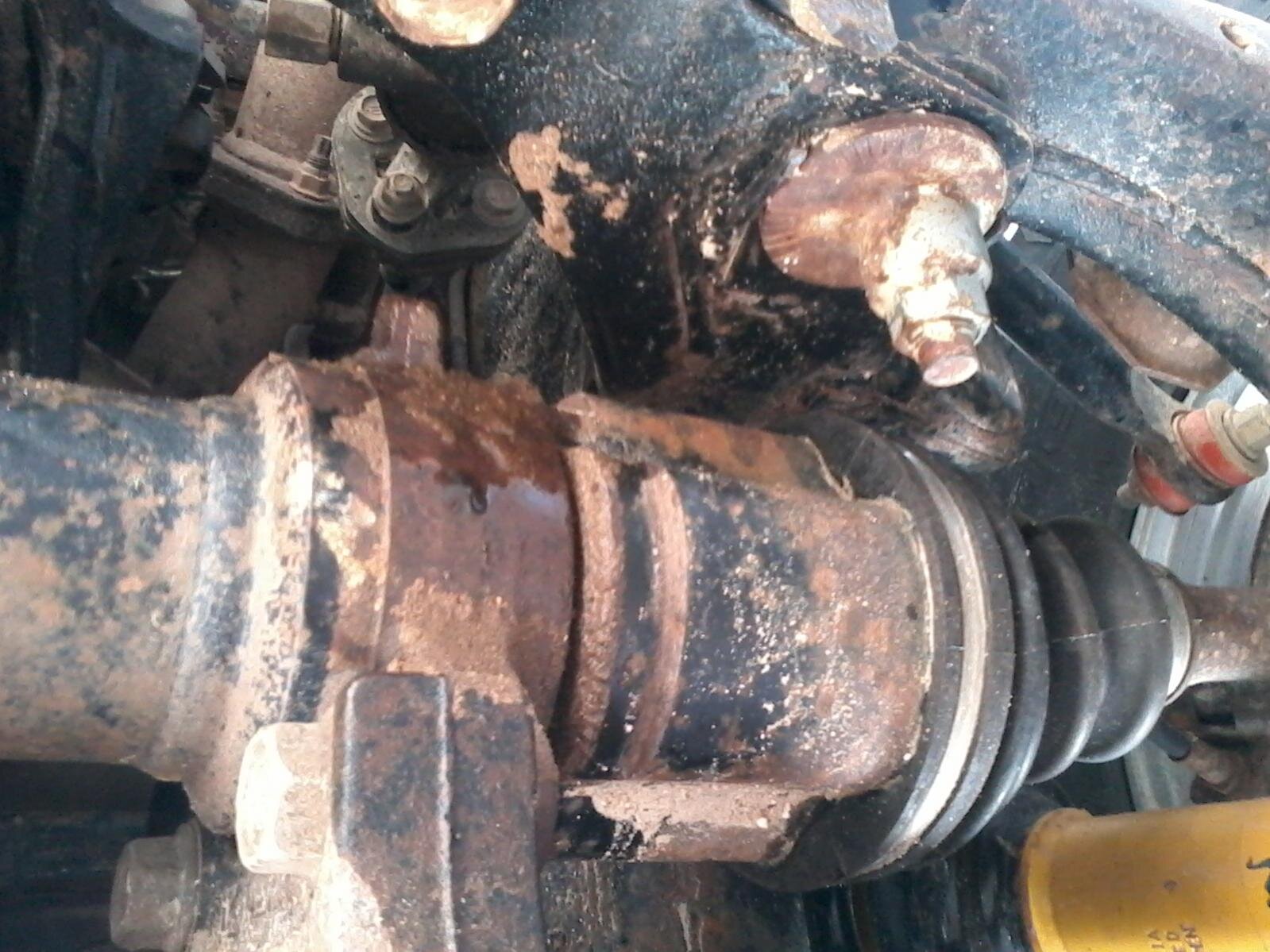

Will it be the same leaking seals as mine currently??? Would any of you that has changed these oil seals mind to share how this is to be done and how much blood/sweat/beer is required or any special tools, etc?
i put the stop leak in mine amd that has worked for me.
"i put the stop leak in mine amd that has worked for me. "
Where did you add it? Assuming to the frond diff oil? As a temp measure...
Fitting the DS seal is a little tricky. There is no machined lip for it to sit in. There is a bevelled lip there which is essentially the seating mark but it's hard to get a tool to stay on the lip as you seat the seal so you end up pushing the thing in further. We did these seals at Lincomb this weekend on Chris' truck. Milner genuine Toyota and they worked perfectly. I think the trick with the seal in the extension housing it to use something like a paint can, tin of beans, large socket etc that will JUST fit inside the housing but won't go past the small bevel. This way the seal gets put in exactly square and not too far down the tube. We have found the best way to get the shaft out and clear of the seal is to undo the long bolt through the top of the wishbone and let the whole strut drop out of the wheel arch. Gives just enough to be able to pull the cv and get it clear.
Thanks Chris, you would'nt happen to have a few pic's of the process do you...? Everytime I've had to work on the CV's in the past I've removed the 4 bolts on the lower wishbone and tilt the strut out of the way which saves me to remove batteries, etc. It was a bit of a pain with those long bolts when we replaced all the bushes, but are you saying it is definitely easier this way compared to the lower wishbone bolts?
i reckon lower bolts easier (assuming they are not seized and no risk of snapping)
the top bolt, needs battery taking out and they airbag sensor being unbolted as well
