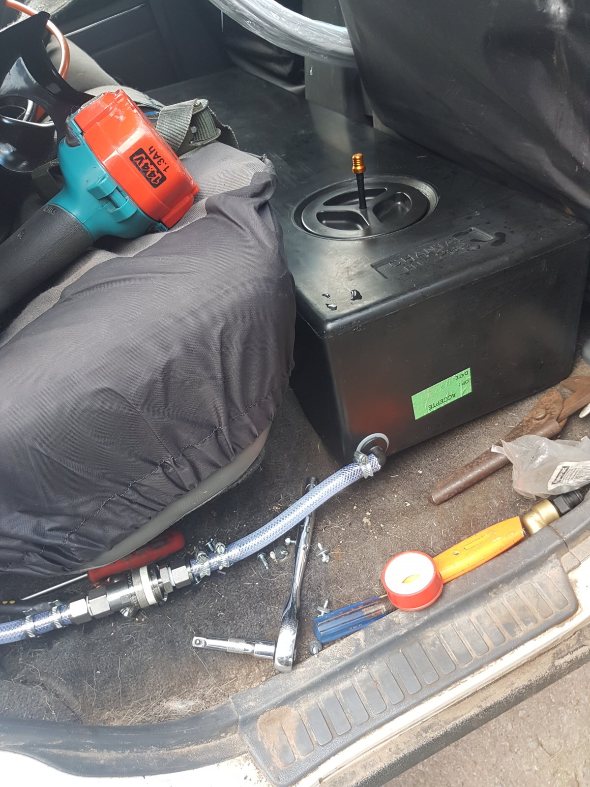

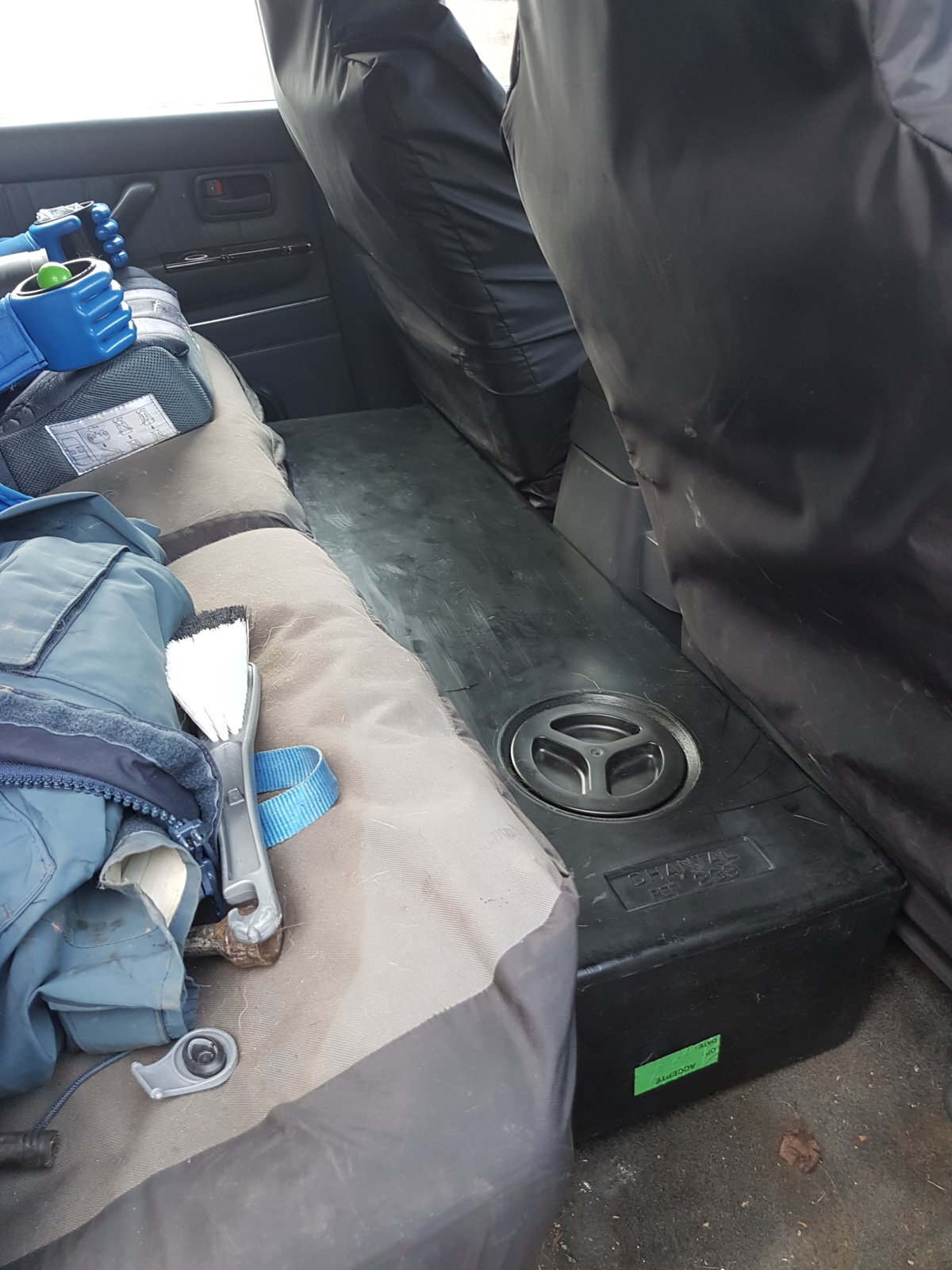

ebay number 122175527655 I got one of these that fits behind the front seats perfectly

Did you have to drill out your own tap point? from the listing "Allows the installation of fittings" isn't very clear
Yes bought a fitting from local plubing merchants for a couple of quid, also got a pump ebay 401272193253. Wasnt from this seller but same pump. Cant find the details but i am sure i payed £25 for it
The issue with the footwell saddle tank is that you need two outlets though don't you? One each side or you can only empty one of the sides. It's neat but I wasn't sure about the extra plumbing or having to park on slope. It also means you can't tip the rear seats up, which I do for access to other kit. With my extended seat runners I think that my seat goes too far back to allow the tank to fit.
Removing the back seats in the 80 gives you a huge amount of room to have all sorts of great ideas, but in my build I was determined to retain full seating capacity.
Nice and easy to fill having it there.
