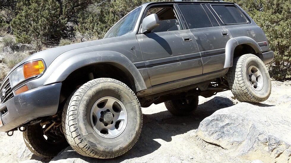

I lifted my fj80 and my axles shifted. Does anyone make any panhard bar brackets to drop the bars down?
Slee might do. I fitted adjustable panhard rods to mine, but it's scarcely worth the effort.
As above^^^^^^^^^^^^^^^^^
Lift more than 4 inches 'might' be worth thinking about, over that consider adjustable versions.
