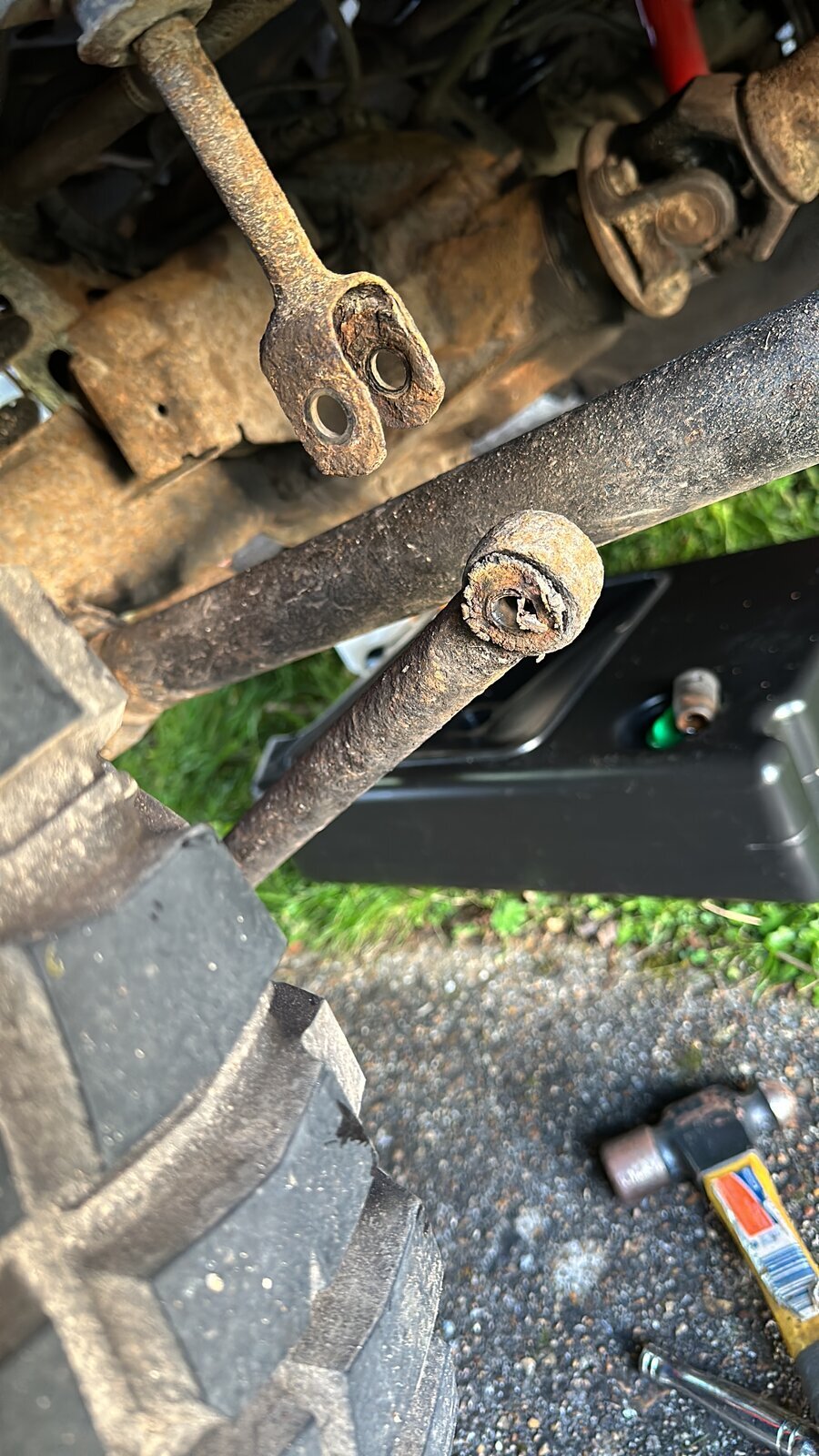

On another note, that is not what you want to see when you take off the old coil. Tragic. State of the steering and suspension in this wagon is pretty dire.
I reckon before you even fit the lift you'd be better off sorting the basics and getting all the suspension mounts and brackets sound .

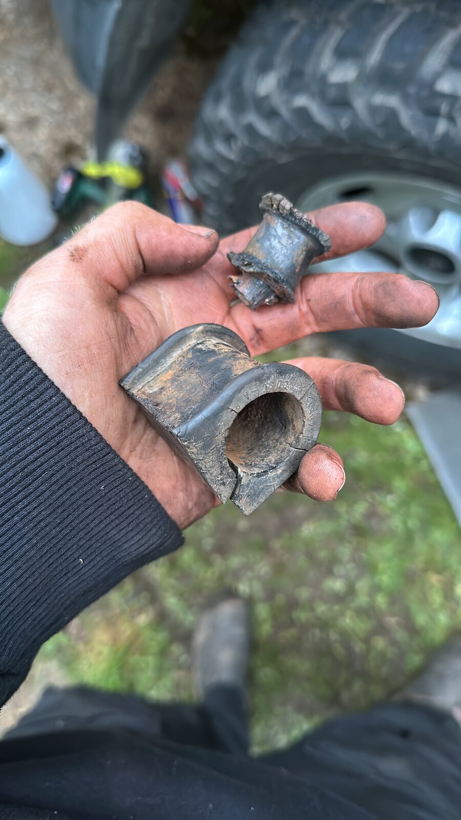

Getting to the sway bars now. They are in a sorry state, I’m genuinely tempted to just start buying entirely new suspension and steering components. Used the nolathane bushes (mixed reviews I know) but the drop link lower bush didn’t really seem to fit and actually bent the housing bracket. Anyone else had any issues with the size of them?

Radius arm castor correction bushes done. Again, original ones were in an absolute state.
Ratchet straps and FSM are your friend when taking them off. I just cuffed it on a whim thinking it couldn’t be too hard and didn’t read anything in the FSM, when I was under my wagon with a headtorch in the rain at 2100 trying to get them back on I regretted that…
