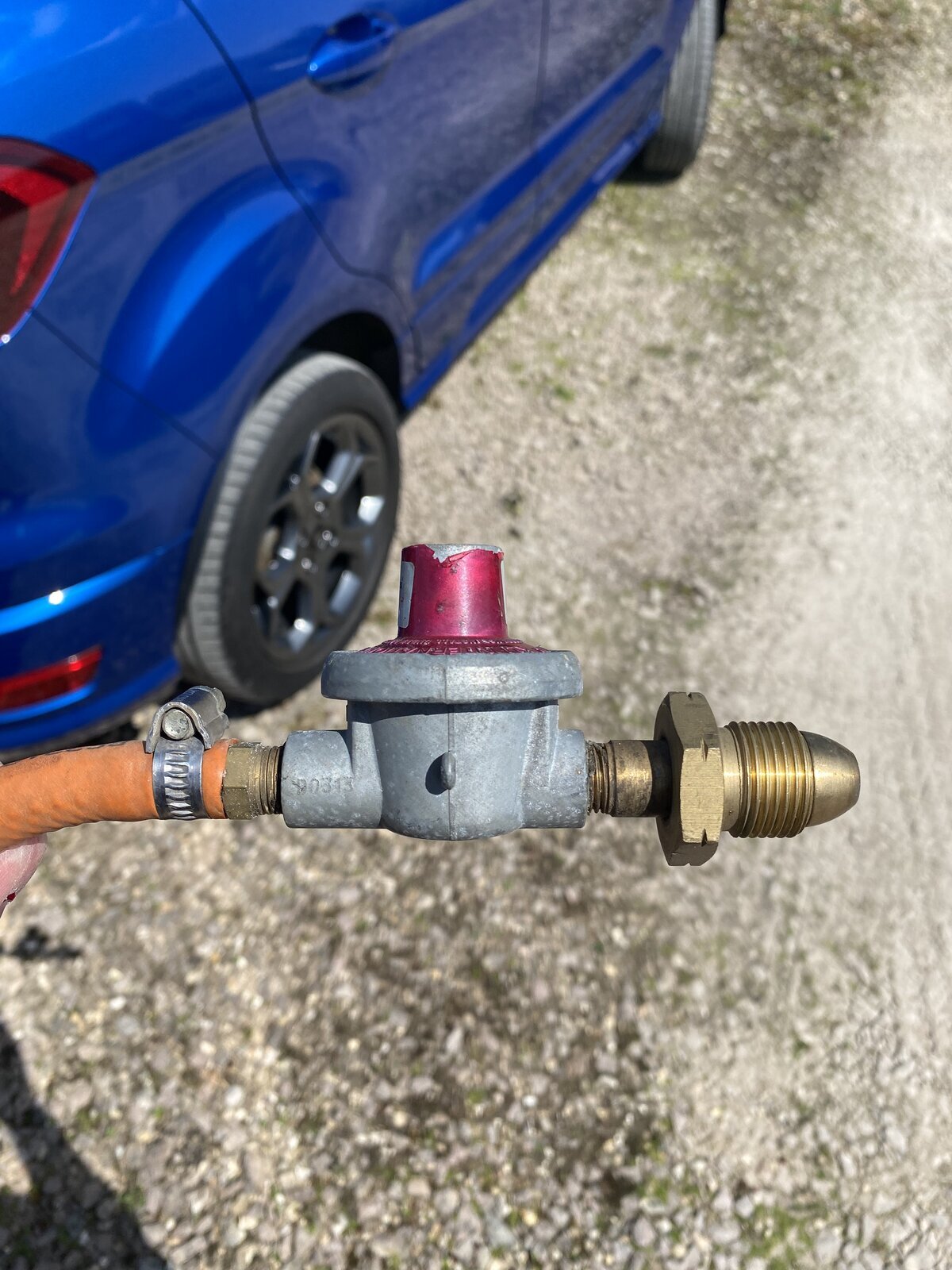

I have a partner stove, I use a calor gas propane bottle. If I remember correctly the regulator is high pressure, next time when I go to the container I will have a look and take some photos

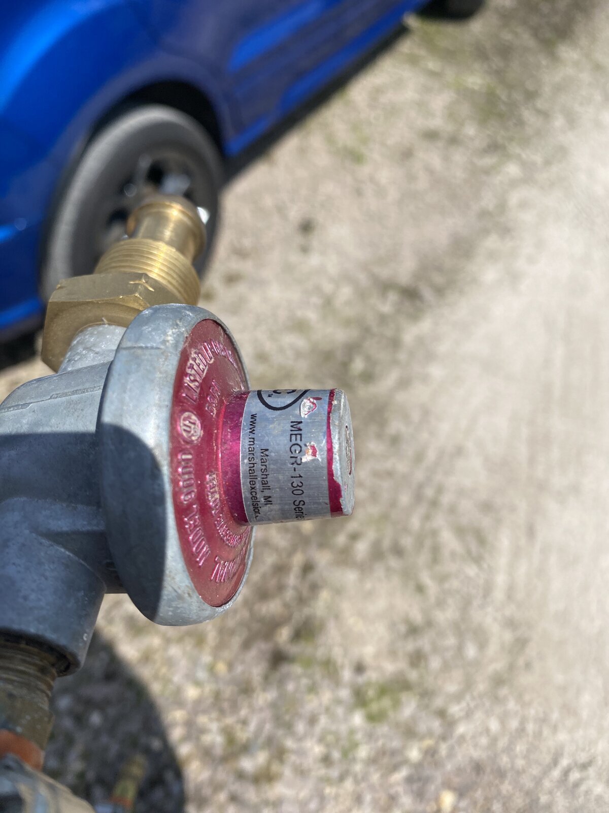

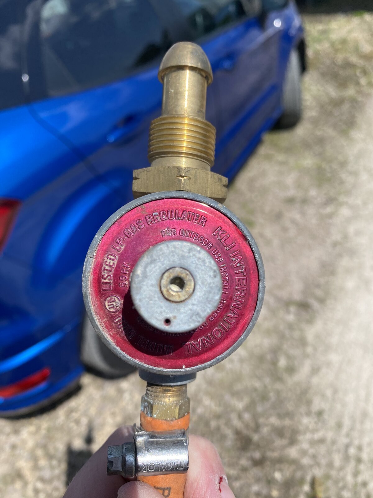

I remember now, when I order the stove Partner sent the regular but I had to change the POL connector (nut and tail).
The regulator itself i believe has a higher operating pressure than the standard fitted to most LPG cylinders here. IMG_2615.jpegIMG_2614.jpegIMG_2612.jpeg
