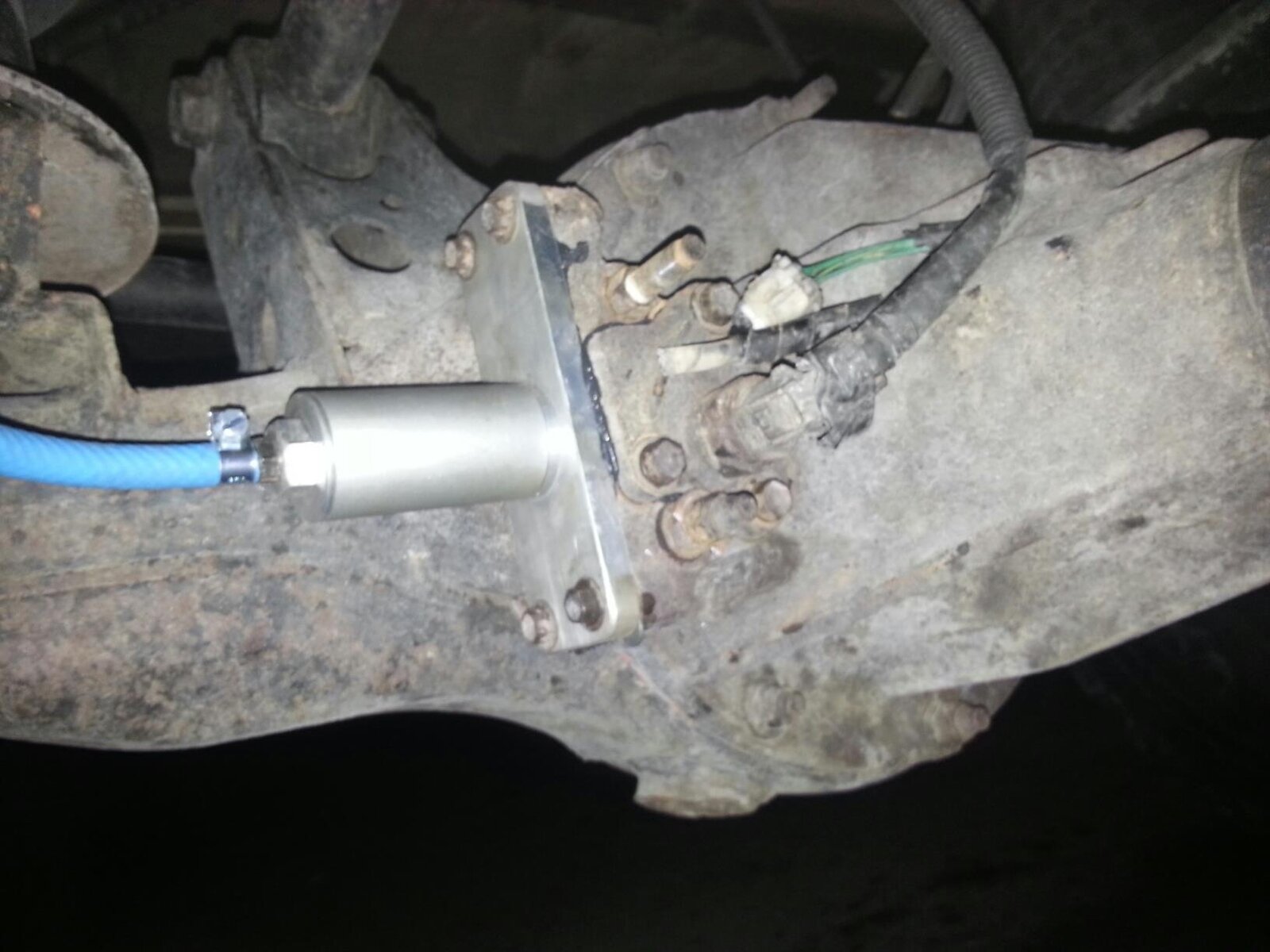

Miles cheaper than an original replacement unit and probably more durable. If your truck is prepped up with air its a no brainer, if its not and you need diff locks then you probably need air as well.
Can't see a downside??
Maybe I should clarify my post, they would be a good idea if a replacement is needed, however I, like yourself can't see any point in converting if the OEM diff actuators are in perfect working order, along with the rest of the diffs too.I see. Given a stock truck with working difflocks, it's a case of waiting for the OEM to break and then consider air plumbing? Presumably then replacing the rest of the diffs to match.
Those actuators are made by smc are well made and you can't get rebuild kits easily. The price is very good for what you are getting and the cost of the plate to be made.
Don't forget you will need actuators solenoids on top of this.
